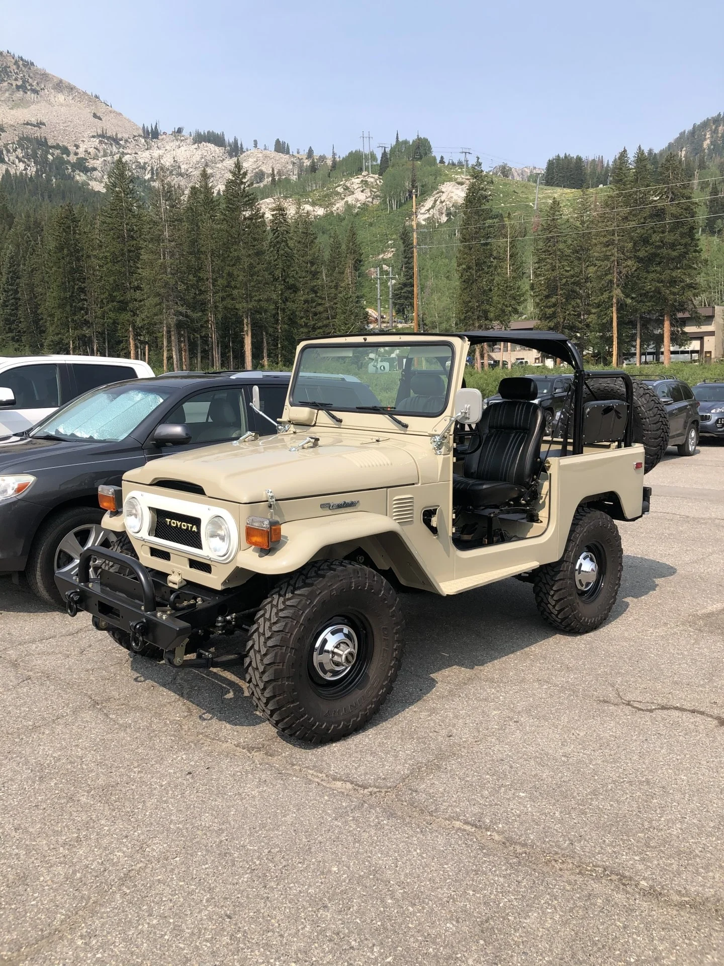

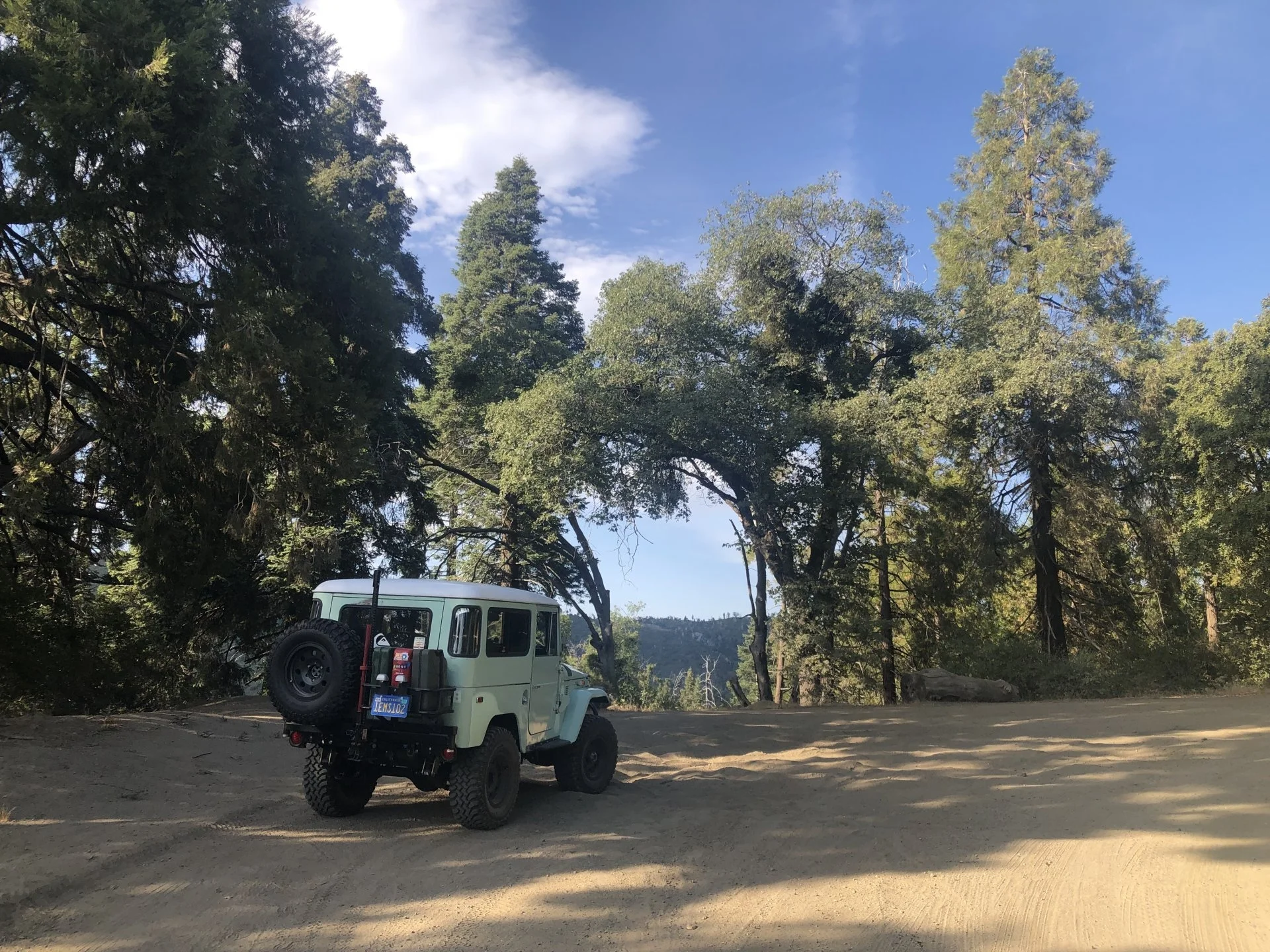

Installed the bikini top and rear tailgate. Took it for a spin up big cottonwood canyon and I’m convinced I’m running on much less than 6 cylinders 😂😂. Slow going is an understatement on any type of incline. A 2F cop motor or 2.8 Cummins will be in my 5 year plan. Still the best looking rig in the parking lot.
Installed the bikini top and rear tailgate. Took it for a spin up big cottonwood canyon and I’m convinced I’m running on much less than 6 cylinders 😂😂. Slow going is an understatement on any type of incline. A 2F cop motor or 2.8 Cummins will be in my 5 year plan. Still the best looking rig in the parking lot.View attachment 2728577

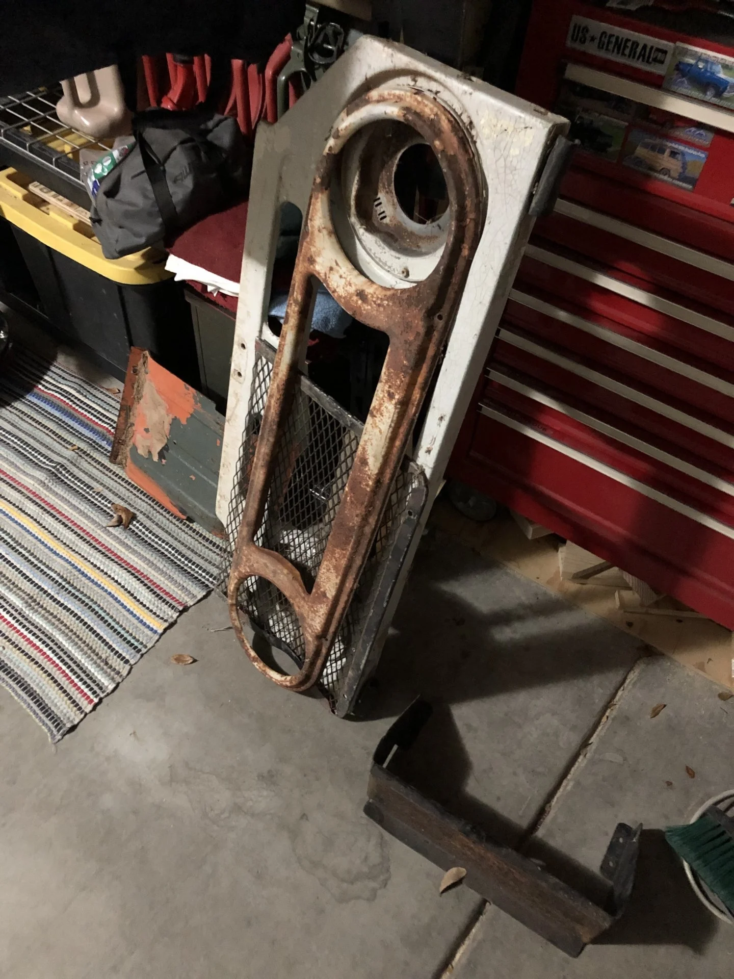

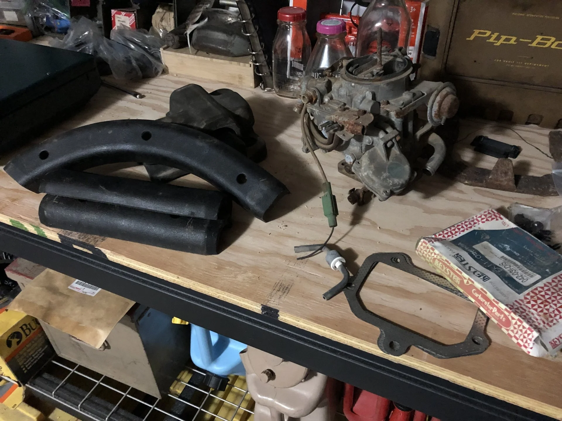

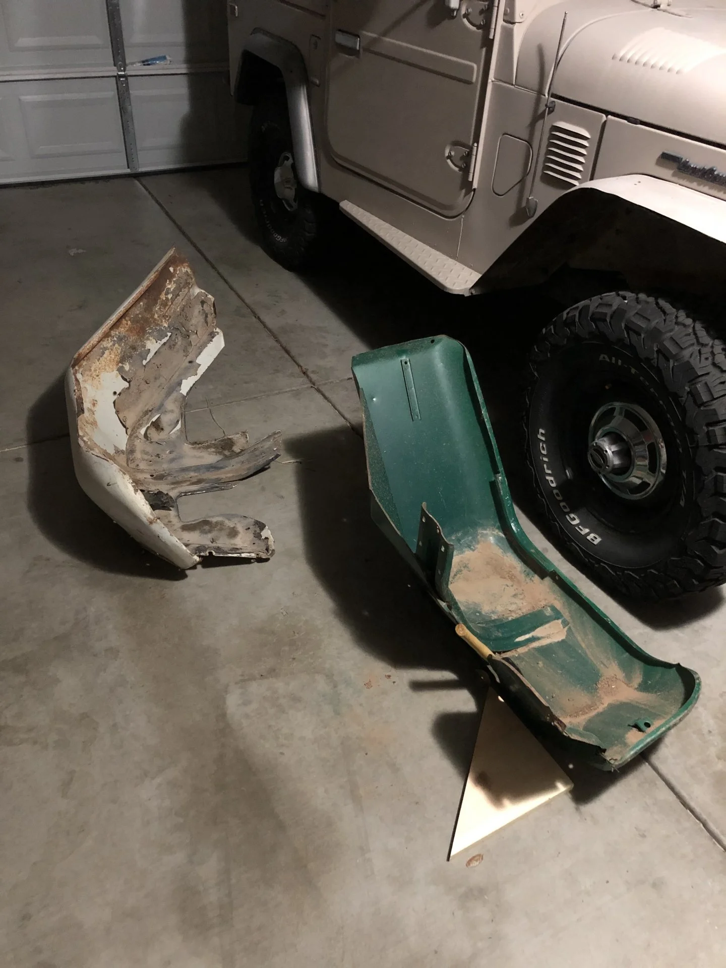

It’s been a whole year and a half, but now that my 40 is back in a garage I’m finally getting back to restoring!!! Thanks to a local legend, I got a big chunk of my remaining parts list items!

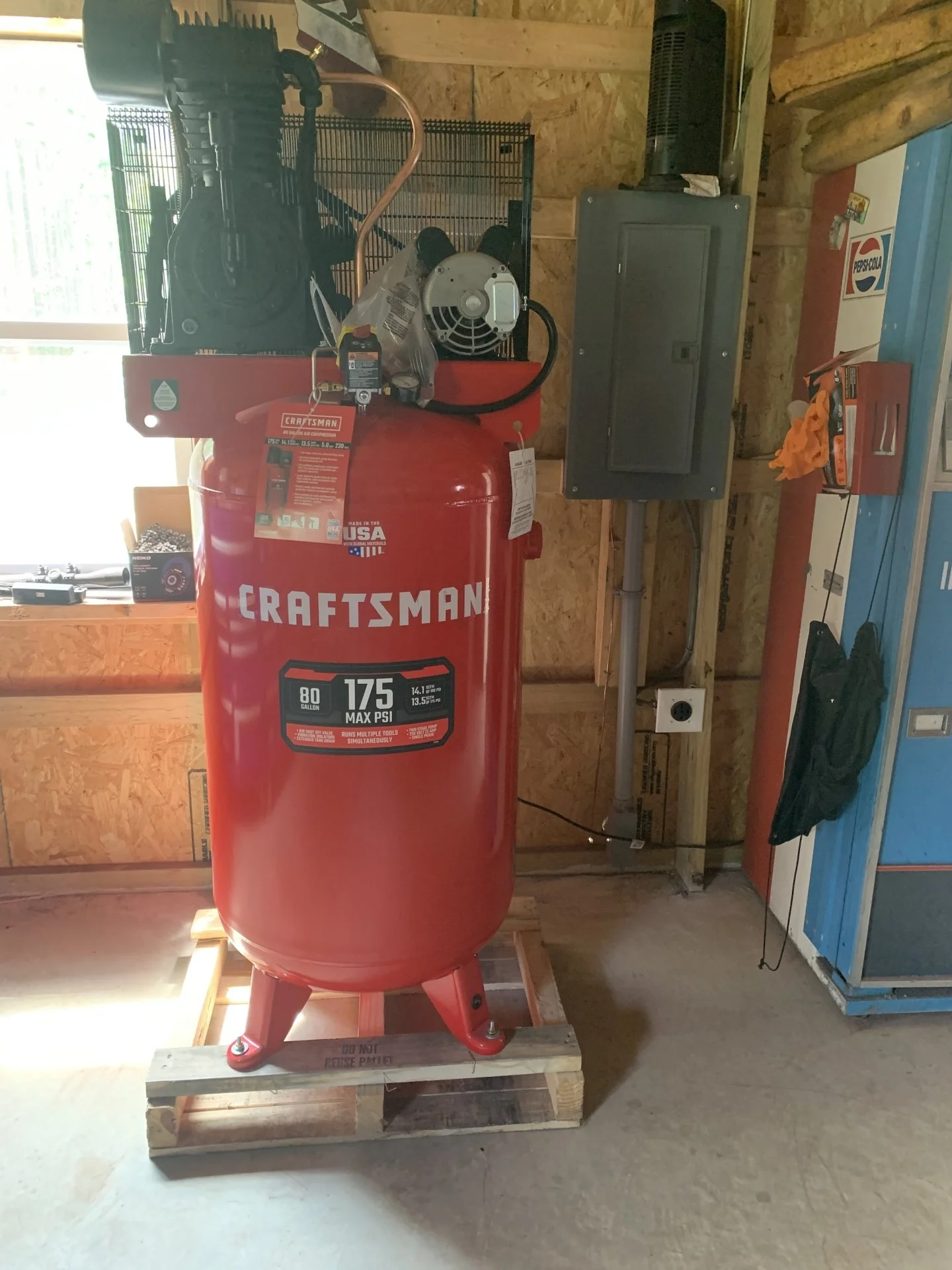

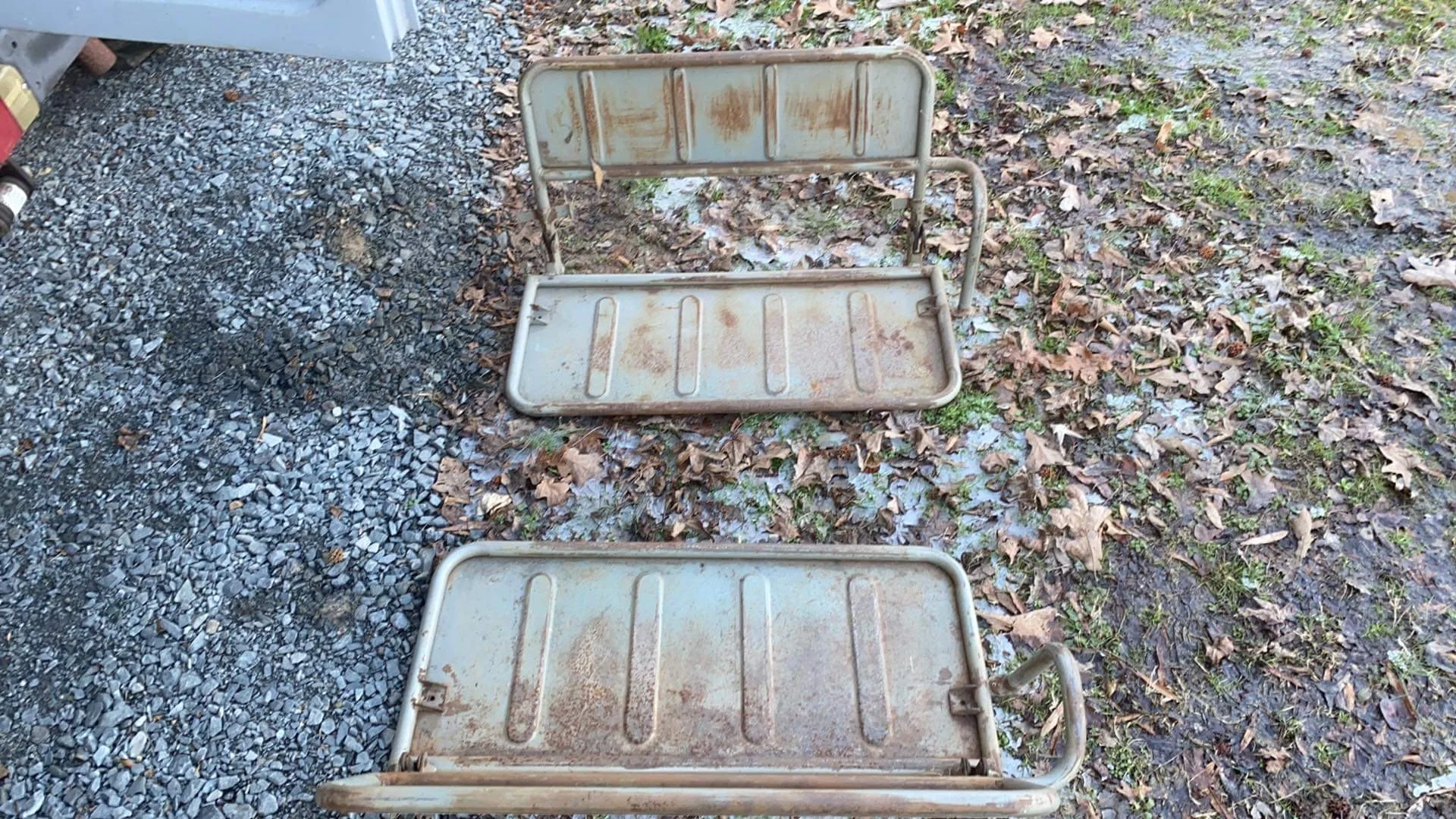

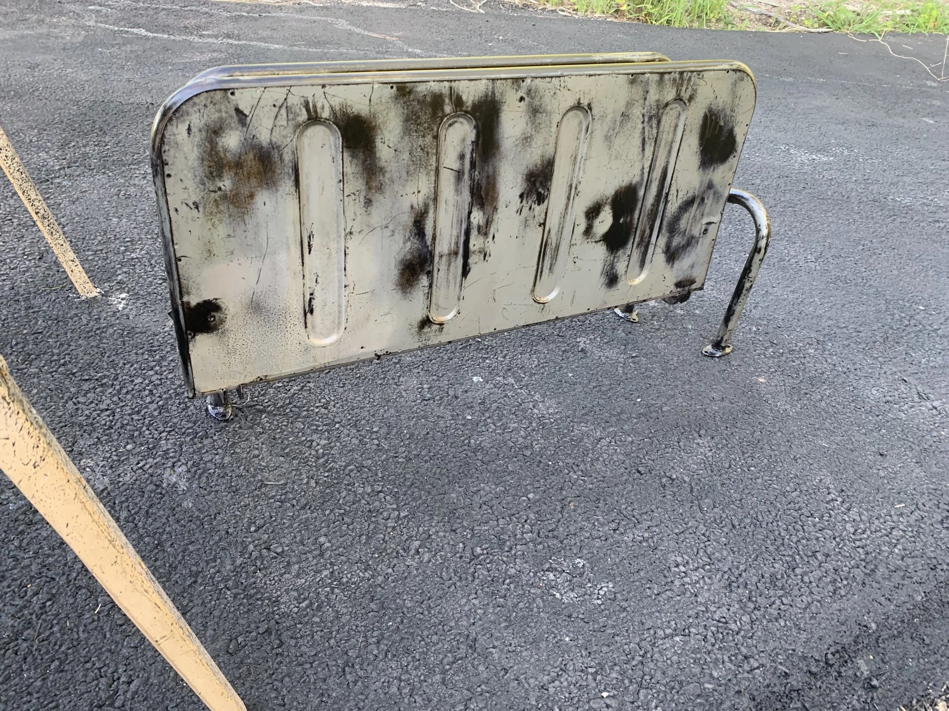

I was going to paint these long jump seats, but after hitting them with some Corroseal rust converter they look pretty good. Going to rub some penetrol on them and put the new foam and coral covers over them. Also picked up a cheap air compressor as my other one died a slow and painful death.

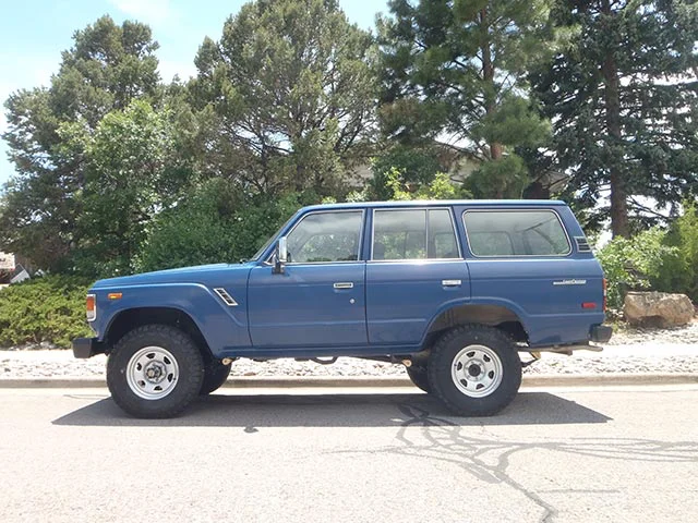

Swapped my leafs from front to rear and rear to front. Cruiser had a bad squat when purchased from PO. Leafs were on wrong ends. Looks appropriate now. Still need to flip shackles however I couldn't because driver front shackle bolt is welded to the inner shackle plate because it's to close to the power steering box to get a nut on the backside. No worries I'm planning shackle reversal or at minimum different shackles period. I like the HFS from ccot but would probably have the same clearance issue without shackles reversal. Either way it's much more level now. Has any one else ever seen this or have any other ideas. I was thinking a thinner nut might clear.
I would remount the steering box up a half inch or so and correct the suspension. Looks like lazy work and planning from the OP.
