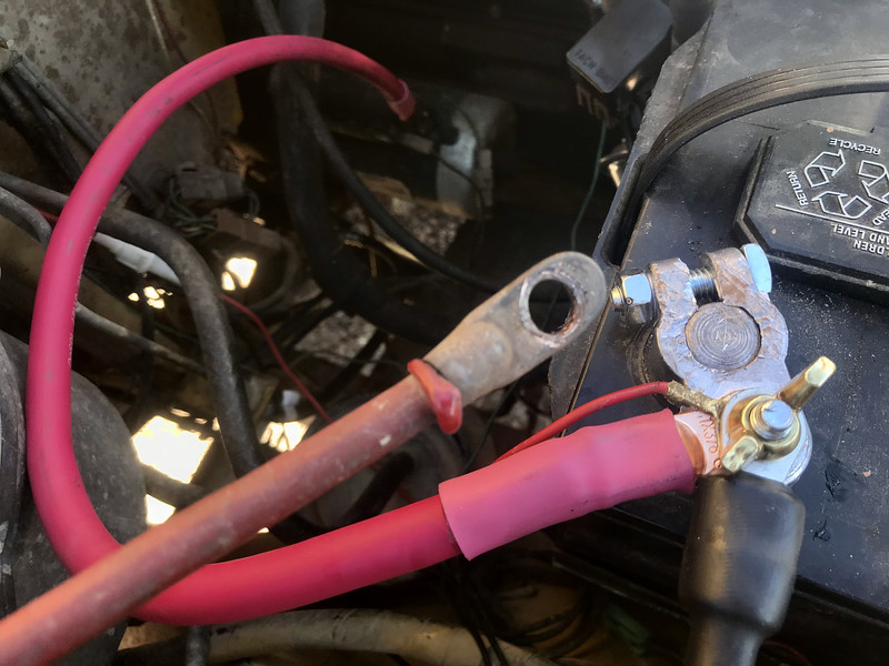

I just replaced the the old positive and negative cables w some new, heavier gauge ones. Cleaned the ground really well, and cleaned all the crud off the starter post...turns over a helluva lot faster now; we'll see how it does in the cold Flagstaff morning.
