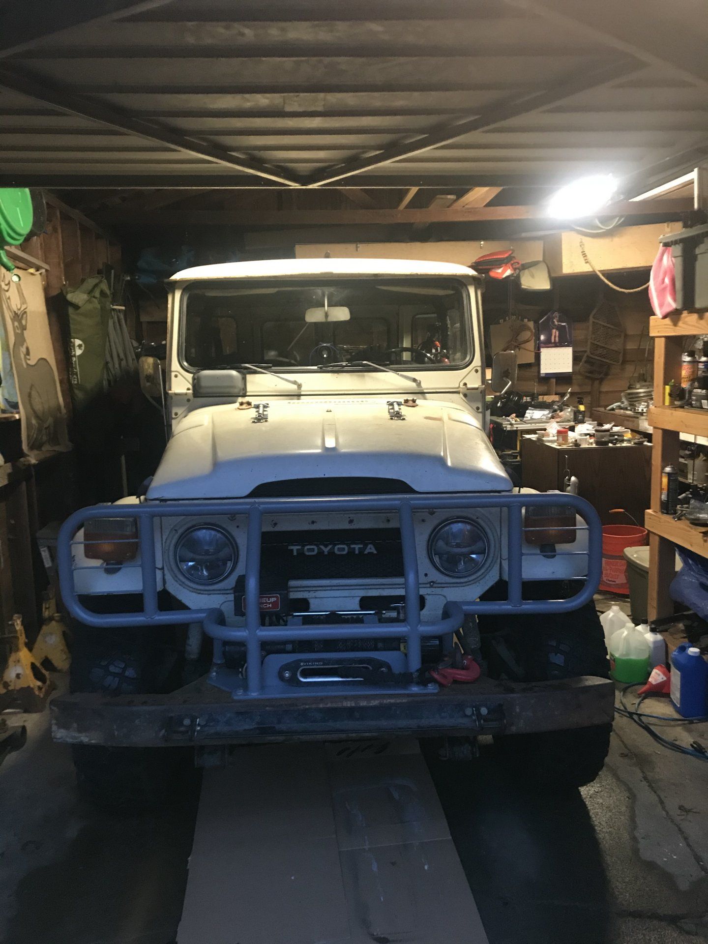

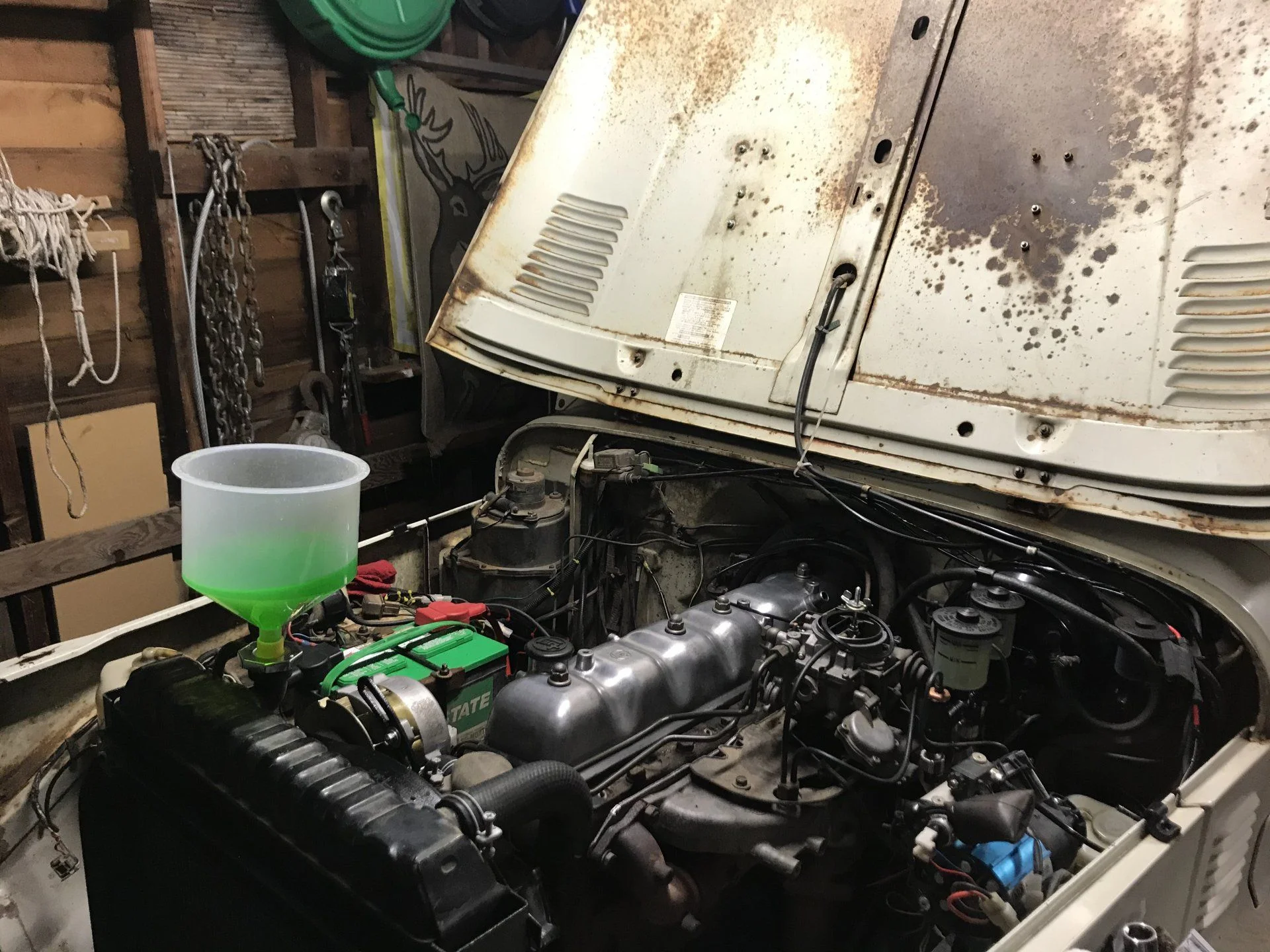

Another day, another step forward. Filled with oil, new filter and plugs. Added coolant. Overheated the thing for a minute, damn air trapped in the block. So I removed the thermo sensor and let the air escape. Kept the spill proof funnel filled, and let it run for awhile. Based on my calculations, should be topped off or very close to it.
In the morning I will install the radiator cap, get it hot and under pressure, check for leaks, then replace the air intake, grill and bib.
Plan on taking sometime off next week to go fishing. Would love to have the Forty on that trip, fingers crossed!

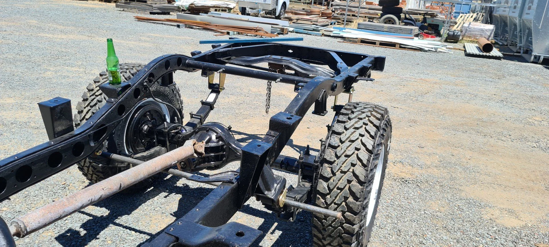

New springs, bushings, pins, shackles and 4plus U-Bolt flip kit. Was very happy with myself until I realised I'd put the bottom plates on backwards 🙄 guess she's coming apart again

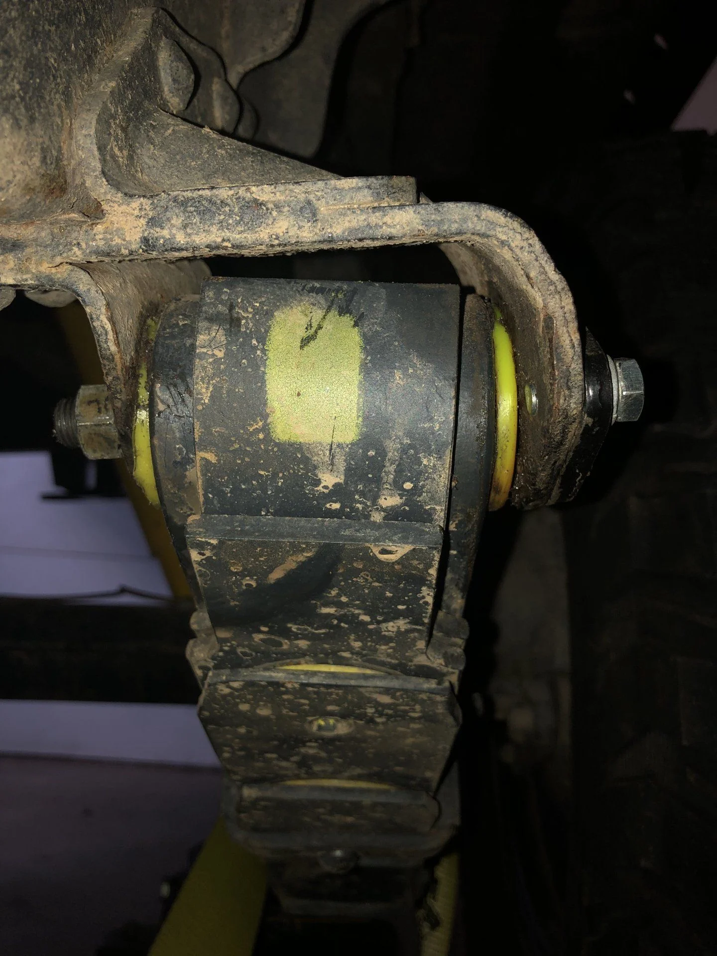

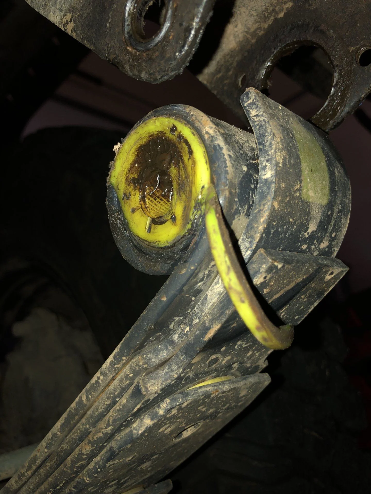

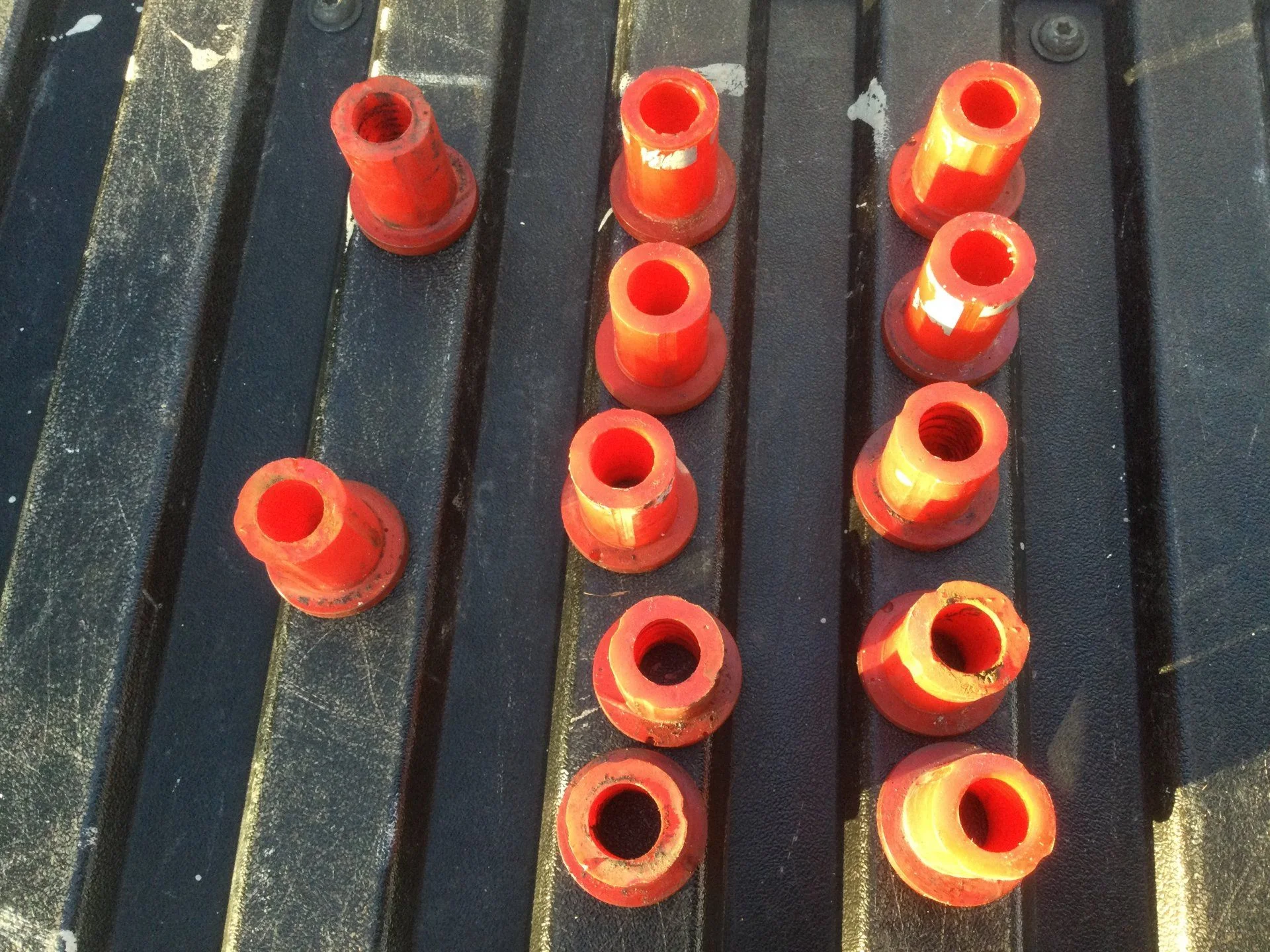

Replaced the front spring bushings today. Took 5-6 hours. Not fun. Here’s a photo of the bushings I removed. I am not at all sure they needed to be replaced. Some of the clunking in the front end is better. Will tackle the rear another time.

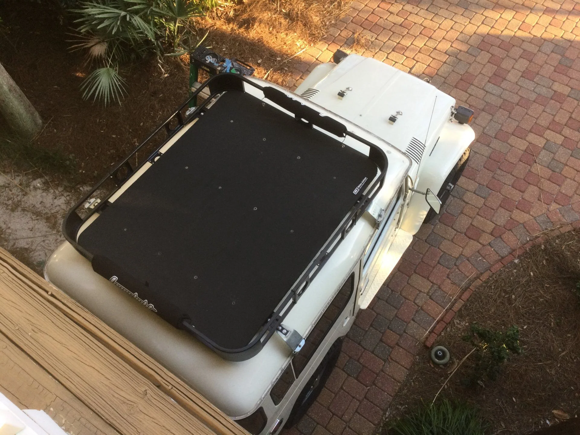

Then installed the platform onto my confer roof rack. It’s ready for camping gear. Checked the mail to find the new Toyota trails magazine. I am going to enjoy an adult beverage and do some reading.

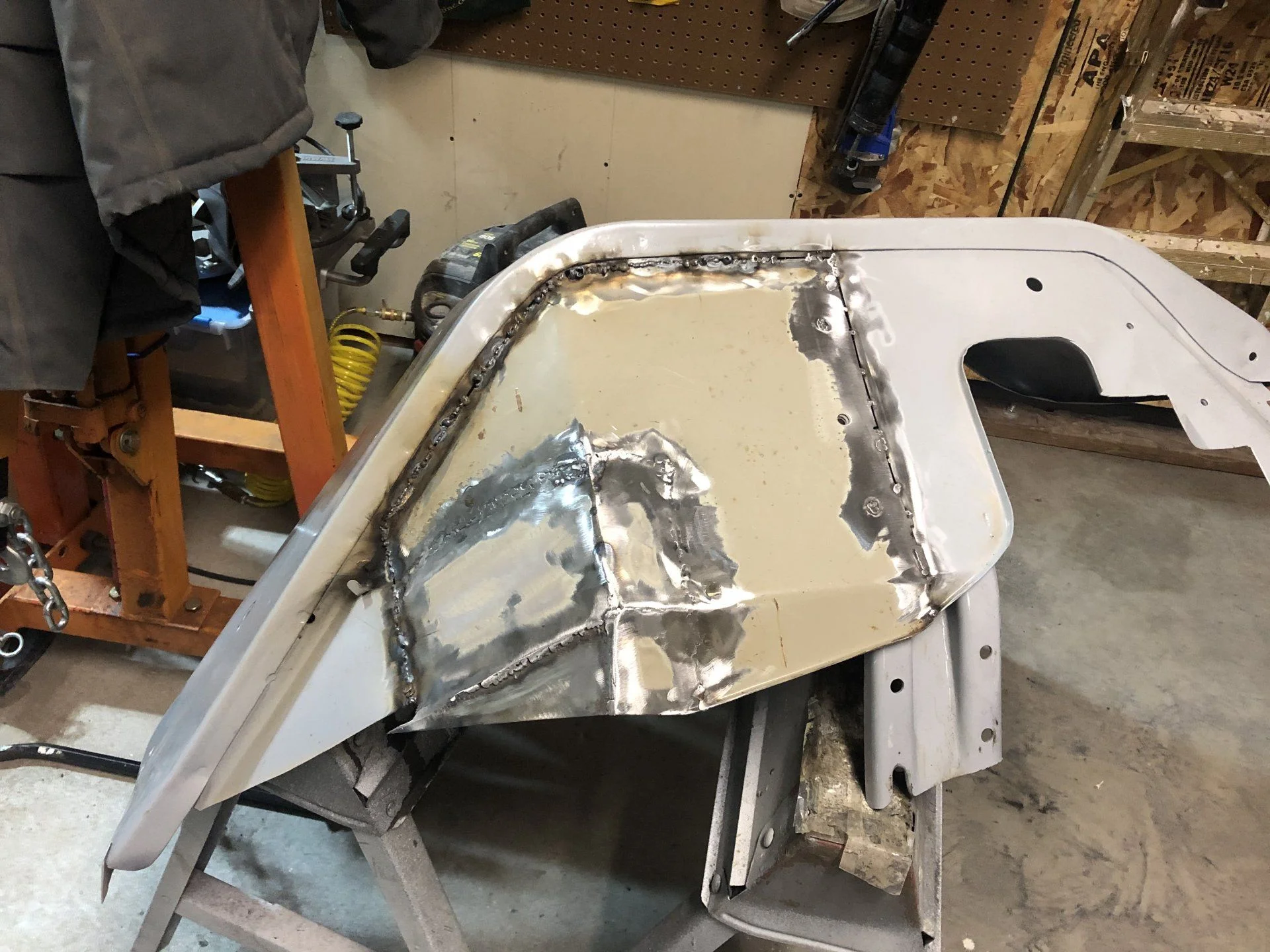

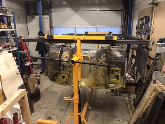

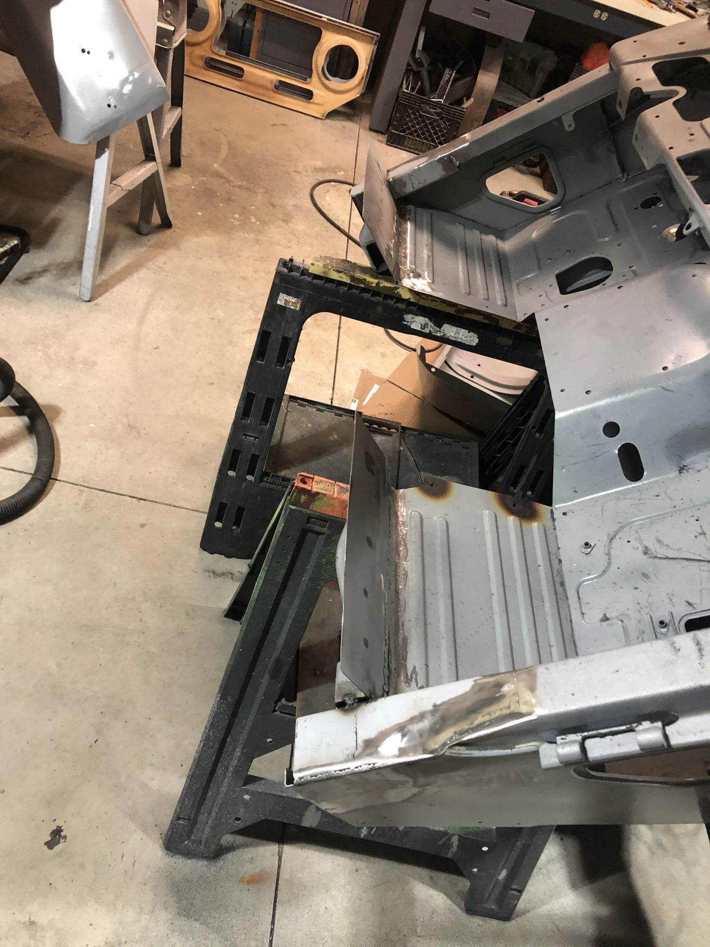

Rust repair continues- new lower A pillars, floorboards and outside patches are in place. This was a New England rig, so I consider the cancer to be moderate. Even so, I’m replacing the rear tub with an Aqualu 3/4 tub, so that’s what stubby floorboards and elongated A pillars will mount to. While I had them open, I slathered the body mount channels with POR15 and weld thru primer on the attachment areas.
Here’s the moderately finished driver fender. I’ve swapped to an Fj80 steering box, so the old opening was no longer needed. It was also making contact with the tire, so at least that won’t be a place to catch anymore.

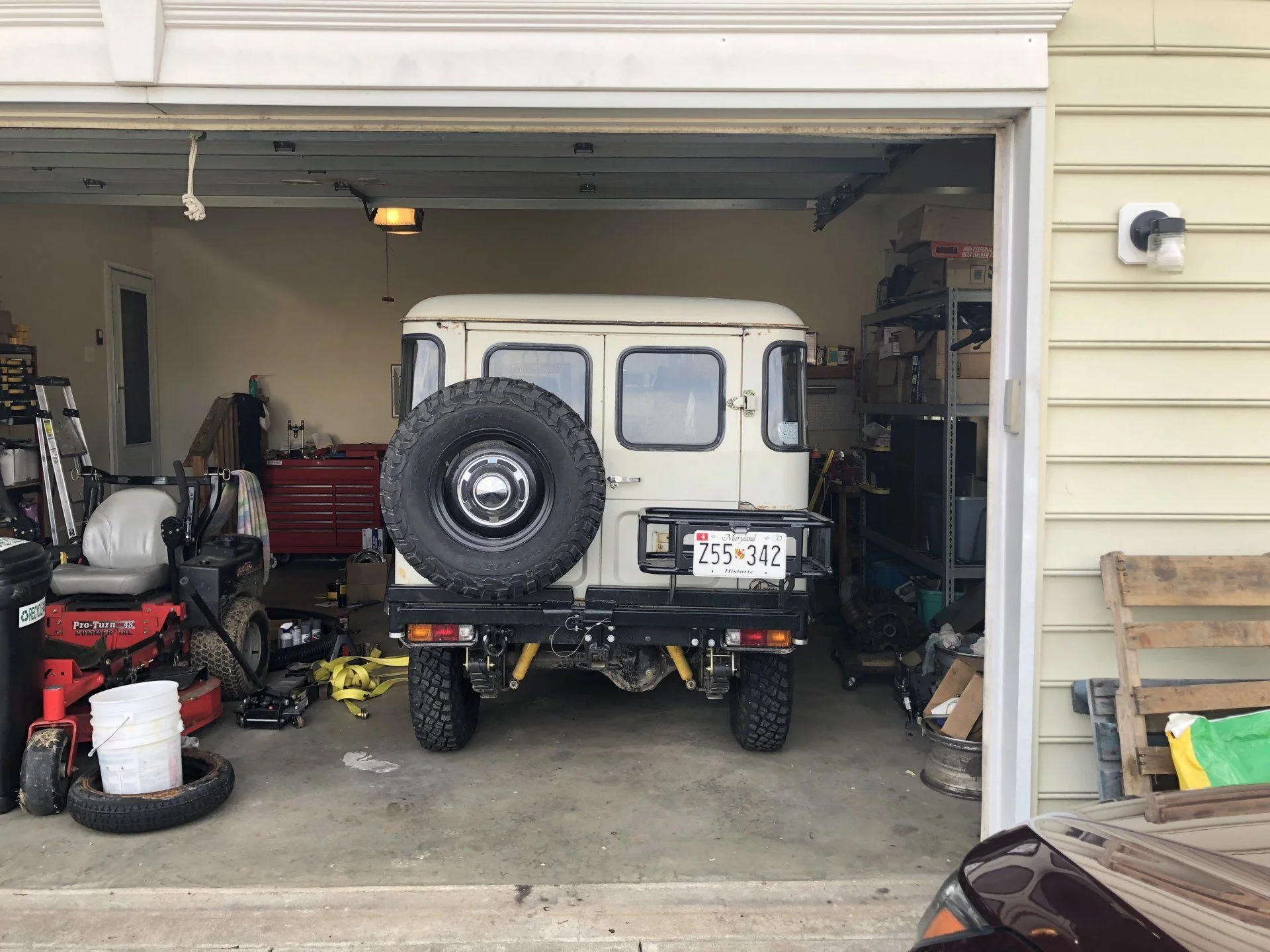

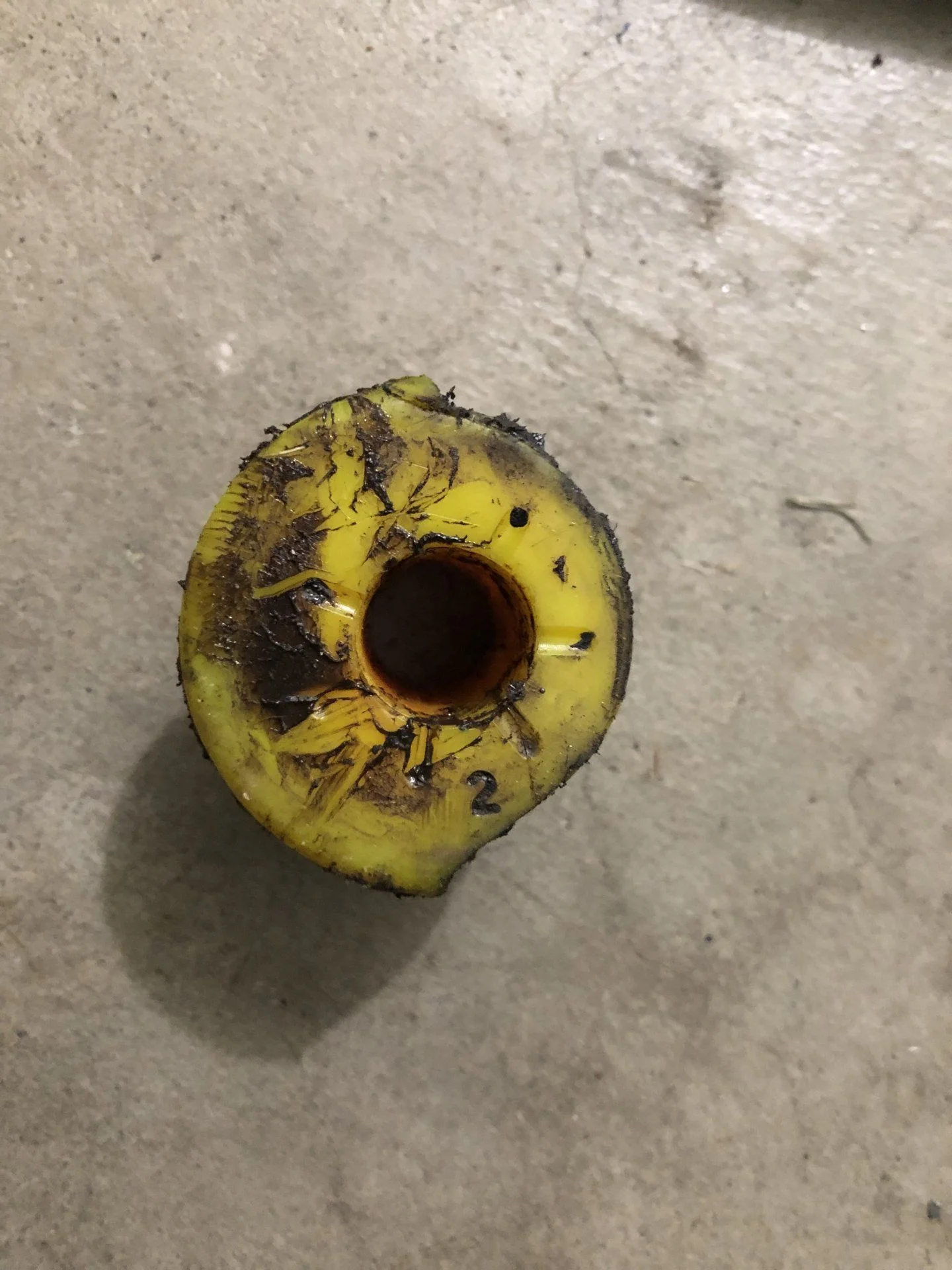

Replaced the spring bushing that I blew wheeling I’m thinking I’d overtightened it.
but I might still need to loosen the U-bolts and try nudging things a little - the spring seems “cockeyed” in the mount.
All told I was hoping maybe something was binding up and fixing this would address my cruiser’s gangster lean, but no luck...it’s still leaning about an inch to the passenger side.
I’ve always heard cruiser lean was to the driver’s side. Would love to hear some opinions as to why mine is tilted right. I could always put in a leveler block bandaid on the high side but I’m trying to rule out there isn’t something else up before I go that route.
New shocks and springs, might still need to settle but I’ve had it offroad for a weekend and put about 500 road miles on it. Almost exactly an inch low on passenger side.
