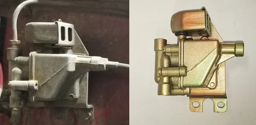

Refinished the transfer change valve.
Was there a reason you bent that particular line that way?
Or were you just showing off?
Great work tho!!

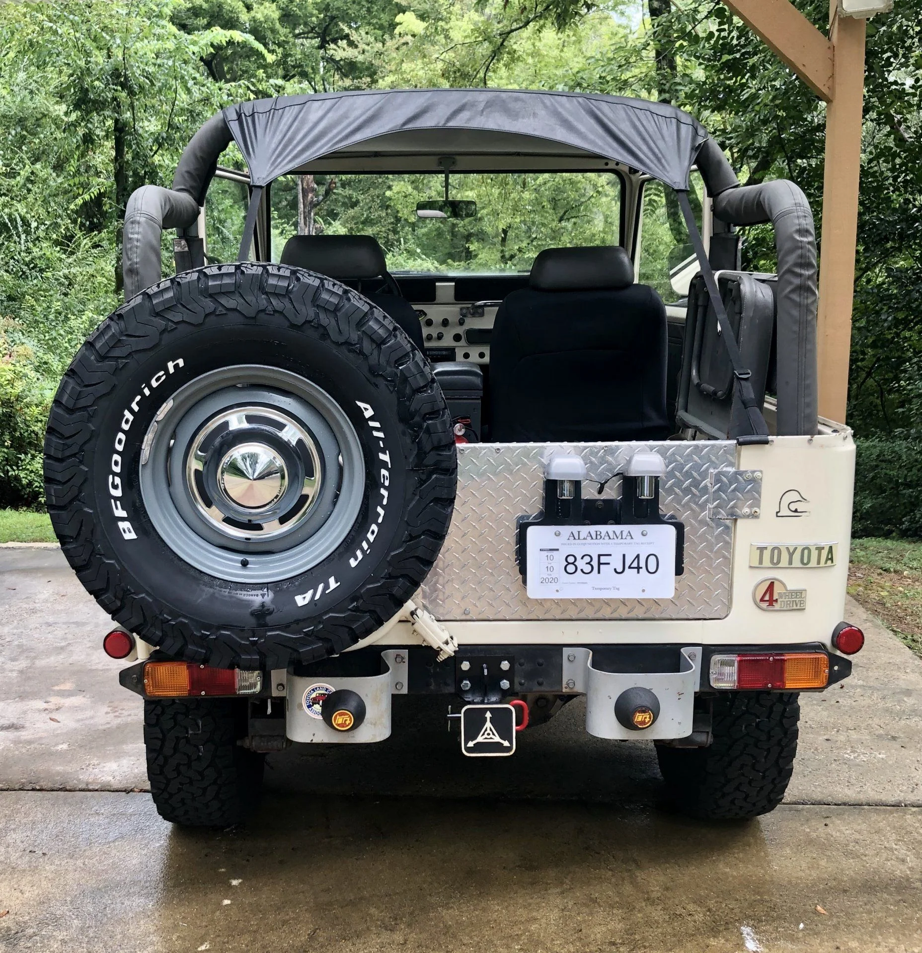

I installed 2 degree shins under the front axle. I restored a 68 FJ40 2 years ago and reused a skyjacker 2” lift I had bought for the rig in 98. I didn’t have the death wobble, but the steering wouldn’t return the center. After I finished the restoration, I had the alignment checked and the caster was at 0 degrees. Since I had a Saginaw box I figure 2 degrees wouldn’t hurt. Spent 8 hours getting the shims in and after driving it, maybe a slight improvement over 55, but nothing dramatic.
The shims were steel from WFO products and were milled to accept the spring center bolts. Also replaced the spring center bolts with ATS bolts with a 1/4” extension.

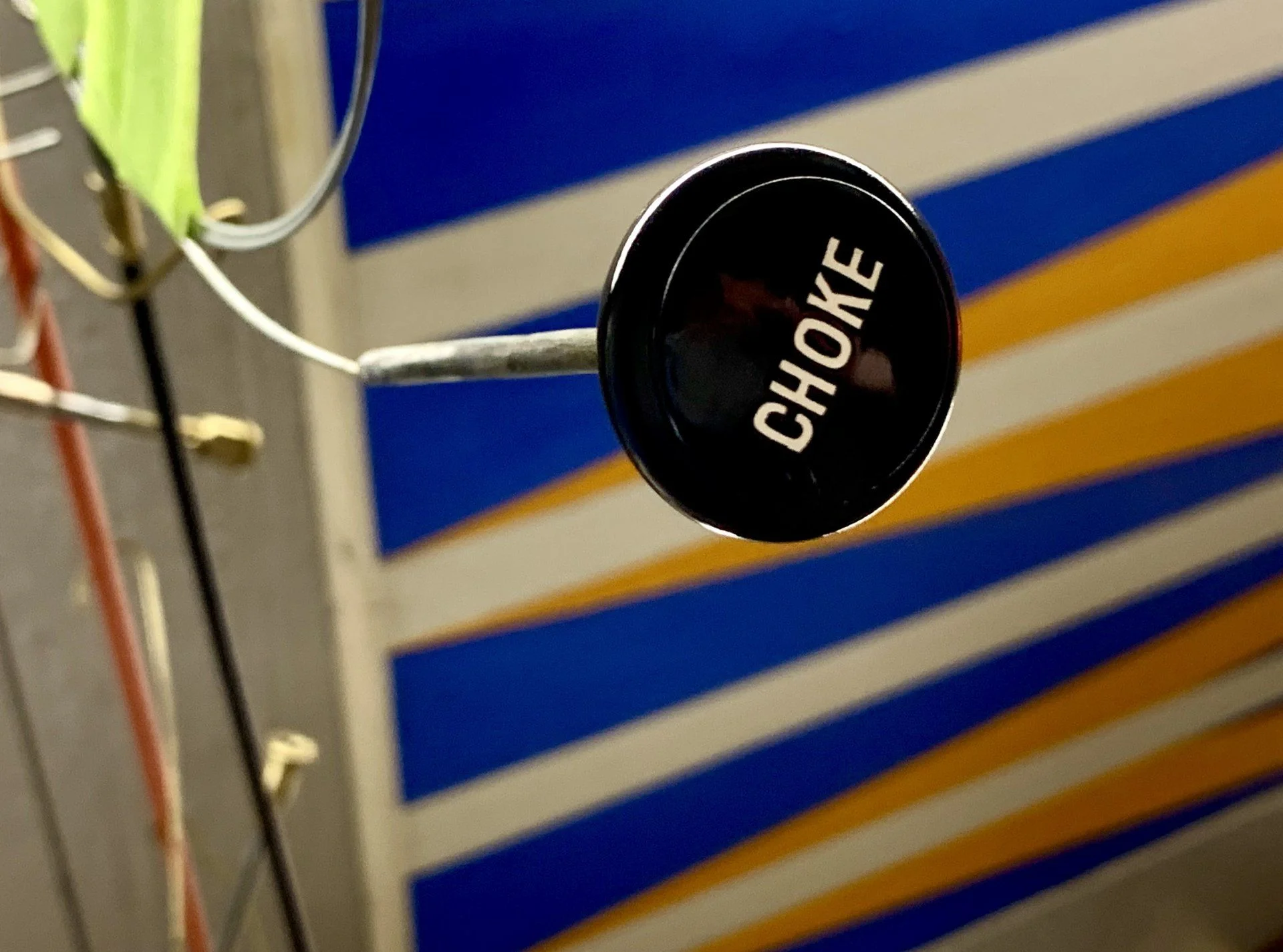

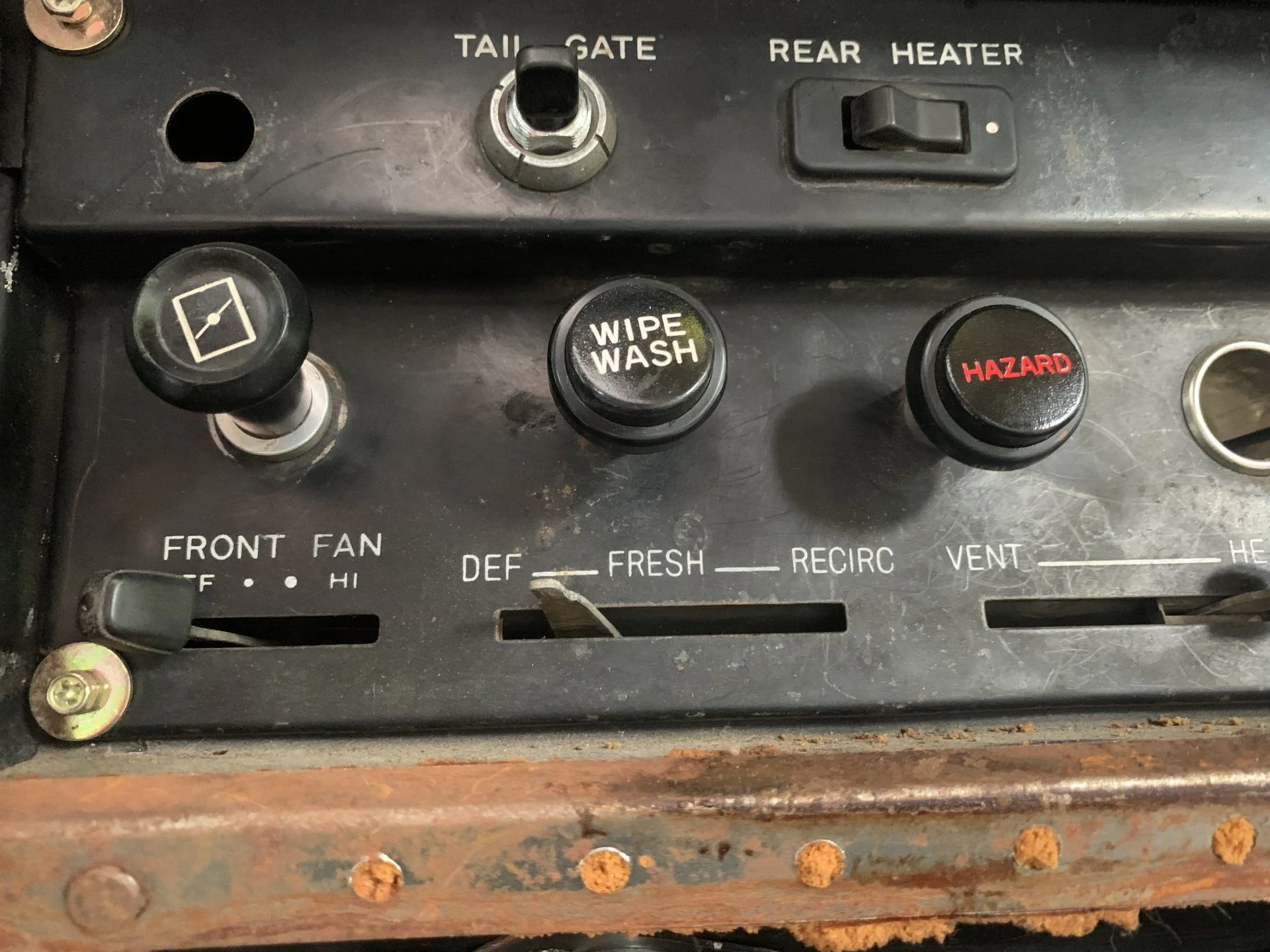

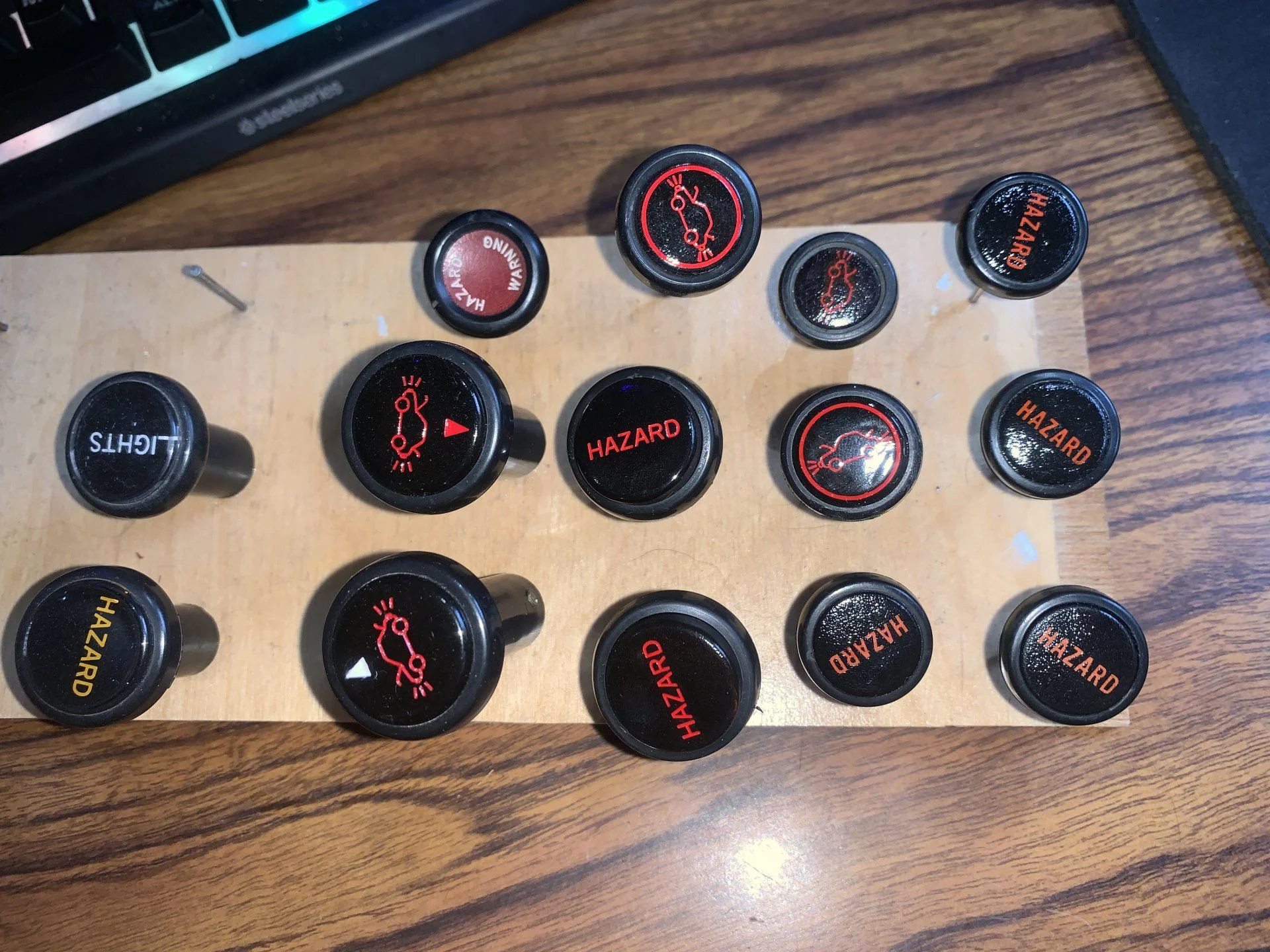

Using a newly sourced white and red pigment product recommended by my special friend and consultant at the Baltimore visionary Art museum , has made
Things ........?
Well better :)
There is nothing “ better “ of a feeling inside when I take. a 31 year old original land cruiser pull switch knob or control cable knob and make it simply “ alive again “ to and for its future home and owner operator to use , enjoy , and serve for the foreseeable future and future generations of land cruisers owners and drivers to be ,
