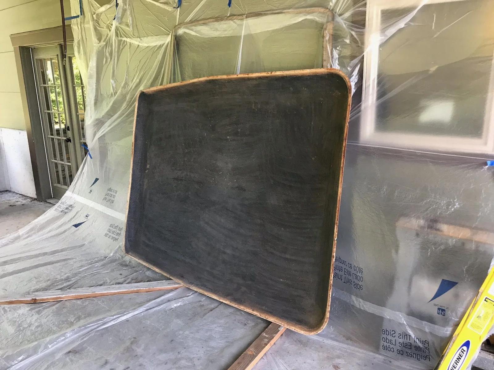

Hardtop disassembled and cap over to @cjmoon for a refresh.

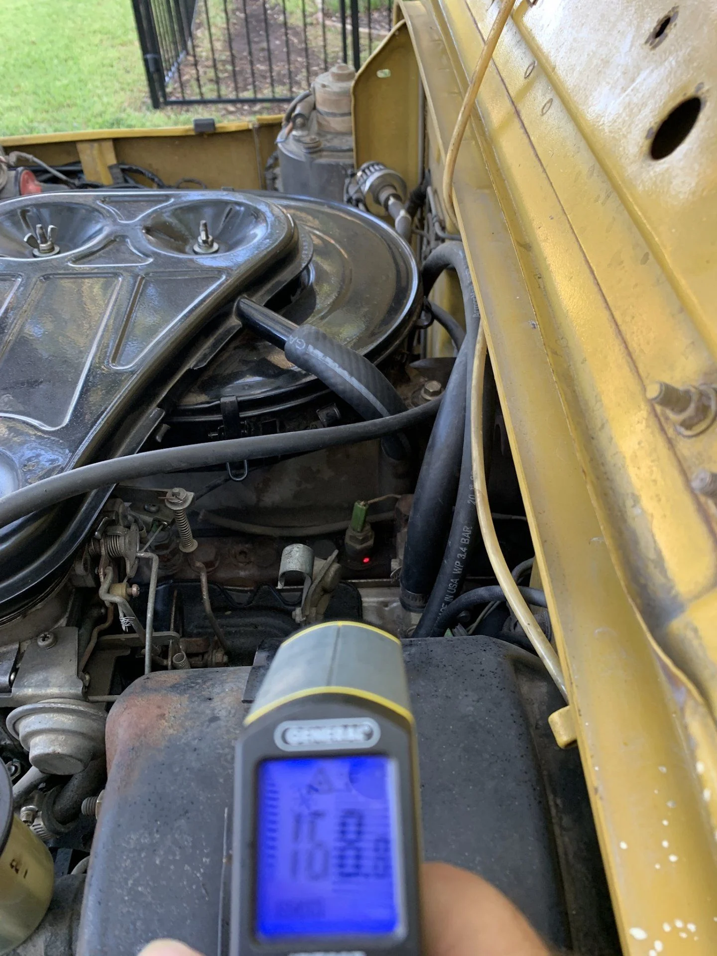

It’s been hot down here in Texas and unfortunately my 40 started running hot as well. Radiator is pretty new and I rebuilt the fan clutch a few years back so I decided to toss a new thermostat and gaskets in her. Top rubber gasket that I removed was pretty much toast. I also opened the drain plug to get a look at the coolant, all good there ... free-flowing and clean so I skipped the full flush. Parked her in the drive nose up and topped off the rad and started her up without the cap. Let it run and burp for 15 minutes or so, I was amazed how many time i needed to top it off. Once it was up to temp I grabbed the temp gun and took some shots for good measure, then buttoned her up and hit the highway to see if I could move the needle, but it never moved off the first mark. All good now.

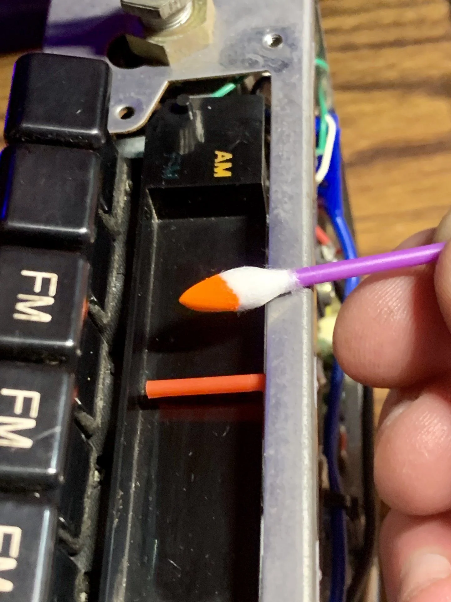

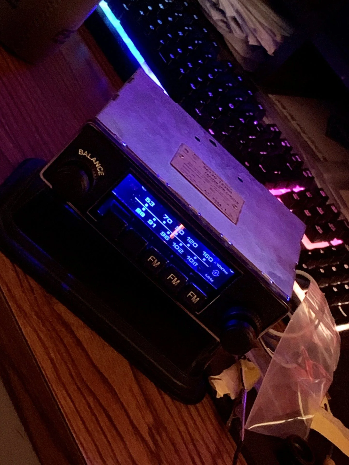

i replaces the burnt out incandescent fulfillment bulb with a LED one , original had BLUE rubber cap on it , OEM Blue ,
i was thinking of his and hers Dueling LED bulbs for balance and Popper LUMENS Tone etc ........
the results left me in
Total BLISS ........................! :D

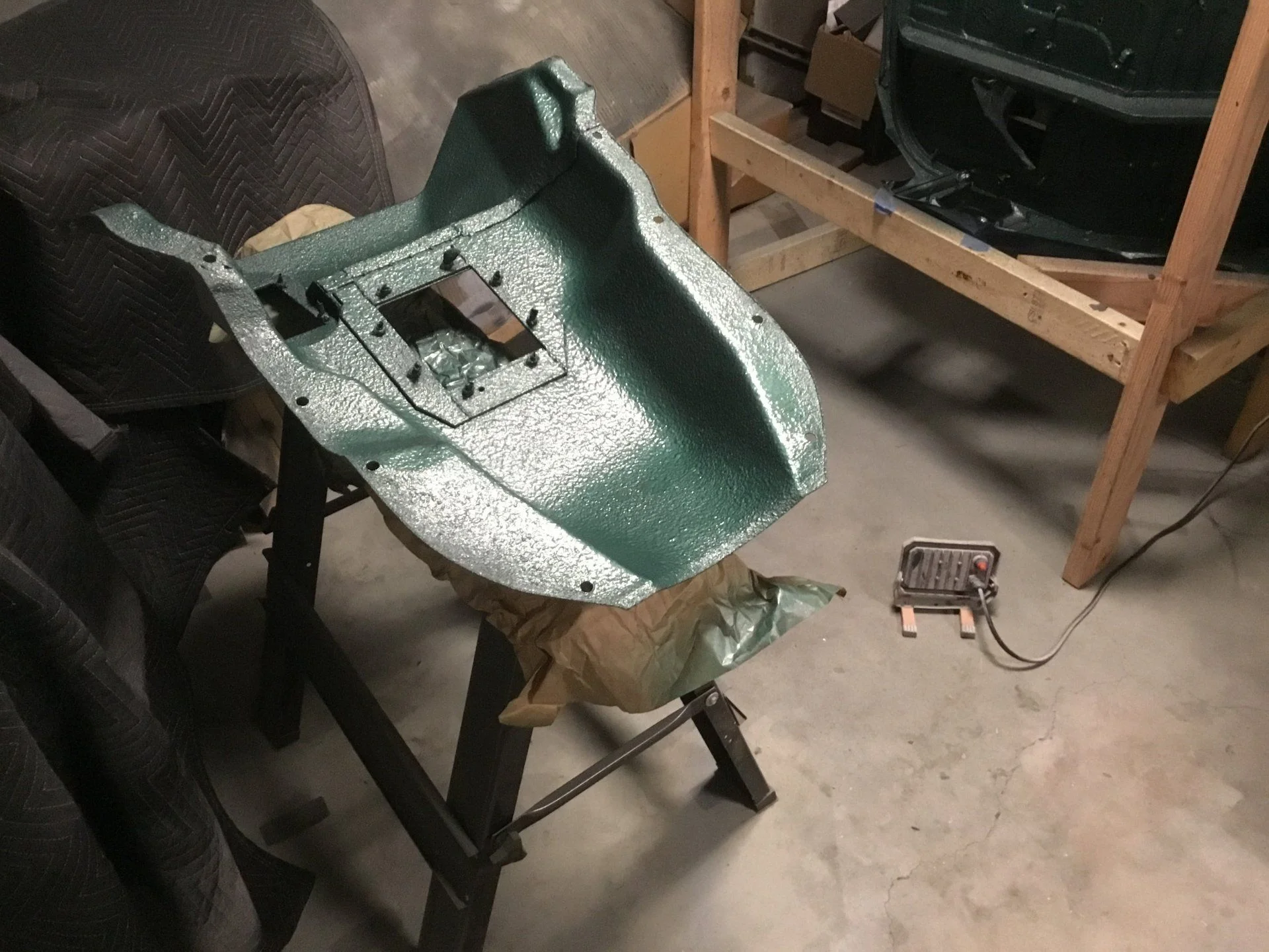

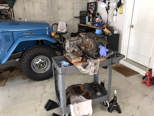

Started cleaning my new to me 12/79 4 speed with matching tcase. Removed shift assembly using a simple piece of wood. Looking forward to shining this up and installing so I can use my 3 speed as a mooring In Nantucket Sound.
