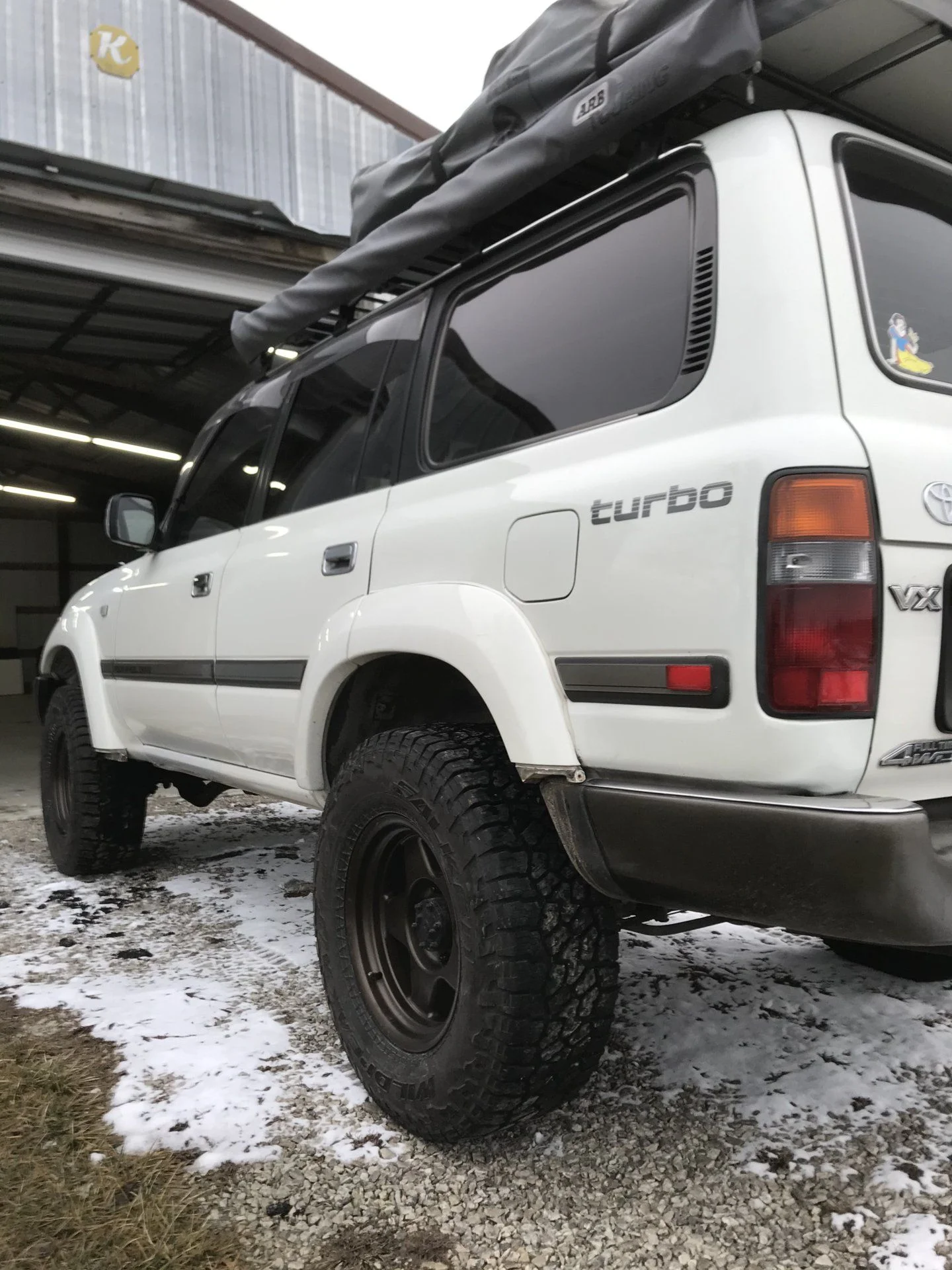

Picked up a set of 285.70/17 Falken Wildpeak's from a new Gladiator, installed on some SCS F5's. Removed the mud flaps, running boards, trailer light socket and 30' of random wires. Installed OEM Turbo decals.

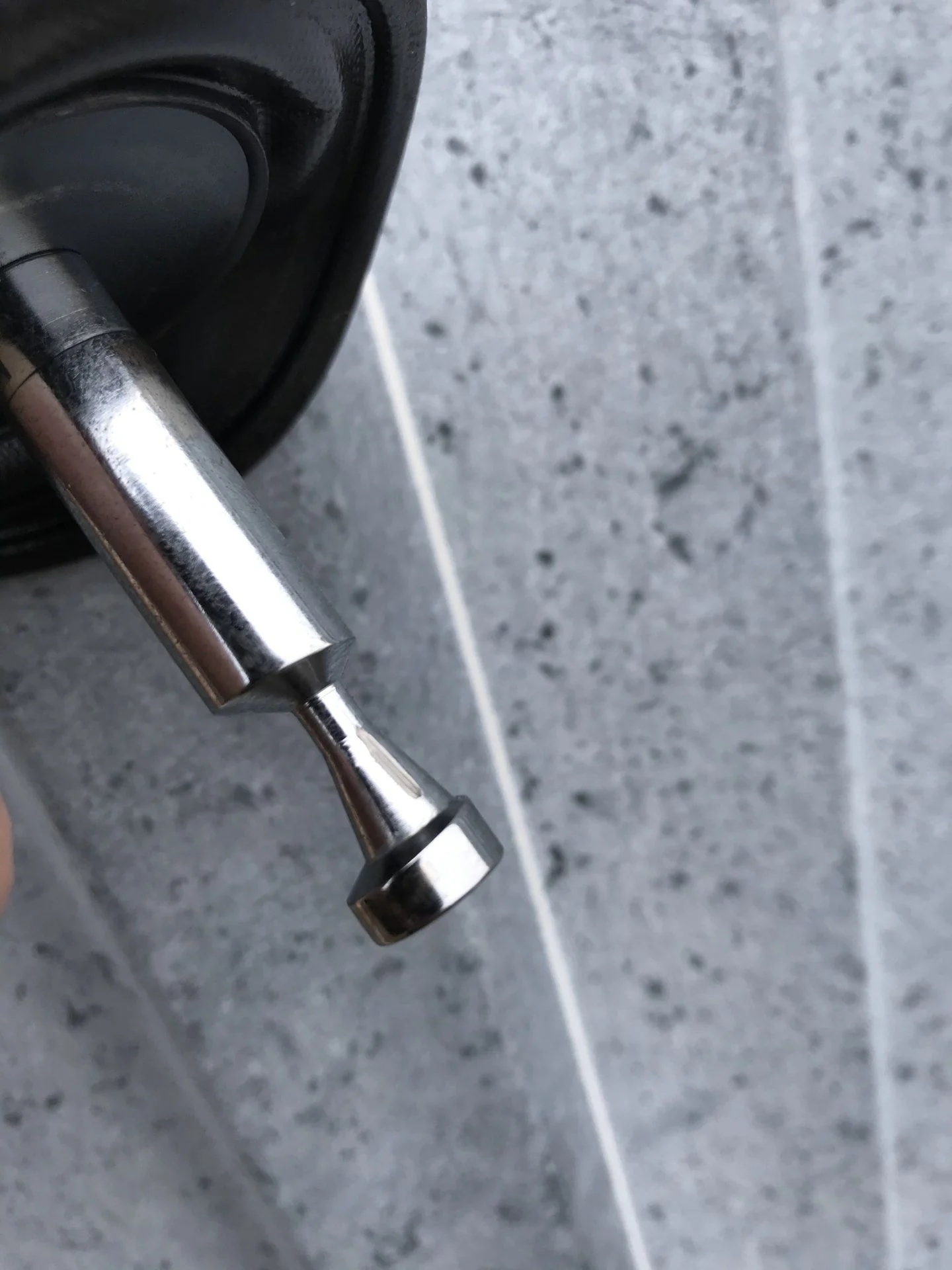

Got the pyrometer functioning finally. Today, I started a little tuning -- had to remove the anti-tamper collar on the fuel screw. So I removed the collar and turned the fuel screw in a about a full turn. Adjusted boost to about 28psi. The boost compensator pin was oriented so the follower would ride on the side with the least aggressive ramp. The pin is not OEM, so someone has messed with it at some point. So I re-oriented the boost pin to have the follower ride the most aggressive side of the ramp to minimize smoke. I still have a bunch of fine tuning to do but MAN, this thing woke up! I had tire chirp when it shifted into second o_O

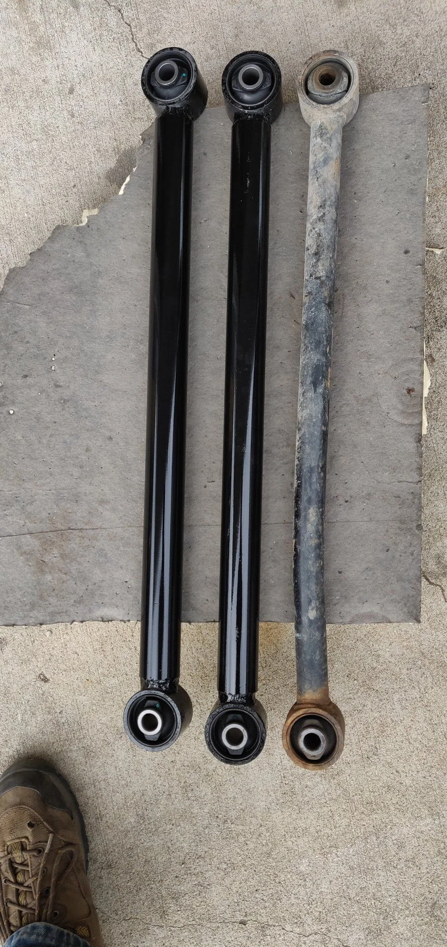

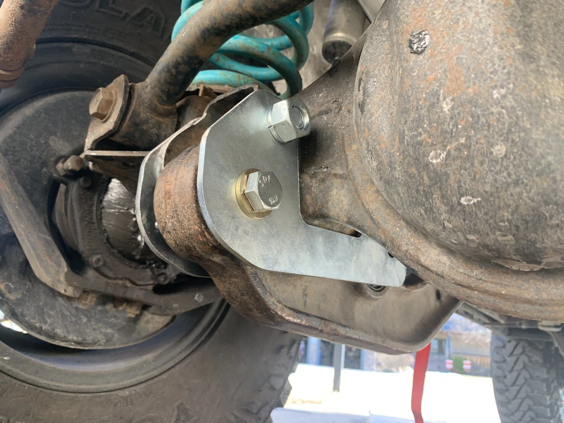

Castor correction done

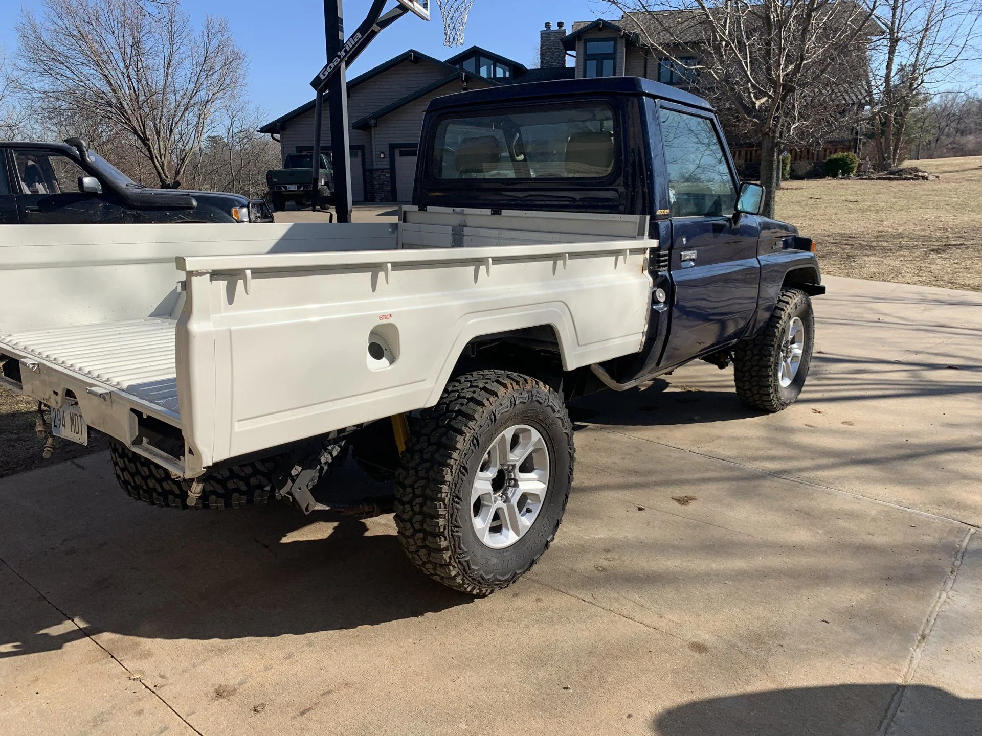

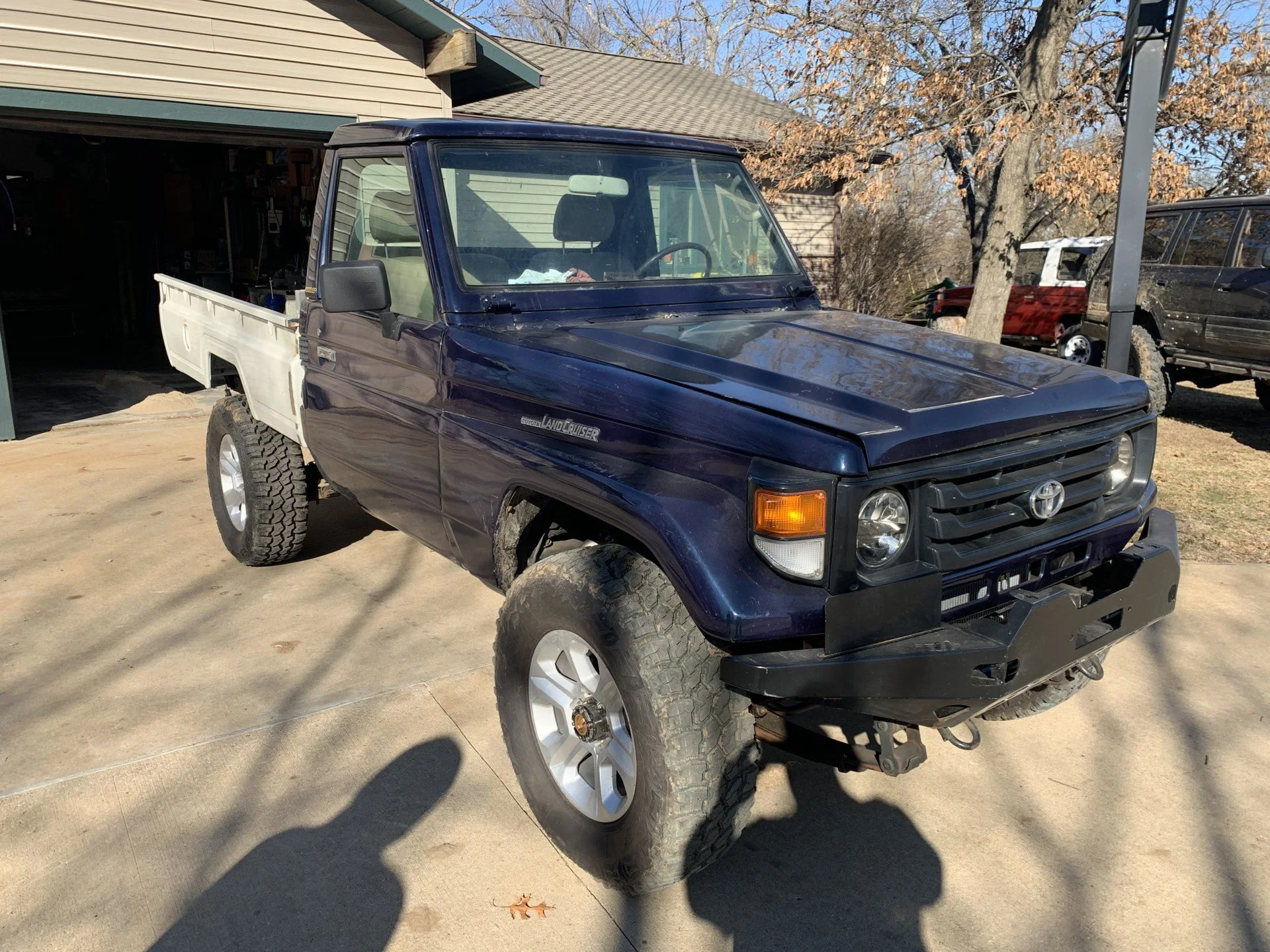

Drove my 75 series after the conversion to fuel injected and fully rebuilt 1fz. In fact the whole drive line is basically new..

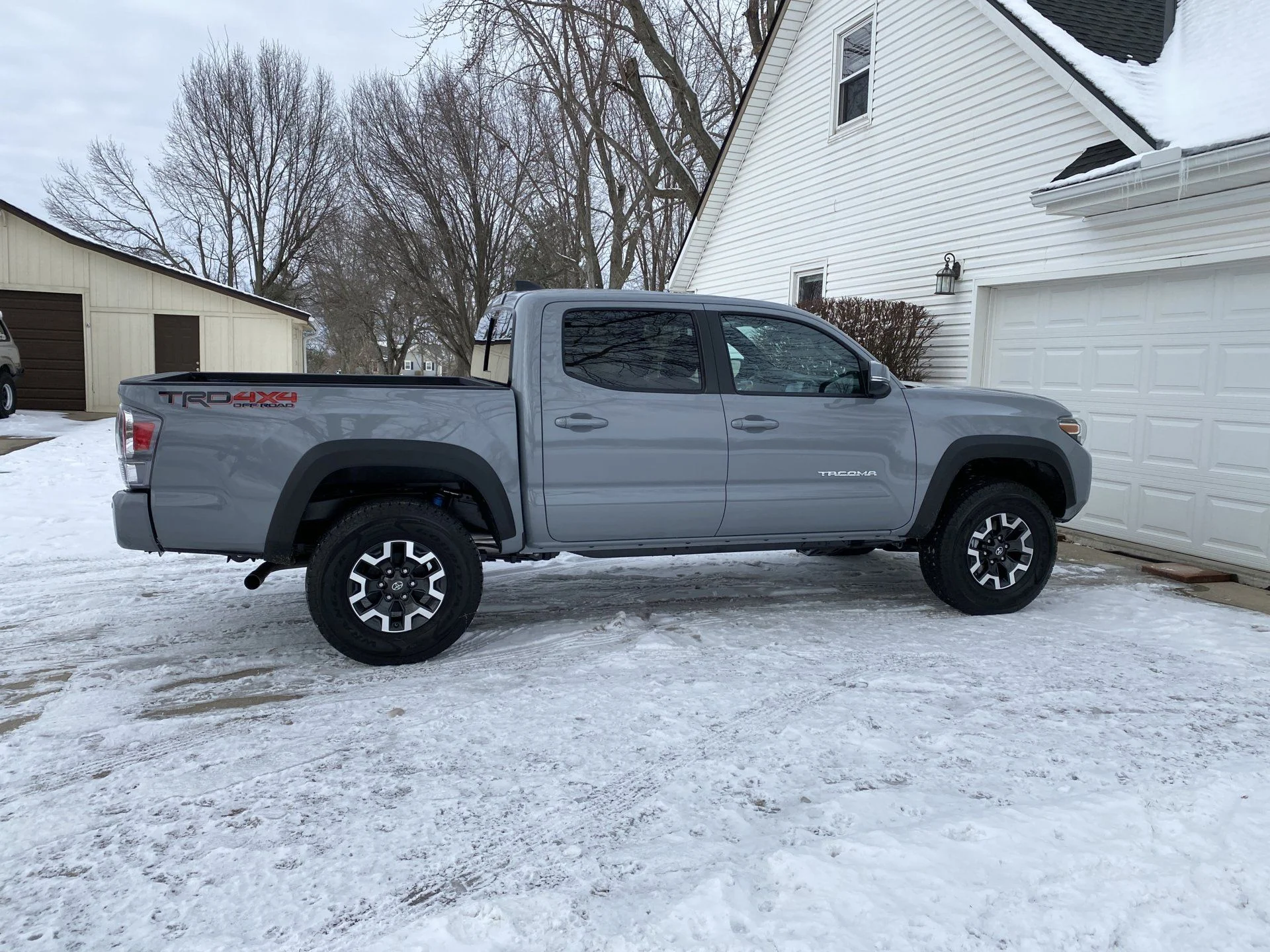

Bought a new one :oops:
2020 Tacoma TRD off Road
