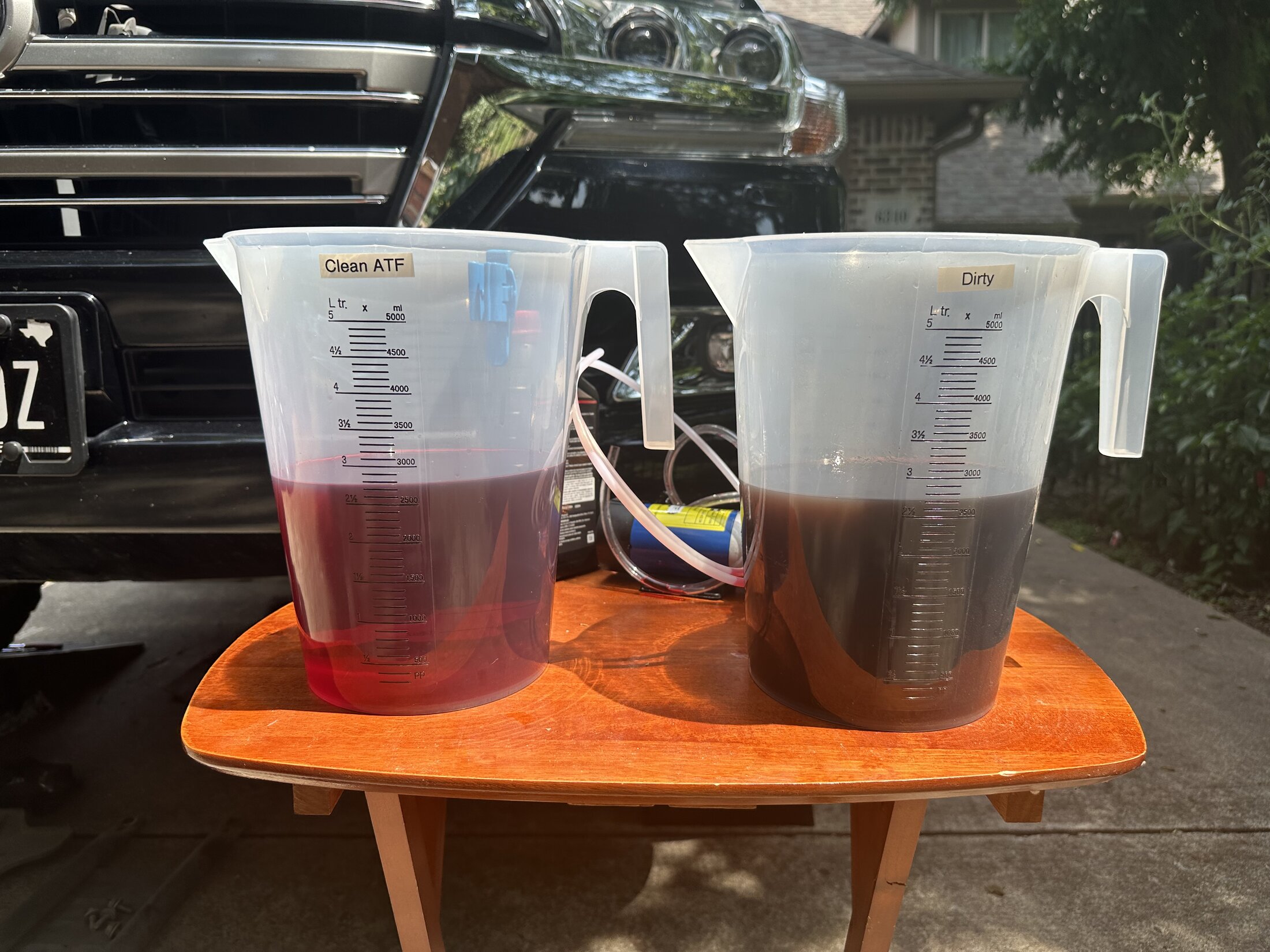

We had a “cold front” coming through this weekend (high of 92) so I knocked out the ATF exchange I’ve been putting off. Figured out the hard way that the return line is the bottom line on the 8-speed, not the top. Now I’m pressure washing my driveway.
You’re talking about right where the lines come off the transmission? Getting ready to tackle this - 117k on my 200.
Quoting myself on the transmission question - I went ahead and did a drain and fill - I’m too big to squeeze under on the ground so I jacked up the frame near the a-pillar about 8” on each side - when I pulled the drain plug I got almost 4 quarts - when I pulled the straw tube I ended up with just over 5.5 quarts drained; more than I anticipated. Does that sound right? Maybe I got a little more because of the angle the vehicle was at?
Yes I was talking about the lines coming out of the transmission. I got just under 3 qts out of my pan. Could’ve been the angle you had the truck but also I believe more fluid will settle into the pan the longer the truck sits. If yours isn’t a daily driver that might make sense.
I pushed/rolled it out of the garage cold to jack it up to leave it all settled.

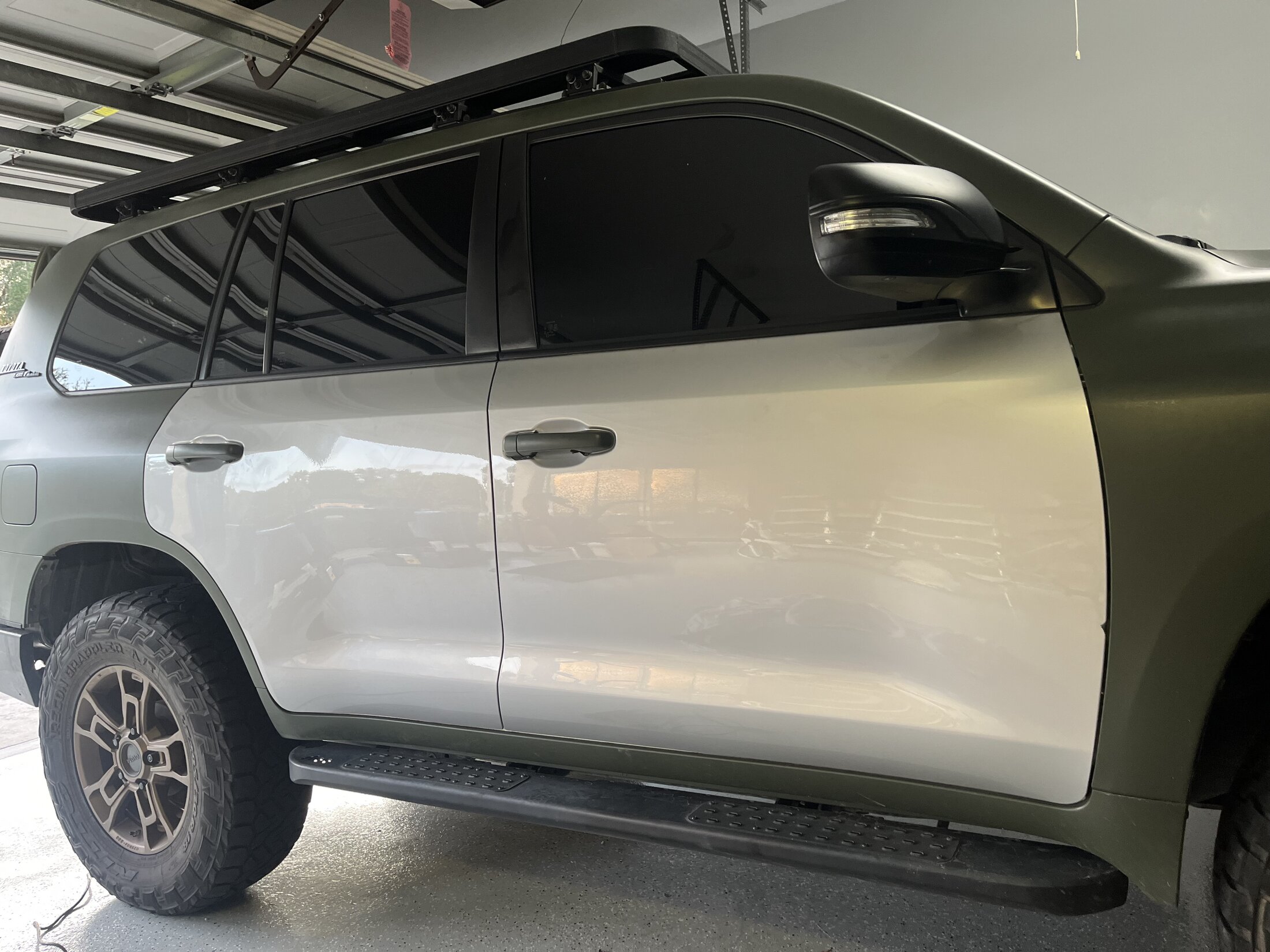

Well paint is perfect minus a few left over glue spots so it did what it was meant to do. But, my god this is a real pain to remove.
8 speed I assume. If sitting overnight, you’ll get about 3 qts from pulling both the drain plug and overflow tube. The angle you had must have led to the much larger amount. Might make it tricky to get the final fluid amount check correct. How about getting a set of 4 Rhino Ramps to get under the beast easily?

I am not sure if I will wrap it again or just ceramic coat it with paint protection film on the hood. I’m debating on putting the front bumper back on and doing the hidden winch. If I do that I will keep it silver.
I gotcha. If you go Hidden Winch route let me know. Ive got the Trail Tailor mount (MY 16+) still new in its box that i could sell you for cheaper than they have listed on their site.
