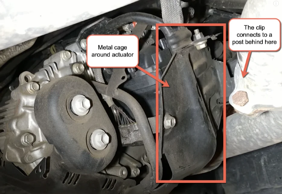

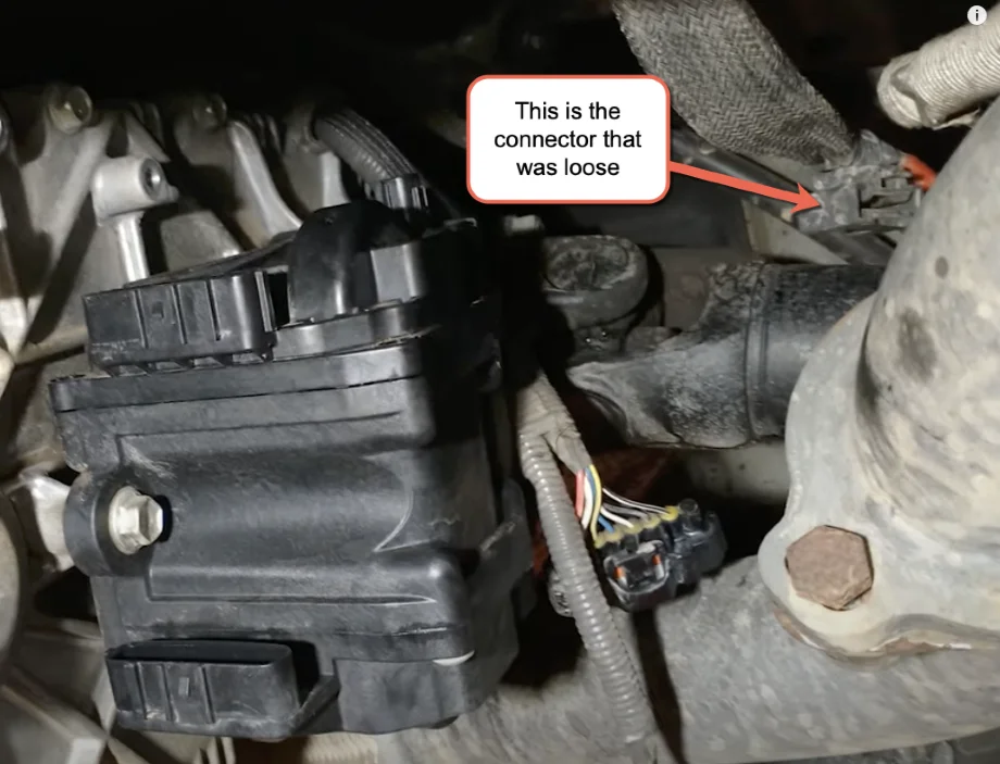

A few wins this week on the LX w/ ~165k miles:
  1. It seems I've salvaged my center diff lock capability. It hasn't worked consistently since I bought the car 3 years ago, and I stopped trying to engage it shortly after purchase. I was greasing the driveshaft zerks for the first time last week and noticed a wire clip had slipped from the mounting point on the center diff's protective metal cage.

    I don't know if this is part of the grounding wire, or simply there to keep the harness from bouncing around. Either way, it was dislodged when I was messing with the u joints. I've casually played with the center diff lock button since reconnecting the harness and it's working fine now. Does anybody know if this connector is part of grounding the accumulator? 4-Lo has always worked fine.

You just reminded me, I removed the grounding wire to installed my skids from @turbo8.
@turbo8 I do not think I reconnected my grounding wire after removing the OEM skid, where did you put it once you installed your skids?
Did you unbolt the grounding wire or unclip it from the factory tcase guard? It should just be left un-clipped.
