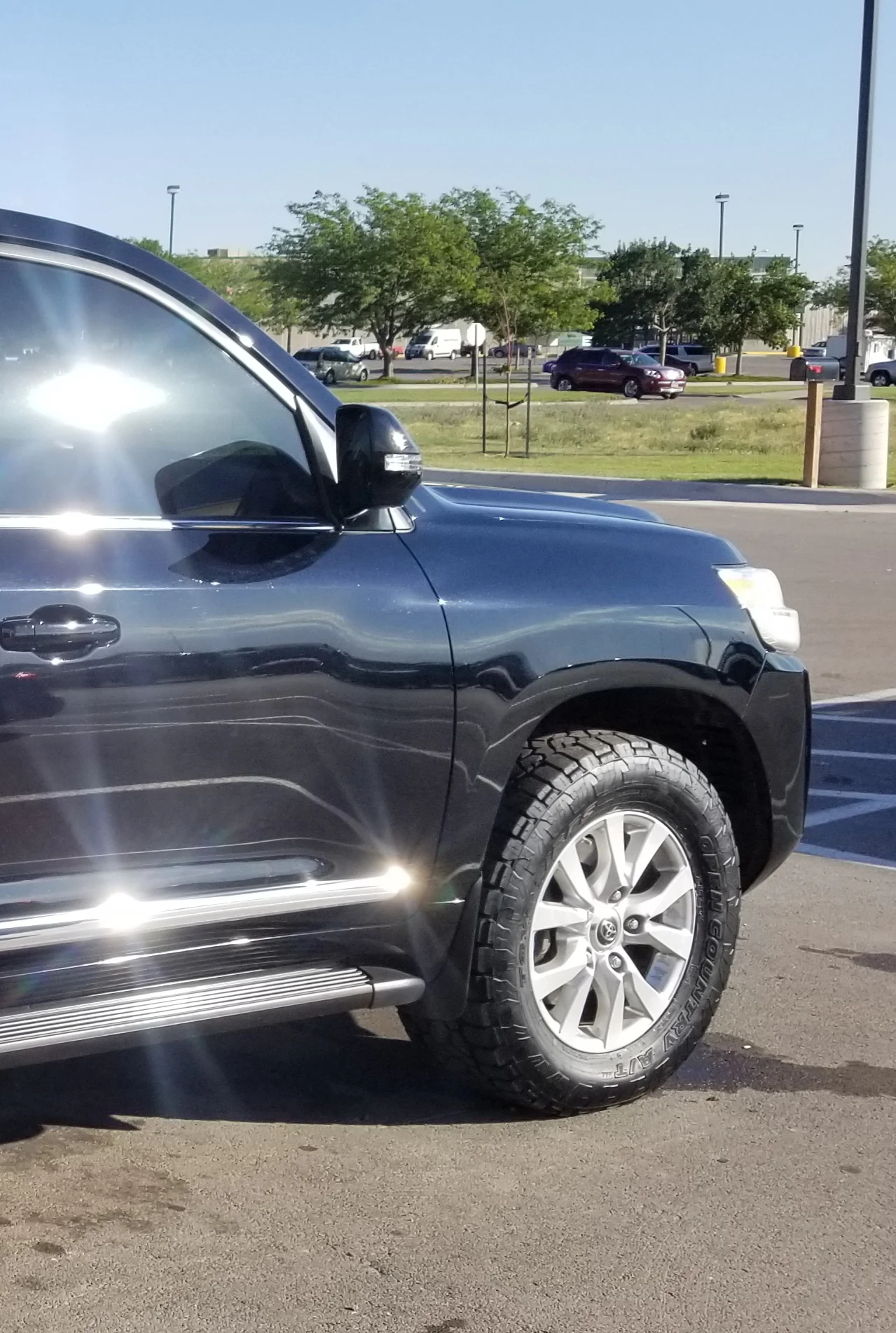

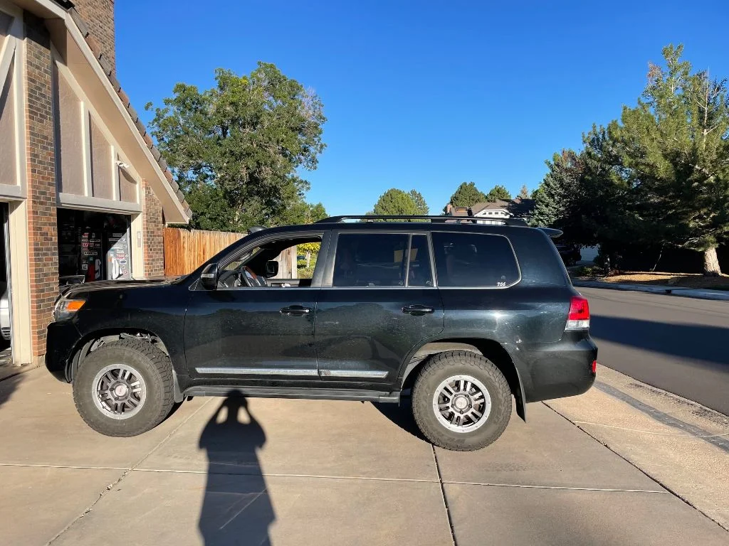

Installed Bilstein 6112/5160's, factory rear springs and the front struts on the lowest setting. About 1.5" lift on the front and 1/2" on the back.

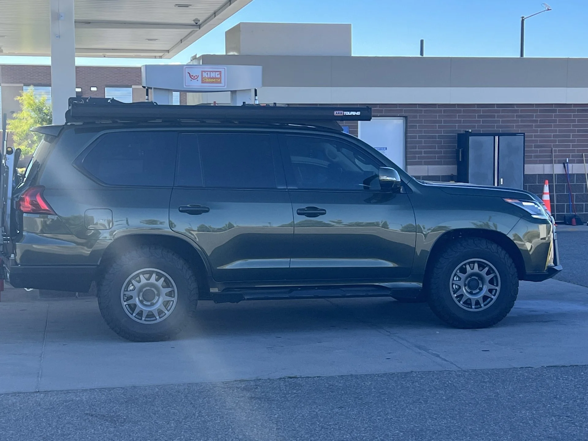

The deltas look hey. I went with echo but think the delta is better. I was worried about the 5 lugs six spoke issue, but that was obviously a non issue.Got my KO2s with Alpha Equipt Echo AND Delta wheels on (hey, I couldn’t find a full set anywhere, and these were on closeout sale)

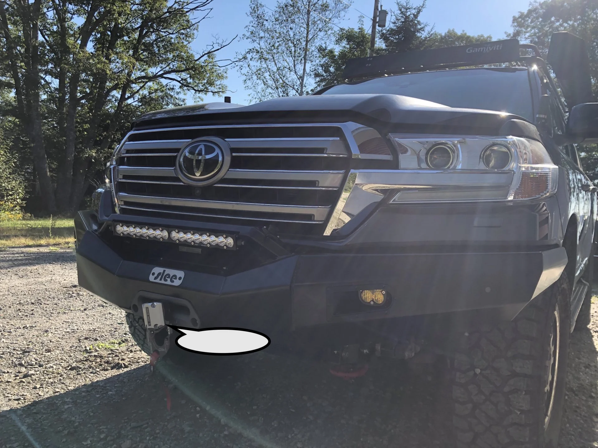

Slee front bumper with Baja Designs S2 Pro amber fogs and Baja Designs - S8, 20" Light Bar (White LED with Amber DRL)
Come up Winch with Factor 55 hook
ODYSSEY ODX-AGM31R battery
Slee main battery upgrade tray
Slee battery terminals

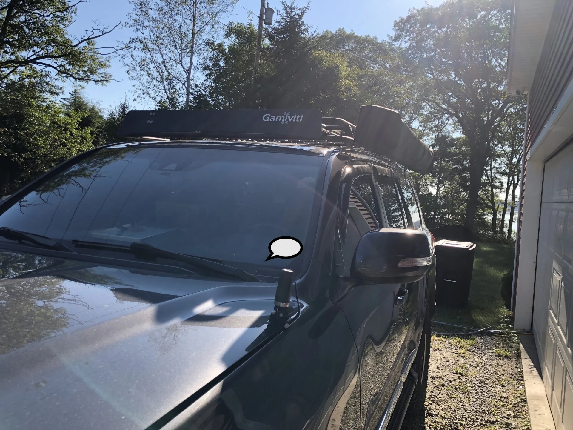

Gamiviti expedition roof rack
OVS Awning

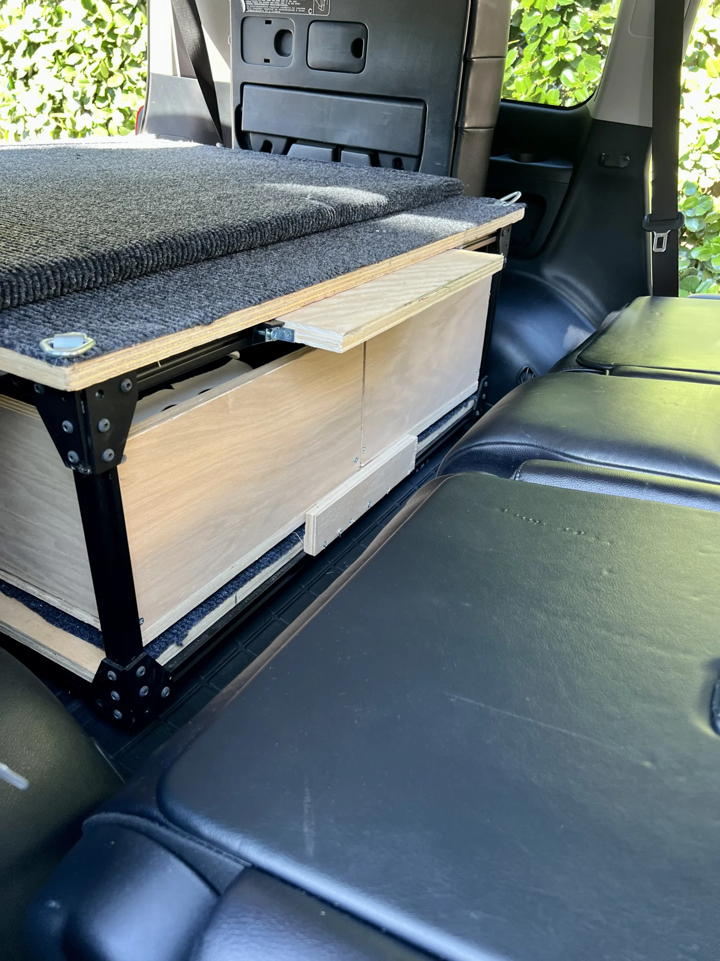

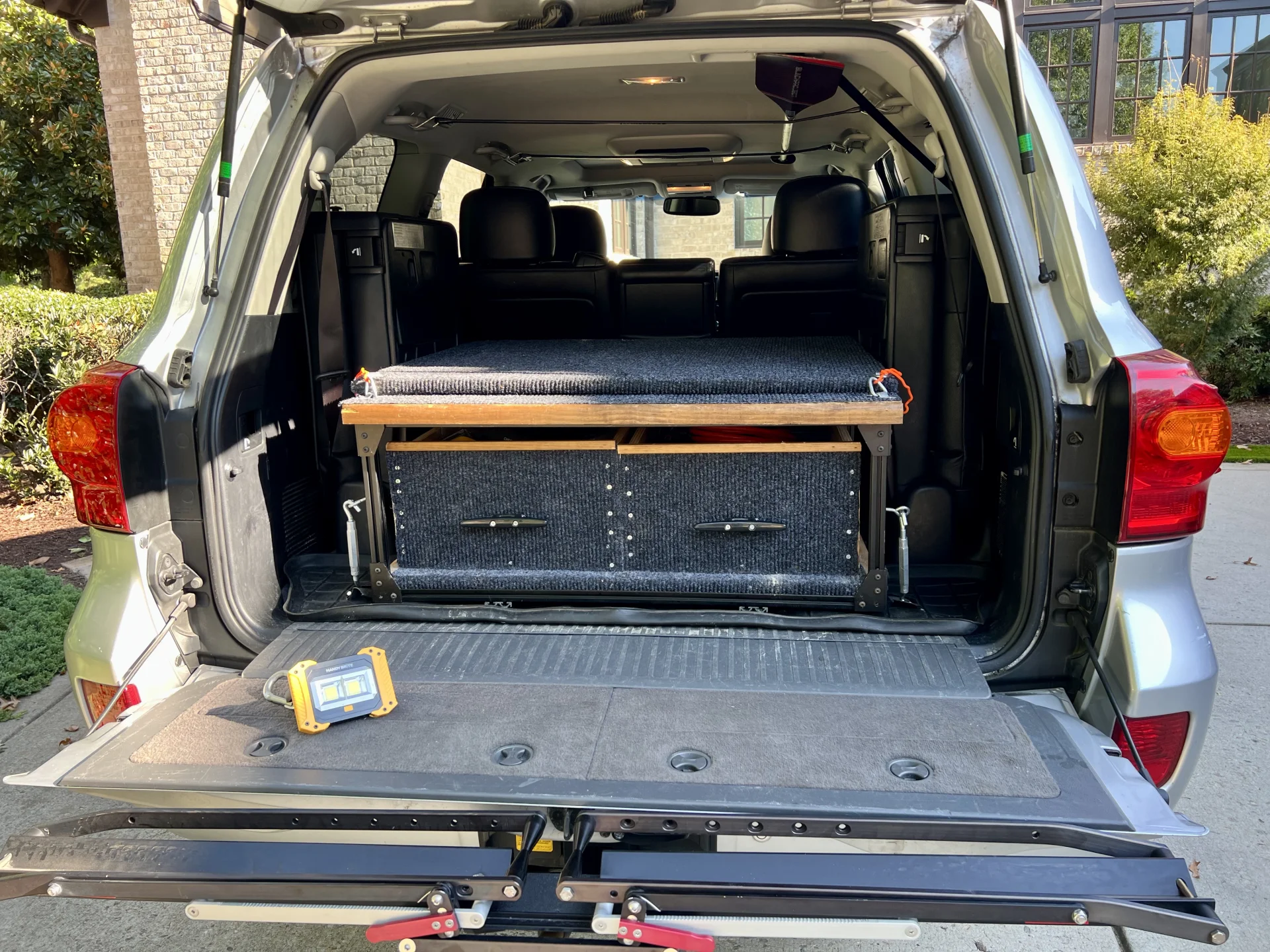

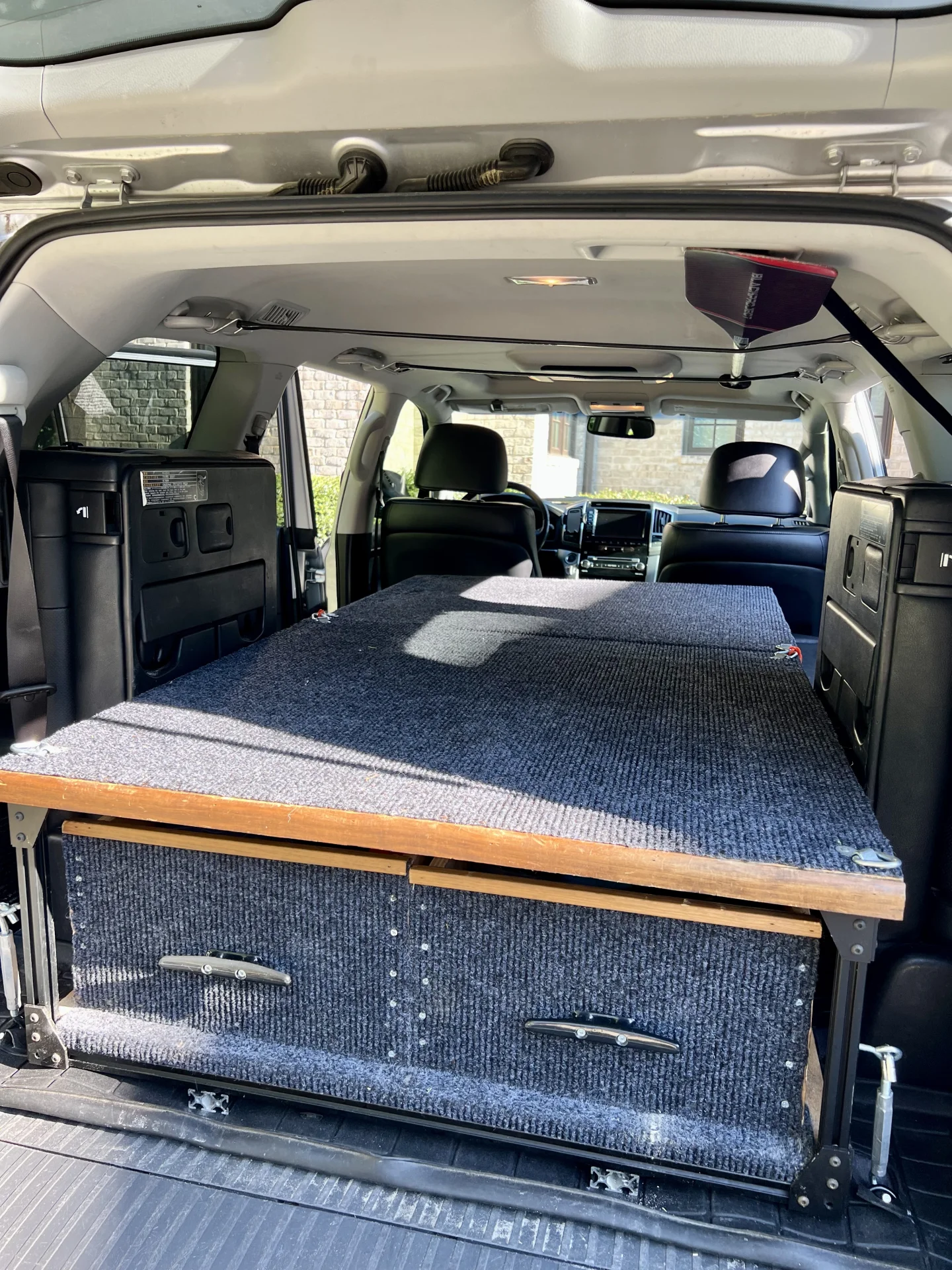

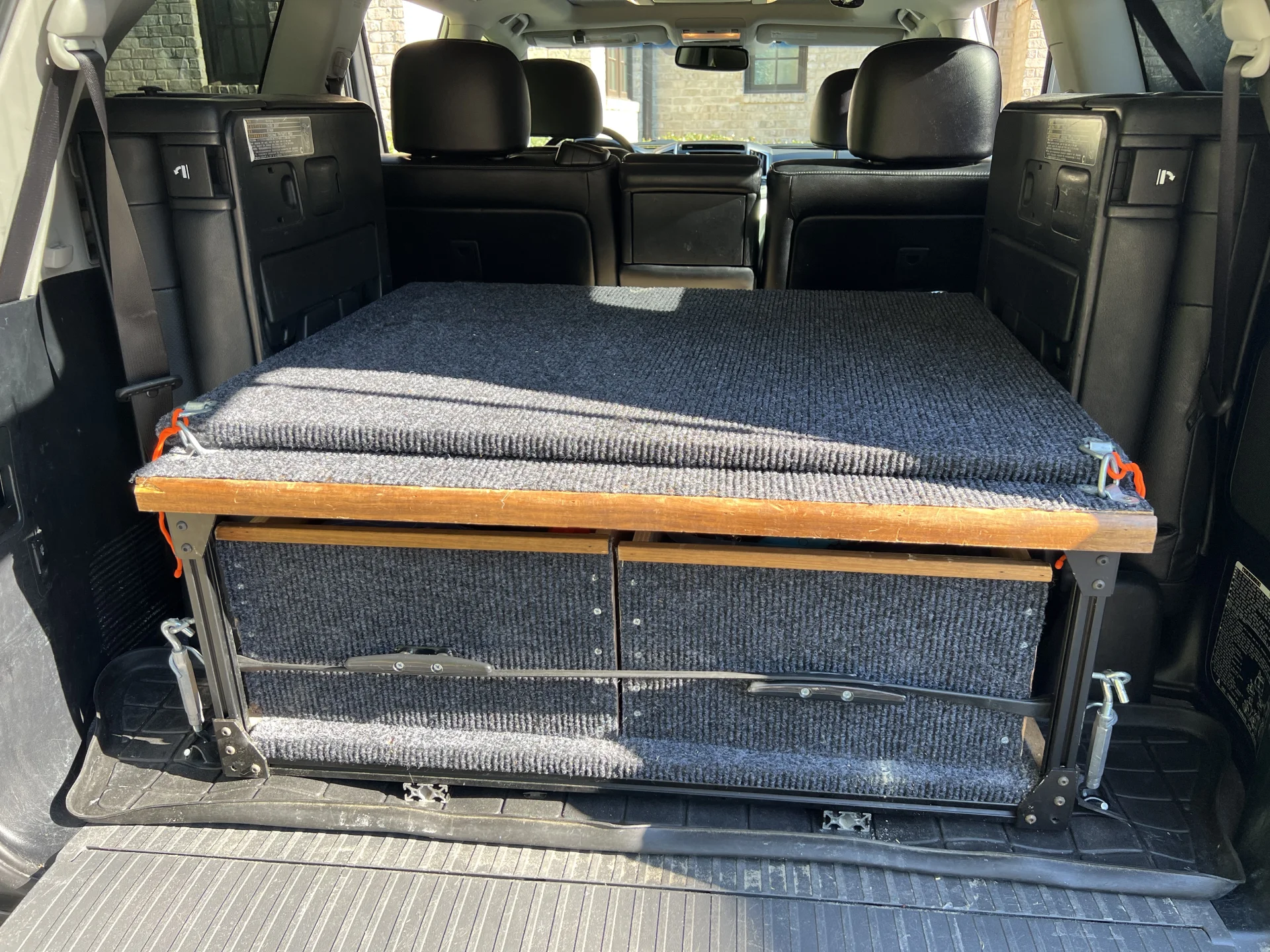

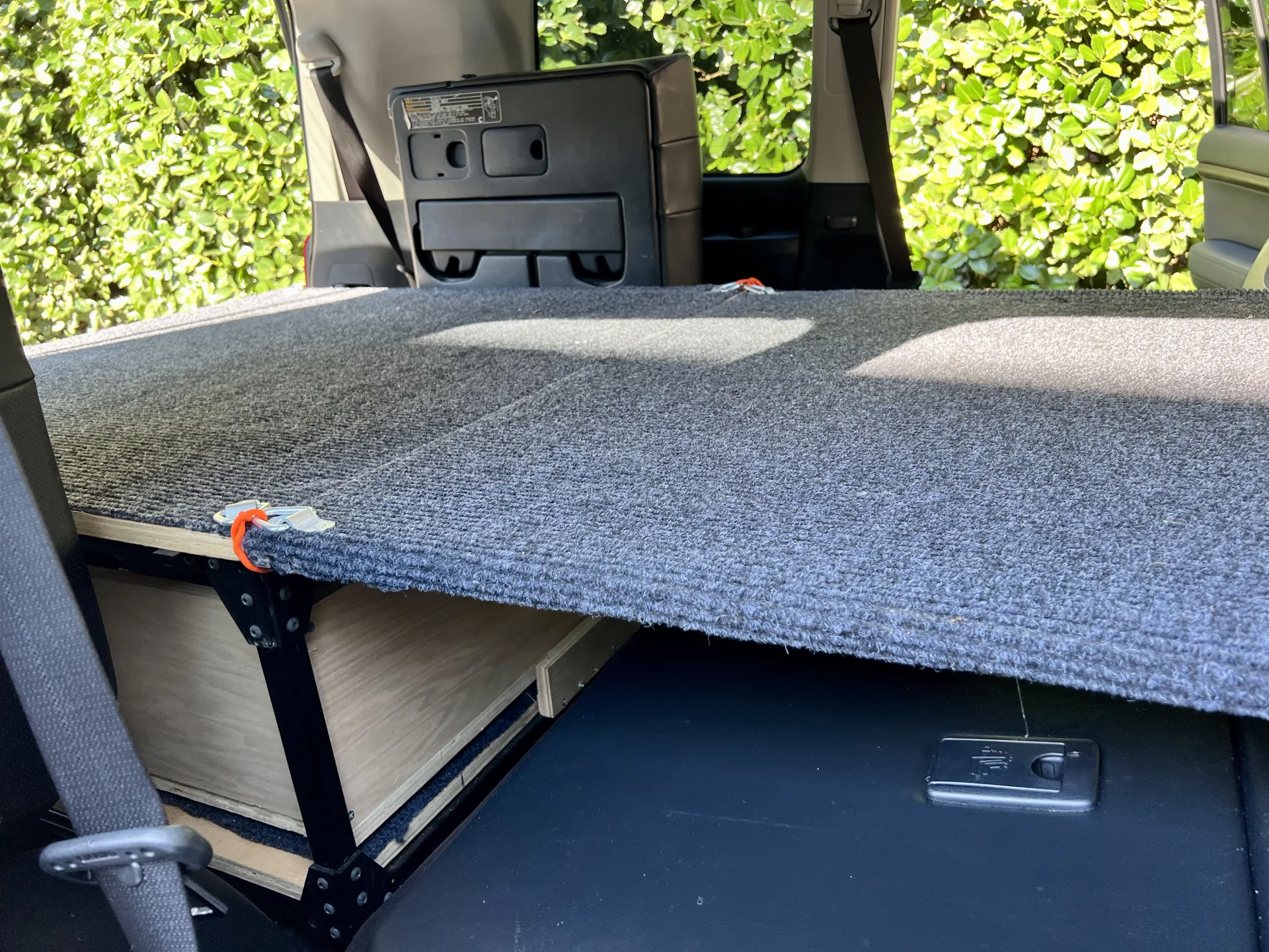

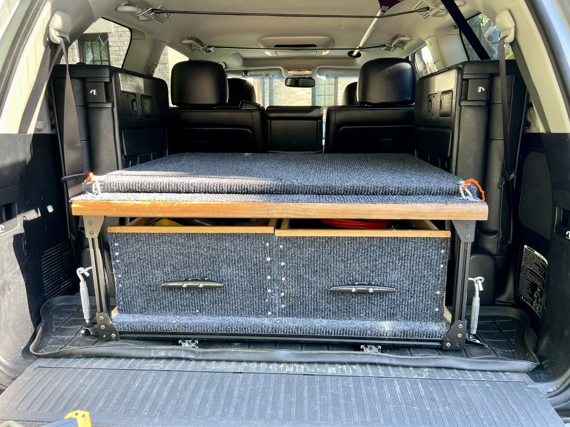

Just add an extension to the drawer system I did. Like a leaf for a table.. adds a longer base for a sleeping platform, truck bed-like storage. When not in use it simply rests on top of the original platform. Goal was to keep the third row seats in (which I use from time to time) and make an inexpensive, light weigh removable system. And not over engineer it. Simply remove the drawers, unhook the turnbuckles and slide the frame out. All in with purchased materials and stuff I had lying around was just over $300. Drawers (I made a simple box) have a simple ball bearing on the far base end to help slide and if needed a bungee to secure the front. Also is a light idea I got from this forum years back - velcro and head lamp attached. I can provide details if needed.
