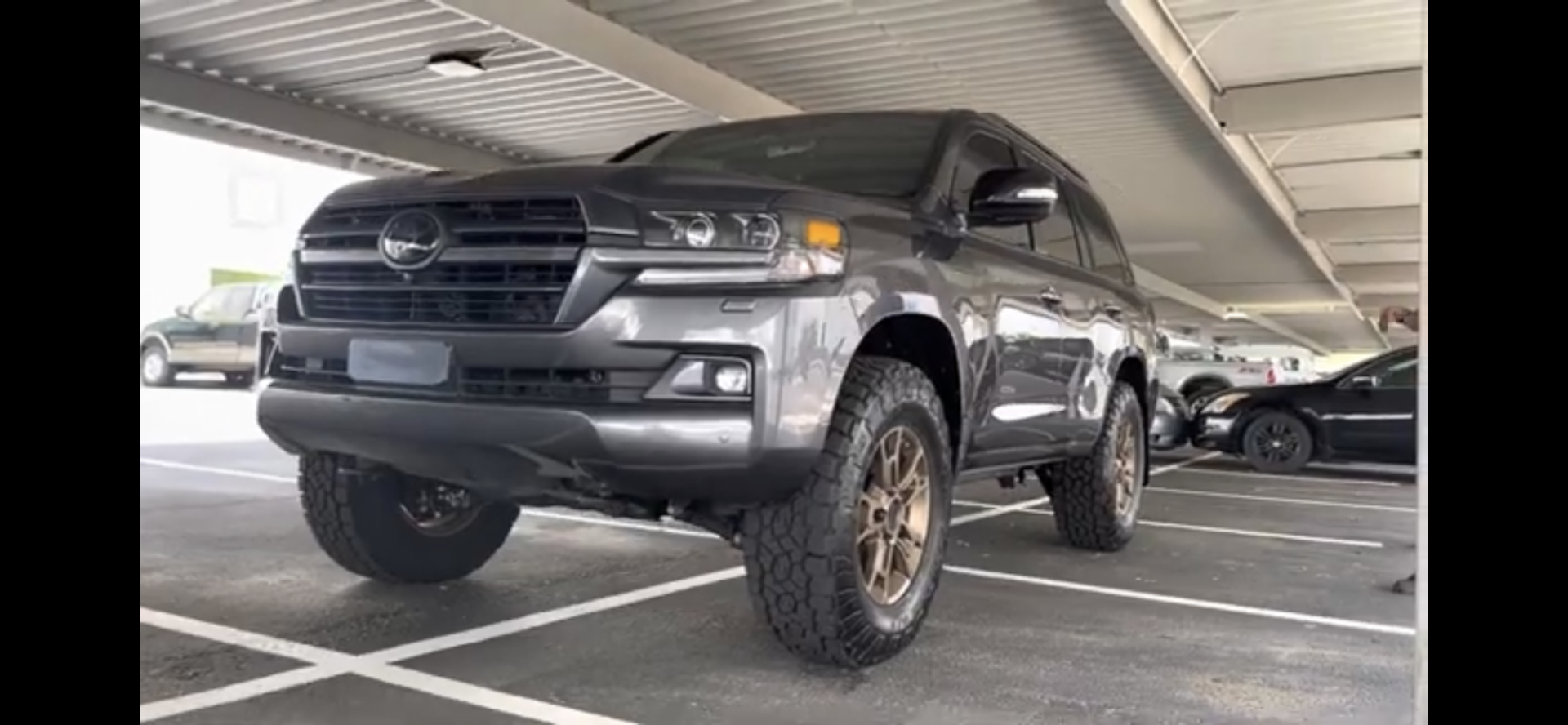

Yeah, the smart move would be the 275 but dang the 200 looks so good with 295’s. Do you have a front and side photo of yours? I’m going order a set tomorrow. How are the Toyos above 80mph?
I've had zero issues with mine above 80+. I typically set the cruise to 72-74. Passing etc, I can get above 80 but I'm not doing 80+ constantly.
I'd expect you to have significant rubbing with 295/70r18.
Good lookin’! I guess I’m more curious if the tire noise is noticeable when your at speed on the freeway. My ridge grapplers are like a very noticeable rough sounding white noise that isn’t relaxing on road trips. The 295s will just rub the drivers side sway bar only since I have 1.25” spacers but would need to weld on a 1/4” nut to the steering knuckle which would decrease my full right turn. It’s not totally uncommon as many Jeep owners actually have bolts to adjust for fitting bigger tires.
