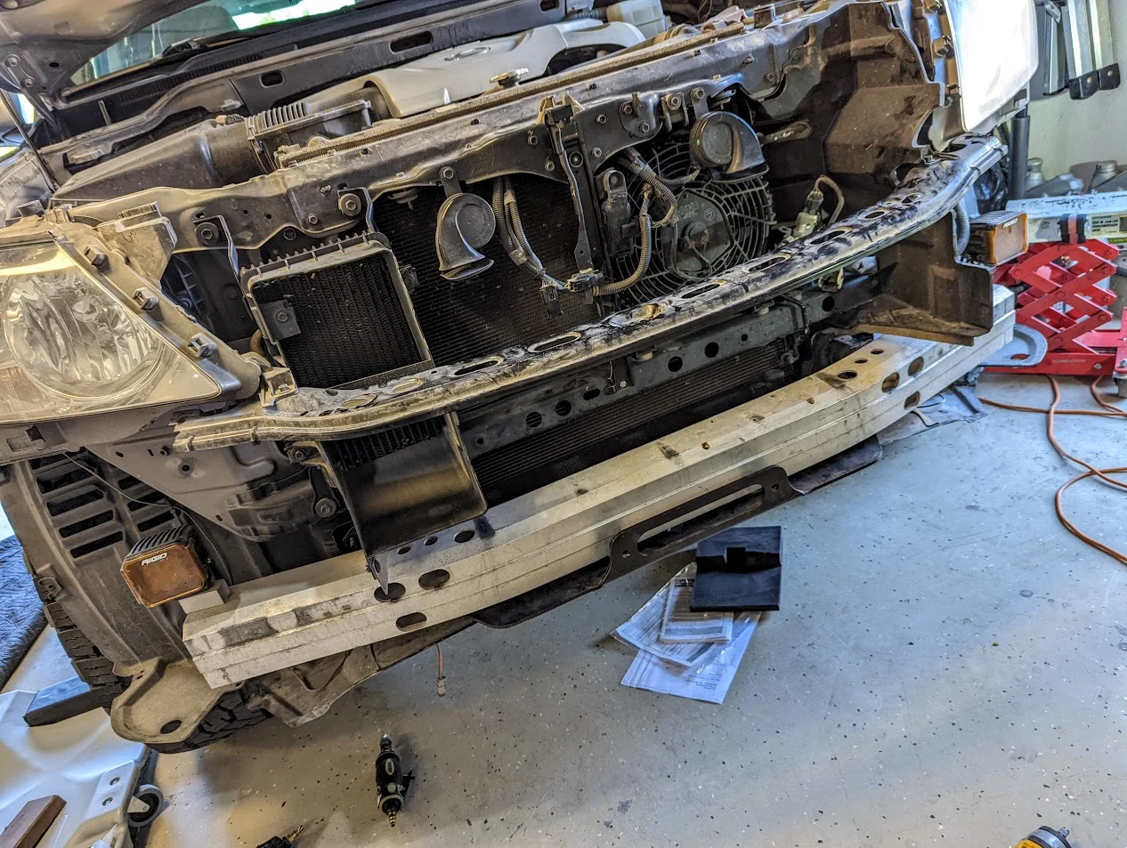

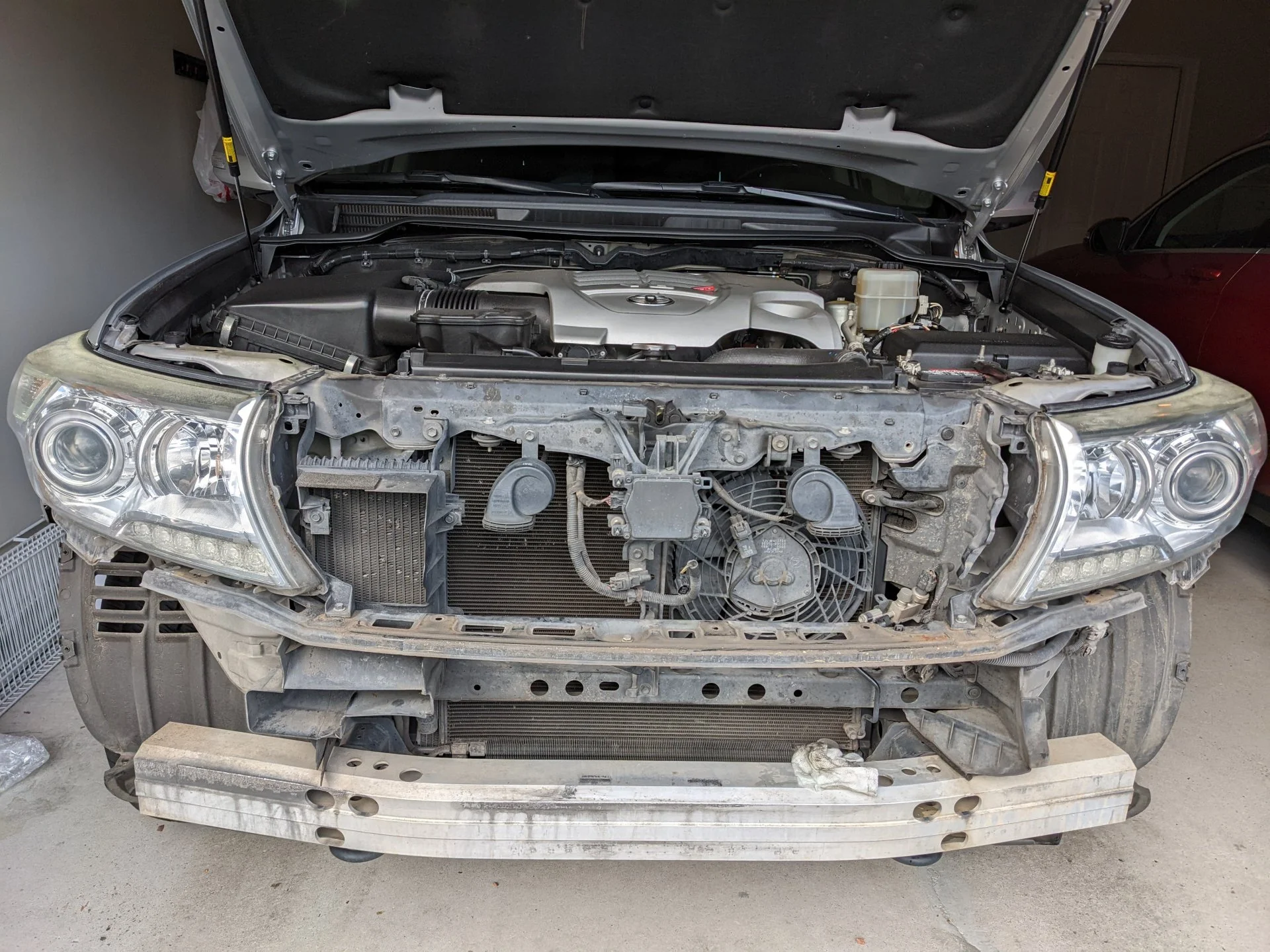

Just got back from the desert without washing. She'll clean up nice as she always does. Adding the winch but going to re-work the HWM to better fit the LX in my own way, but to also integrate back the wing part of the crash bar.
I can’t wait to see this mod. I would love to have a HWM and retain the wing part of the crash bar.
Sorting out how each piece is going to fit up and I'm comfortable I can make it happen at this point. It's going to be a complete custom job and may not be easily replicated unless with a fabrication shop. Idea is to integrate the frame horns in with the HWM plate. Then tie in the cut crash bar in with the HWM plate with enough structure that it can transfer loads in a small overlap crash.
On the LX, the HWM plate is completely below the crash bar perhaps making integration somewhat easier. The LC plate is located 2" higher. I'm also trying to keep the winch as low and far back as possible to minimize cantilevered weight on the front end.

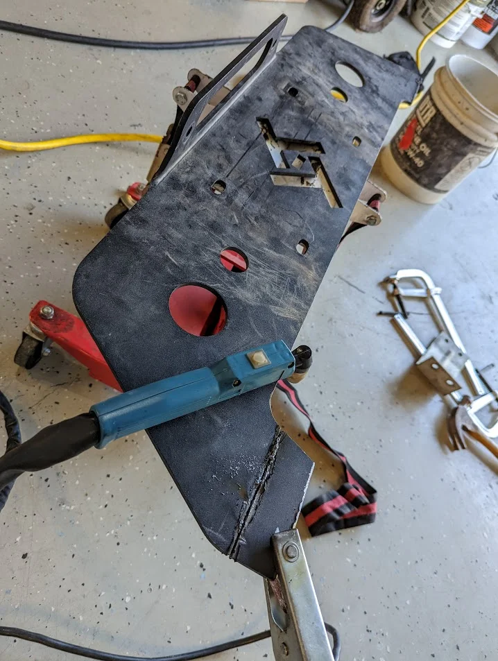

Here's what the fit-up relative to each other looks lie before I cut the crash bar to make space for the winch. The thick HWM 1/4 plate making things hard for my plasma cutter.

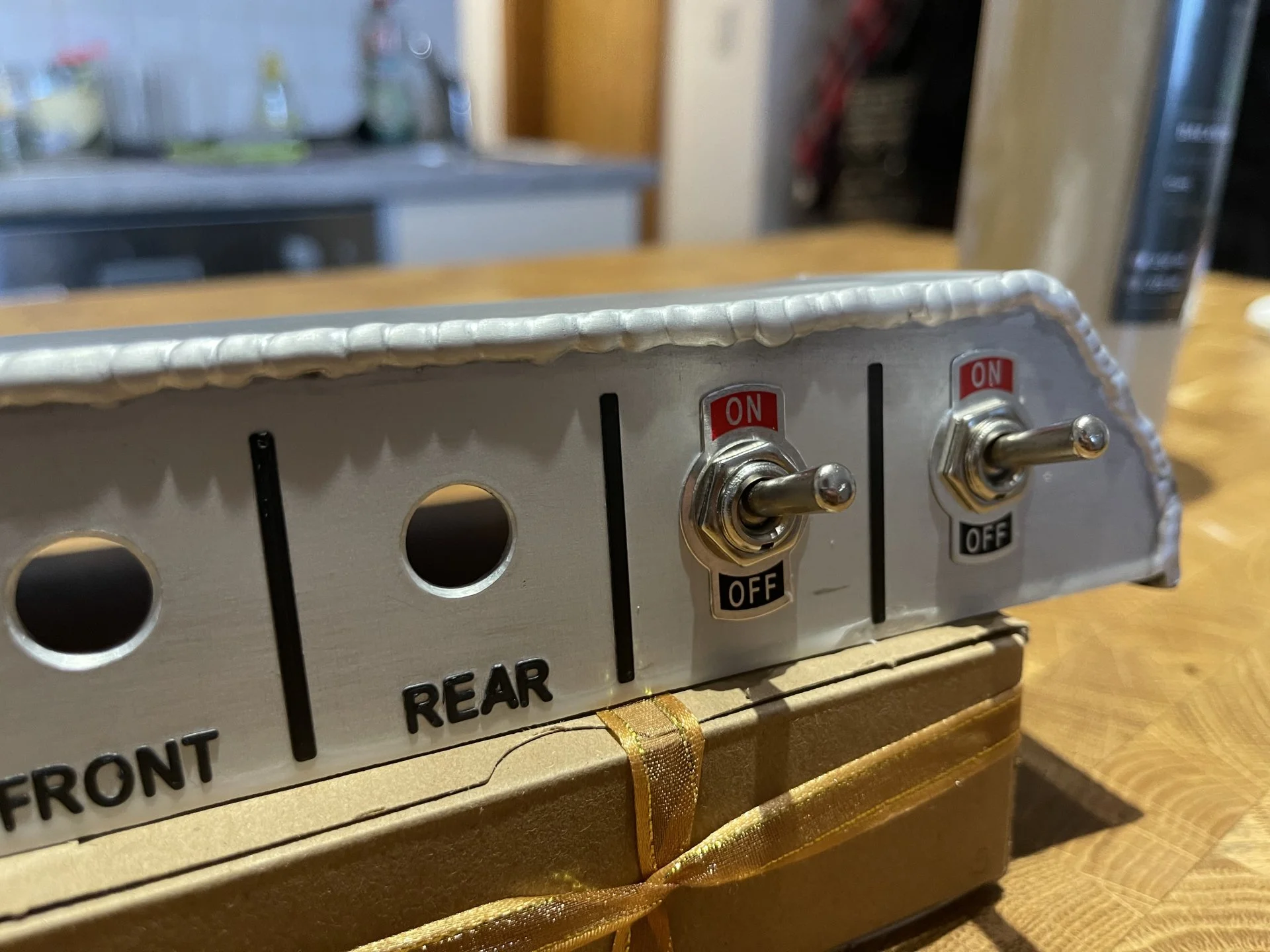

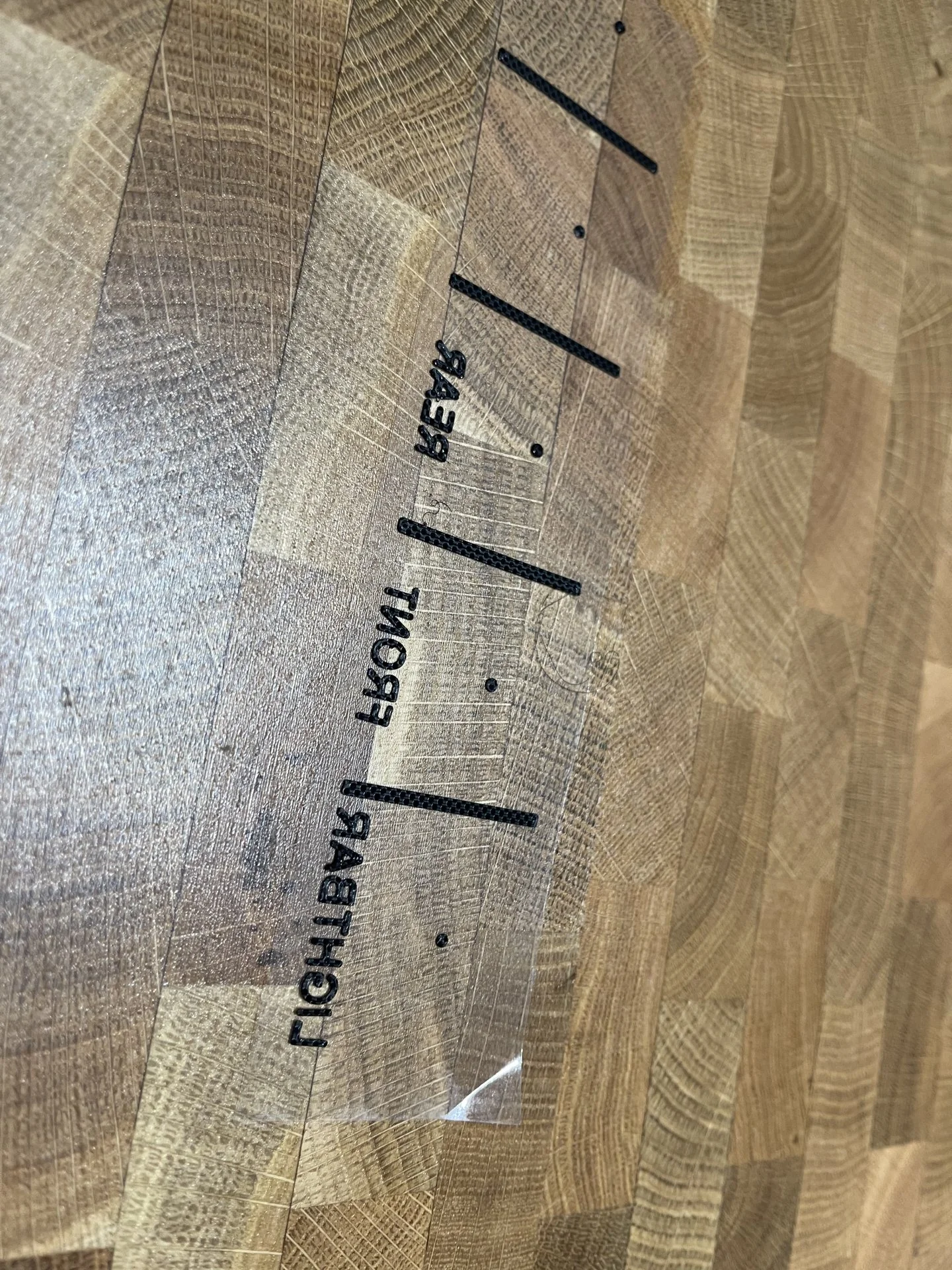

I quickly built a housing today to accommodate the switches for the light well.
A bit of CAD, cut out aluminum, welding, print and transfer the lettering with the 3D printer, paint and now it's ready.
The whole thing comes then on top of the dashboard because the switches left under the steering wheel have disturbed me.

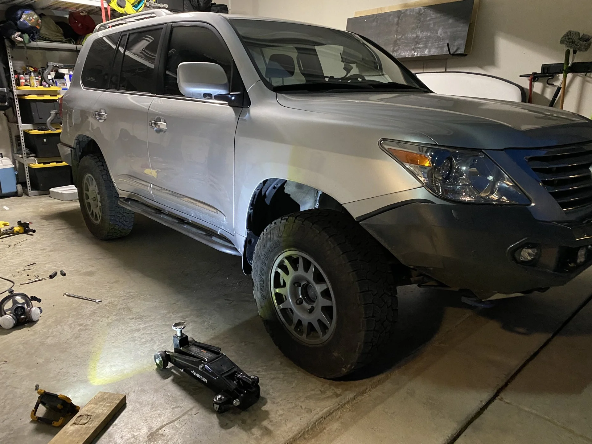

Put in my white knuckle off road sliders. Love them! Definitely no need to buy LC rocker panels for LX just some easy cutting.
I did the painting.
They are very easy to put on an LX not sure why the instructions make things so complicated, but maybe is because LC are harder…
Either way they are awesome. Got the beefier ones. They weight a lot and seem solid as hell.
White Knuckle the sliders are the cat’s meow, the instructions way too complicated.

Are you running AHC? If so can you show how you mounted the white knuckle sliders?

I’m very curious how they are attached. I went thru some correspondence with WK in 2018 and it sounded like the feet would get into some of the AHC attachment points.
I’m glad they did t, would love to see some pics so others could also benefit of how they bolt up.
there is absolutely no way in hell you could mount these with AHC… I am sure they could redesign and get them to go on.
I have deleted AHC and running kings, but I recall the day I hacked everything off. It was a chore. There are still a couple pieces of tube in there.
I actually put the order in October and got them over new years. I was going to get the Slee but they got so expensive I looked for alternatives.
The white knuckle look better in person. Zero regrets
Cheers!!
See post above. Sorry about getting everyones hopes up. But you guys should reach out to them. I think it is doable with some redesign.
Yeah, they were open to it back then, but at the time I didn’t think there would be 16 moths where there was no supply for Lx at all. At this time there are now a couple solid solutions on the market and actively stocked.

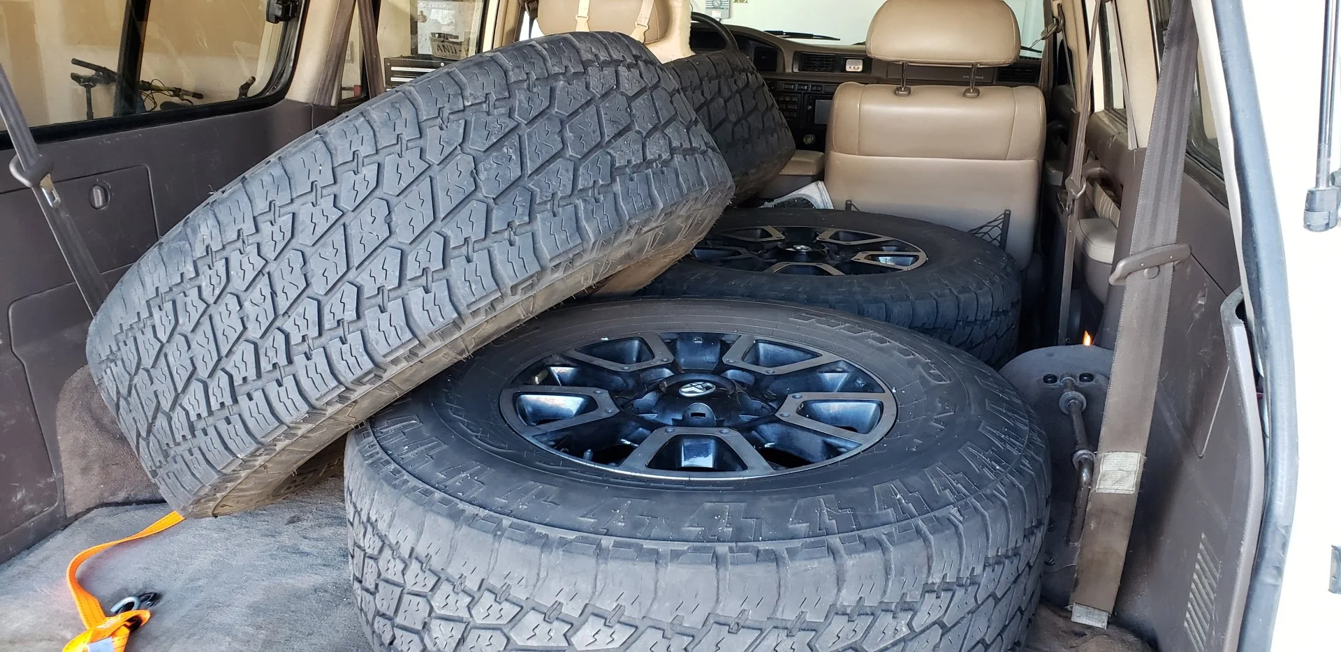

Acquired some wheels and tires. 285/75r18. Planning on AHC service and sensor lift before installing. Two tires are quite good, two have some bad camber wear. Unsure whether I'll run them or replace them, but the price was right.
Probably replace. With the wear/cupping I see, those are going to be noisy.
