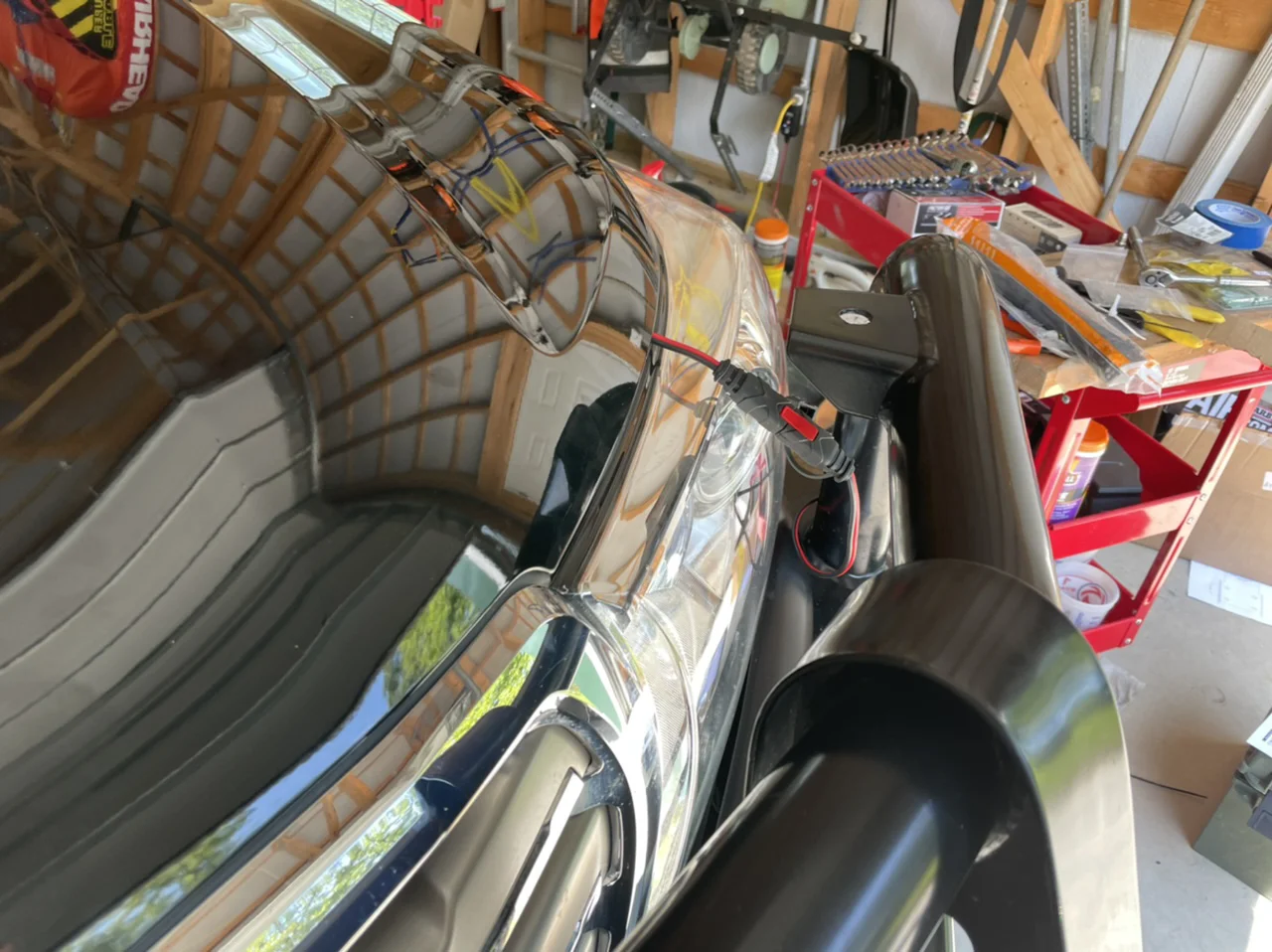

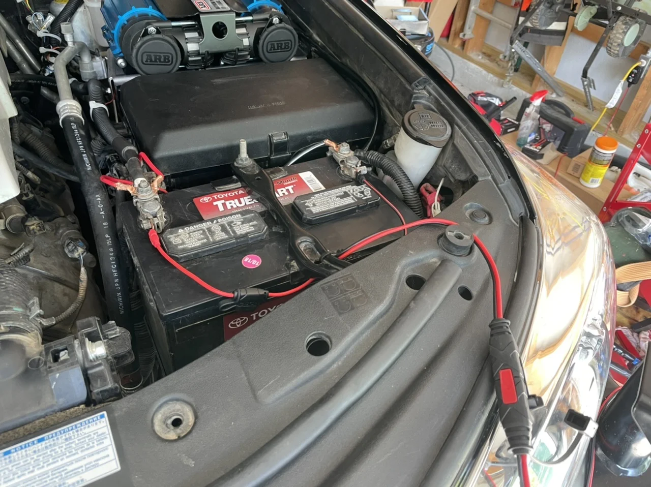

Added NOCO charger leads to use with NOCO 10’ extension to make plugging in my NOCO trickle charger more convenient and allowing hood to be closed while charging.

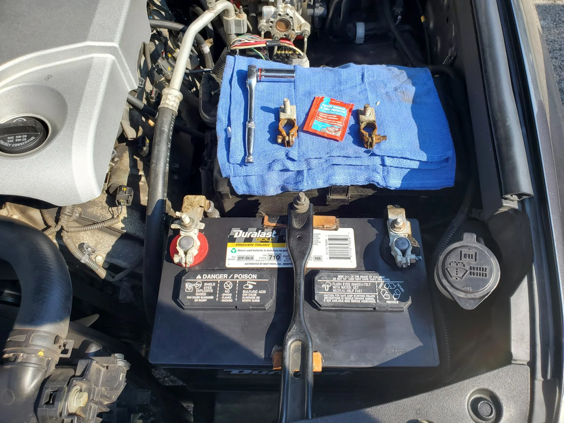

This weekend, I installed a new battery and OEM battery terminals. Battery wise, I went the Duralast Gold route b/c their are more Autozone's around when traveling😎

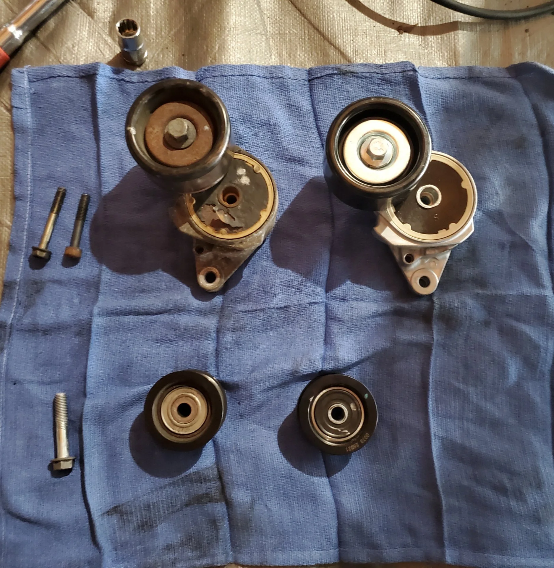

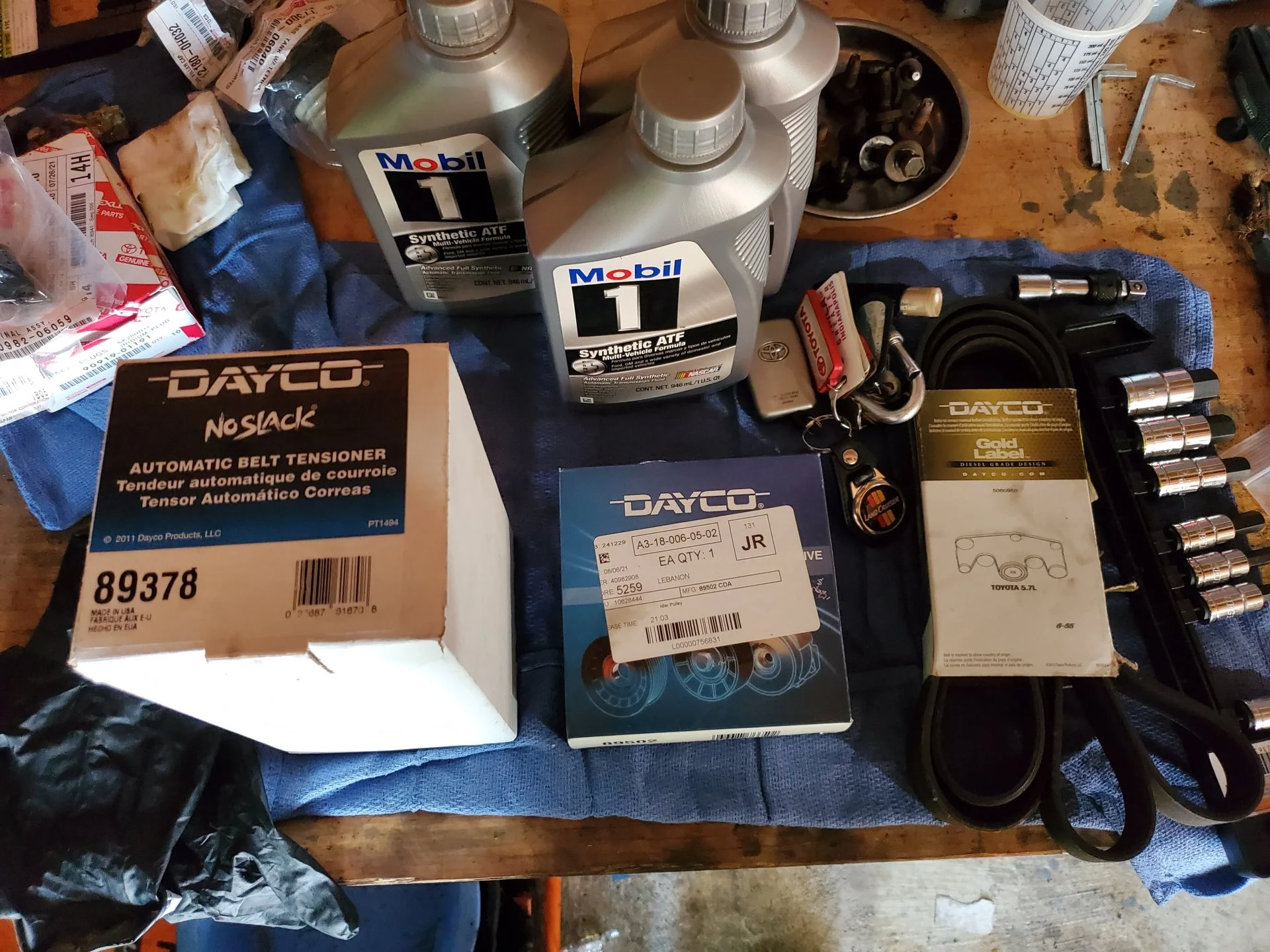

I also decided to brave the heat, and replace my tensioner, idler pulley, and belt. Went the Dayco route for all three parts. Didn't realize the tension was getting weak in the old tensioner, until I put the new one on and tried to slack it up. I ended up having to grab my neighbor to help me slide the new belt on.
Why Dayco over OEM. Land Cruisers dislike anything non-OEM bolted to their engines.
Dayco is OEM for the belt, tensioner, and idler pulley on the 200 series. I purchased all three items from Advanced Auto w/ a 25% off coupon for around $125.00 out the door. If I would have bought the same exact parts from Toyota, I would have paid over $200.
Made in Japan?
Made in Japan?
No, they are "Made in the USA." They are the exact same parts you would get in a Toyota/Lexus box. Both tensioner's are stamped "Dayco." I look around on the Tundra forms if I can't find info about are 200's on here. That's how I found out about Dayco being OEM manufacturers for those parts.
