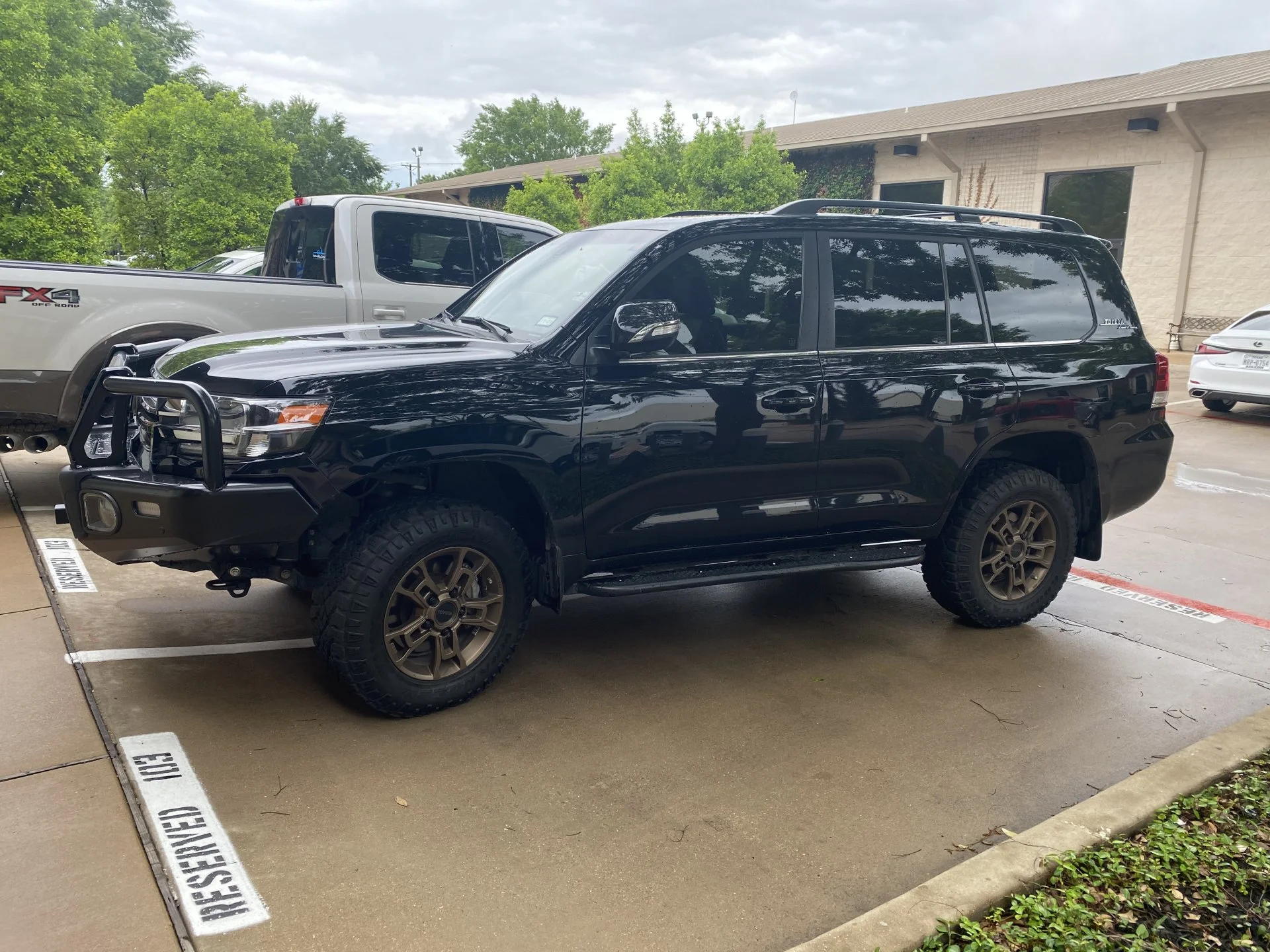

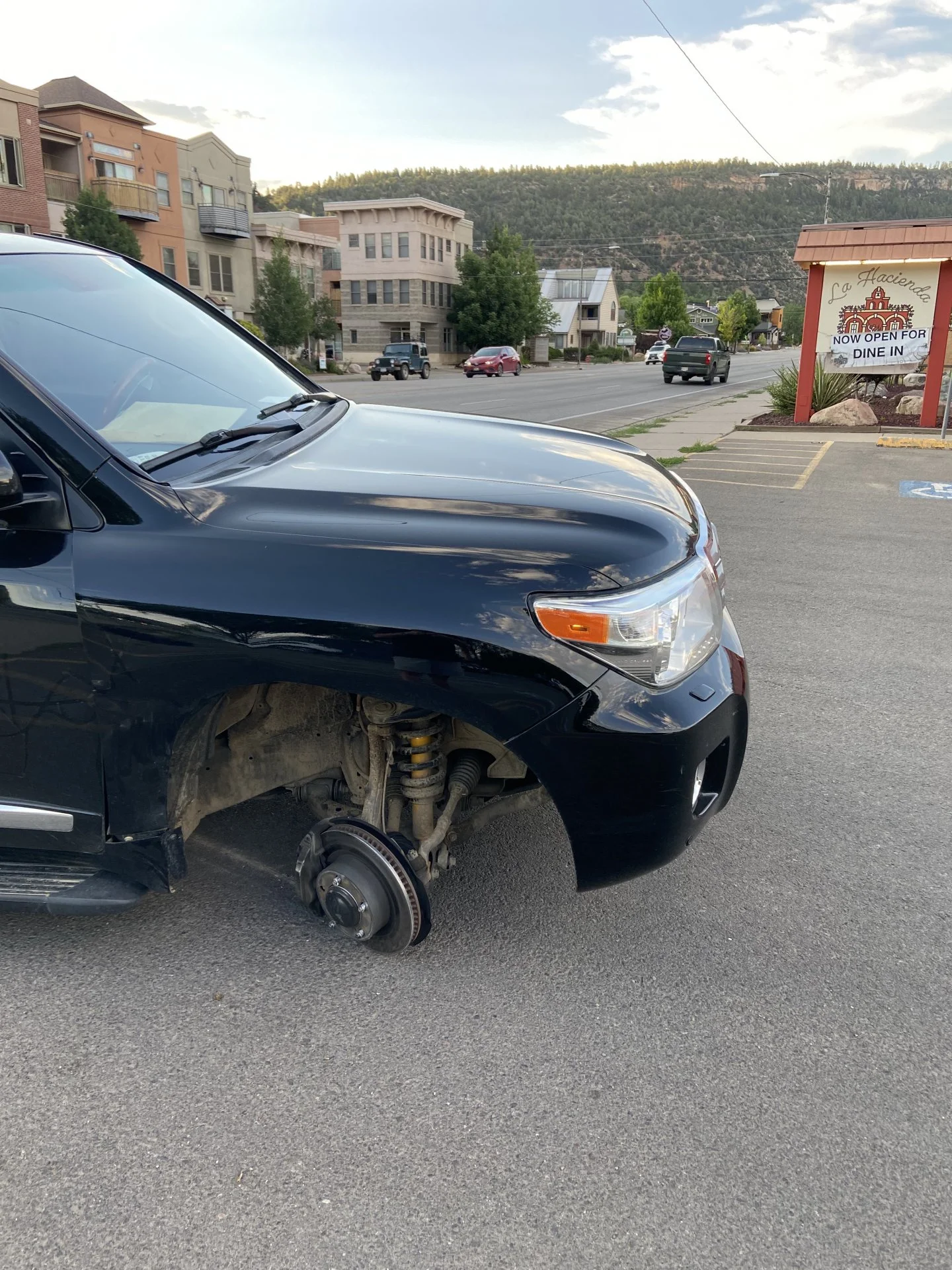

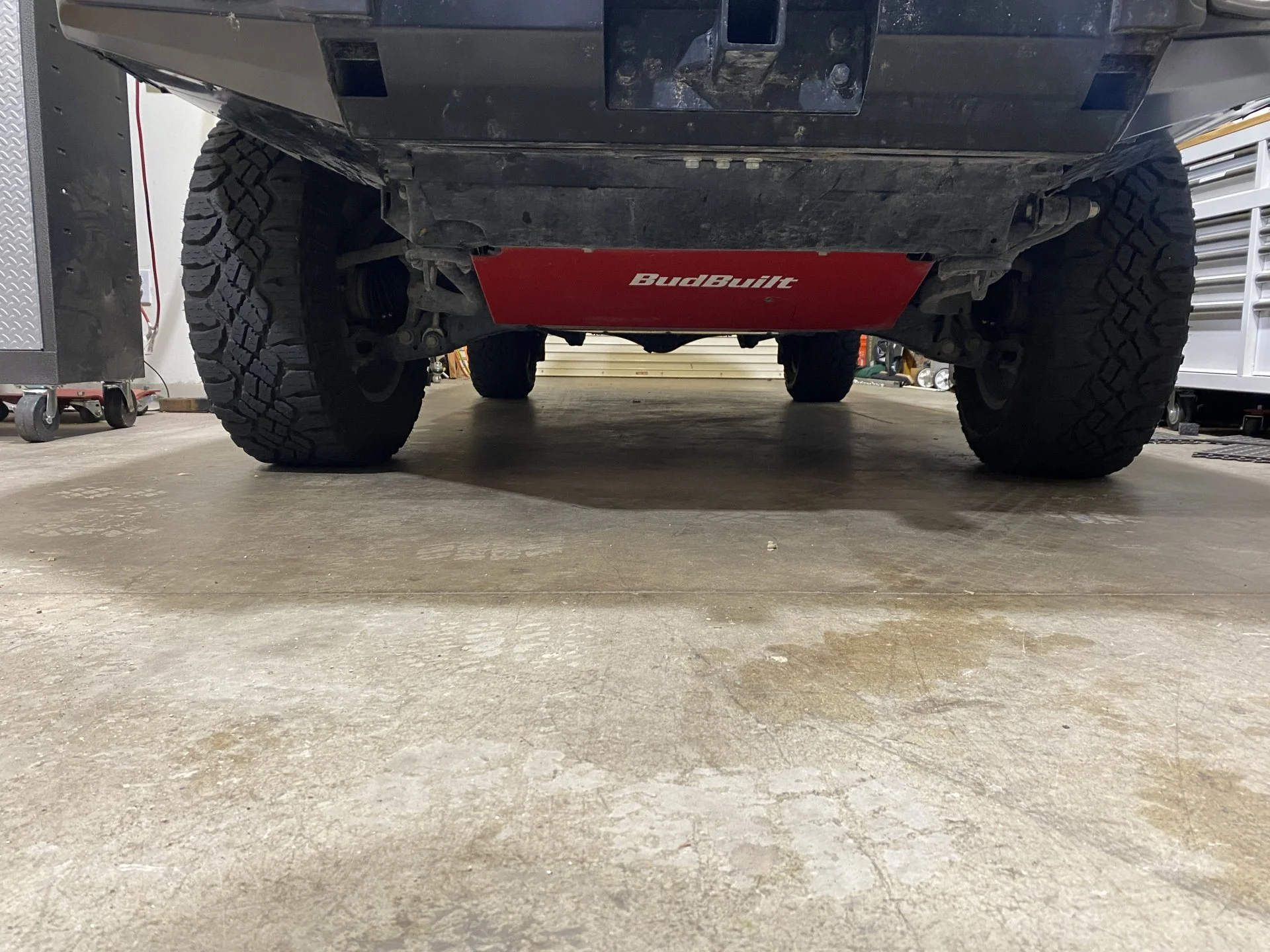

Just a but of an upgrade to the LX 570!

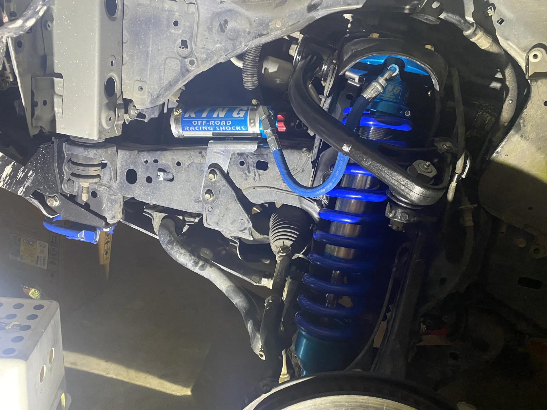

removing the rear shocks is an ordeal so currently. Just swapped rear springs out. Going to have to take to someone to remove old rear shocks
This thread has some tips for rear shock replacement.

Have details of all the parts you used for the suspension swap?

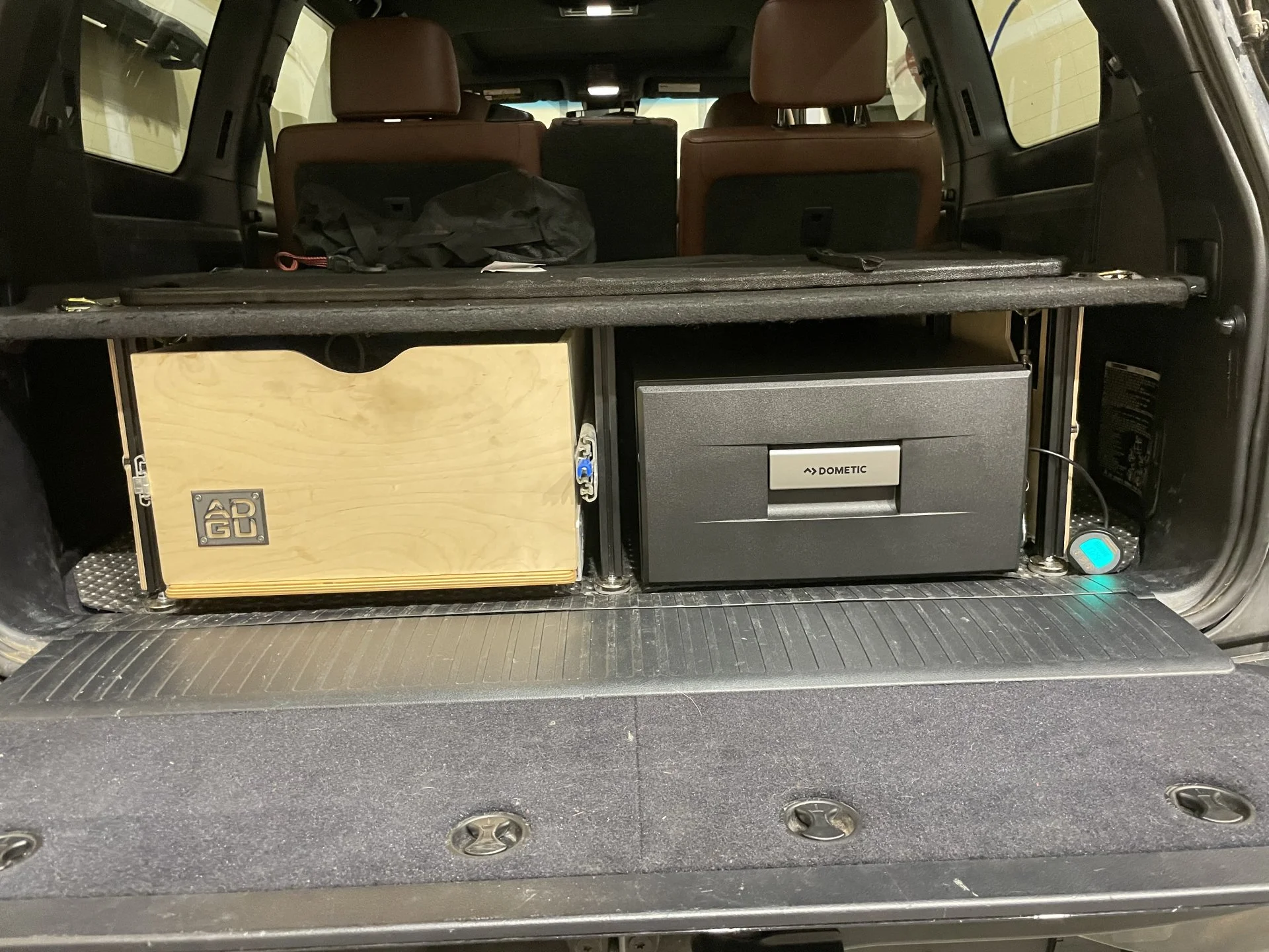

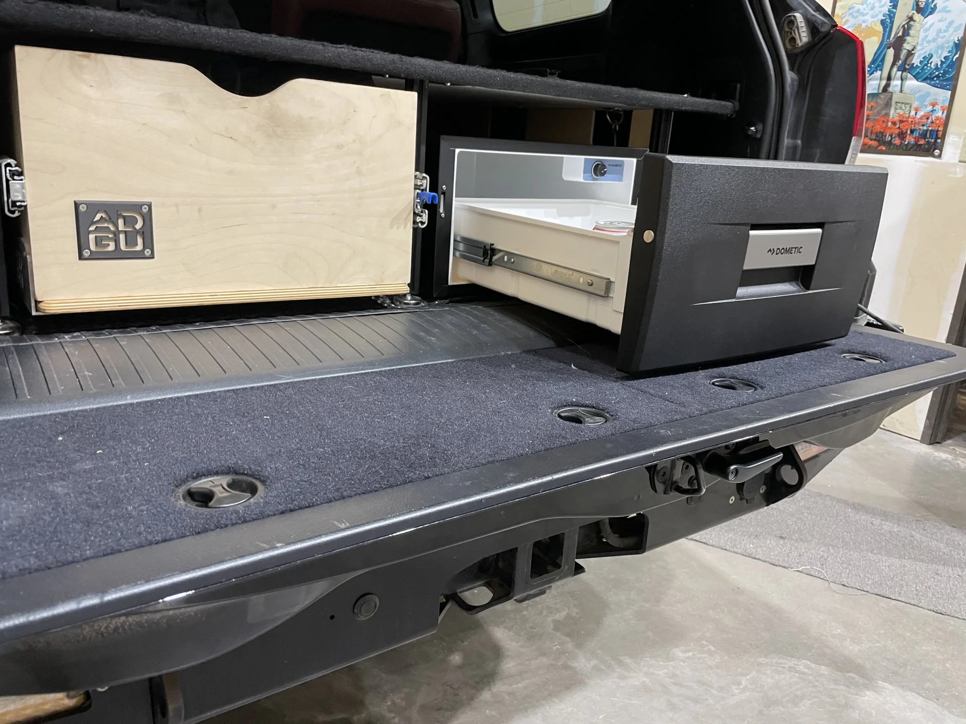

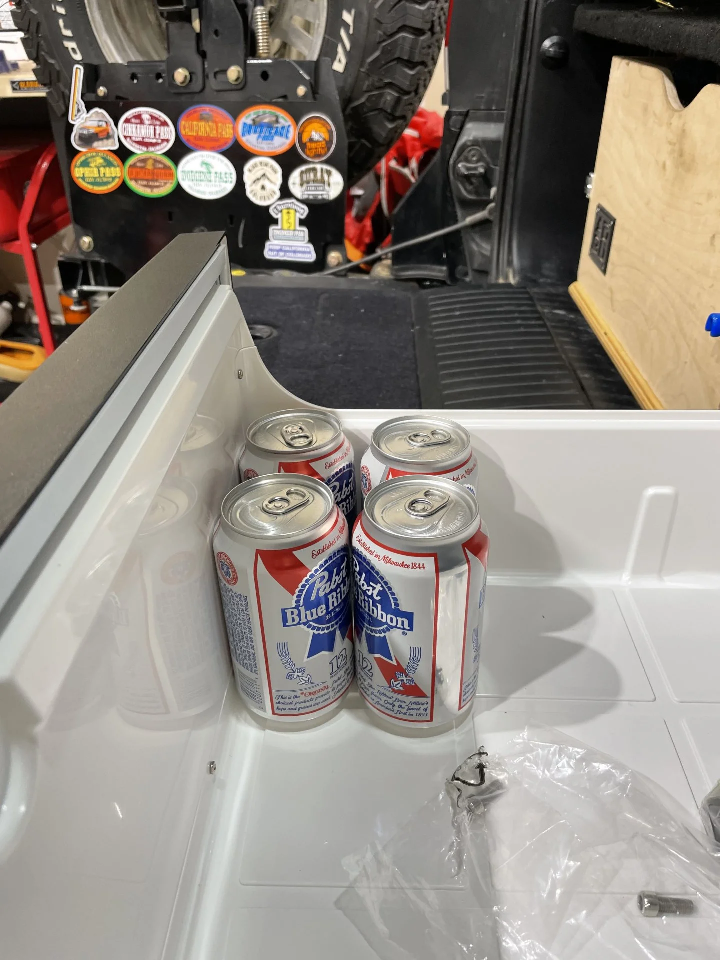

finished wiring up dual redarc bcdc and dual battery. Hooked fridge and “testing” it

I did go through it, but it that bolt below the hydraulic hoses is insanely difficult. At this point I may just take it to Lexus dealer and asked to be charged labor for just removing them. I am sure they have figured it out, will then put on the rears at home. Putting them on its not hard, its that damn bolt for the AHC shocks within this fitting to clamp AHC hose.
Curious to hear what you did with AHC.
Taking it all off. Already disabled it. Mine was already due for a change and prefer these to AHC.
Give Ben a call at Filthy Motorsports. They have this process down, and can get inventory. Mine are custom valved for my vehicle weight. He is incredibly detailed in the whole process and very knowledgeable. Look up his suspension comparison on youtube. Cheers

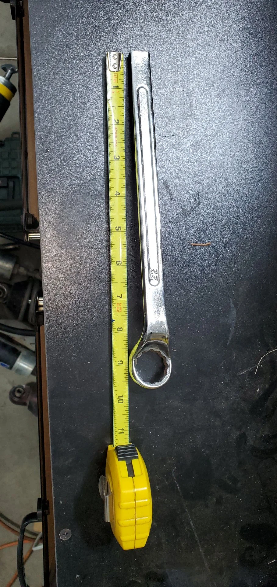

Happy to see another with the AHC delete. I ended up buying a 22mm offset wrench from harbor freight and cut one end off of it to be able to remove the top nut off the rear stock shocks.

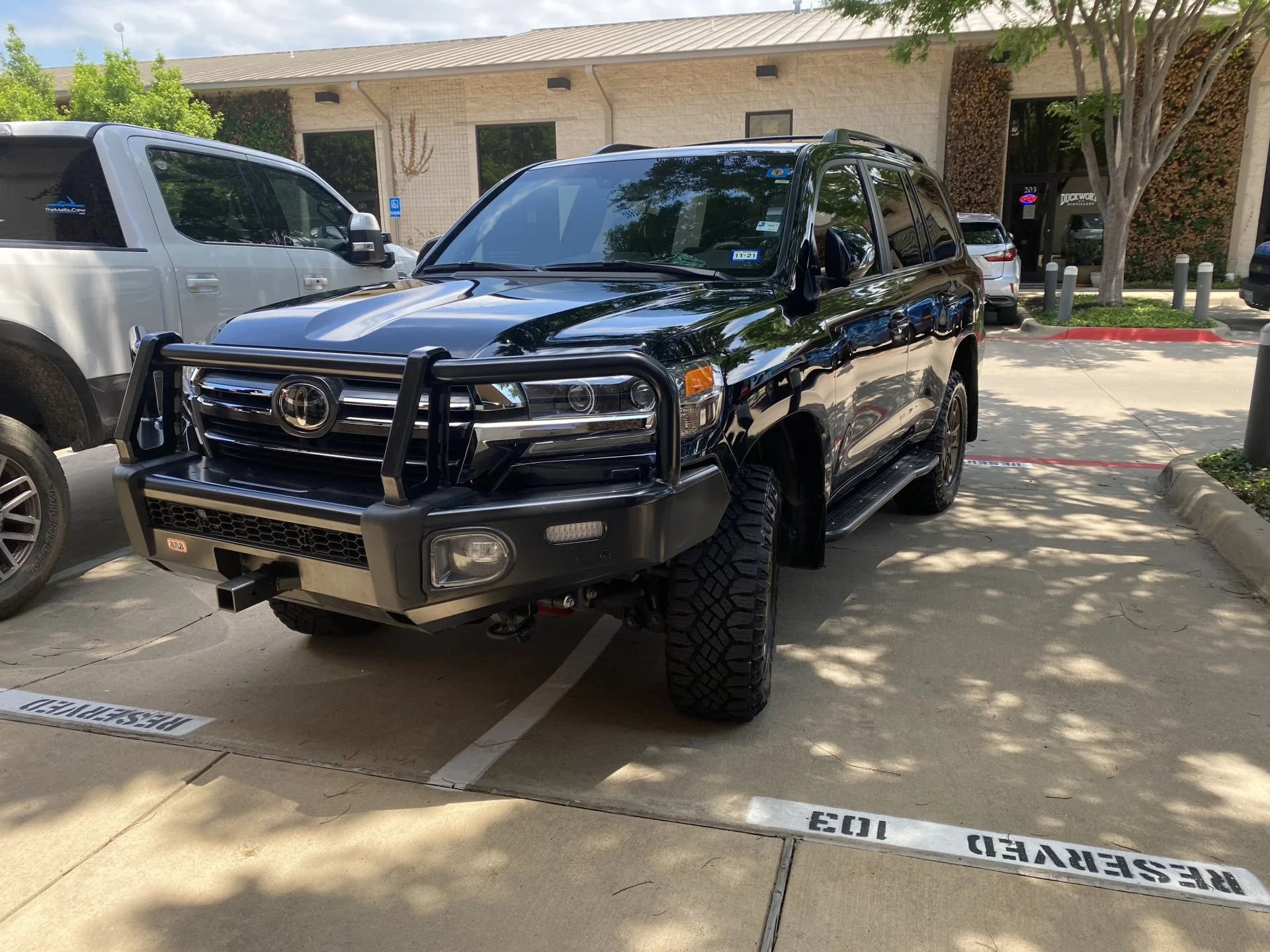

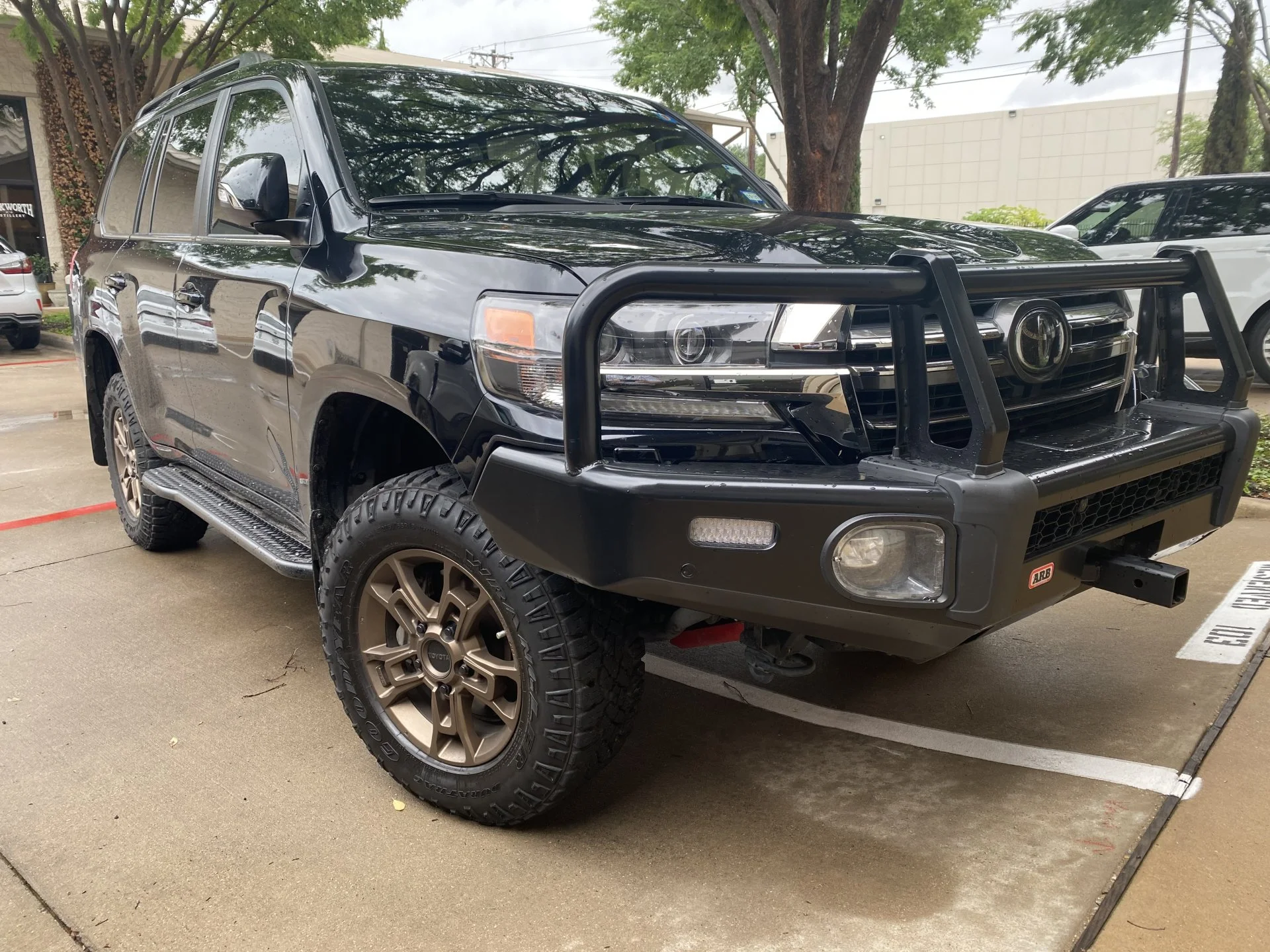

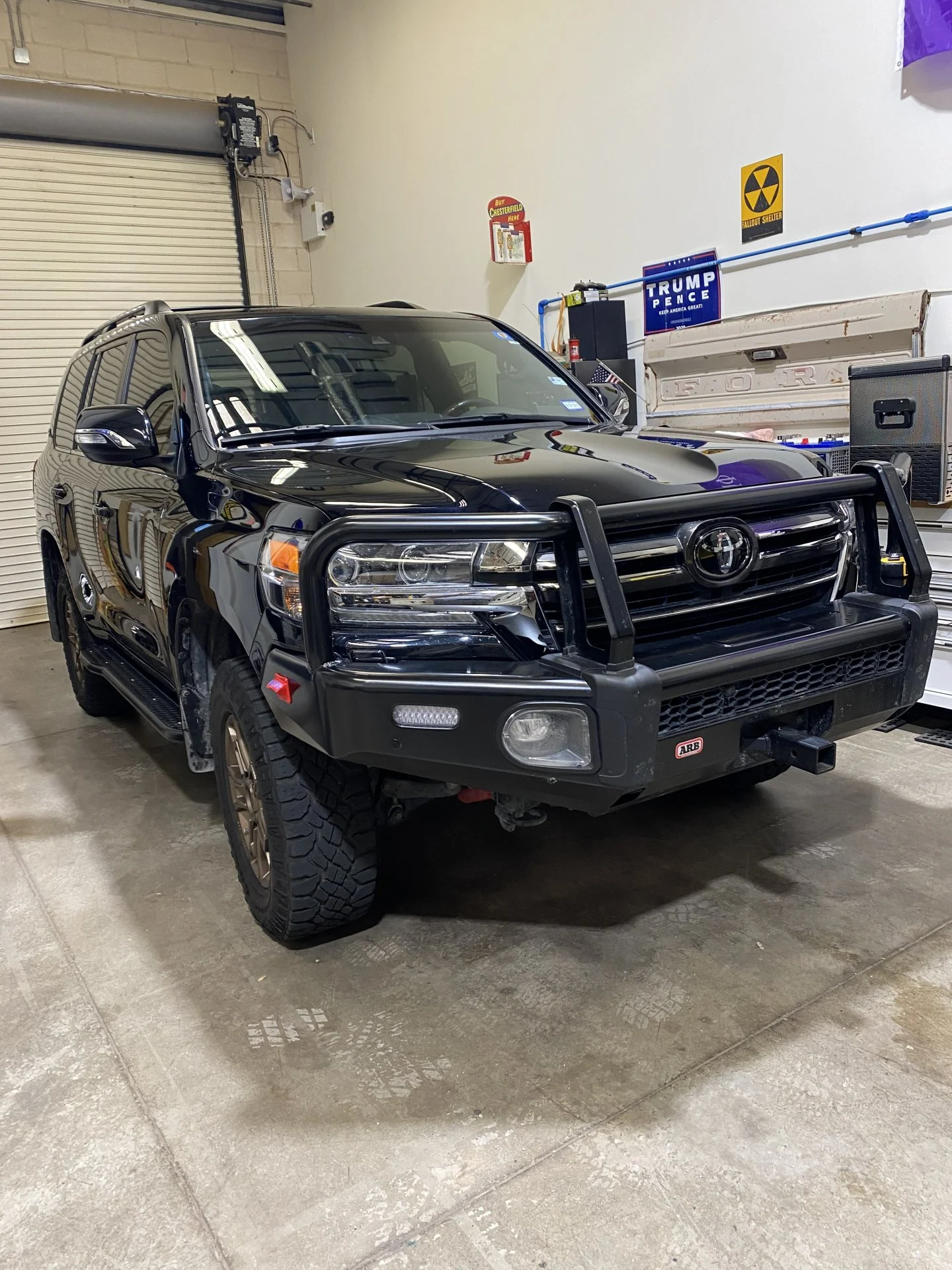

Is that front receiver hitch welded on your ARB or is it incorporated into the winch/fairlead mounts? I assume a custom job? Never seen a front receiver hitch on an ARB.
It’s just bolted to the bumper where the winch would be bolted on. I’ll post some additional pics tomorrow.
Turbo8 you inspired me on this one! Will try your tactic. Cheers
