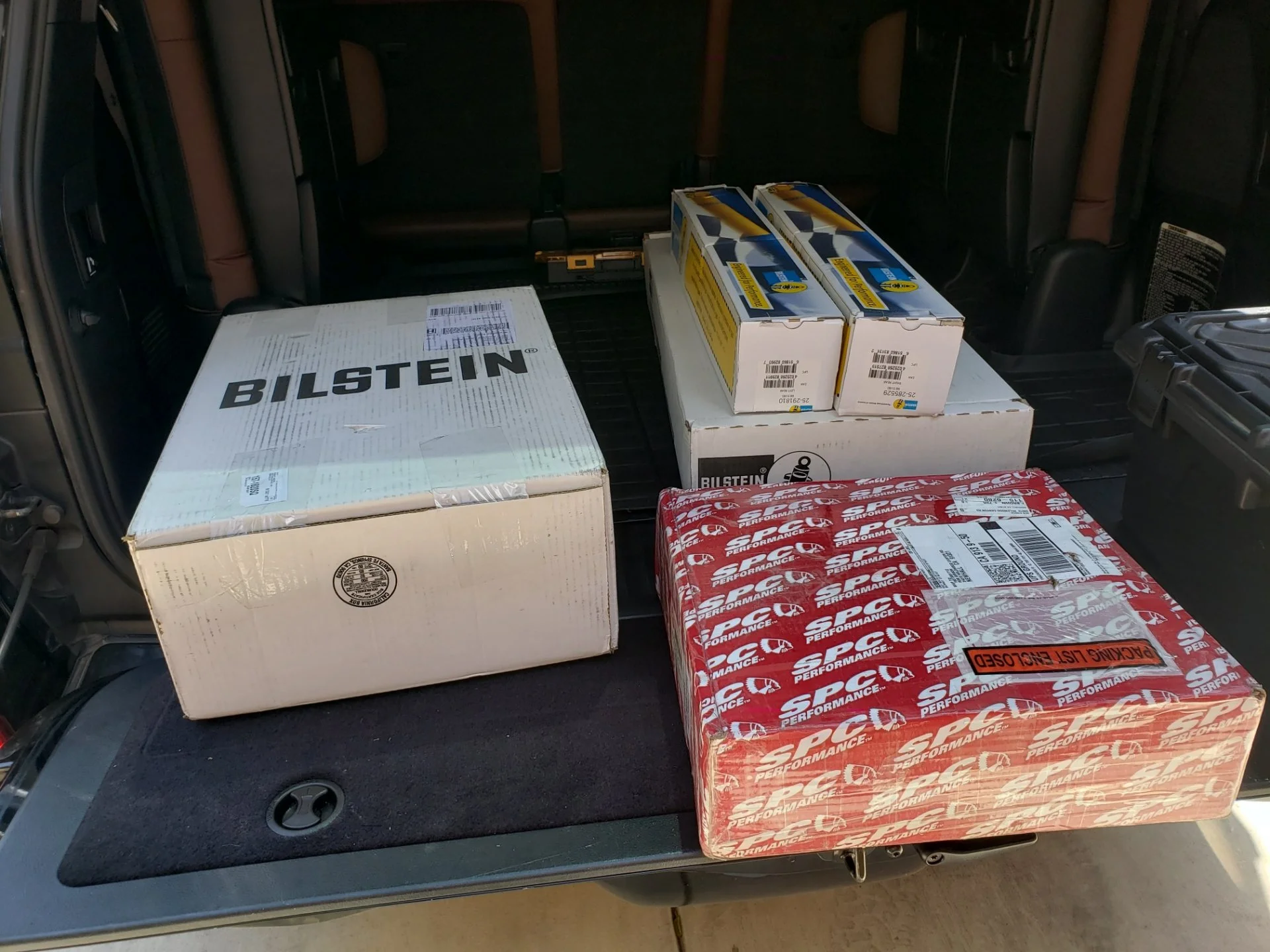

Received all the parts for my lift.....had to piece it out unfortunately. Front lift parts are on long back order from Bilstein - luckily found a set on the shelf with Summit Racing and had AJUSA ship me the rear set.

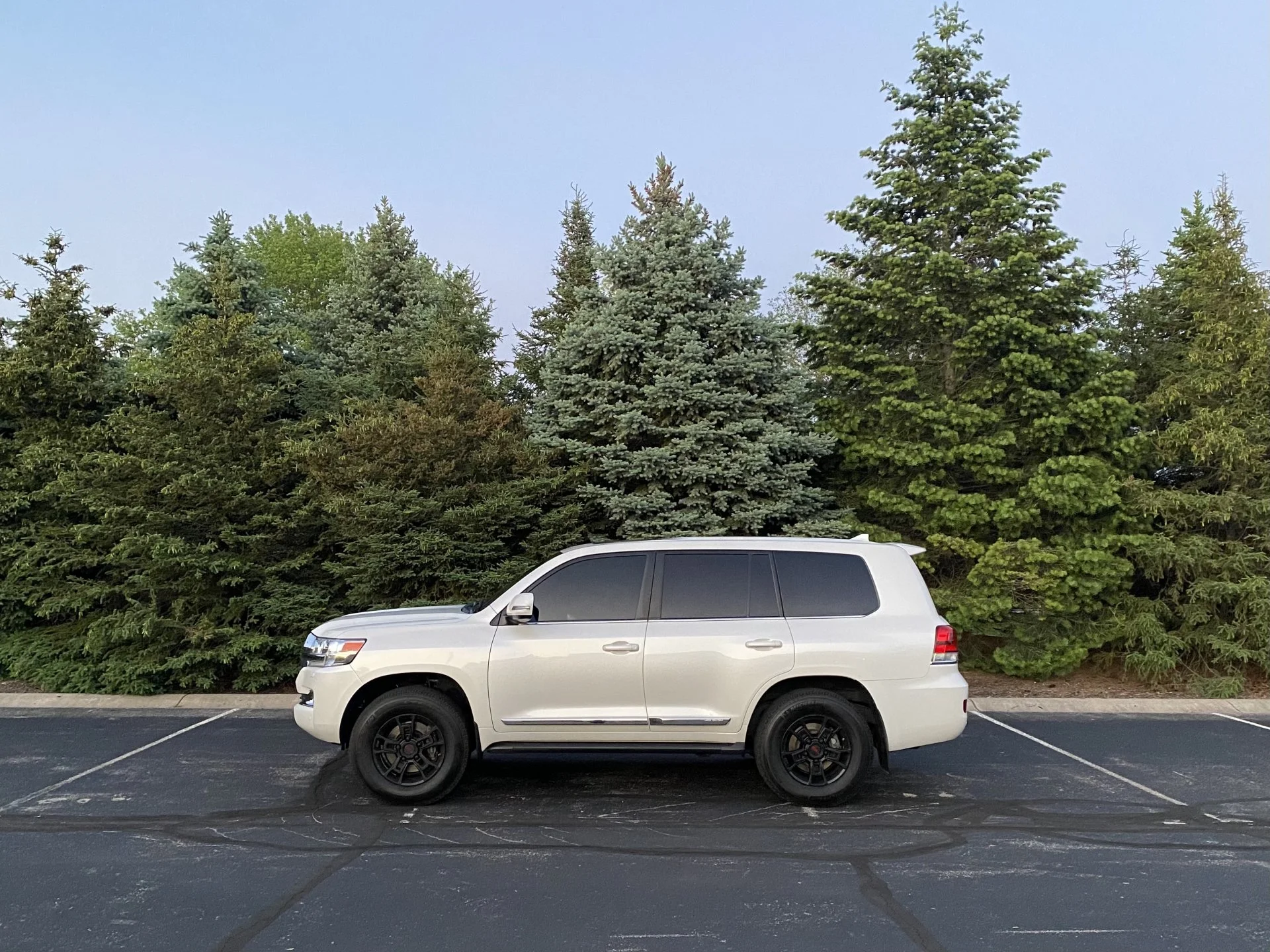

Wheels and Tires came in yesterday and now waiting until my local shop has a timeslot for installation.
Thanks for everyone's input!
