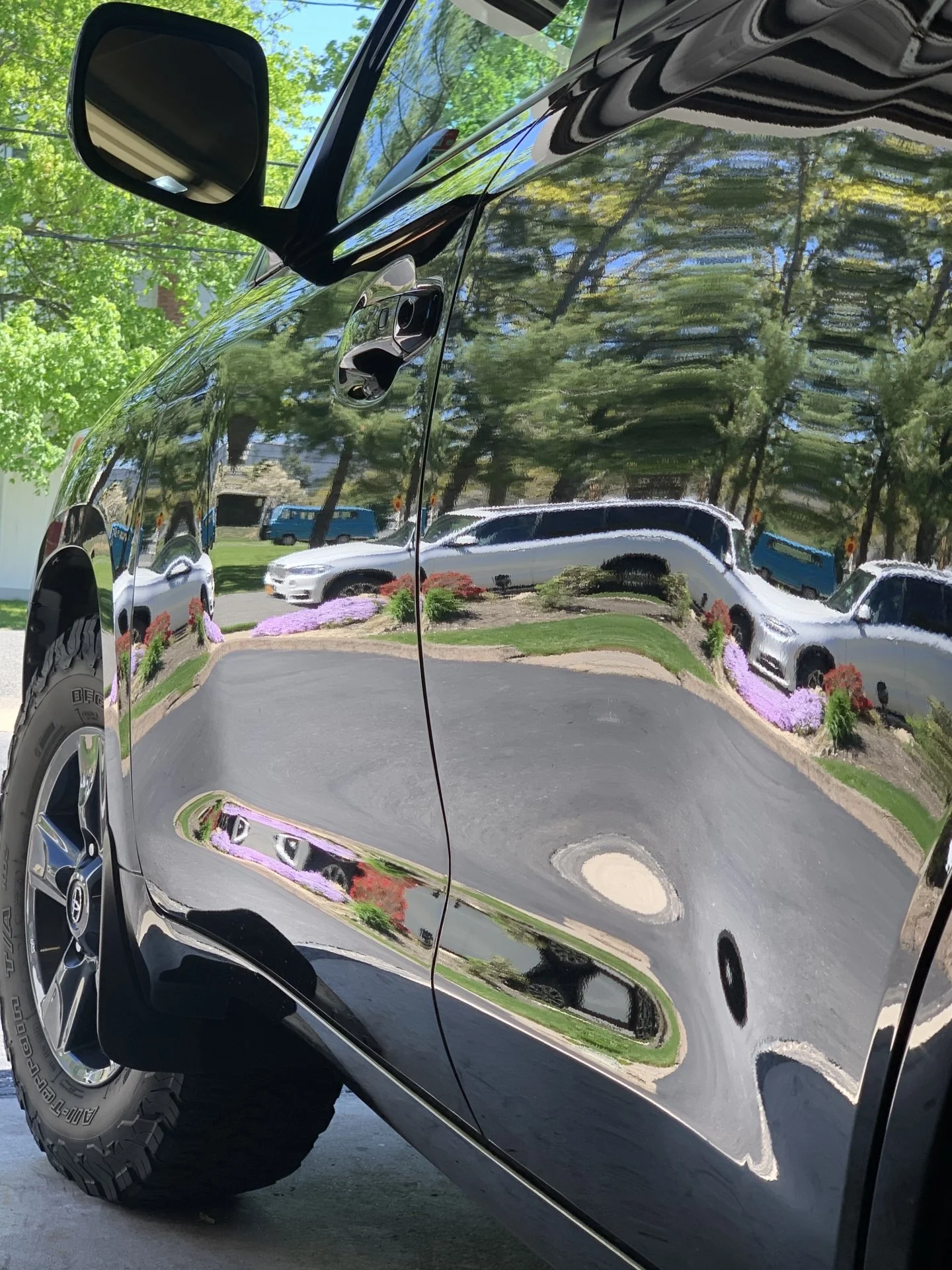

Washed and waxed my 2011.

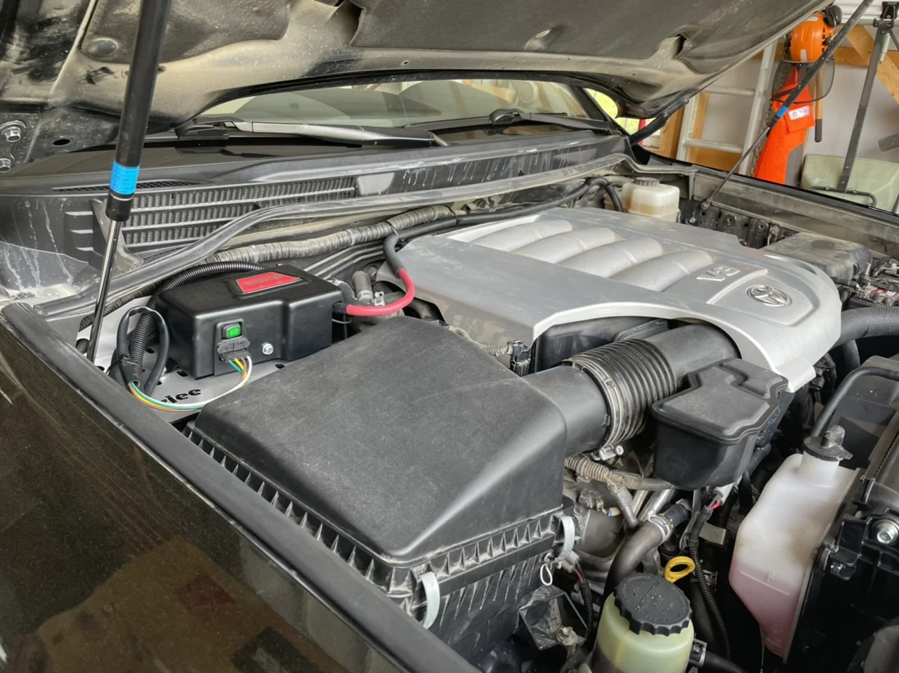

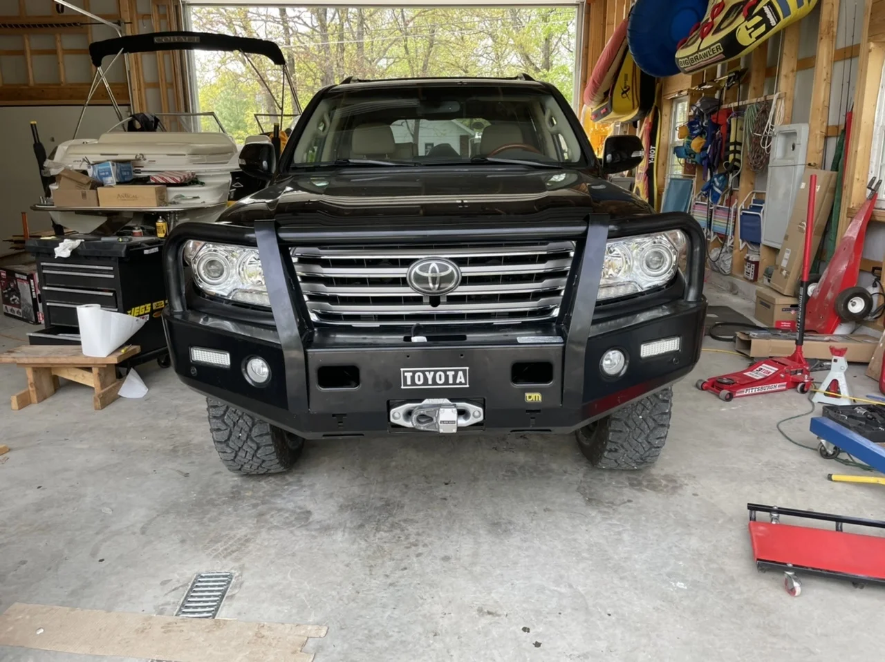

Finished install of my Warn Zeon Platinum 12-S with relocated control box on Slee accessory shelf.

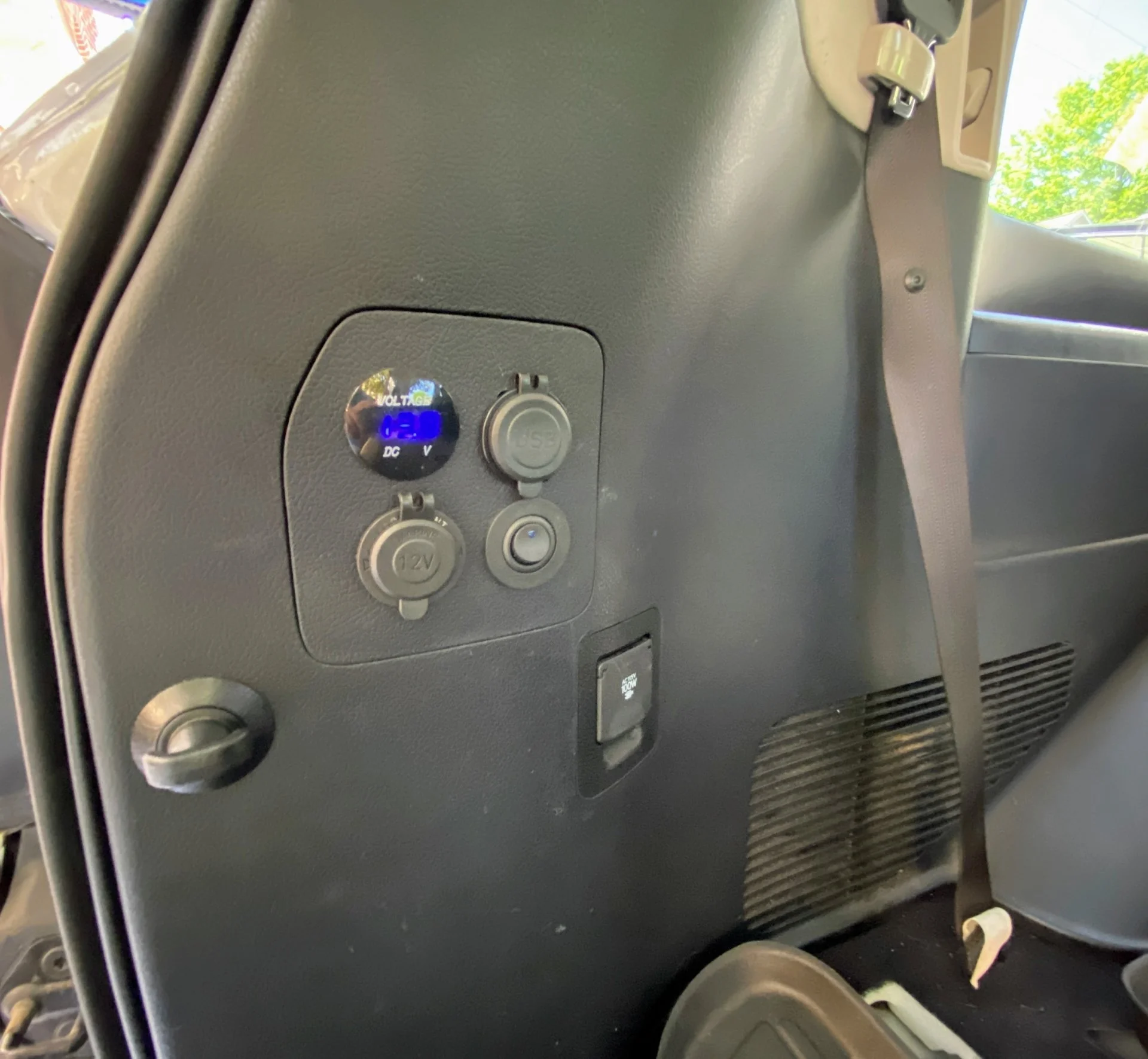

Installed a voltage meter as well as an 12V and USB ports in the back:

What made you go with the Warn over a Comeup? How difficult was relocating the control box?
I didn’t really look at Comeup. When I was looking at winches, I was worried about fitment and ease of access to control box and clutch lever. It was mostly the relo kit and the remotes ability to control the clutch that made me pick it.
The relo kit for the control box is pretty easy to install. Hardest part is deciding where to put it and how to mount it. The Slee shelf worked pretty well.
I hindsight, the manual clutch lever access is not a big issue with T13 bumper. I also wish I had researched the warn remote a little more. The battery in it drains when it’s switched off. Takes about two weeks to be dead. It works while charging so it’s not fatal but definitely annoying. There is a mod to fix that. I posted a link here on that topic.

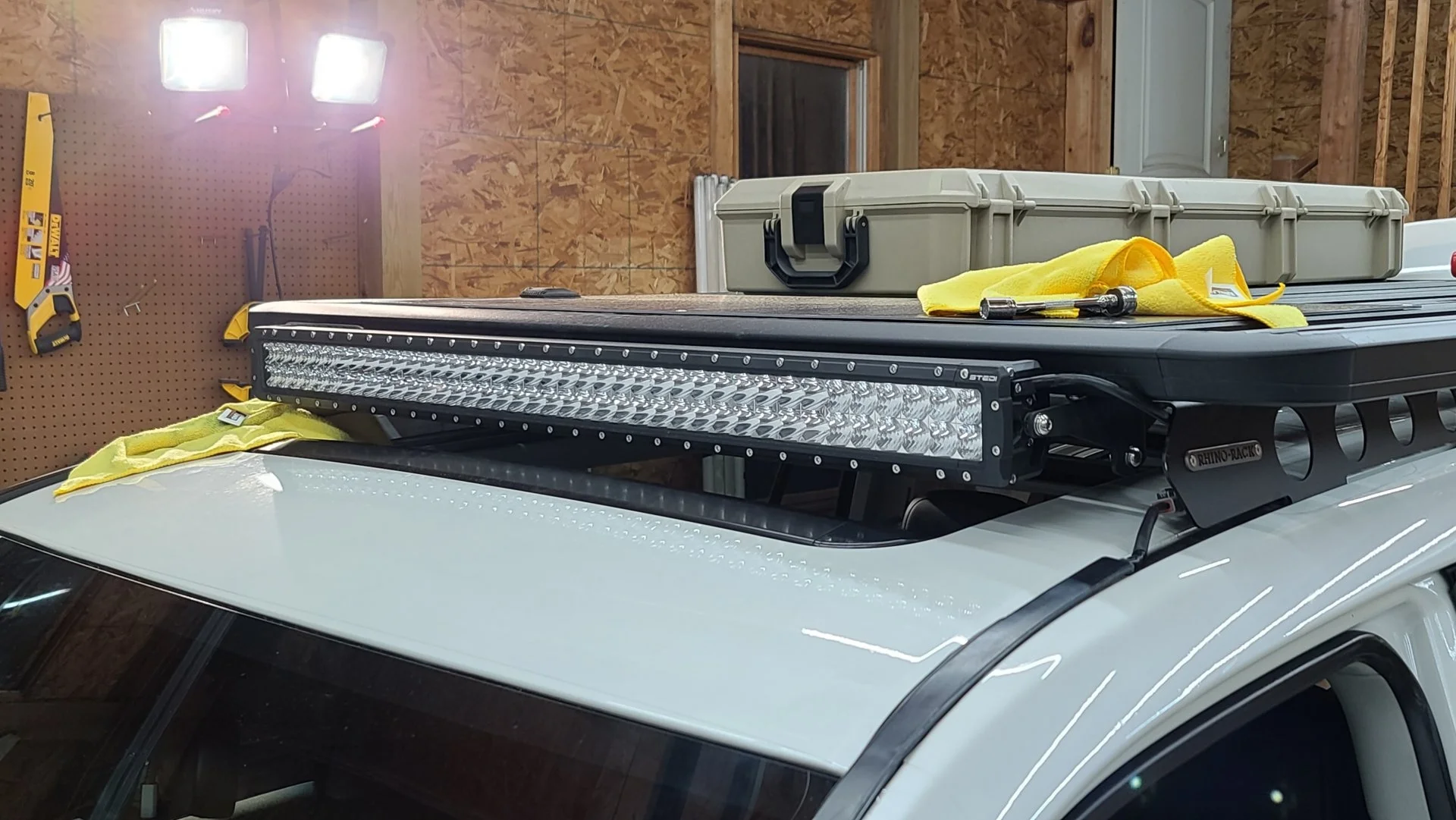

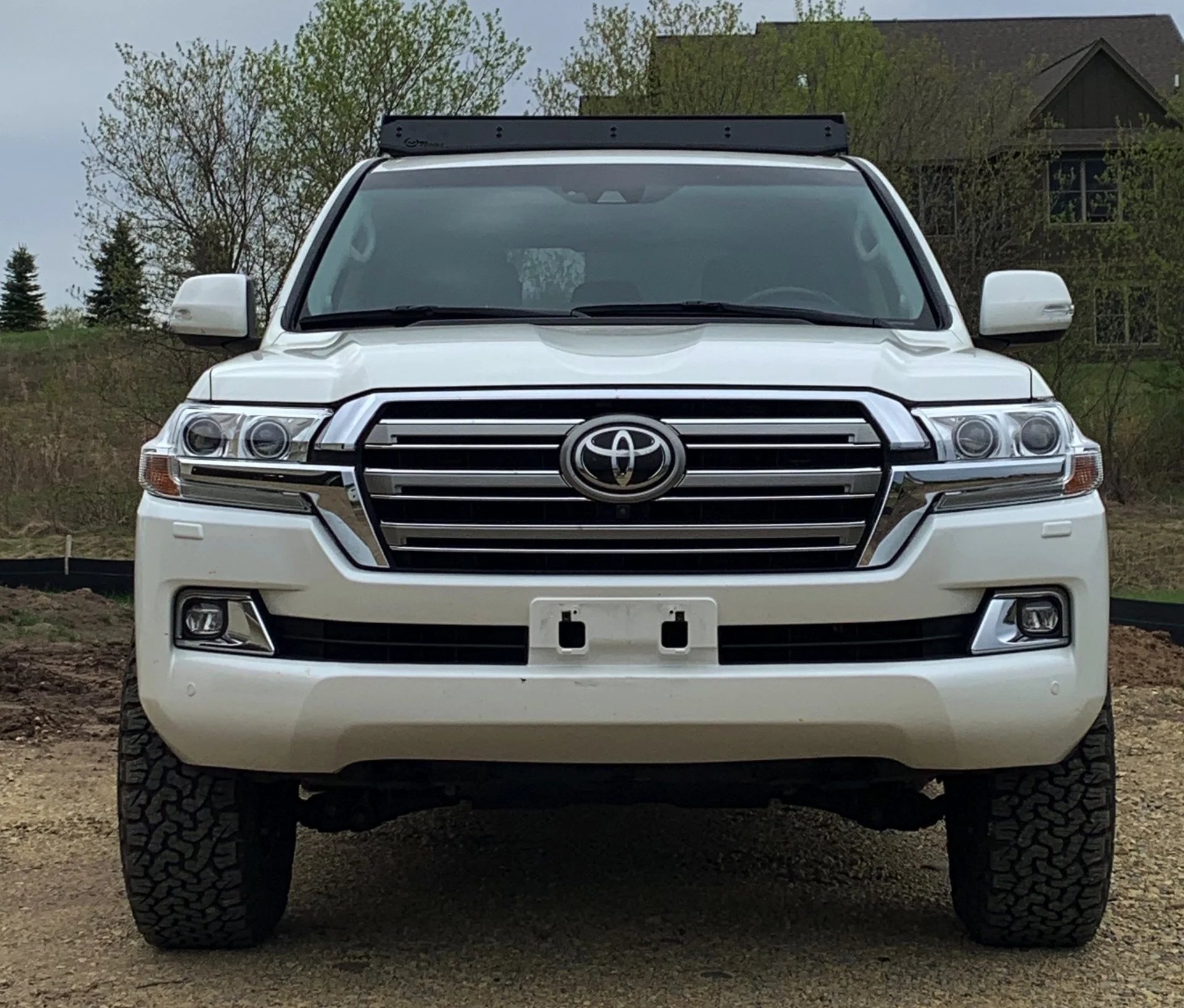

Finally got around to installing my Prinsu roof rack...Was a little apprehensive due to reading some of the challenges and "gotchas". Watched a few videos, read the thread here on IH8MUD, took my time and things worked out just fine.

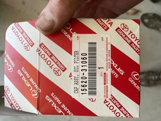

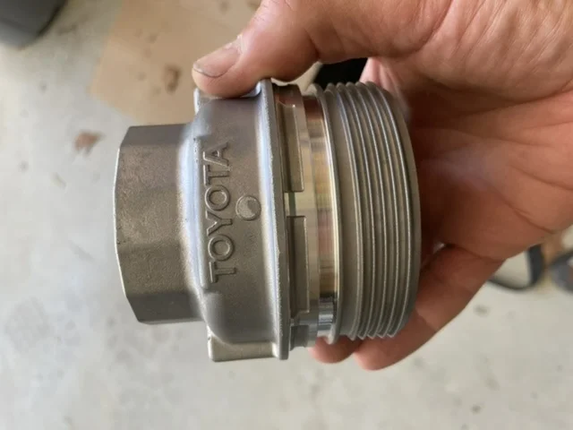

Swapped out the plastic oil filter housing for the Tacoma aluminum one. I like the Jowett housing but this is only $28 and I have a brass oil draining tool already and don't use the plastic thing that comes with the new filter.
You got a part number?
