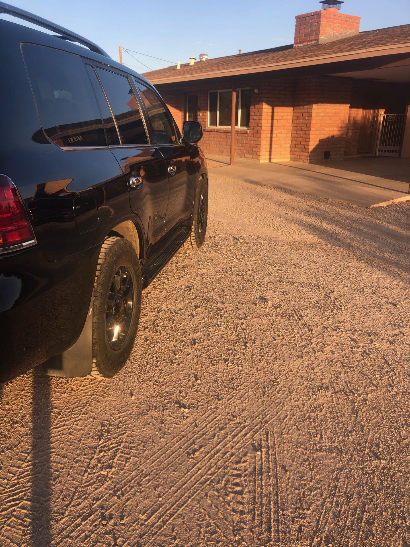

Icon Rebounds with 285/75/17 Nitto Ridge Grapplers. I removed the mud flaps and moved the bottom front mounts of the front wheel well liners forward about an inch, but still have a little heat gun work to do in the front. Overall very pleased. Slant in the photos is due to being backed into my driveway.
