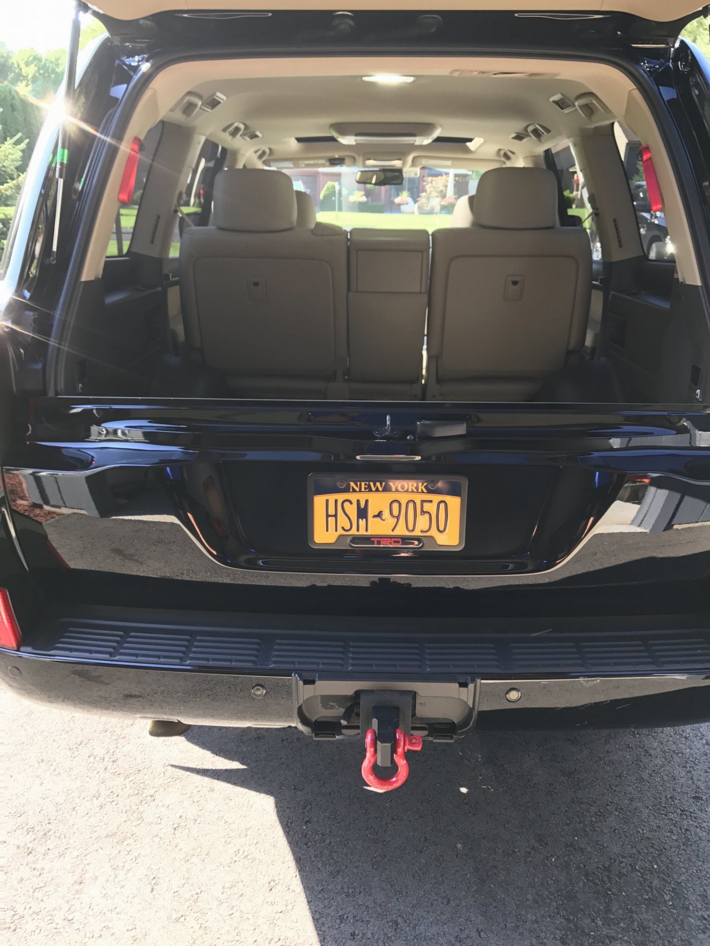

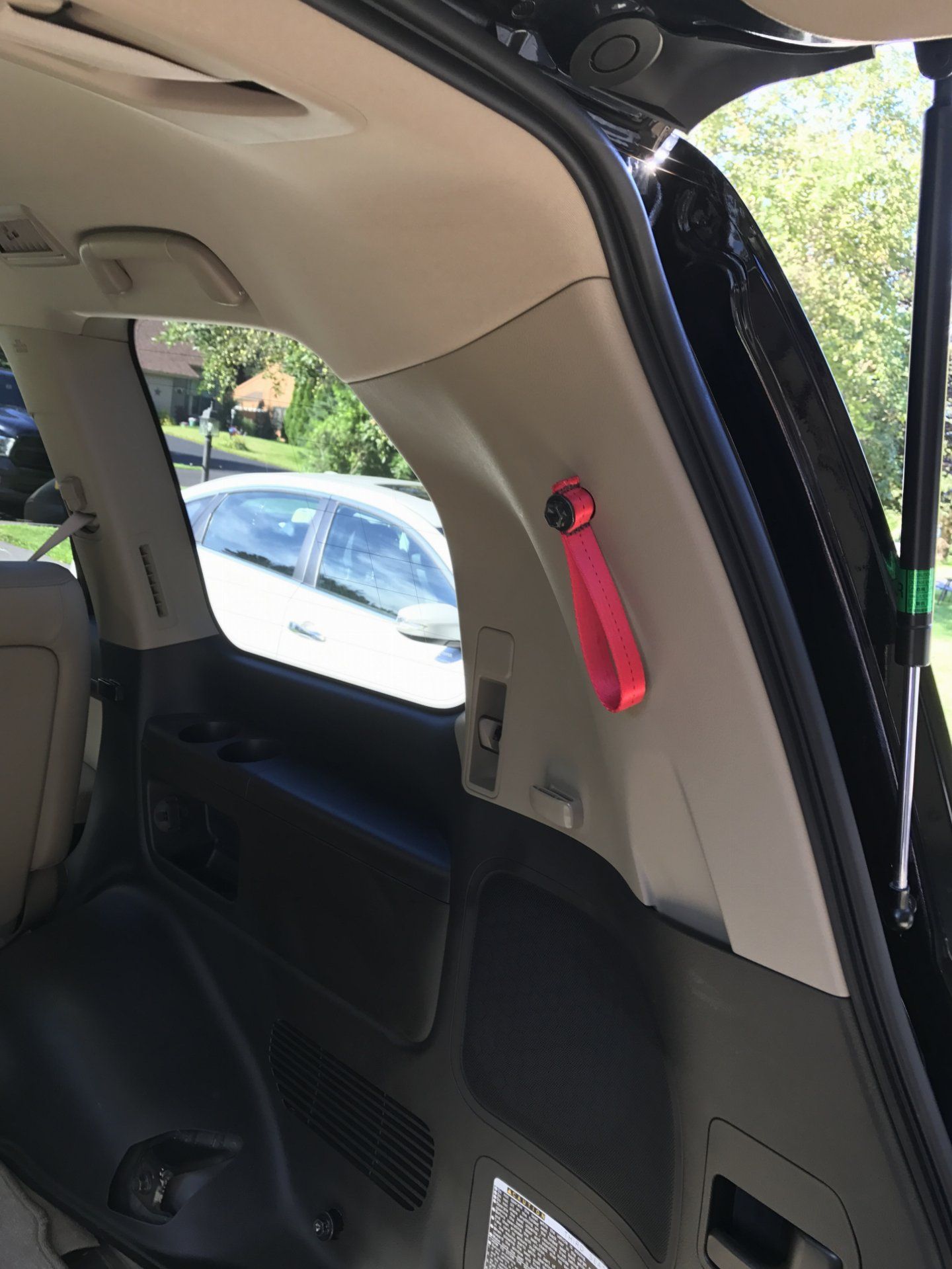

Removed the 3rd row seats and seat belts, and installed my most important mod to date.....I used the upper 3rd row seat belt anchor and had a local sewing shop custom fit straps that I can use to tie things down, pull myself up to access the roof, and use as tow points if needed. Ok, maybe not tow points, but I took the idea from @RS6tofj80 (thanks Erich) :clap:. Also replaced all interior lights with LED's including the really bright LED panel in the cargo area shown. Really happy with the results.

I have the same ARB rear bumper. Are those mini lights I see? Mine came with a rubber cover on both the holes. Would like to put "something" in there!
Nice - which LEDs did you go with? Specifically which color, brand... and which panel did you choose for the back?
Thanks!!
Here is the link for the LED that I used in the rear cargo.
Amazon.com: Cutequeen Trading 2PCS White 5050 48SMD 48-SMD LED Panel Dome Light Lamp + T10 BA9S Festoon Adapter (pack of 2): Automotive
Here is the link for the LED's for the interior and rear license plate lights.
Amazon.com: Zone Tech 10x WARM WHITE High Power LED Car Lights Bulb: Automotive
Really like the results and a fairly cheap mod. Hope this helps.

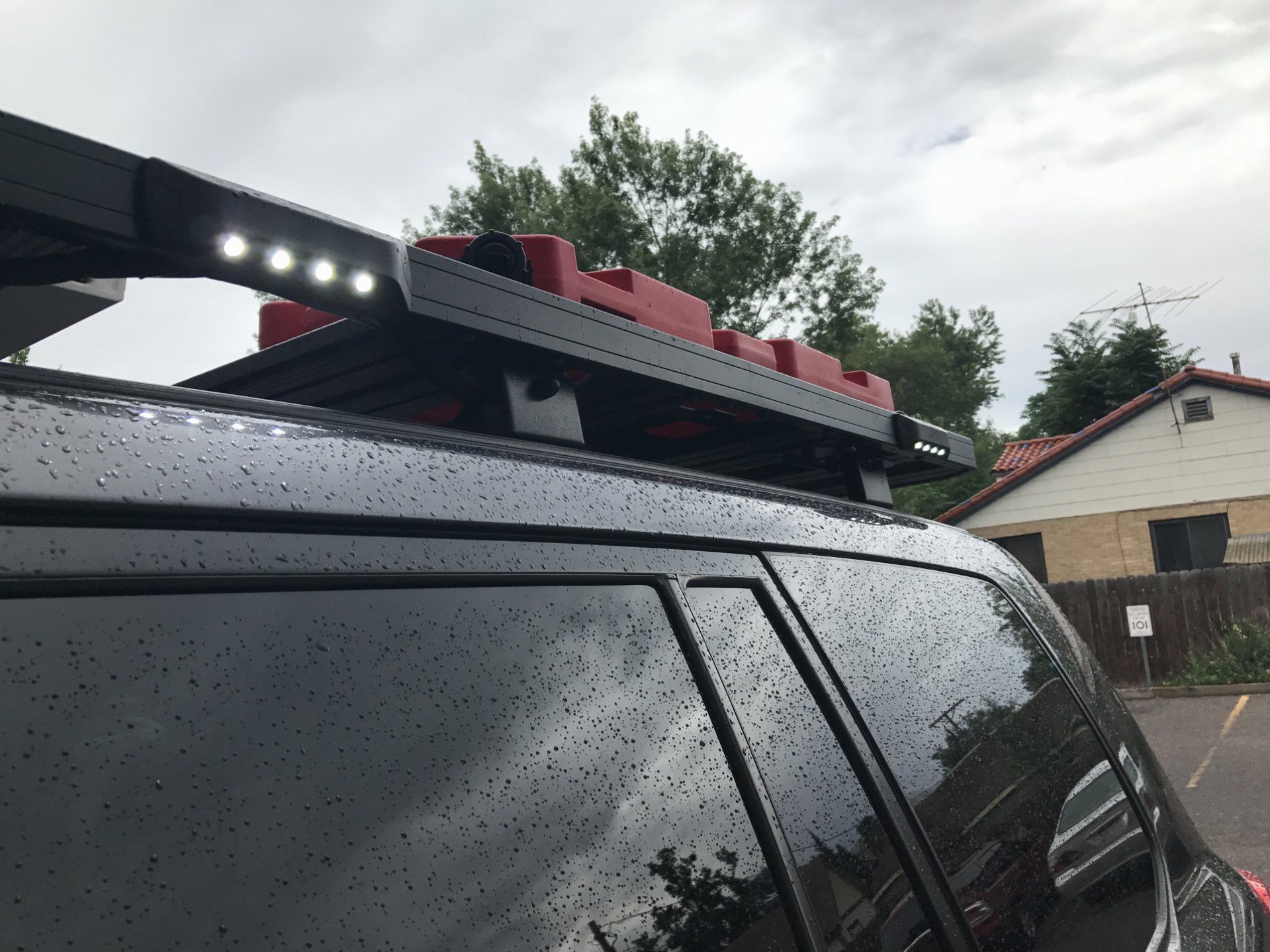

I love the side lights. What brand are they? Can they fit the stock roof rack?
I'm assuming you're referring to me? They are Labcraft SI8: LED SCENELITE (SI8) - Labcraft I honestly have no idea if you could get them to work on a stock rack because I don't have one. They are the perfect dimension for the Front Runner rack, but you can check the dimensions in that link to see if they would work.
Yes your lights. They are sweet lights, I will check with my local shop to see it it fit...I will put get 6 of them, 4 both sides and 2 in the back. Thank you.
