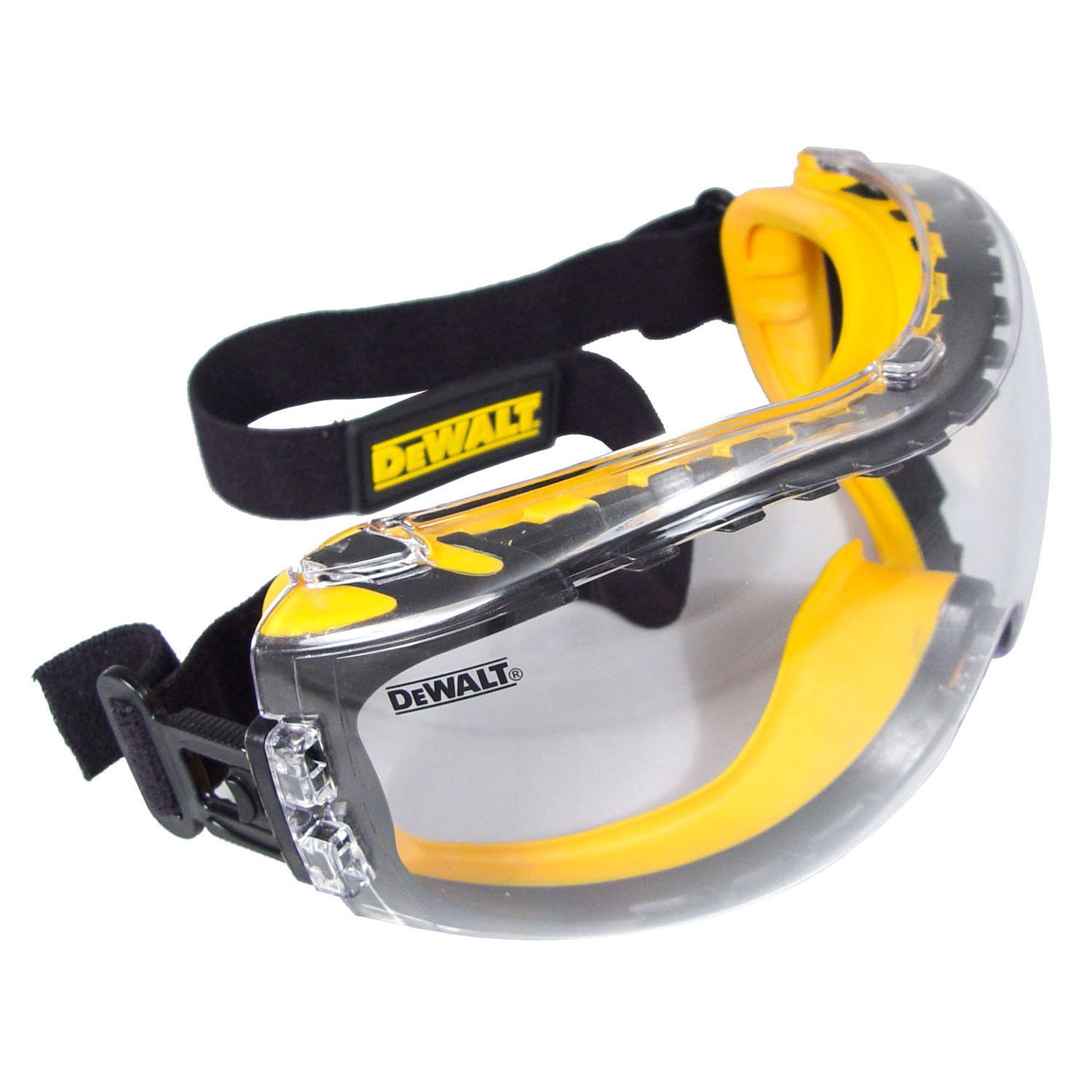

I recommend some eye protection too.
These work great whenever spraying anything and are priced around 11 dollars.
DEWALT DPG82-11 Concealer Clear Anti-Fog Dual Mold Safety Goggle - - Amazon.com

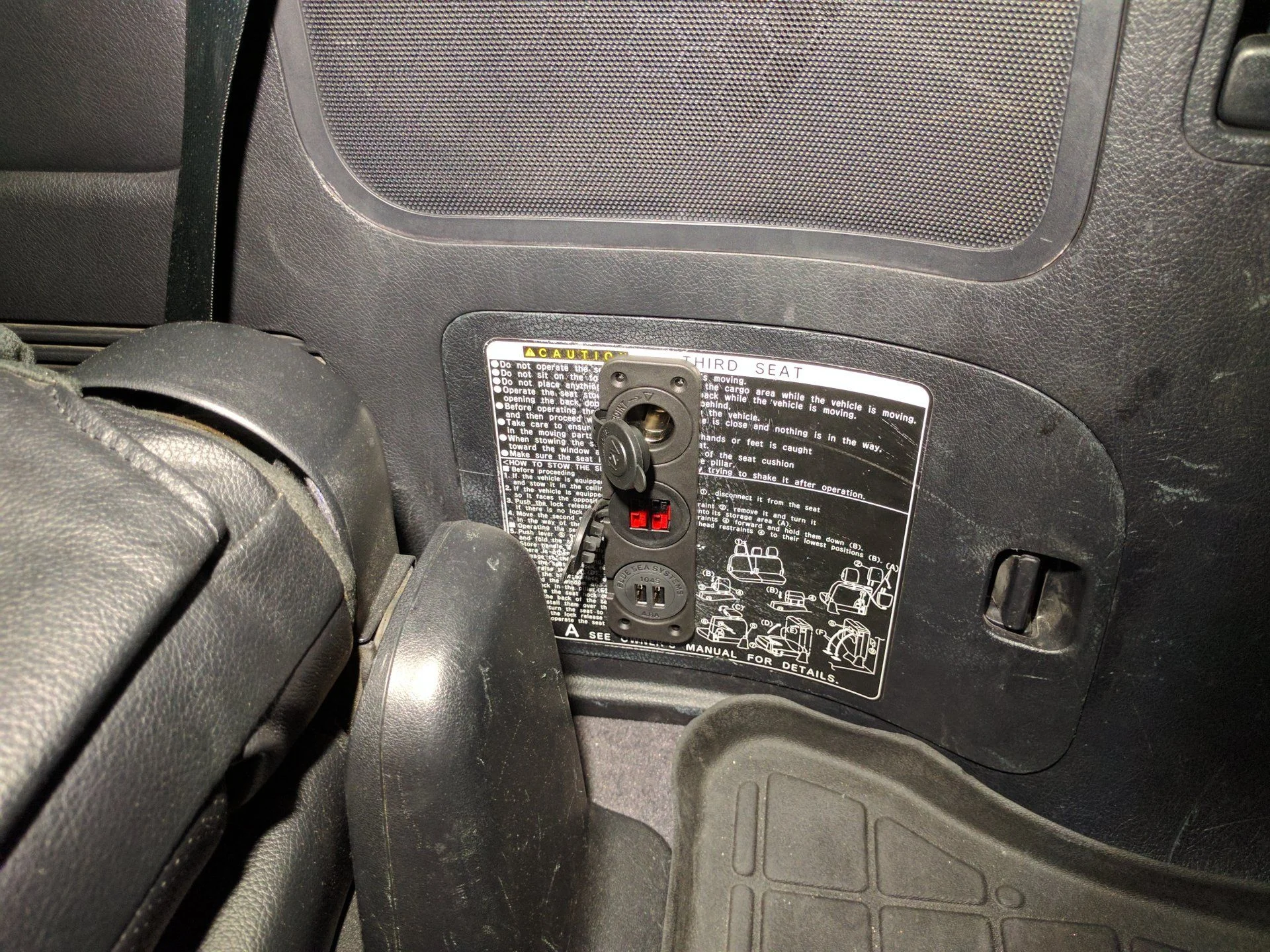

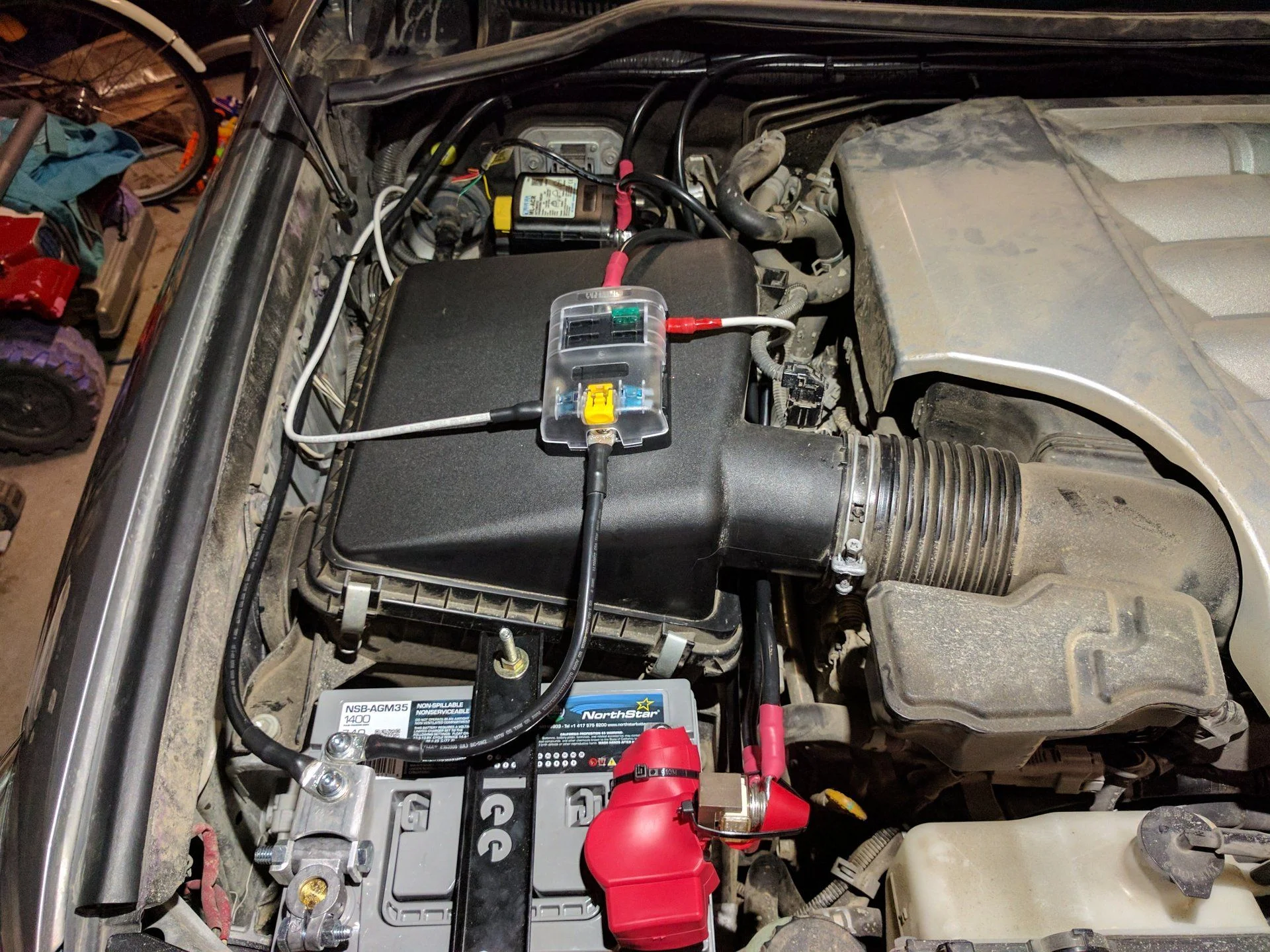

Got to work on some electrical today too. Installed dual battery system based on Blue Sea 7622. Northstar GRP 35 AGM. Added (2) 100A circuits, one to feed the passenger side and one to feed the driver side (one or the other will be used to send power to the roof in the same manner Kreiten did. Also ran a 35A circuit to the rear that powers (3) options: standard 12V, dual Power Pole, and dual fast charge USB. Under the hood I added another dual fast charge USB port for powering the GoPros. I still have to add the contura switch to the cabin but ran out of time. Next up I'll be adding some under carriage lighting and (2) 13.5" swivel LED lights to the rear hatch, I've got it all wired and one of them mounted, unfortunately the other was DOA so I'm waiting for the replacement (superbrightleds.com). I'll add pics once I have them mounted as I'm sure I'm not making much sense unless you happen to know what they look like. This was really the first time I worked with electrical bit it was fairly straight forward, I did do a lot of pre-planning so that I didn't have to rewire down the line for future upgrades.

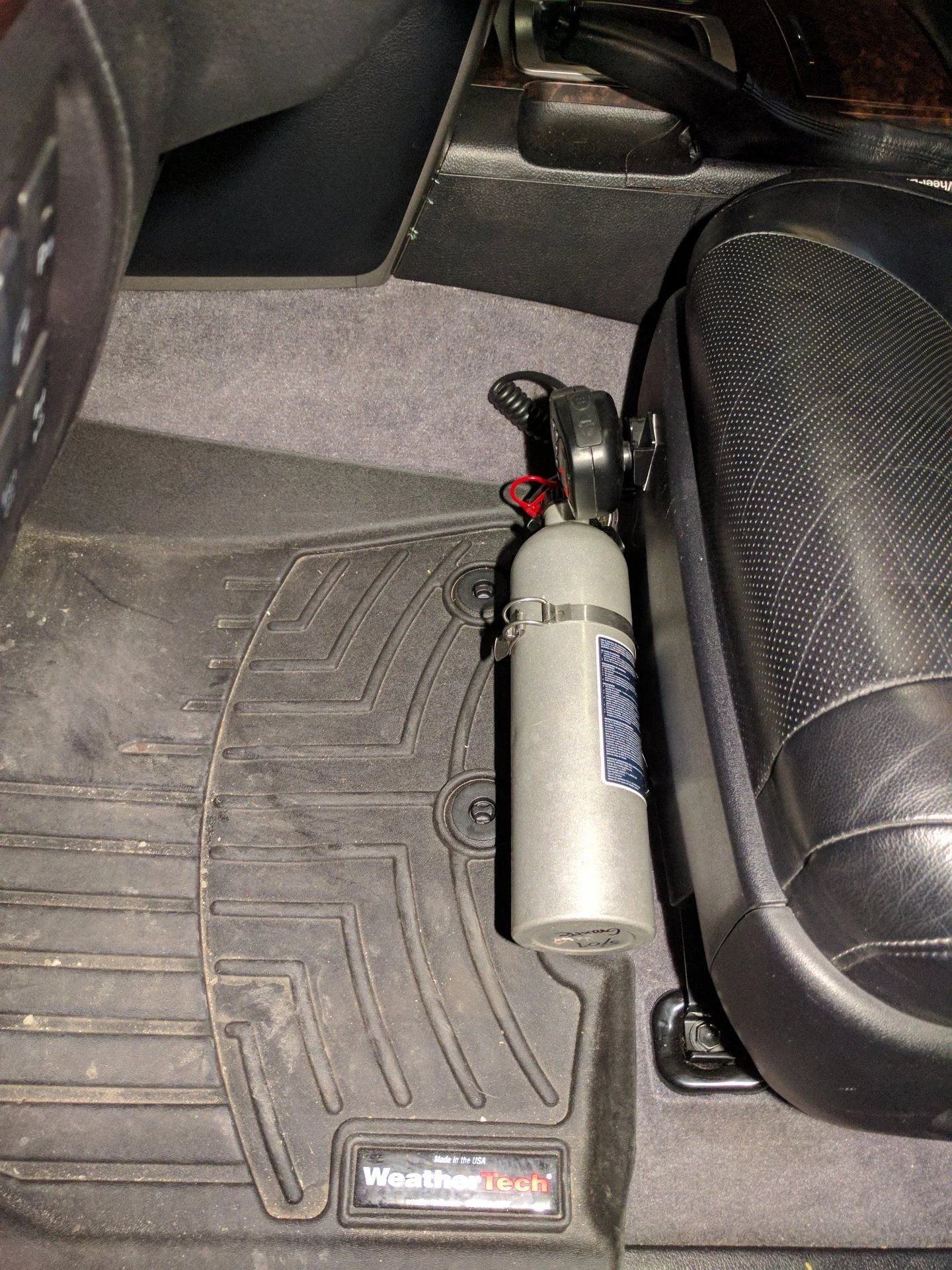

Oh and added the fire extinguisher mount and a CB radio. Can you tell I'm excited for Moab!?!? 10 day trip planned around it, can't friggin wait.

@Mogwai What brand is that rear power port?
The USB and 12V are Blue Sea, the other is Powerwerx PowerPole. I think I bought all of it from Powerwerx however, including the 3 hole plate. All individual components so you could pick and choose based on your needs.
