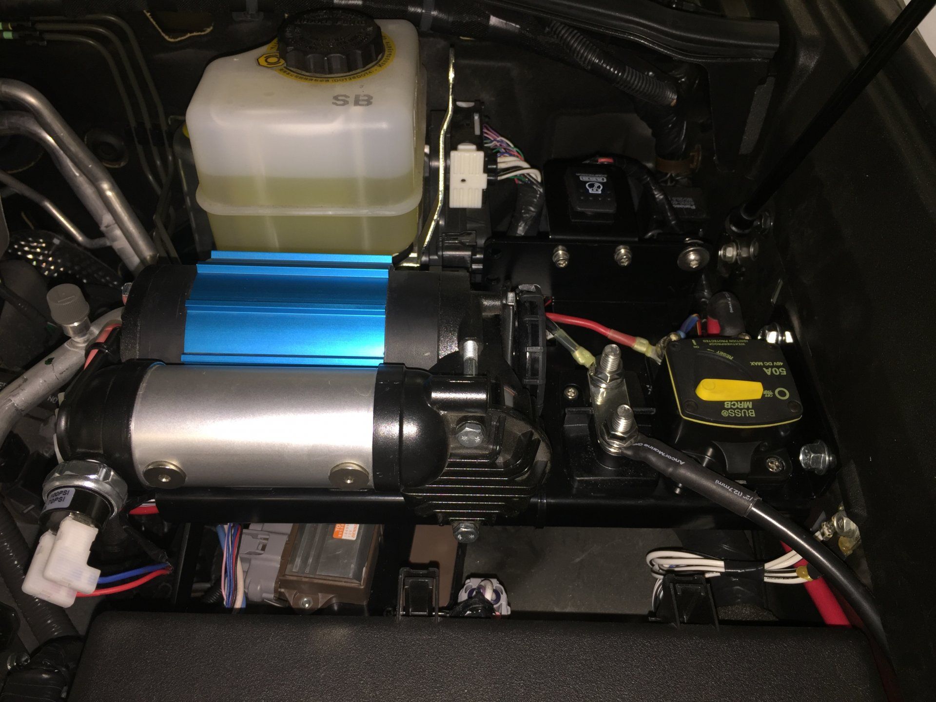

Chased down a few bad electrical connections and replaced the wiring with new high quality harnesses. Also installed Slee's group 31 battery tray and fitted an Interstate AGM7 deep cycle battery in anticipation of the ARB fridge which should be here soon. Still got a few things on the list before Moab in less than a month!
