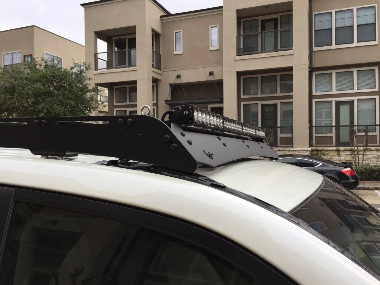

Got the rack on

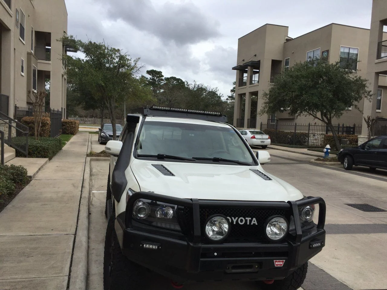

Finally mounted up the Baja Design S8 light bar........ damn this thing is bright and throws light so far down the road for it's size...... not as far as the ONX6 50" that i had on my Heep but it makes the Hella 4000 seem useless....
The bar fit perfectly into the valance on the Prinsu - and it is dead quiet VERY happy !
need to clean up the wiring when I get back after my trip to Kooks this week, but it'll be awesome for the drive...

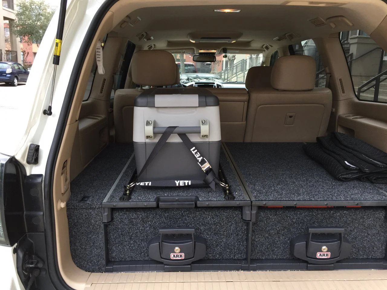

Also got the tiedown mounted on the ARB drawers - have a spare second set for anyone local to houston, decided not to have them on both sides.

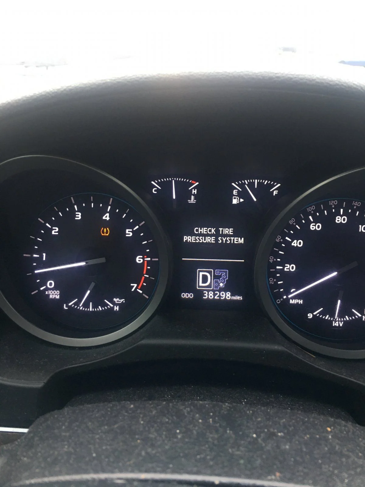

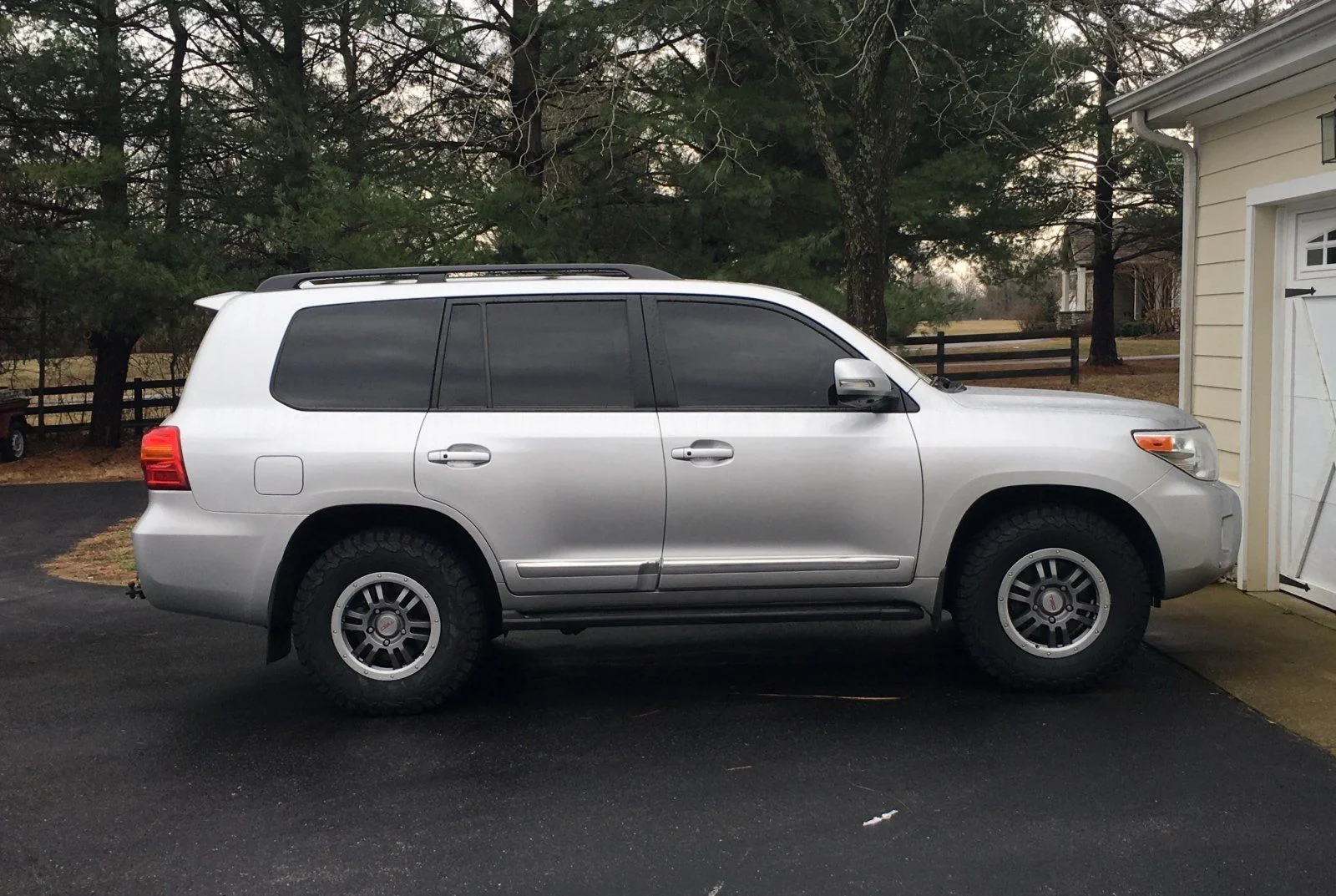

Got RWs on finally. TPMS not working.
What do I need to do now?

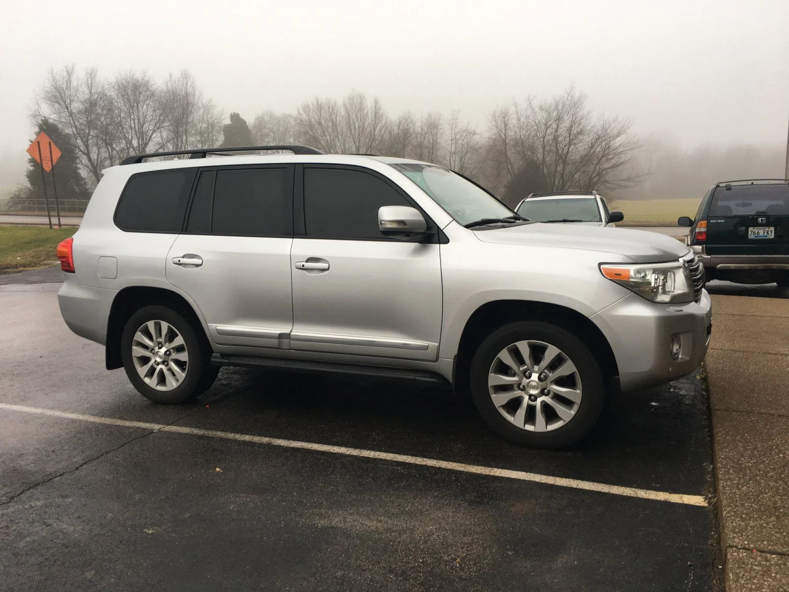

Before picture
Looks great!
When you say "not working" do you mean not at all? Or just not showing the correct tires (like showing the spare pressure when it's really on a corner spot).
Did you re-use the same TPMS sensors from your stock wheels?
If so, you shouldn't have to do anything, unless the spare (5th sensor) is missing.

Before picture
Easiest bet is swapping the tpms sensors to your RWs and they 'should' work. Discount Tire charged me $40 to swap sensors. If the sensors are from a RW Tundra (according to my dealer so take with a grain of salt) they aren't compatible with the LCs.
Otherwise, off to the dealer to have them techstream it. My local wanted $90 for a reprogram.
I've read where people order Toyota TIS off eBay to manage sensors. Anybody?
You can order the Mini-VCI cable and download the software. Getting the software to work on a 64bit system takes driver trickery though. If you have an old 32bit laptop it'll be far easier, getting the software key for your version can be a pain but do-able. I won't go into details on here for obvious reasons.
RWs came with TPMS included. Old rims still have oem sensors in them.
-If you had swapped your old TPMS into your RWs, they would have worked fine. Since these are sensors the computer hasn't seen before, you'll have to have them programmed to be recognized by your system. The best way (in my opinion) would be to have them cloned to match your originals, because then you could swap wheel sets without needing to reprogram...
-I think Discount Tire was wrong. They work fine on either Tundra or LC. The difference in sensor build angle is different only if switching from steel wheels, but OEM and RW are the same sensor type. If you Tundra wheels were steel? Then ya.
It was the Toyota dealer that told me this. But like I said, the dealer isn't exactly the most reliable source of credible information.

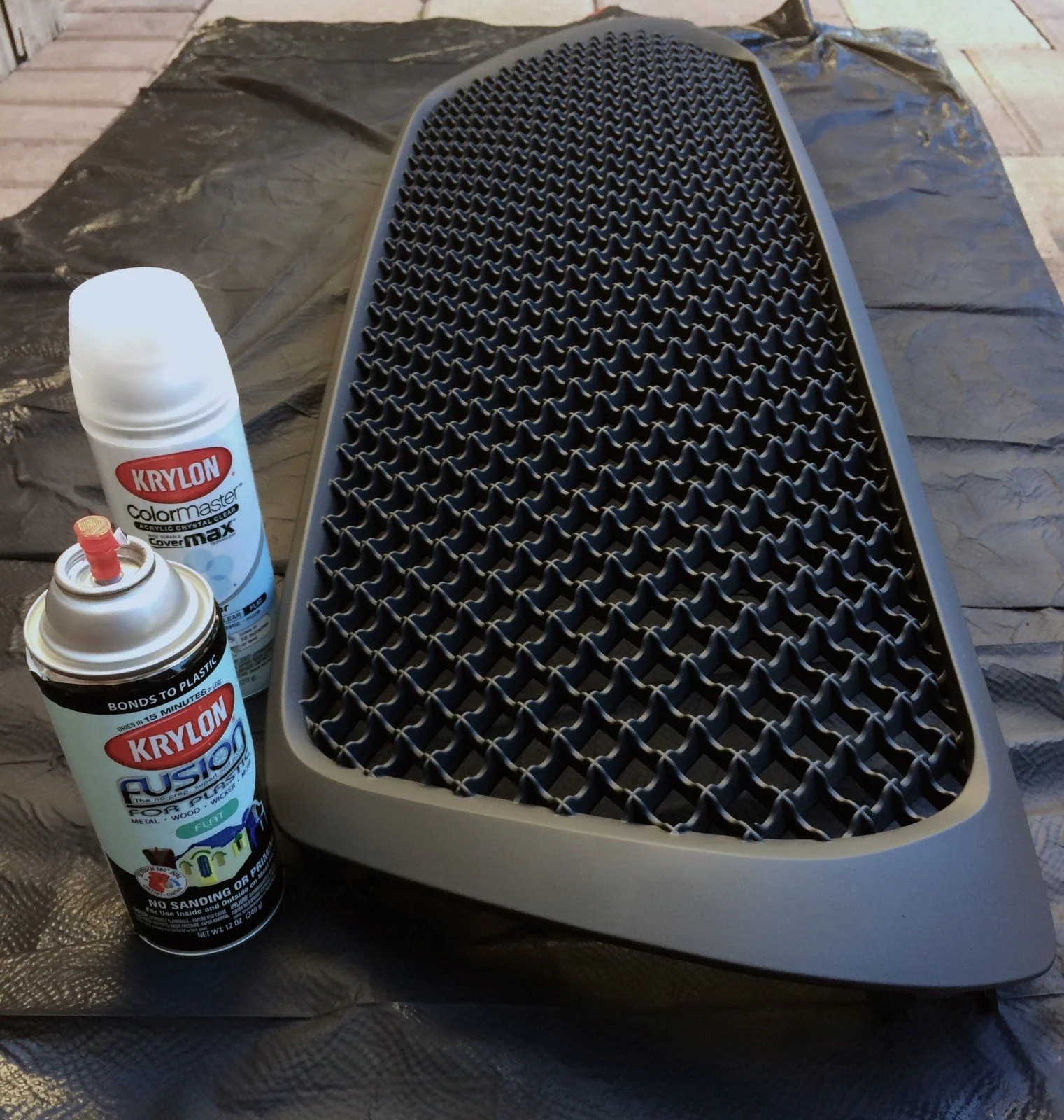

I decided I didn't like how SHINY the black grill was as it came...so I applied flat black plastic fusion paint.
I figure it will better match my eventual bull bar. To me...unless you have a shiny black Cruiser, a super shiny black grill looks a bit off...
I noticed it looks lighter in this photo compared to in person. It's flat black...

Ah. I mixed up KY's post with yours. :)
Discount Tire will repack each of them for like $7-9 each... And ya... Who knows what Toyota was doing... ;)
