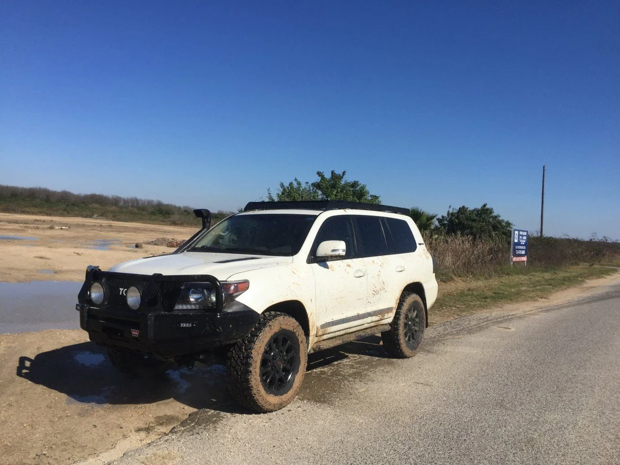

put her thru her paces extracting a friends heep........ I hate mud..

@Genoks - I'm running nothing in the front but it's wider then OEM due to the Tundra arms ( roughly 1.65 inches it seems) I also am adding a 10mm spacer this week to get better clearance to the KDSS and change scrub angle a bit... in the rear I have 1.25 Slee/ spidertrax currently - but have a 1.5" custom set enroute.
I am going to be adding 10mm rear coil spacers and cranking the front up a bit but it seems to clear so far when cycled with a forklift and lightly wheeled....

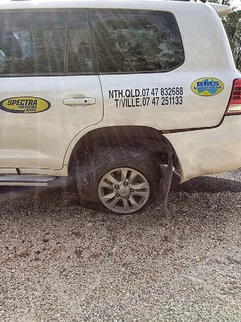

@NQCruiser - what are we looking at here? blow out or tread delaminate? bumper looks like its a bit outta whack
Here's an adjusted version that shows a bit of detail in the tire.
It looks quite shredded in this zoomed part...

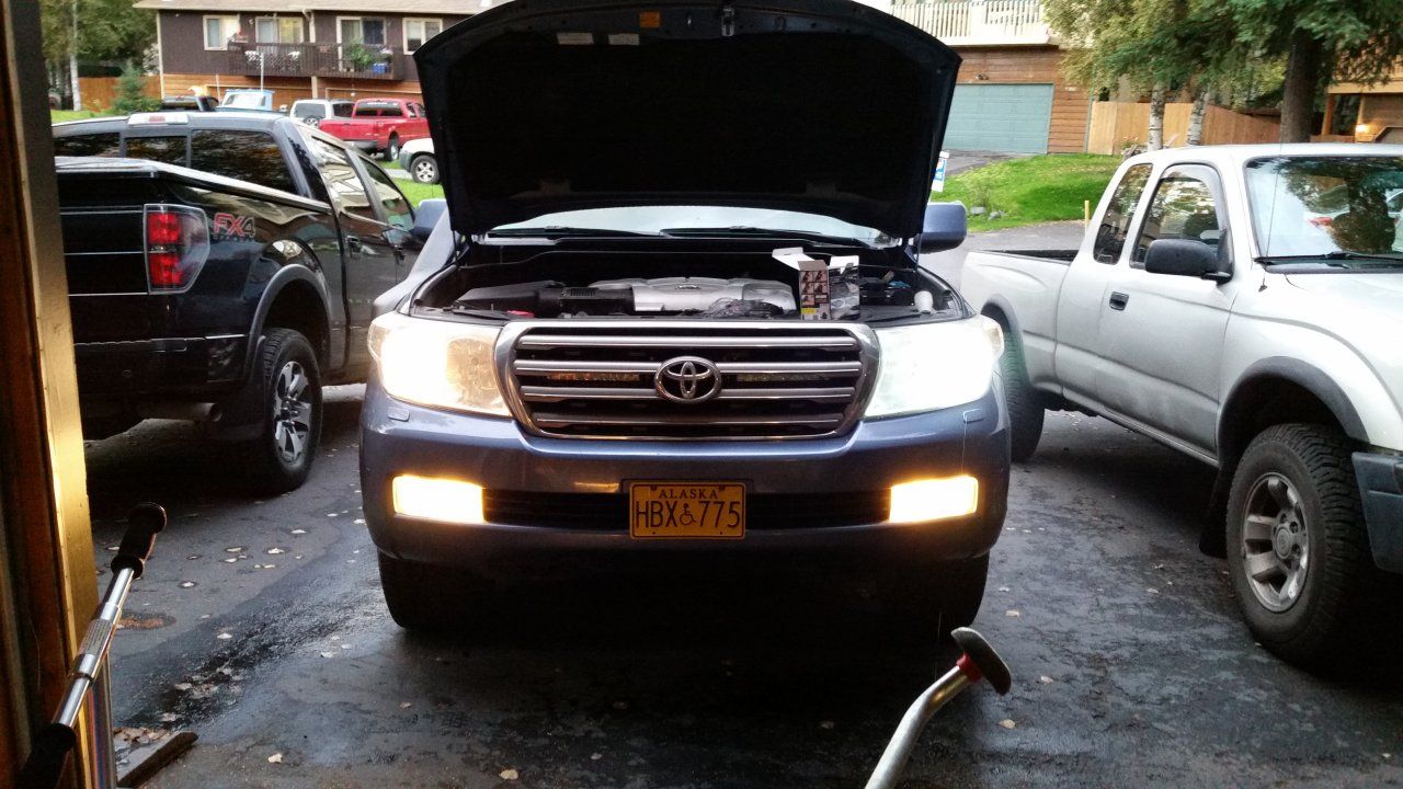

Few things I did that I never posted: IPF LED bulbs (Amazon.com: IPF LED bulb headlight 6500K H11 12v20w 301HLB: Automotive). Right is the LED vs halogen on the left. Bulbs fit with dual battery, I'm very happy with them.

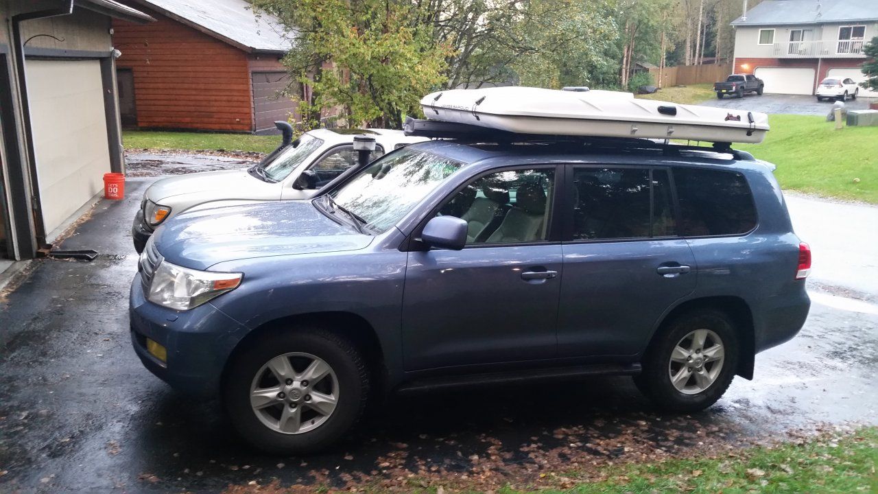

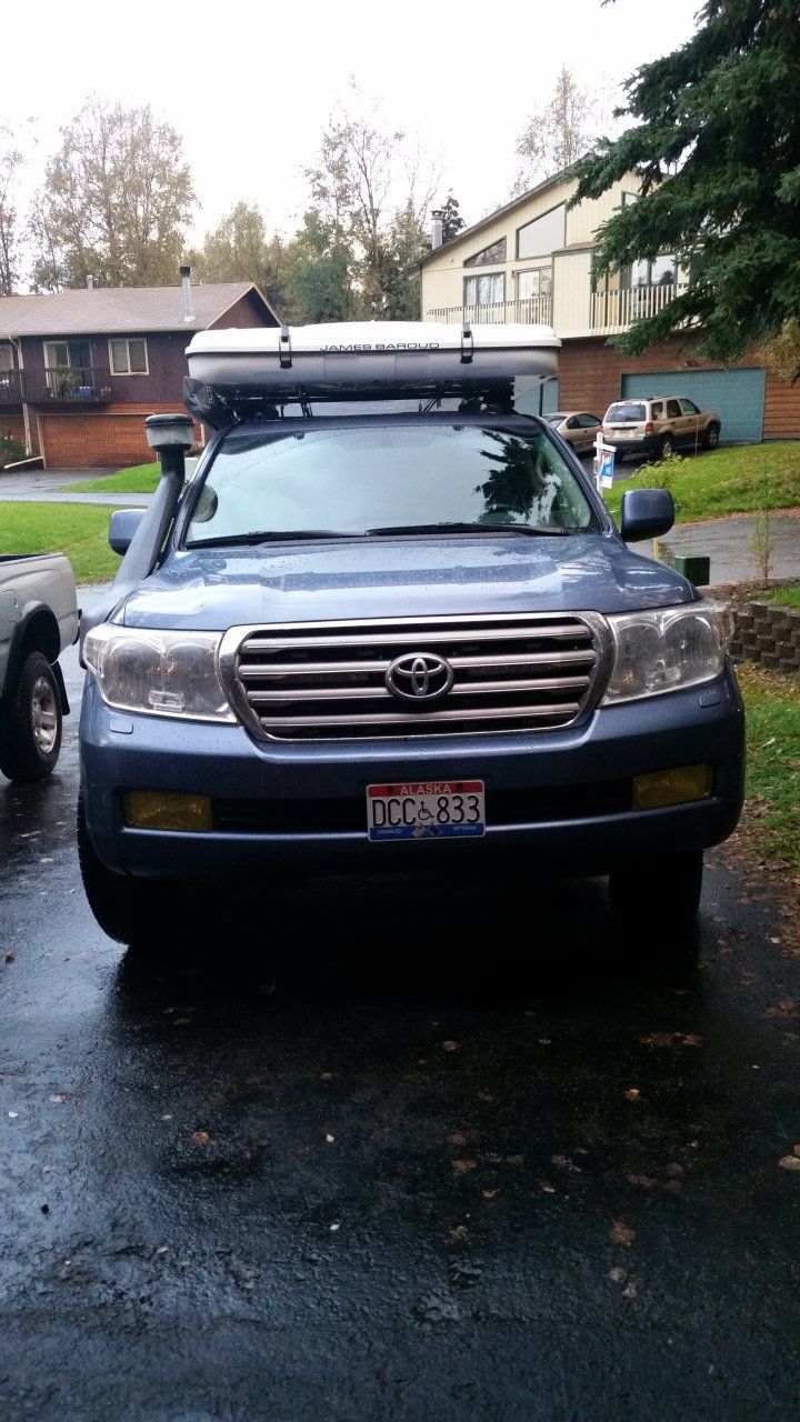

Interior lights upgraded with these (Amazon.com: Cutequeen Trading 2PCS White 5050 48SMD 48-SMD LED Panel Dome Light Lamp + T10 BA9S Festoon Adapter (pack of 2): Automotive) Super bright. Added one to the front also (soldered it onto the LED bulb lead). They're stupid bright, great upgrade. Also, I never posted pictures with my RTT on, here are some I found.

Those James Barouds are so nice.
Alaska is the one area I’d go ahead and get a RTT... Slept in a tent in the northern boonies of the Brooks Range with a very nervous wife because grizzlies were aaall over the place one year. A RTT would have been super helpful.
