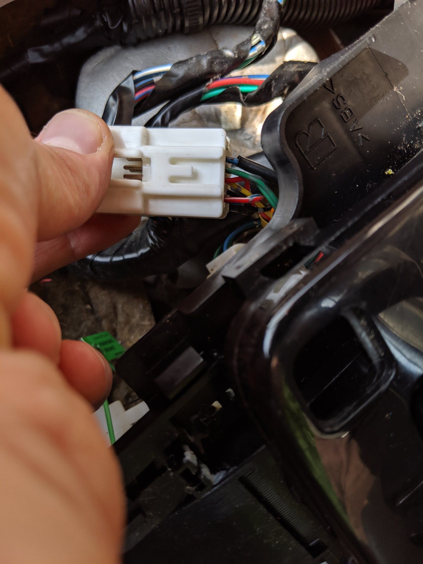

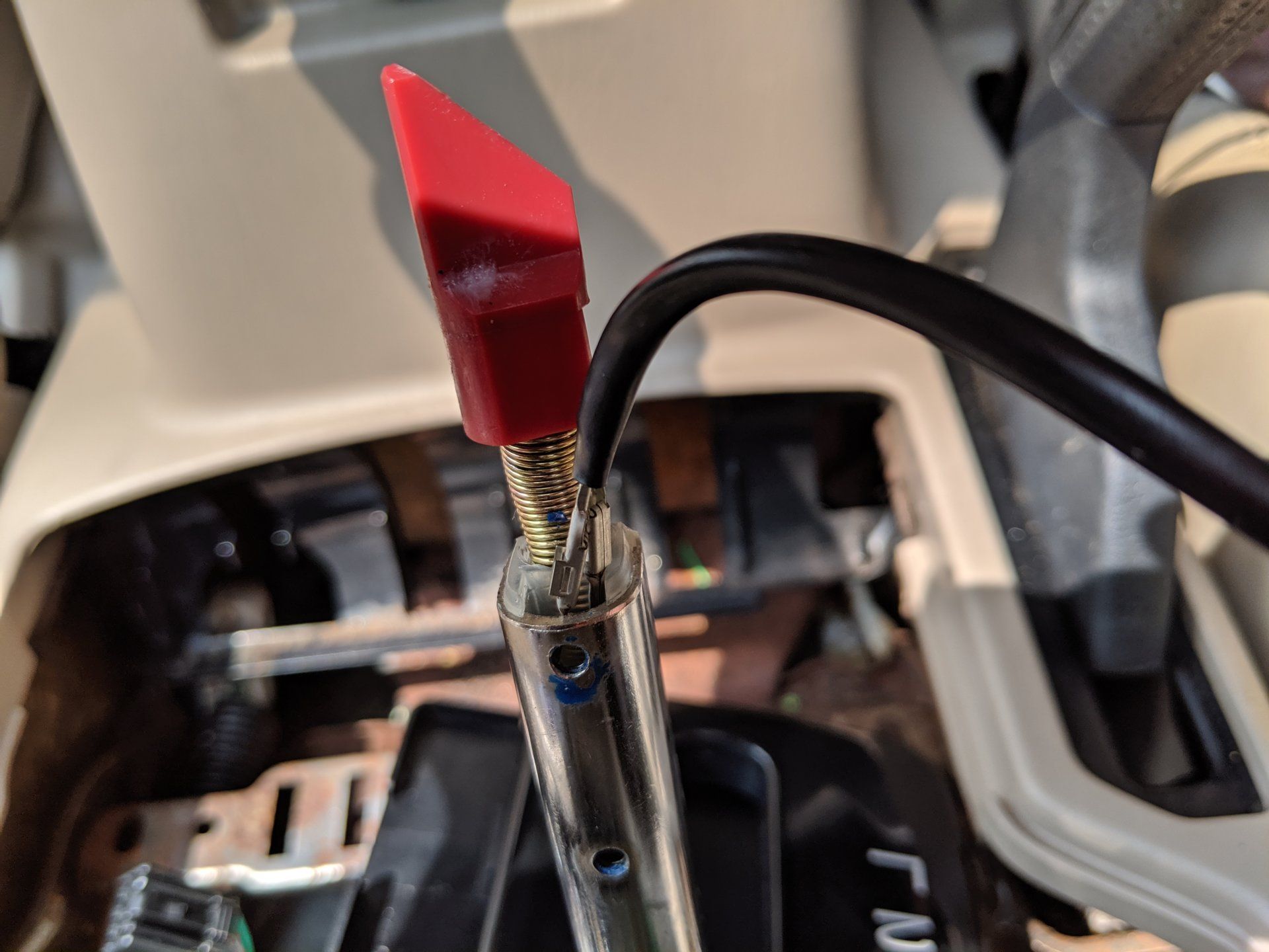

The two pins with blue wires that connect to the OD button on the shifter, run through the silver shaft to wire harness under the lower position indicator housing. They need to be disconnected to remove the shift know and replace the control position plate. Follow the black wire from the shifter to find the correct connector.
Once the main cover (with the cup holders and buttons etc.) is removed, disconnect the white connector (where the red arrow is below), unwrap the wire from around the housing, and then pull out the two pins out of the connector. Use a straight pick to lift the tabs holding the pins as you push the pins out through the back of the connector. You can see the black wire cover coming out of the bottom of silver shift lever shaft. Once the pins are out of the connector, remove the two screws from the shift knob and then pull the shift know straight up, guiding the wire through the shaft. The old Control Position Indicator Plate pops off on 4 corners and new one pops right back on. Reverse to re-install.
