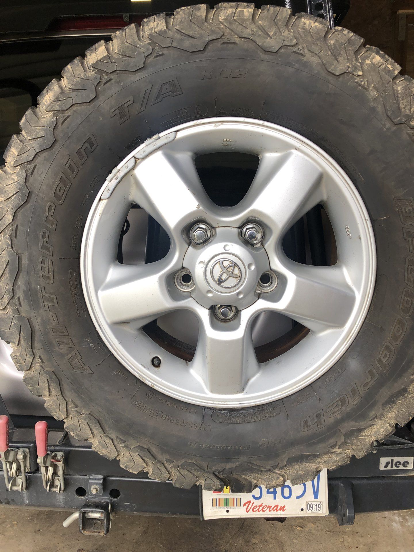

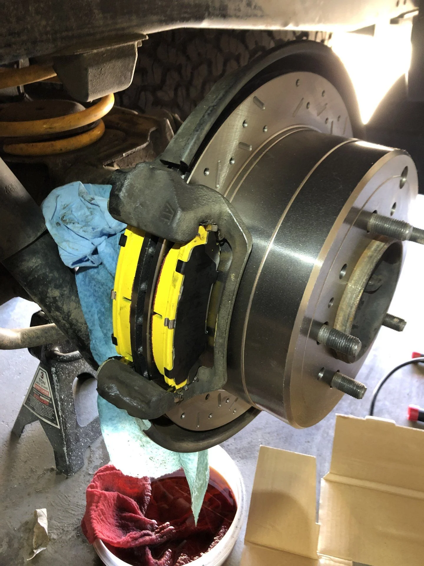

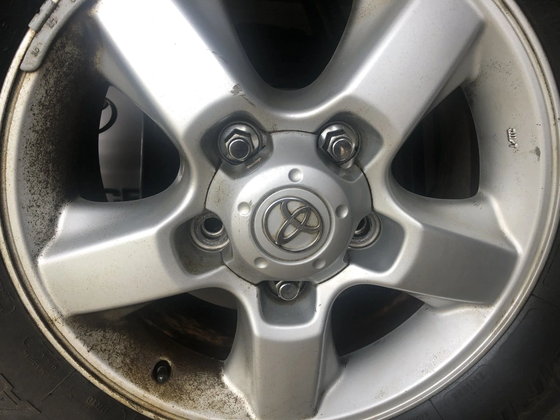

One other thing that happened when the right rear brakes went metal to metal.....
The rust shavings got into the dirt and dust that was on the wheel and flash rusted to the point that I could not get it off.
I ended up having to polish it out with a wire wheel on my drill and WD40.
After I got it all off I put wheel polish on it to protect where I may have gotten into the clear
I thought it was ruined but the best looking 100 series wheel ever is back and bright and good for another 21 years

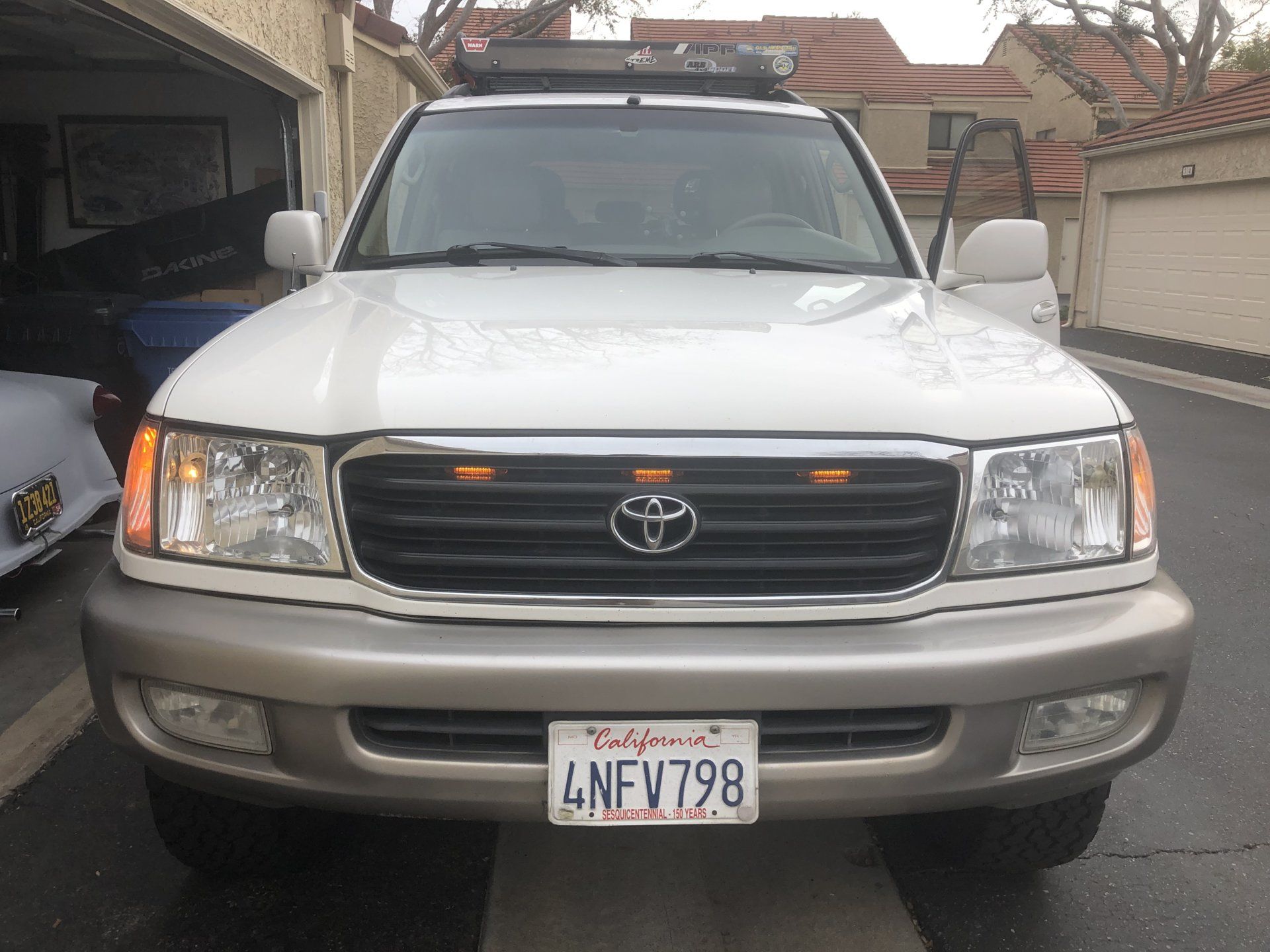

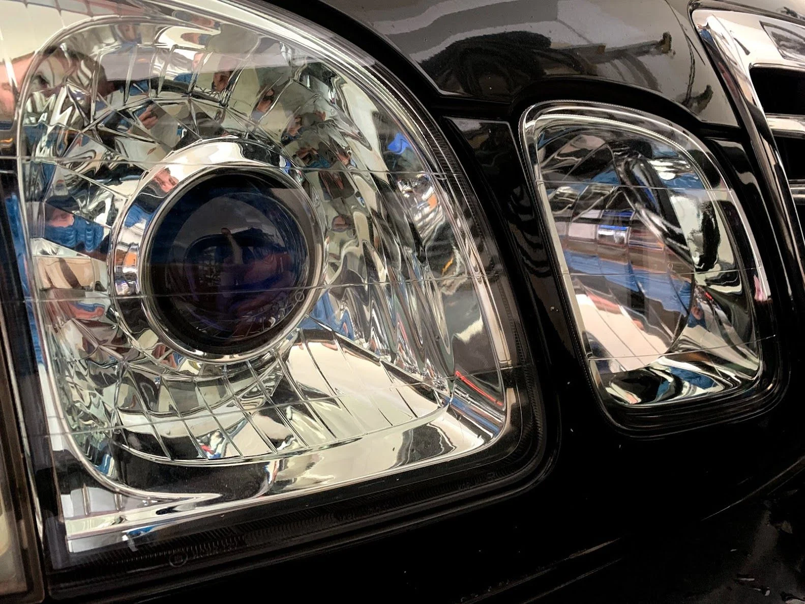

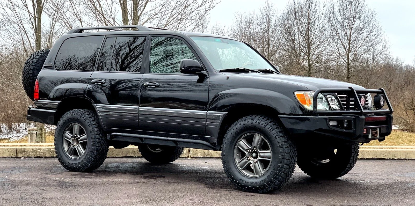

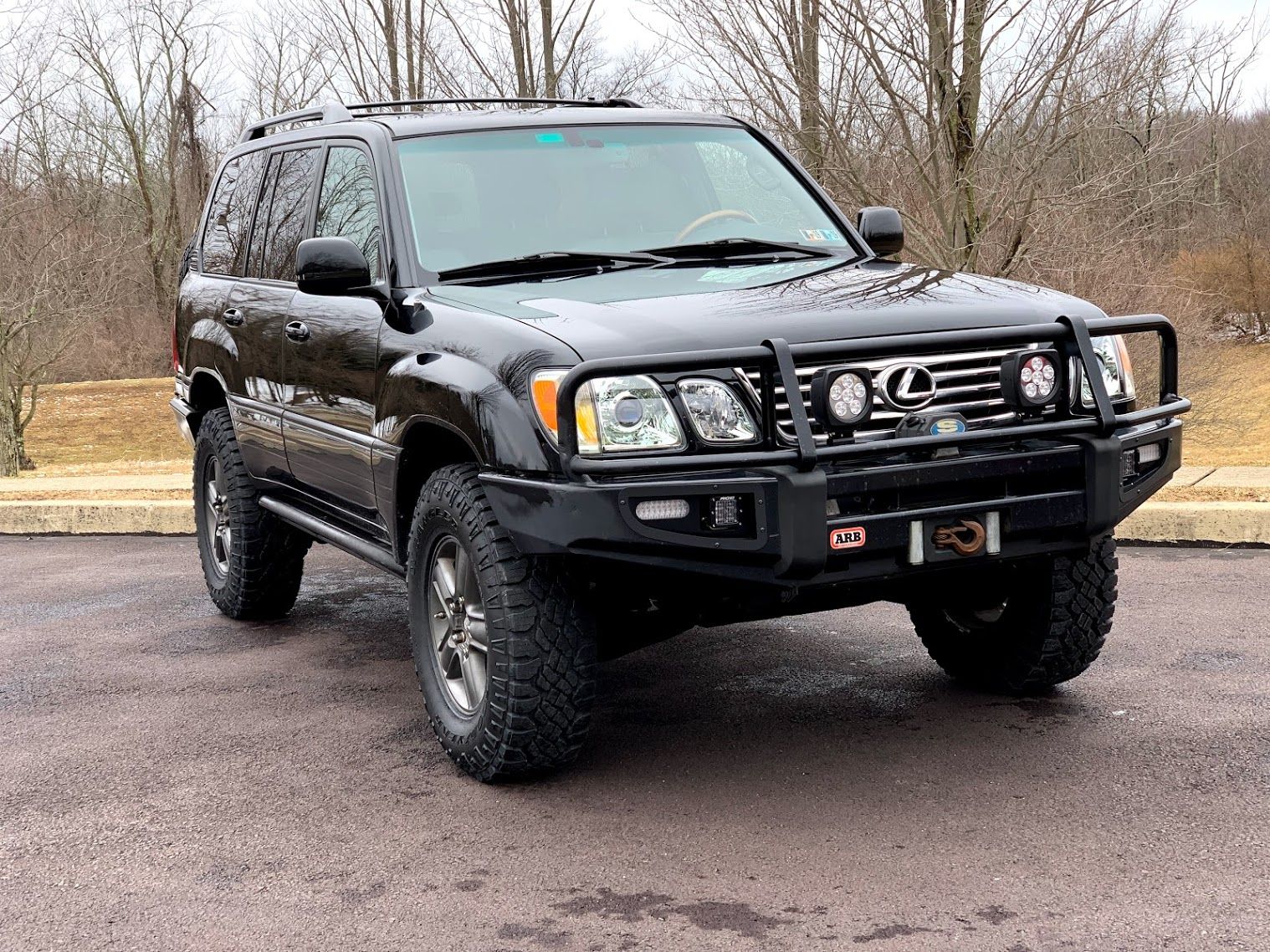

Completed some visible and not-visible maintenance. On the visible side, installed brand new headlights, with a proper HID conversion, courtesy of @Luke111. It was a very nice straight forward install, and they "look" great -- haven't had a chance to try at night yet.
1917774
1917775

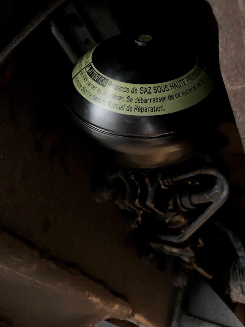

On the invisible side, I replaced all the AHC globes with new OEM ones, and torqued the torsion bars to get the pressures back to spec. It rides like it's on a cloud (better than I ever remember...)

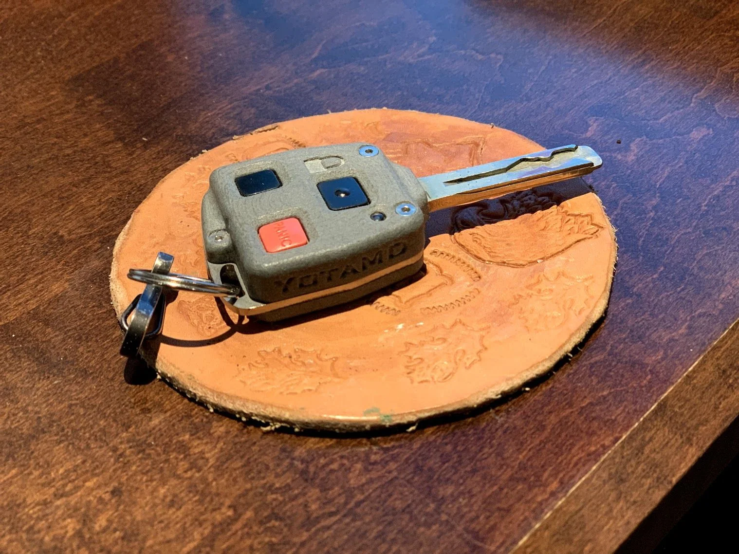

...and finally on the invisible, and totally free side (for once), I re-programmed my key to unlock all the doors on the first press, instead of fiddling with the double click to unlock them all.

Really great looking truck!

How did you reprogram your key?
Installed LED turn signal relay, no more hyper-flash!! Yay!!
I used the Techstream to plugin to the car, and then used the vehicle customization options to change the behavior. You can separately change how the remote works, vs. how the actual door mechanism in the drivers door affects the other door locks--I changed both.
