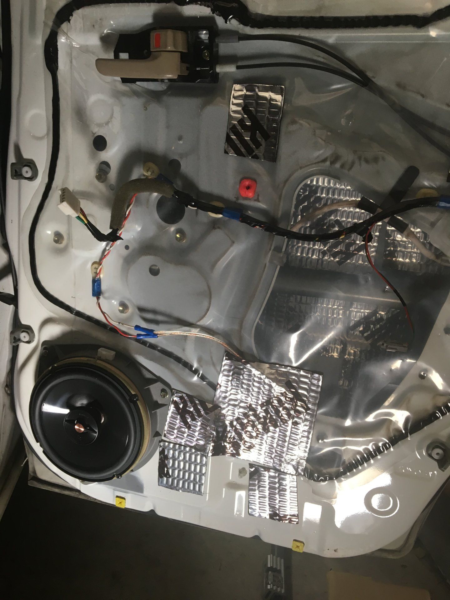

Got the rear Infinity coaxials installed. Put Kilmat in both rear doors. Running off the head unit they sound great....to the point where it almost has changed my mind about putting a sub in the factory spot....I think a 4 or 5 channel amp will be more than sufficient....5 channel just in case I decide to add a sub later. Definitely makes a massive difference over the factory speakers and my factory speakers were in perfect condition....but the Infinity speakers are awesome. Crutchfield said they wouldn’t fit but I had zero issues.

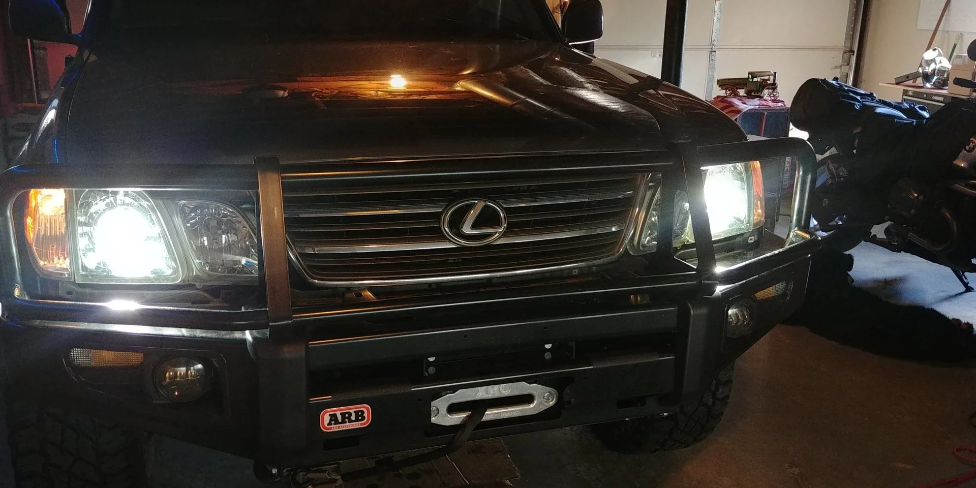

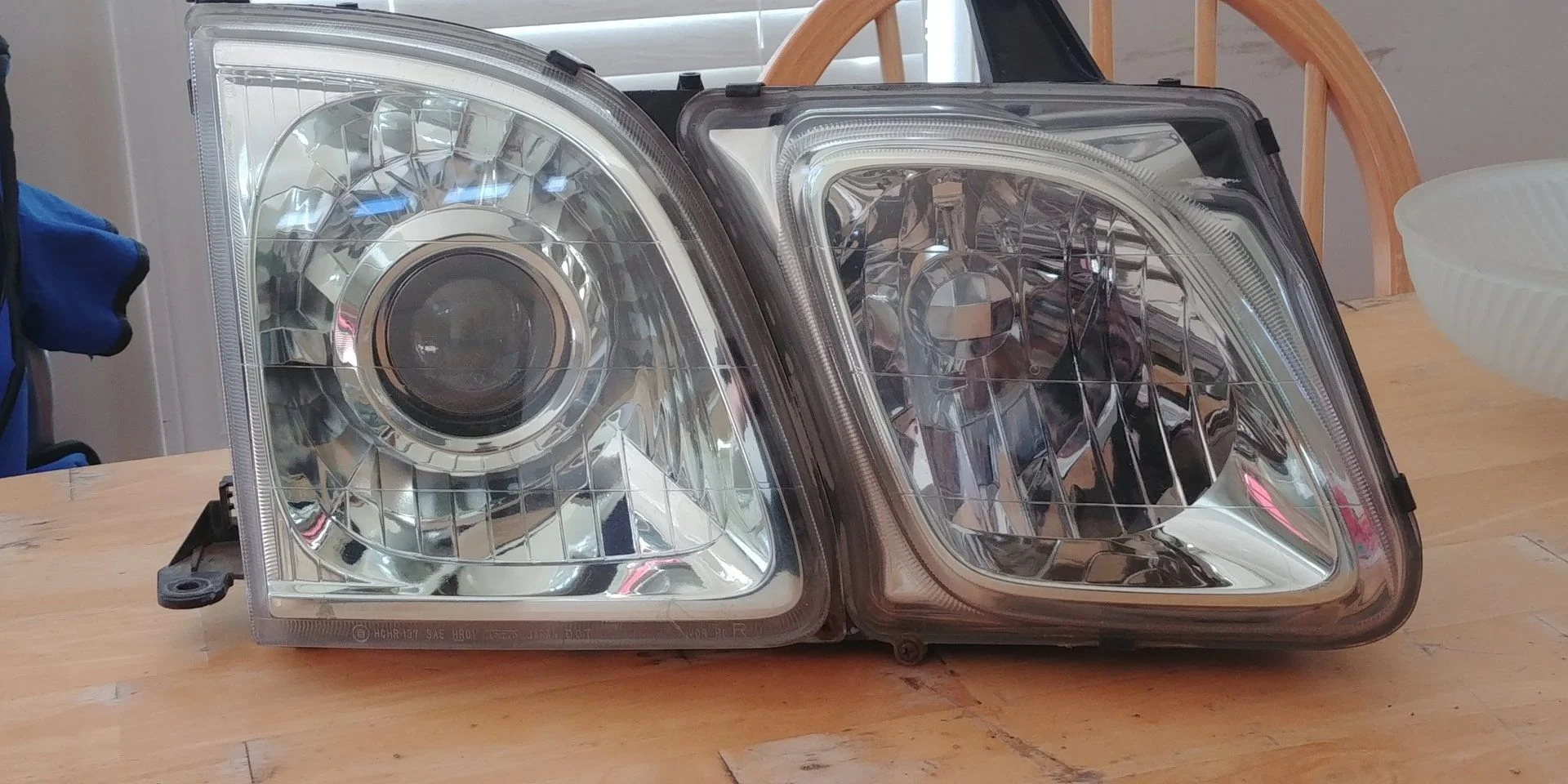

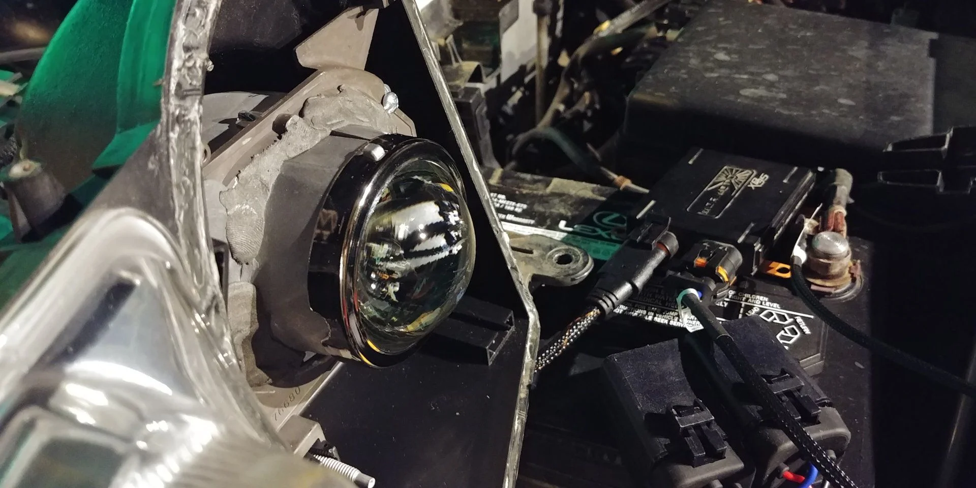

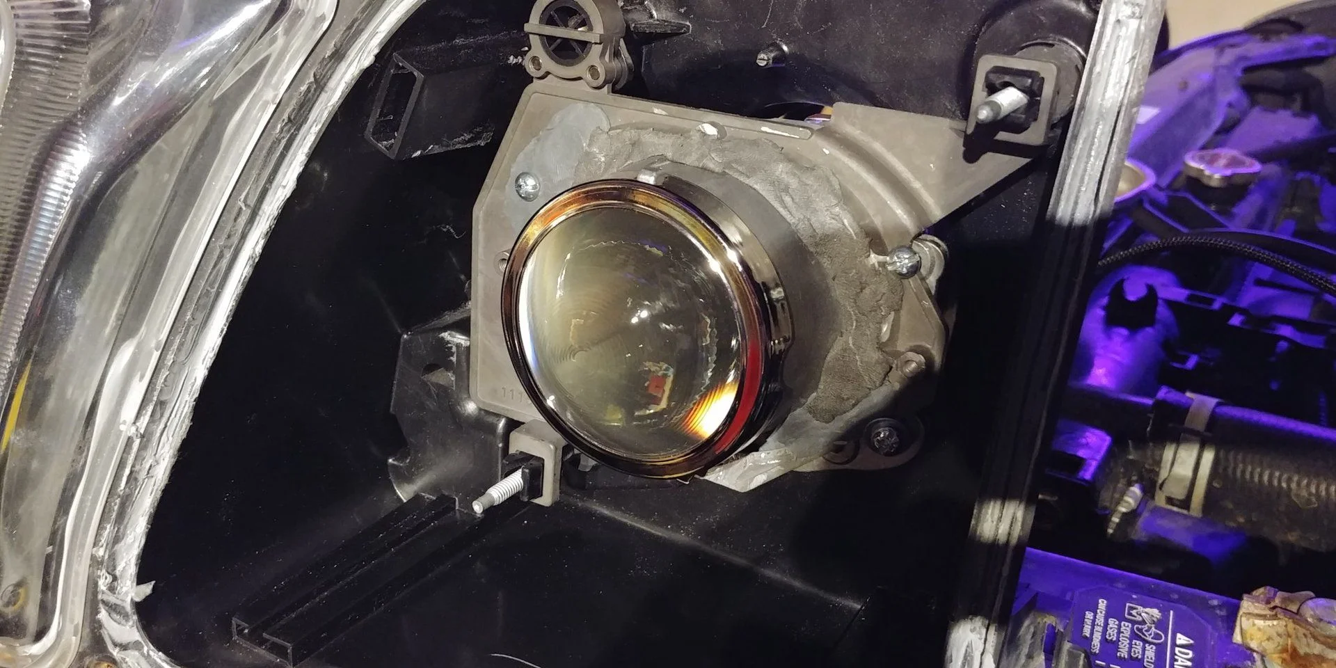

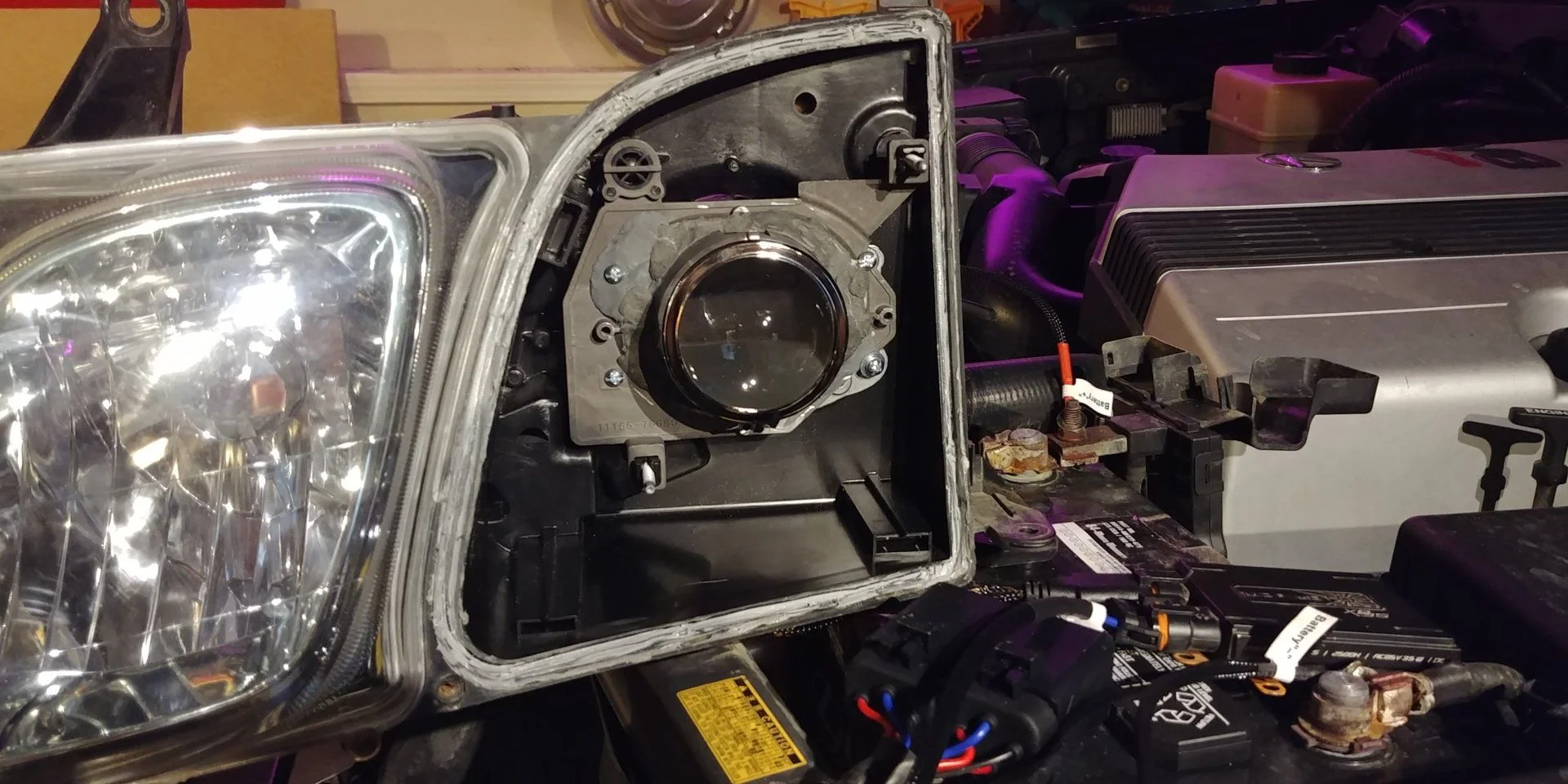

Started and completed my TSX projector retrofit over the weekend. The first side took me all of Saturday, and naturally the second side took a few hours today. Go figure. I still need to have them aimed but I'll need to find a wall with 25' of space in front to do it.

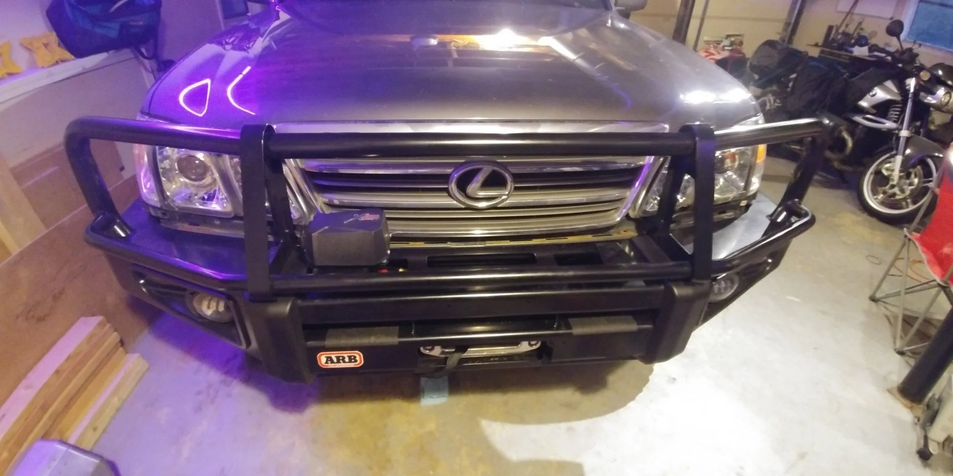

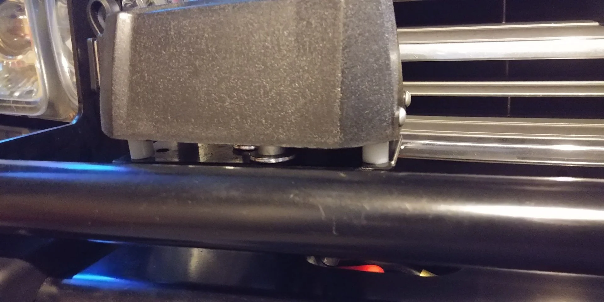

I also got my winch control box mounted up, finally. I'd installed the bumper over Christmas break but left the box uninstalled because I was sick of messing with it at the time. I also needed to figure out how I wanted to mount it. I see a lot of guys run it under the hood but I didn't feel like A) extending the wiring to do that and B) having to pop my hood when I want to use the winch. So I utilized one of the light mounting brackets on my ARB, drilled 2 holes in it, fabbed up a bracket and some spacers to bolt to the bumper then screwed the box to the bracket. Simple enough, will work for the time being. Plus it looks cool.
Is there a guide you followed for this? Just ordered some black depo's and was thinking of getting some projectors.
Did you put the LED lights in upside down? It looks like the writing on the lenses is upside down. Those have a nice flat cutoff. Light them up and double check.
They are right side up (I think), but I had the same concern as you! The lenses both seem to be upside down. Adjustment screws are pointed down and the cut off is sharp. Here is an awful, inches from the flat surface, daytime picture of the light pattern. I still need to aim the lights.

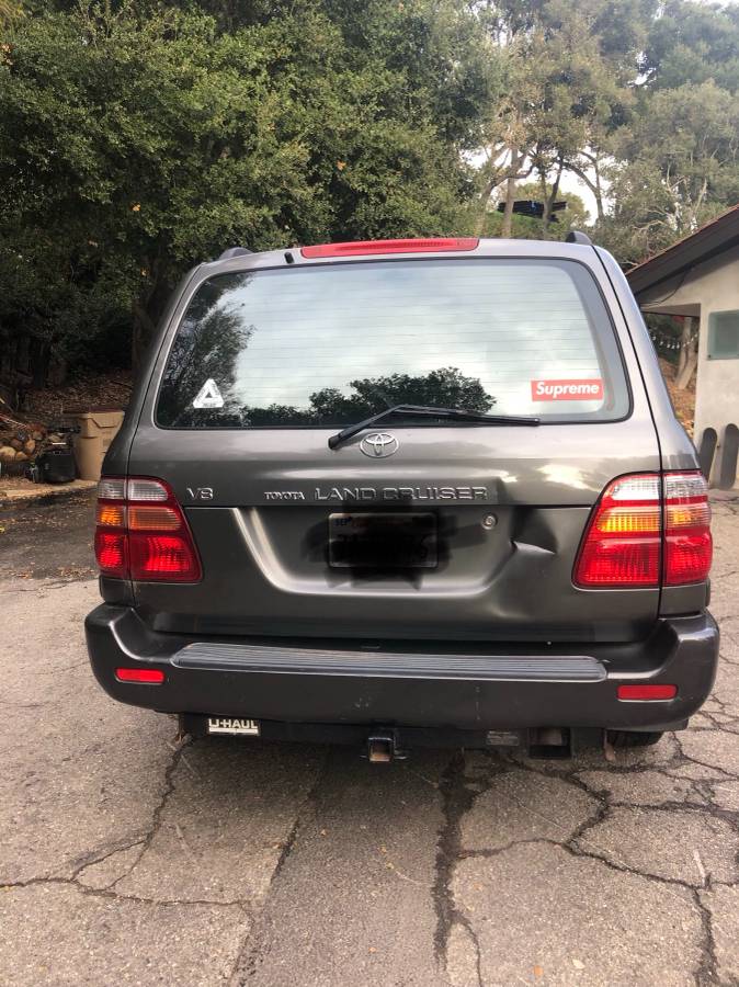

Bought it. (I’ve gone from 60 to 80 and now to 100!) introducing Dixie, our 1999 Toyota Land Cruiser 100 series.
A bit of an adventure to purchase: drove my Lexus LS 400 miles to see it, did the deal, took the 100 to Uhaul, picked up a car dolly, loaded up the LS and towed it home 400 miles, with some drama mixed in at the beginning and middle, but Very happy with how it runs and drives, just working out some kinks, both literally and figuratively.
Had interior detailed.
Had neighbor massage pass fender and pass door to operate again.
Installed new front pass door hinge strap bracket bolt (that was a mouthful).
Massaged front bumper driver corner with a heat gun.
Installed depos (buster pass corner light so went to 06-07 style) with OG bulbs for now, with some sort of retrofit or at least hir or led bulbs eventually.
Plans: grocery getter duty for time being until some other priorities are met, then build up with lift, wheels and tires, bumpers and sliders, skids, front locker, roof rack, lights, etc... let the chaos begin!! :wrench::steer::flipoff2:
