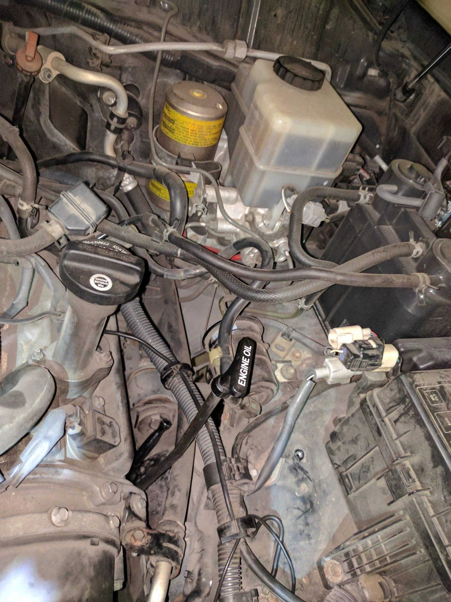

Hose/tubing removal
Removed all the hoses/tubing for flushing.
The FSM says to use an SST to open the tubing clamps by the expansion valve. Inserted a small flat head driver in the hole and was able to pull them apart. One of them got slightly damaged in that process, but it's still usable.
Also broke one of the rubber mount by the coolant reservoir, when I twisted the attached nut. The rubber was brittle and I should have been more careful. Oh well...
To remove the tubing between the condenser and expansion valve, took off bolts for charcoal canister and headlights, and moved them out of the way.

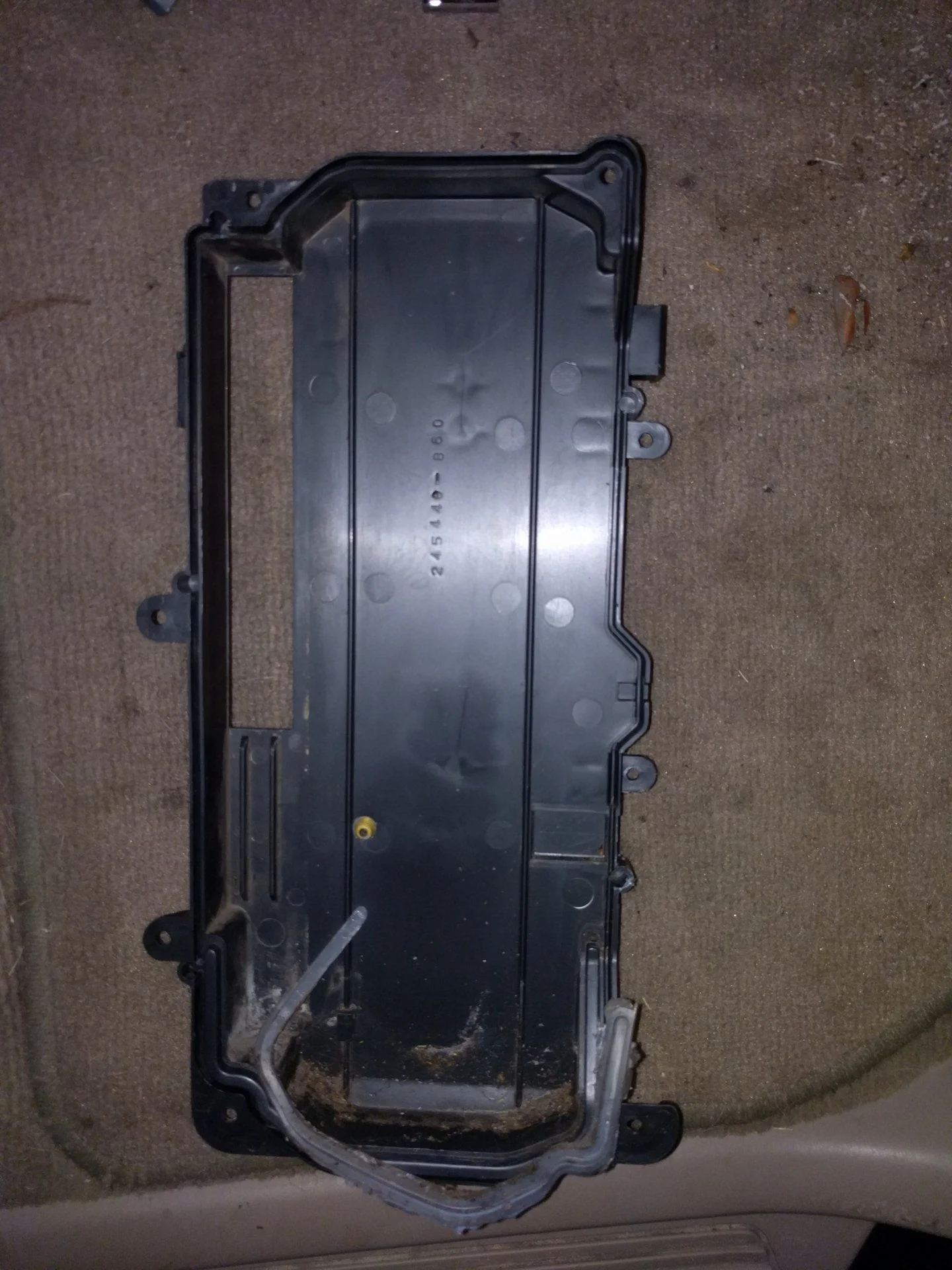

  • When I got this car two years ago, the AC wasn't working well (slightly cool air, not cold). I took it to a shop and they said the refrigerant was low. They evacuated and recharged the refrigerant with dye. The AC worked ok afterwards (not as cold as my other cars though). They couldn't find any leak. No refrigerant has been charged since then. It was working ok (except the compressor noise), but the air didn't feel as cool as before. Not sure if it was because of the leak or failing compressor. I haven't seen any dyes leaking at the hose/tubing connections so far. If there is a leak, it must be in the evaporator or expansion valve.
  • Even if there is no leak in the evaporator and no need for replacement, it's good to remove and flush it.
  • I tried to drain the compressor and condenser, but nothing came out. Where did all the oil go? To charge the proper amount of oil in the system, need to know how much oil in the system currently.
  • As mentioned in my first post, the expansion valve replacement is supposedly required for warranty. It is not accessible from the engine bay (I think).
Here is the picture of the removed evaporator:
Most of the dyes are at the bottom, but I can see some around the inlet/outlet as well. I can't tell whether it was leaking from the o-rings and/or coil.
I don't want to find a leak after everything is put back together. I guess I have to change out the evaporator as well...
You can find threads on how to get the evaporator core out without removing the instrument panel, so I'm not going into the detail on how. Here is the picture.
When I got this car, I had a problem with water condensation dripping through the door of the evaporator because of the failed seal. I took it off and applied Permatex clear RTV silicone. Never had a leak issue since then. It came off when I opened it to remove the core, but it is still perfectly formed and looks like I can even reuse it.
that evaporator looks bad... is that AC oil at the bottom of the housing? How hard was it to unattached the evaporator from the engine bay? removal after that looks pretty straight forward. I think my front evap is leaking, so thats the reason for asking. thanks!
Mixture of AC oil and dye, most likely.
Not difficult, once I figured out how to open the clamps. All you have to do on the bay side is to remove the clamps and pull the tubes.
Yes, straight forward. You just have to pull the panel really hard to get the core out. Even with the cut, still very tight. I thought the panel was going to break/crack, but it didn't.

One thing you can do on the evaporator is to check the evaporator drain (coming out from the engine bay) with the UV flashlight. If there is a leak in the evaporator, the mixture of refrigerant oil and UV dye would be drained with the condensation. You can also slide the evaporator door and take a peek.
Brilliant. The UV light was really helpful in finding what in hindsight was a fairly obvious leak. My compressor is running like a champ, for now. If I had to do it over again, I would prob replace the condenser, compressor, and the evaporator all in one pop. No AC on my wife's car is painful to hear about!!!
I seem to have the same issue with condensation coming off the evap. Should I be conserned about this other than the minor inconvenience of my passengers feeling a drop or too of cold water? Or is this a sign of more problems to come
I think it is just a minor inconvenience and not a sign/cause of more problems. It's not difficult to fix it though.

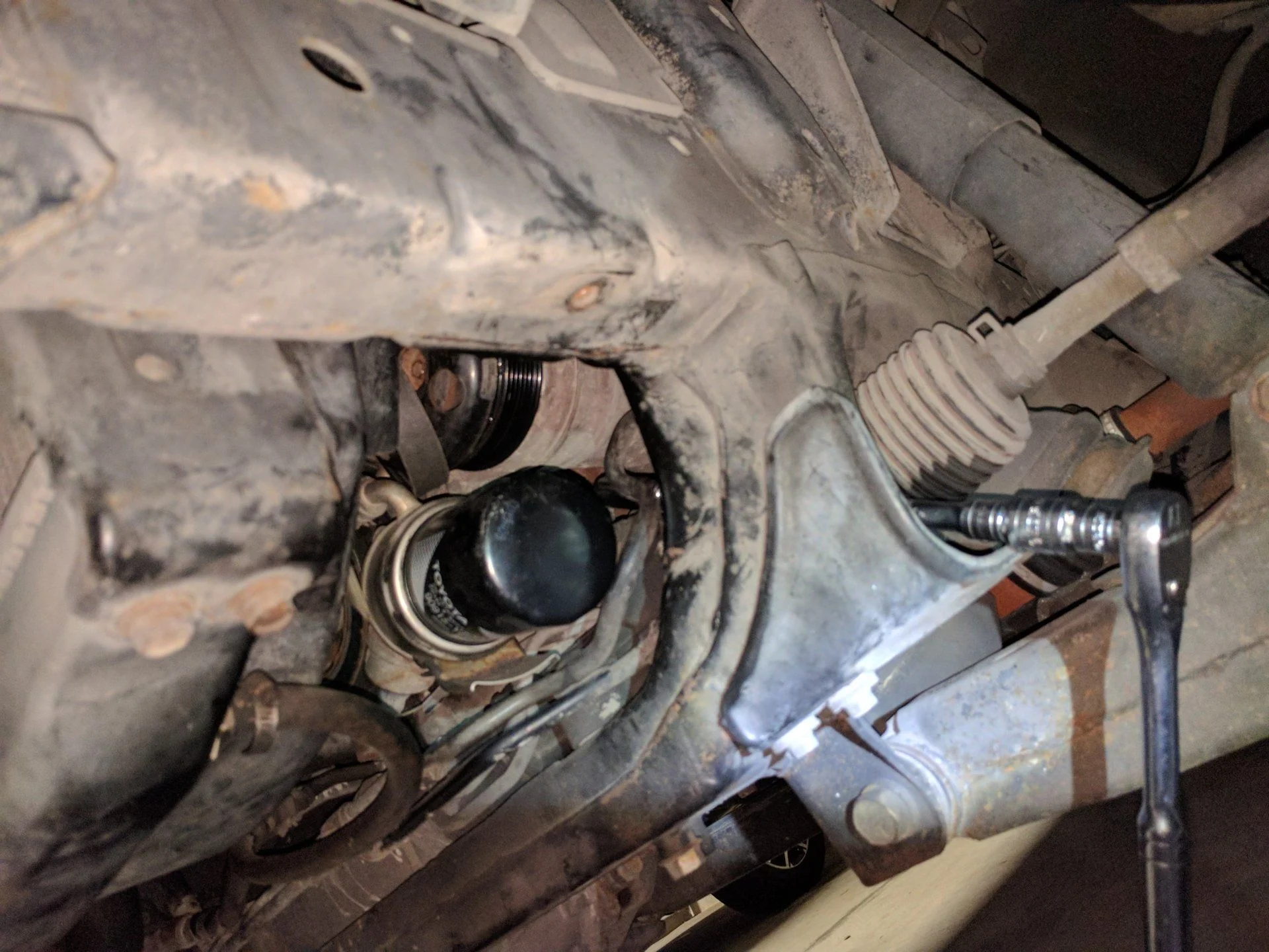

First bolt - front top
Accessed from the bottom. Used a 14mm shallow socket, 3/8" breaker bar with a cheater pipe. It wasn't bad.
Second bolt - front bottom
Accessed through the area where the tie-rod goes through. Used a 14mm socket and long 3/8" extensions. Not an exact straight shot, so a tilt socket would help.

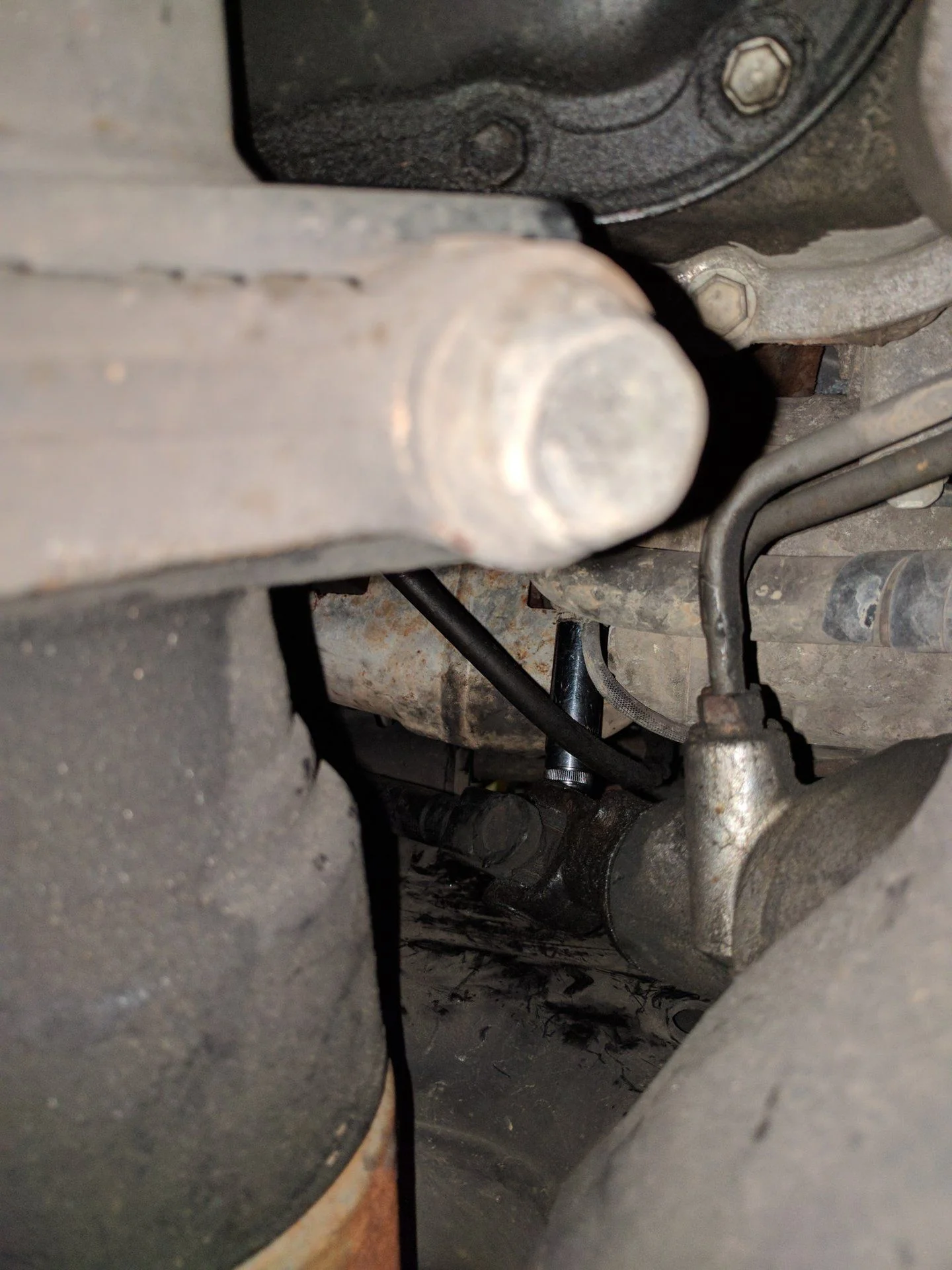

Third bolt - rear bottom
Used a 14mm deep socket (12 point), 3/8" breaker bar with a cheater pipe. Set it up from the bottom (around the LF drive shaft) so that the breaker bar points upwards through the engine bay. Tried 6 point socket first, but the bay is too tight and I couldn't insert the cheater pipe. It would have been easier if I had a helper to hold the socket from the bottom.

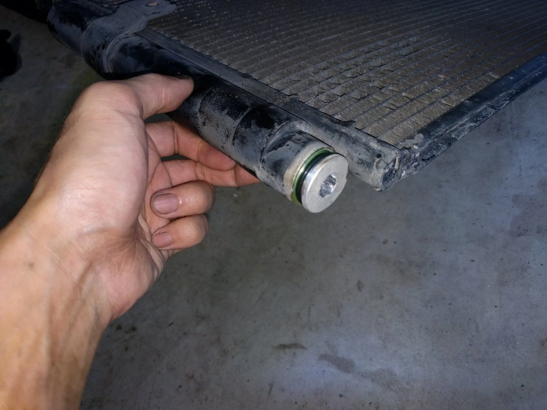

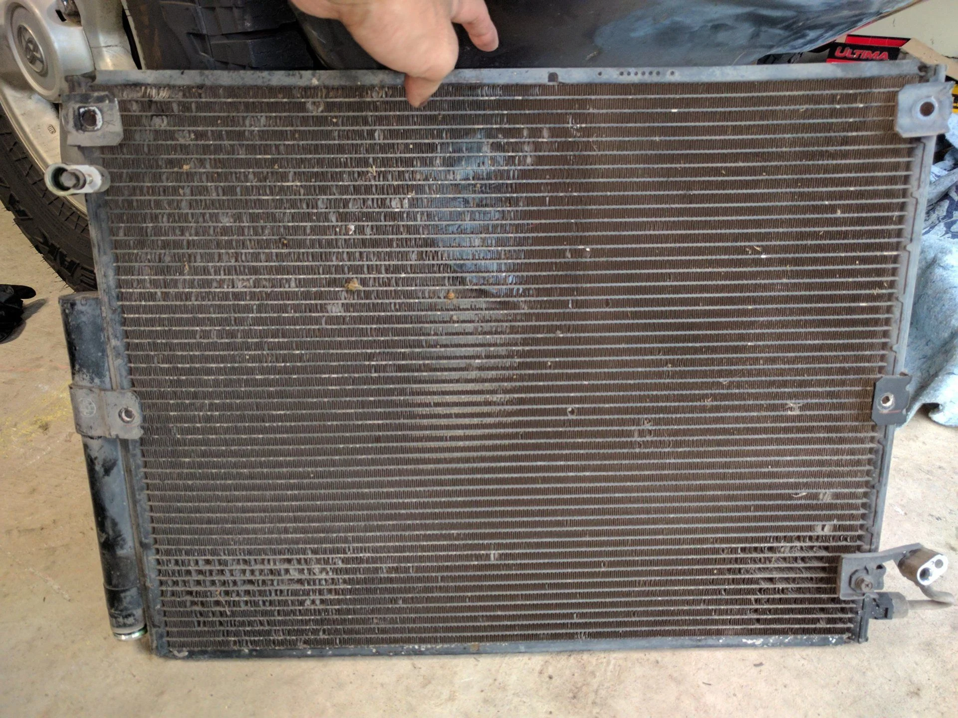

Condenser removal
Removal is not really required, but I decided to do it to inspect and clean it. The FSM says to remove the oil cooler, but I just took the bolts off and moved it out of the way.

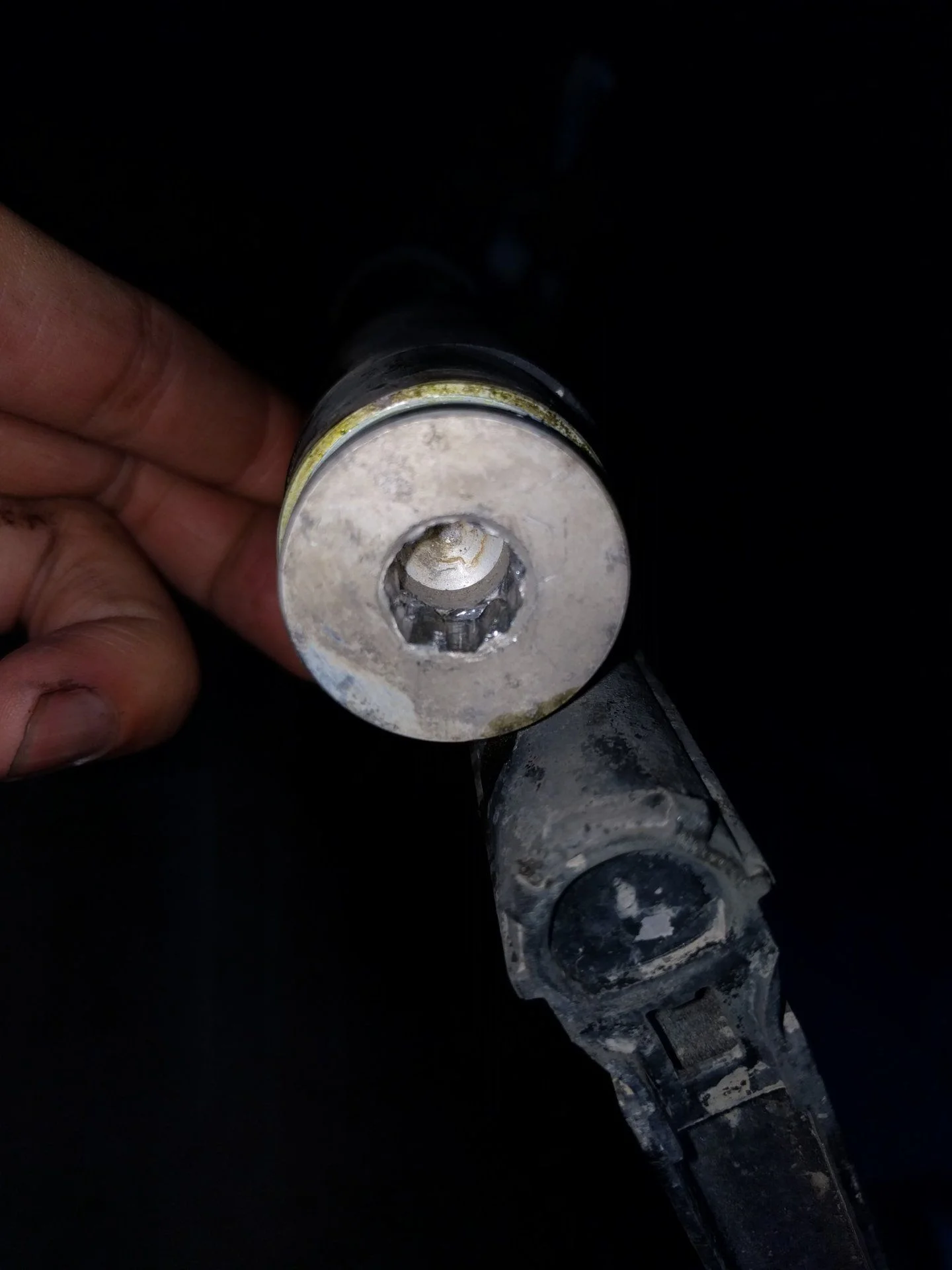

Drier removal
Failed. Used 10mm hex key. It turned a couple of times without an issue and stopped. Used a cheater pipe, but still couldn't get it out. Damaged the head. Have to buy a new condenser. Looking at the condition of the original condenser, not a bad idea to replace it anyway. Just have to wait for another week to complete...
To be continued...

Evaporator removal
Debated whether I should remove the evaporator or not, but decided to do it for a few reasons:
Is that evaporator bad? I got a little bit of that yuck at the bottom corner in the same spot. I’ve had all elements of my ac replaced but that. Blows cold as s*** but was wondering if there’s a downside toman evaporator in that condition. I only saw it when I was doing my cabin air filter add to my 2003lc.
