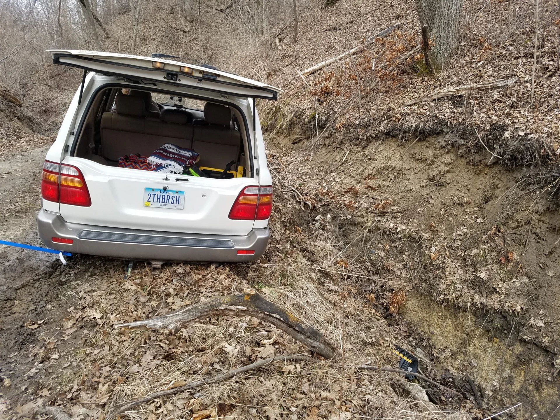

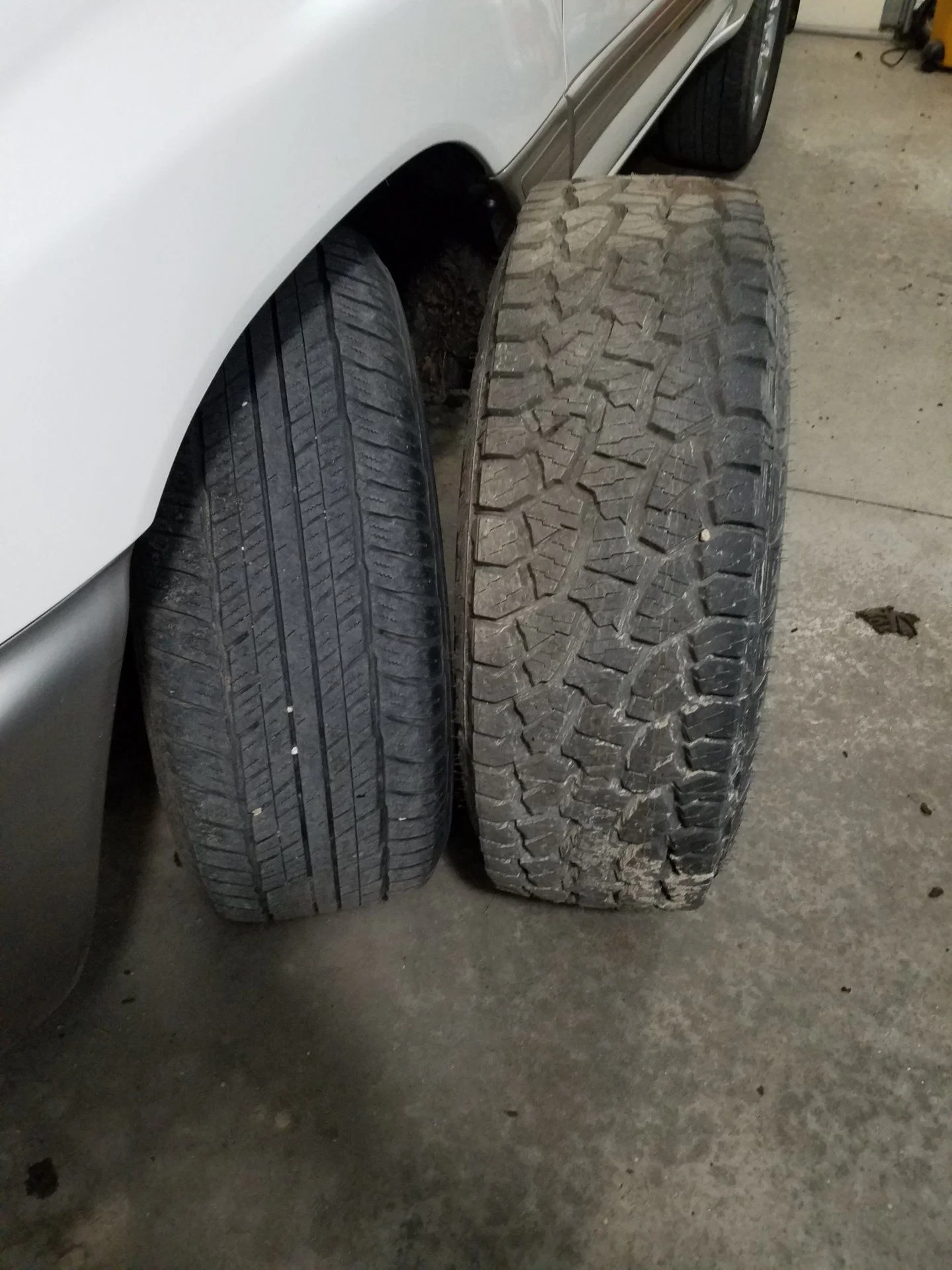

So my wife married an idiot...
and the difference was that my street tires and my off road tires were in two different places.
With out those on my truck I ended up here...

I don’t think the tires would have saved you...
