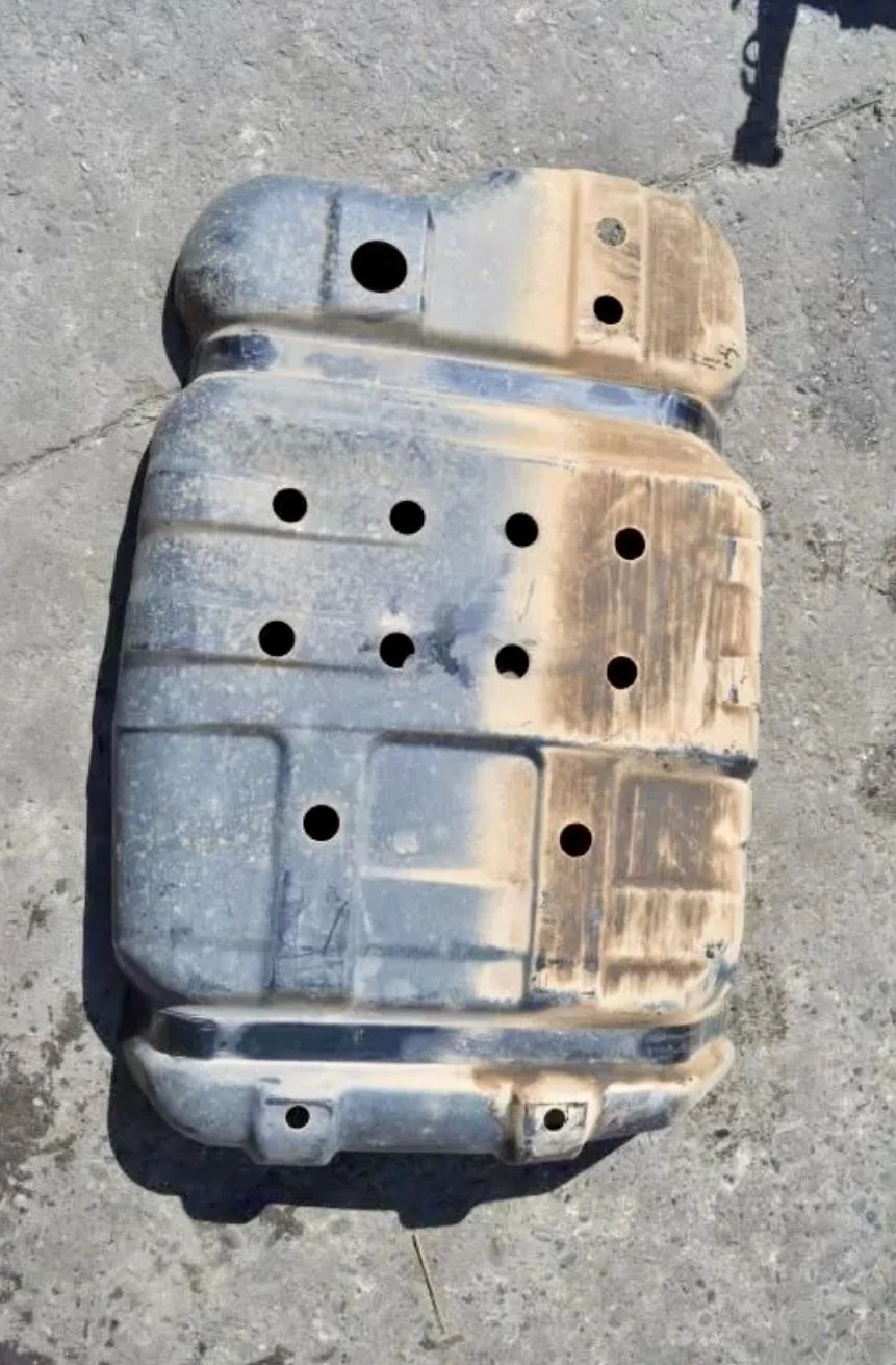

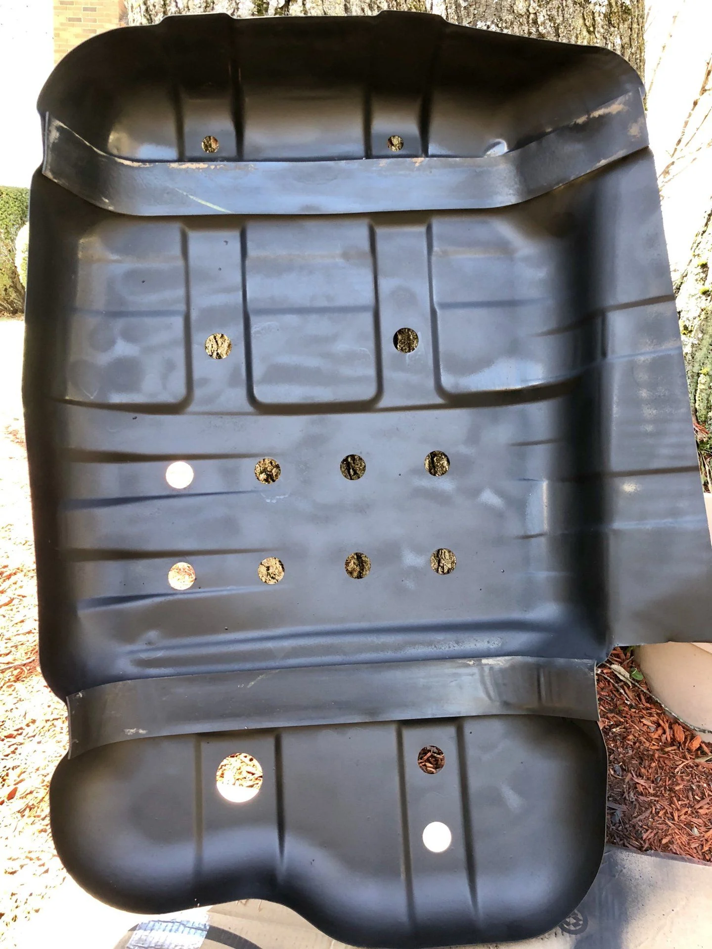

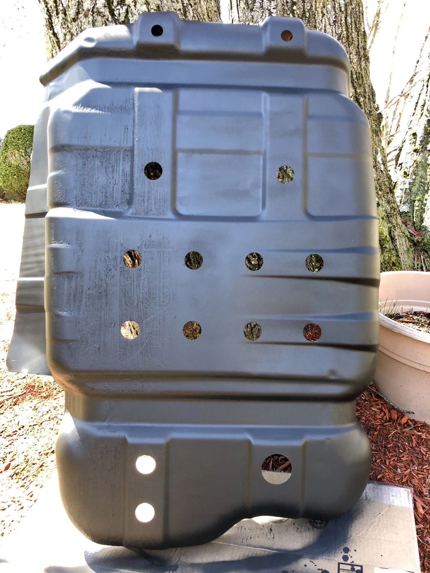

Busy day! Today, I cleaned up and painted my “new” Fuel Tank Skid Plate. I don’t have a lift, so I won’t be able to install it yet. In any case, I’d like to let it dry for a few days.
I used a wire brush to remove all the gunk (mostly a fine sand) that was stuck to it, hosed it down, then used some regular household cleaner to get the rest of the sand and grease off, and hosed it off again. Although I have a power washer, I opted not to use it.
After it dried, I hit it with several coats of Rust-Oleum Rust Reformer.

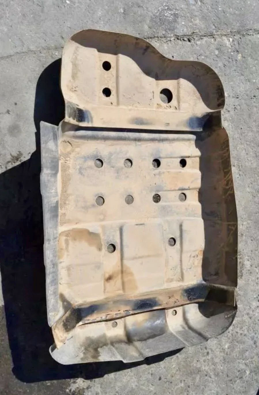

Donor vehicle
You can see the right side of the skid plate is gouged, I’m assuming from the accident.
In any case, this is much, much better than the one on my truck at the moment, which has rusted and basically completely rotted out.

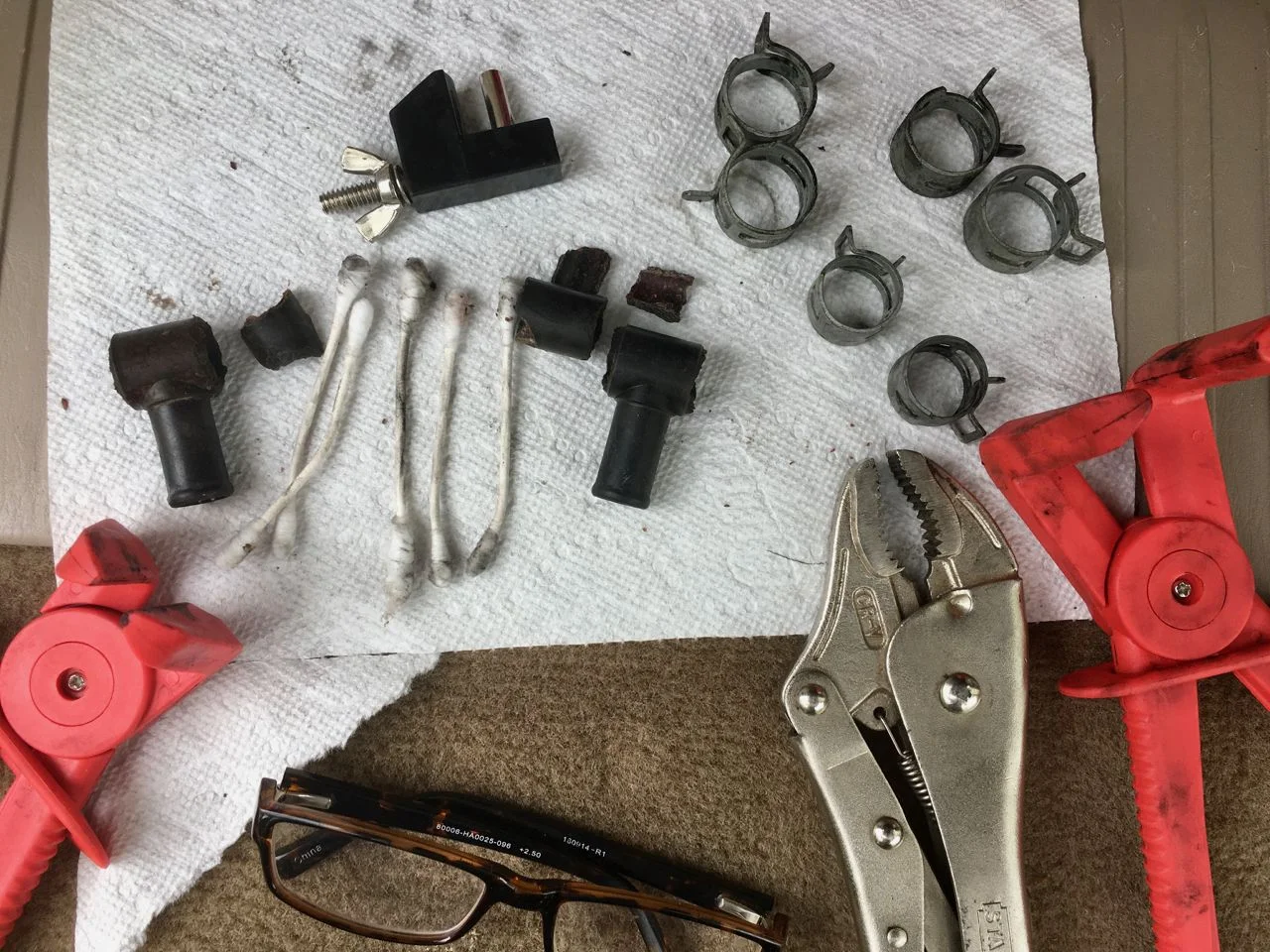

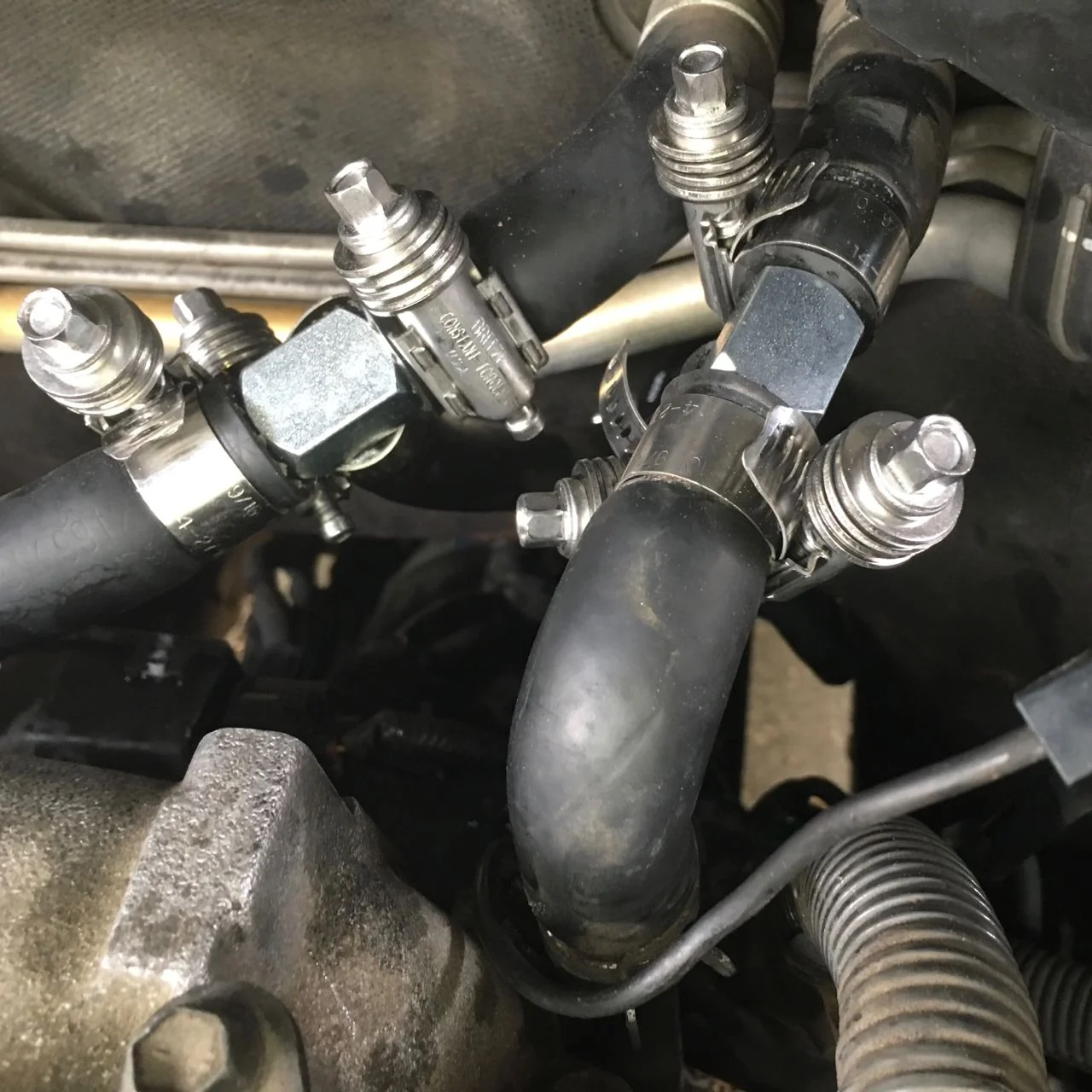

New to me 2000 LC, 220k, heater tees last done by dealer @ 100k. Heater hoses all done about 50k ago at dealer. Can't believe they didn't replace the tees again at that time.
This job was first on my list (after removing the side steps.)
Really glad I did this job ASAP.
I followed recommendations & clamped everything first. Only lost about a 1/2 cup of antifreeze.
Both tees crumbled during removal.
I flushed & swabbed to get out all the residue & bits of old tee out. Total time for job = 1 hour.
Bought everything needed from Amazon (found in various heater tee replacement threads.) Happy with initial quality of the metal tees & stainless clamps.
full
full
Clean up - old tees & clamps, plastic chinese locking crimpers & a metal wing nut hose crimper.
