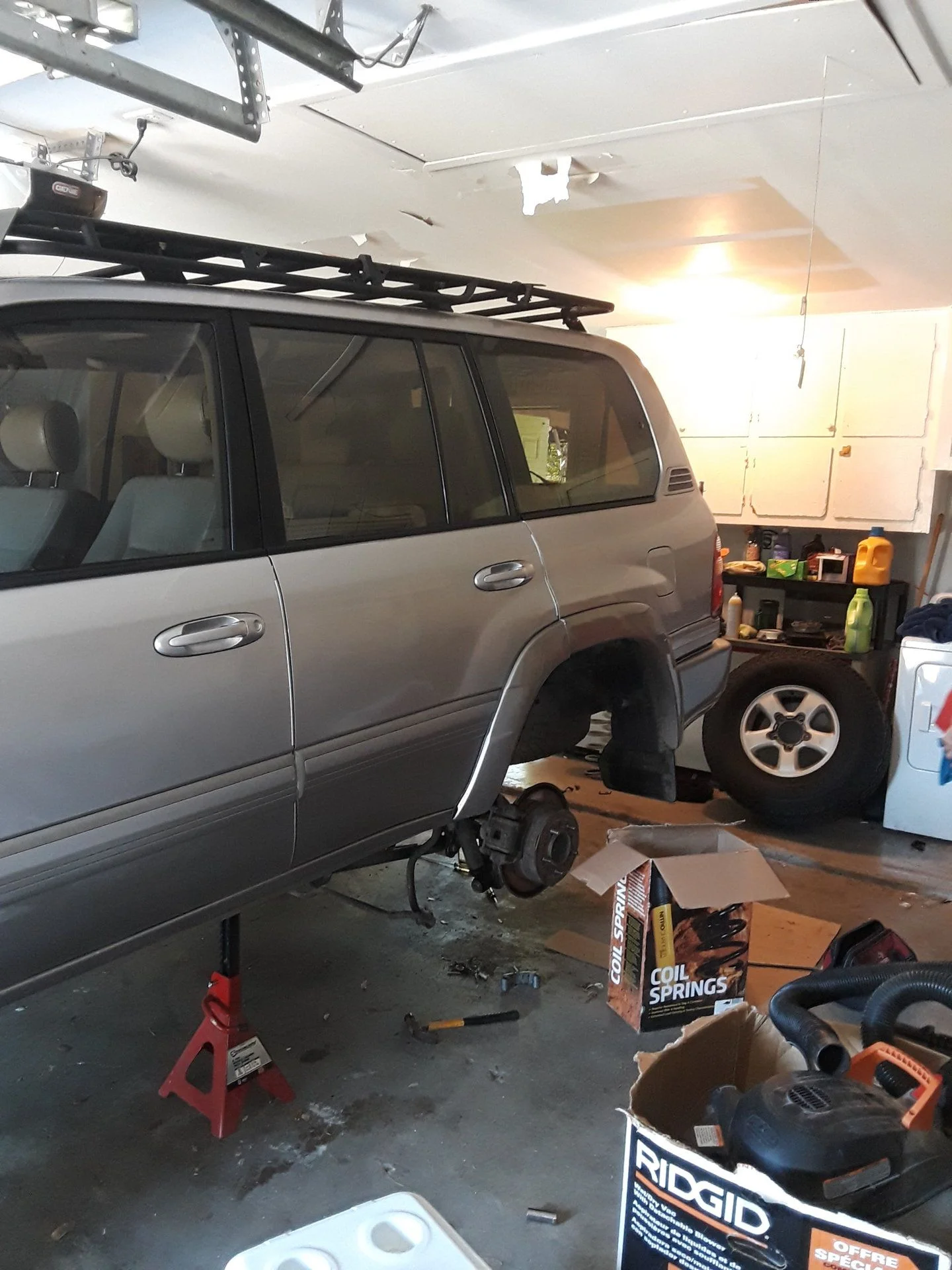

King shocks from filthymotor sports desert dune valving setup basically means much heavier rebound damping
Sway bar delete front and rear
Tough dog torsion bar 30% more spring rate
Total chaos upper control arms extended travel shocks

o forgot to mention king liner springs in the rear 2 inch lift.
+ remover front differential and axels for better weight distribution

Over the last month I have been getting ready for Mardi Krawl. OEM cv axles, SPC UCA, new ball joints, rebuilt motor for brake pump, Trail Tailor diff drop, upper and lower differential arms, Metal Tech upper and lower adjustable rear control arms, Tough Dog adjustable panhard bar, new sway bar bushing, and Trail Tailor extended front and rear sway bar links.
