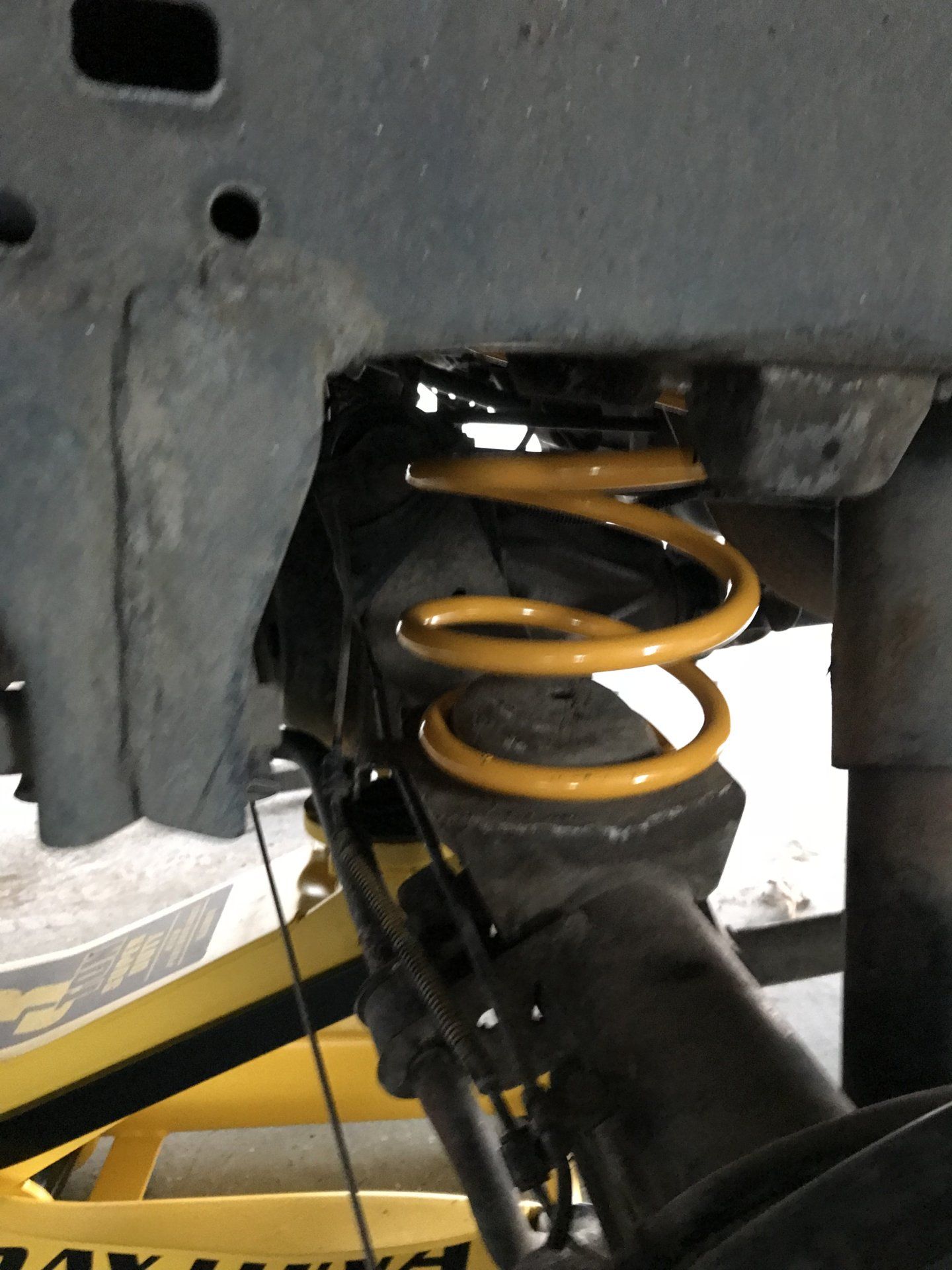

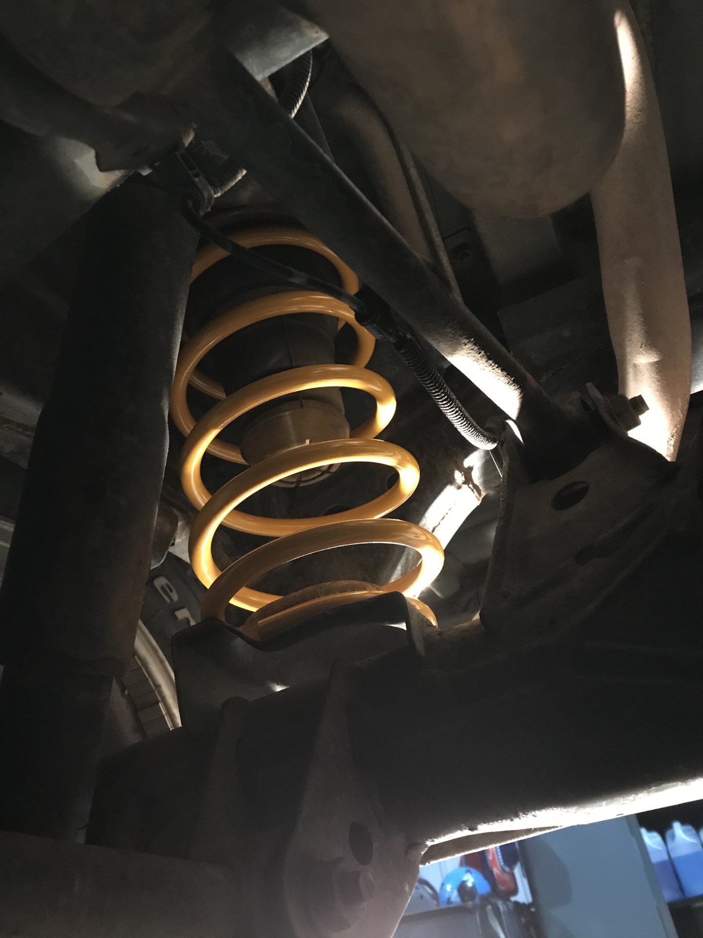

Put on a set of King springs ... AHC still running strong. Neutral pressures in the rear were 7.1 before the new springs went in. Now at 5.0 ... just right in anticipation of @benc rear bumper going on soon
Thanks to @Ramathorn15 for the push to do it myself.

How do you like that floor jack? Any regrets or picky points?
No regrets here ... was $180 on sale at Harbor Freight. Exact clone of $650 Snap On. Raises to 24” ... I needed all of it to get the droop for the spring swap.
