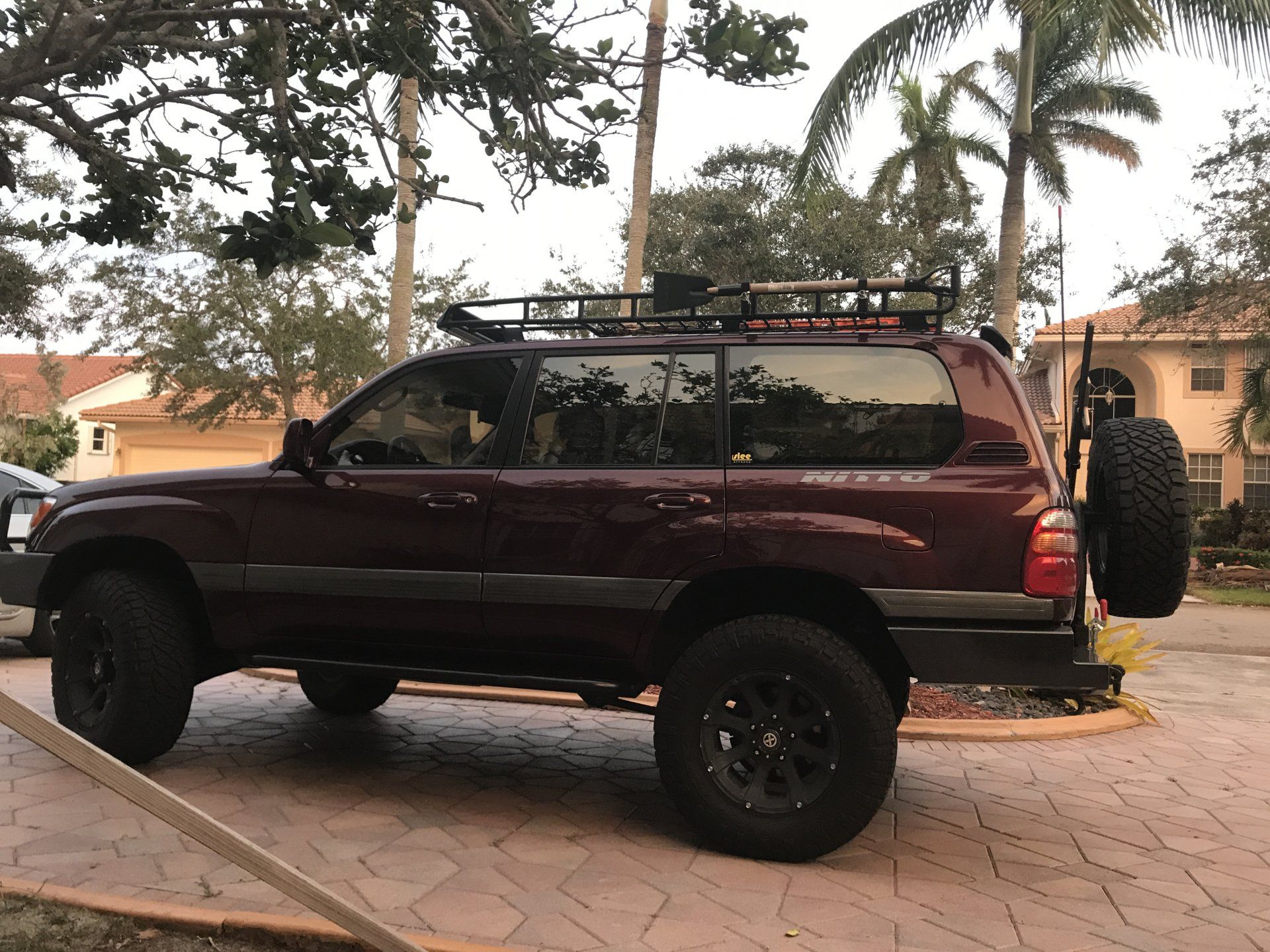

Switched to the 864s
Actually drives better.
Sorry to see those wrinkles. That's a cut issue, but you might also get a second opinion from an installer. I wonder if you needed to replace your foam. I replaced mine in the fronts and it has made all the difference.
All seats had extra foam added and were steamed. So not only were these really baggy in the middle, they also had some grease pen markingsfrom whoever
What were you running before? I have slee heavies with spacers and have been considering doing that also.
Was running the 2860 with the torsion bar cranked as much as we reasonably could.
Then the roof rack. And rear bumper. And really heavy 5th tire. 1 wife 2 peruvians, and two monkeys (my children) and all of their crap. No longer had the lift I wanted. Even with all that these are tall. But it definitely drives better. It's more settled with it riding ass high.
