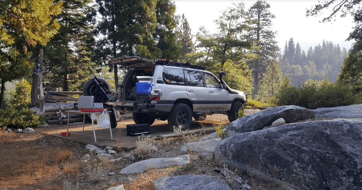

Paid @benc a visit over the weekend for some goody and dropped into the Sierra to meet up with some friends after 2 days of solo camping in the bush. Glad to have the new addition - an accessory arm on the rear bumper. 1200 miles of adventure.
Accessory arm addition in progress.
The dogs had a great time socializing as well
Eagle Lake pit stop for the night. Nice to finally get some rest and sleep to the sound of the flowing river. Time for some morning strong coffee

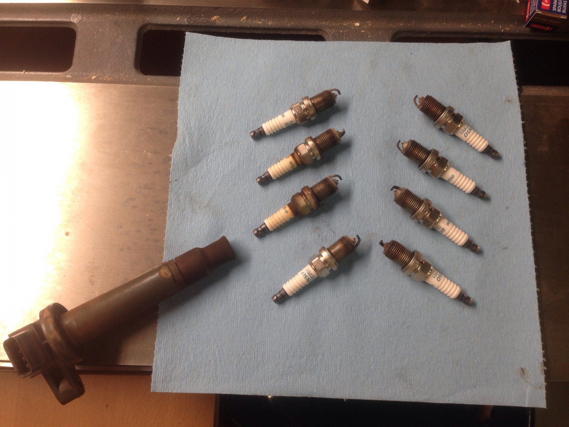

01 LX @ 137k miles
8 x plugs (Denso Iridium SK20R11) and 1 x ignition coil, with another on order.
Plugs in cylinders 4 and 6 (middle two on US passengers side) were finger loose and ignition coils were very dirty and discolored. Replaced worst one with my emergency spare and ordered another two.
Gapped plugs to 1.1 mm and torqued to 13 ft-lb.
