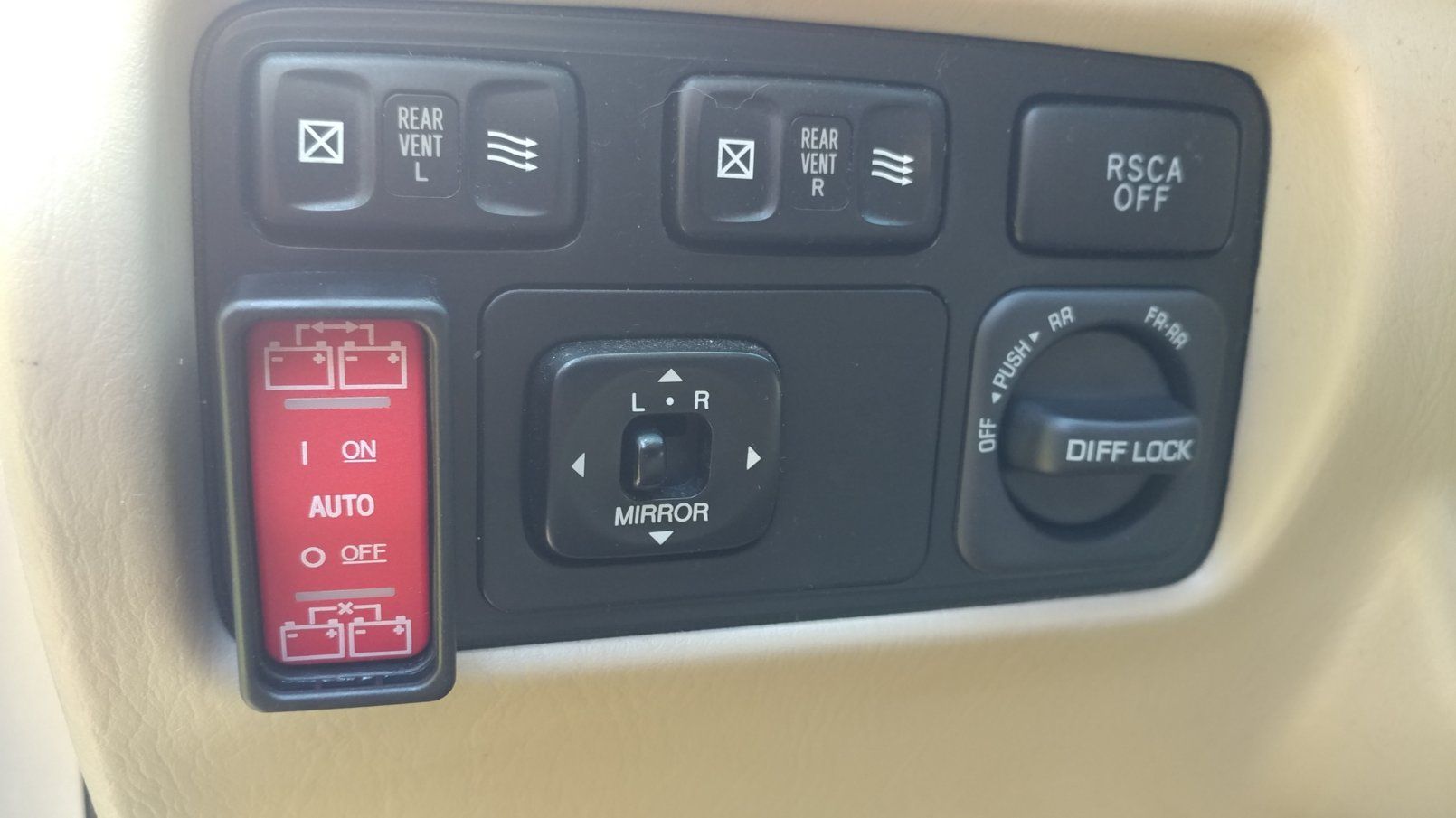

Installed in-cab switch for Blue Sea 7622 battery controller and locker switch in preparation for front and rear Harrop E-lockers.

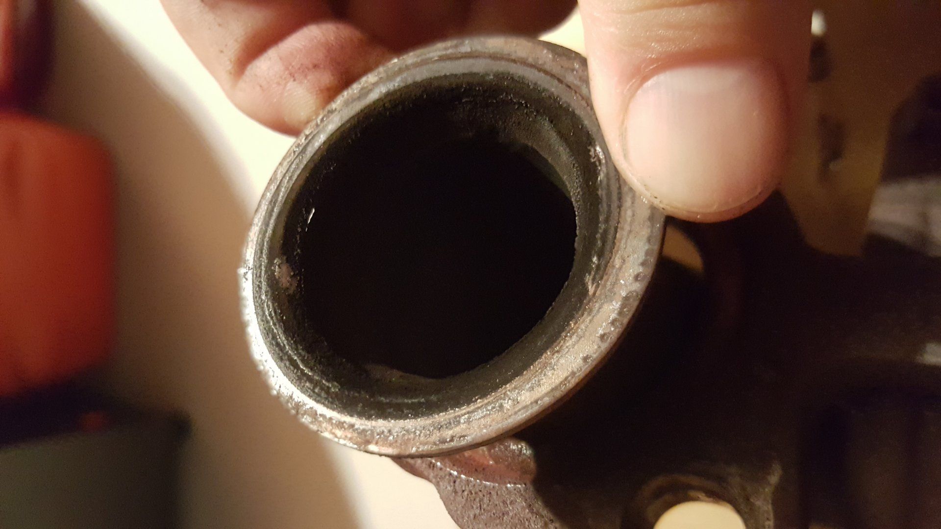

Replaced both of my exhaust headers with OEM replacements. I'm in CA, so DT headers were not really a choice if i want no issues with smog inspection. I tackled the driver side first, knowing it would be the most time consuming. Yep, estimates are right 6-7 hours. I probably could have saved an hour if I didn't spend so much time messing with the heat shield trying to get it out before removing the manifold itself. Passenger side only took about 2 hours. That too would have been faster if I would have torqued down all the nuts before re-installing the heat shield. Doh! :slap: I had left one only finger tight - good thing I saw it when I went under to torque the 3 exhaust pipe nuts!
Also replaced the alternator, mine has 110k miles on it. I had pinpointed my whine to the alternator using a stethoscope. Figured it was just an alternator whine, so I replaced it. Unfortunately, whine is still there. Replace the lower radiator hose at the same time while I was there, it was probably original, just PM.
Now to keep tracking that whine. If only I could attribute it to a supercharger under the hood, sadly that is not the case...
Old / New Driver Side Manifold
And yes, I found the leak!!! (can make out the crack where the light is coming through on the left side)
