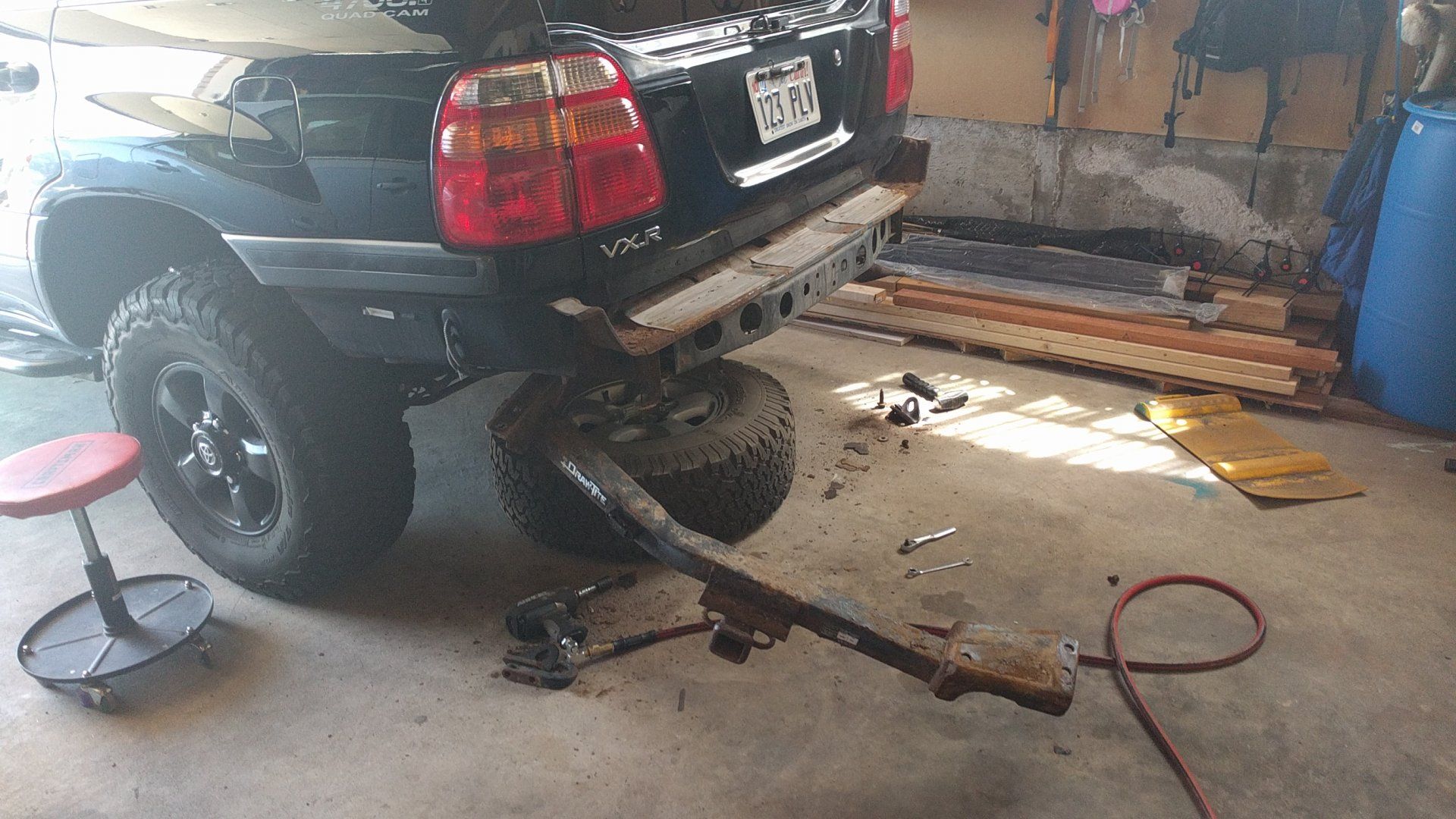

Main portion of rear bumper is completed. I still need to finish up a few things like capping the end on the swing out and the main 2x4x.25" section. Bend up some corner pieces and that's a wrap. Changed up the factory hitch a bit, and tied it into the frame using the 10 factory 14mmx1.5 pitch bolt locations that are in the rear frame area. Factory hitch was only connected with 6 bolts. All structural pieces are made from .25" plate and the main rear piece is .25" 2x4. Learned a few things, like I do every time I undertake a big project like this. Hope to have it finished up by the end of the week.
