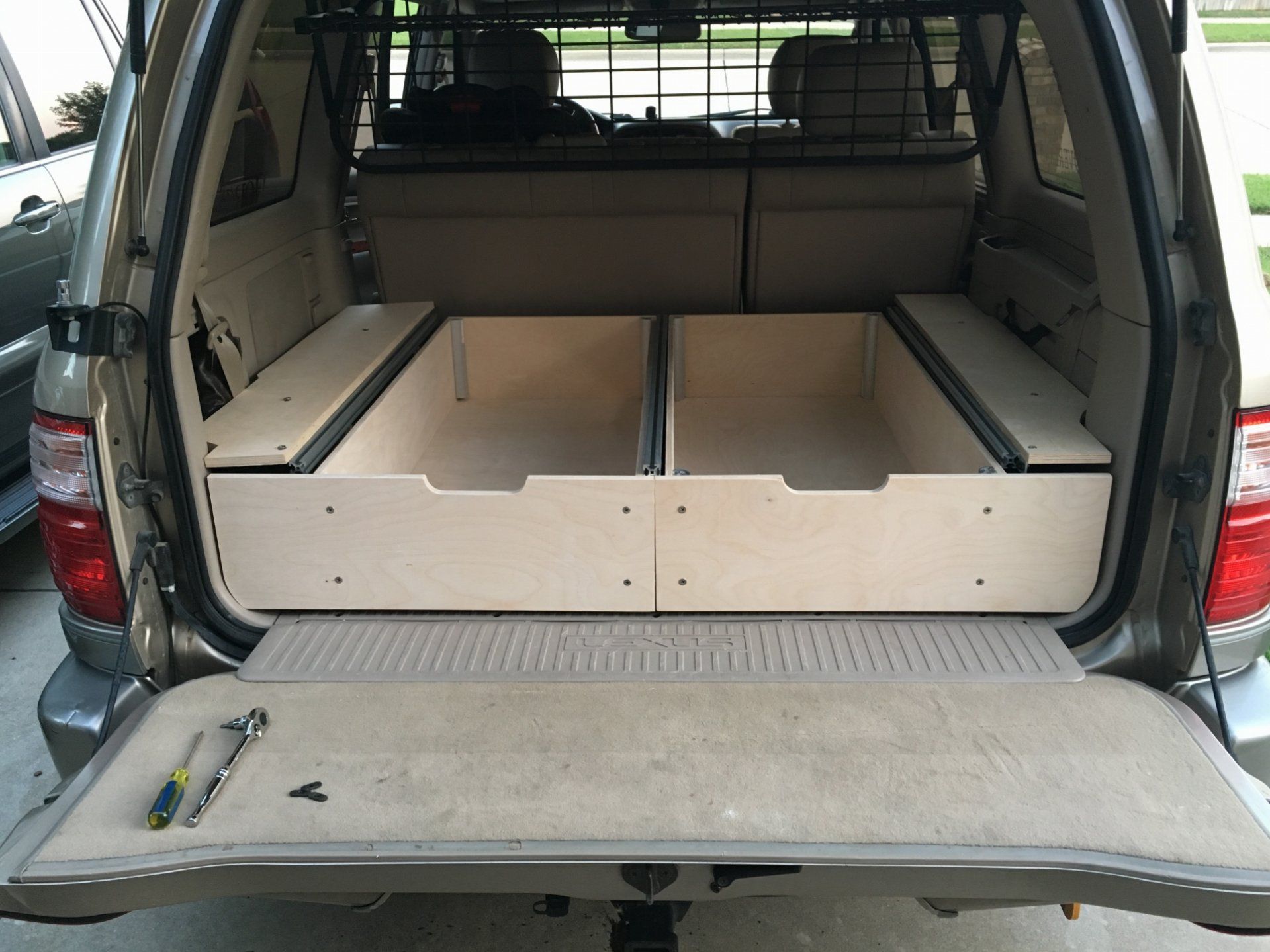

Now it's time for the fun s***! Sleeping platform for the back and head somewhere without cell signal.
