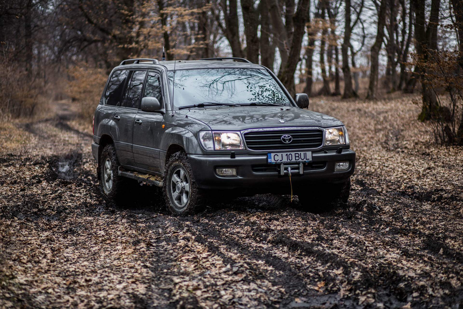

bad ass... that was some serious mud you were rolling through.
