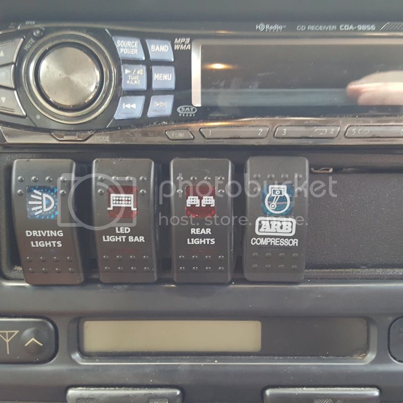

Hey same thing-pre locker install, I got the on board air installed, wires plummed, switches mounted and connected. Surprisingly every thing worked!
The ARB harness makes it pretty dang easy, and the instructions are straight forward. Of course I got kind of anal with the wiring install and sleeved all the wires Techflex wire loom over all the wires, used split loom on the air line. Looks "professional grade" now- for what thats worth :)
ARB CKMA12 compressor chosen to run the rear locker and supply standby air for airing up tires if my CO2 tank runs dry. If/when I add a front locker still one port availble for that line.

Switch and Compressor installed pre TJM locker install. Next up, clean up wiring and install the locker switch...older slee dual battery tray up for sale. Will post sometime when I get the chance. Also, got some OME mediums for sale. Went up to the heavies post dissent rear bumper install.

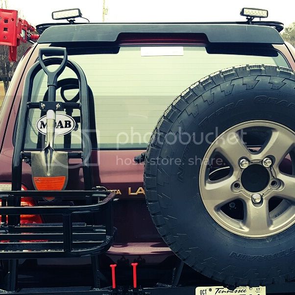

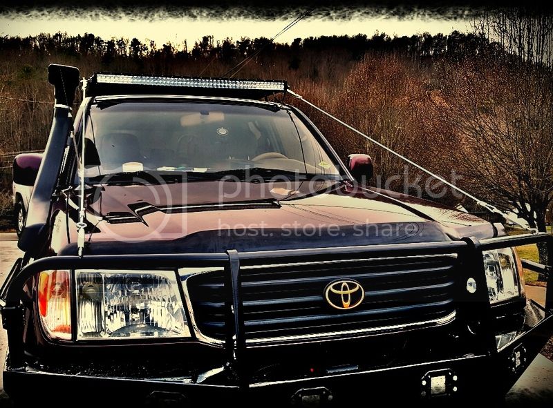

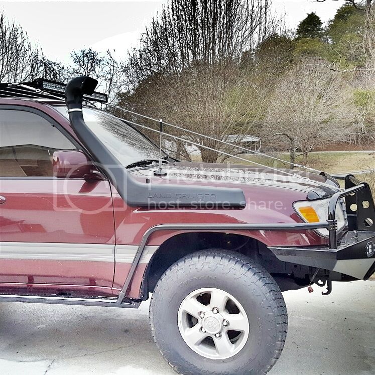

Got a few more things done today. All the switches are mounted, shovel mount on the ladder, and limb risers are on. Yes I know I can't open my hood the way they are but a couple twist on the turnbuckles and I'm in. I looked at sliding everything over but looked off. Check out the print on the China made snorkel, it says "LAND CRUISFR" What do you expect for less than $100?
I'd recommend turning your limb riser hook down. It will grab things!
