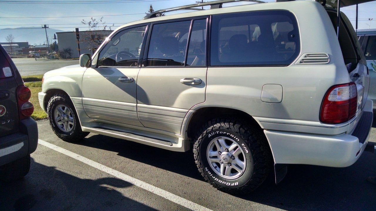

View attachment 1353142 View attachment 1353143
224k,
Also found a well maintained 2000 with 129k at a local salvage yard, they are offering a good deal on the turn key engine with all accessories and harness, may go that route instead repairing this engine.

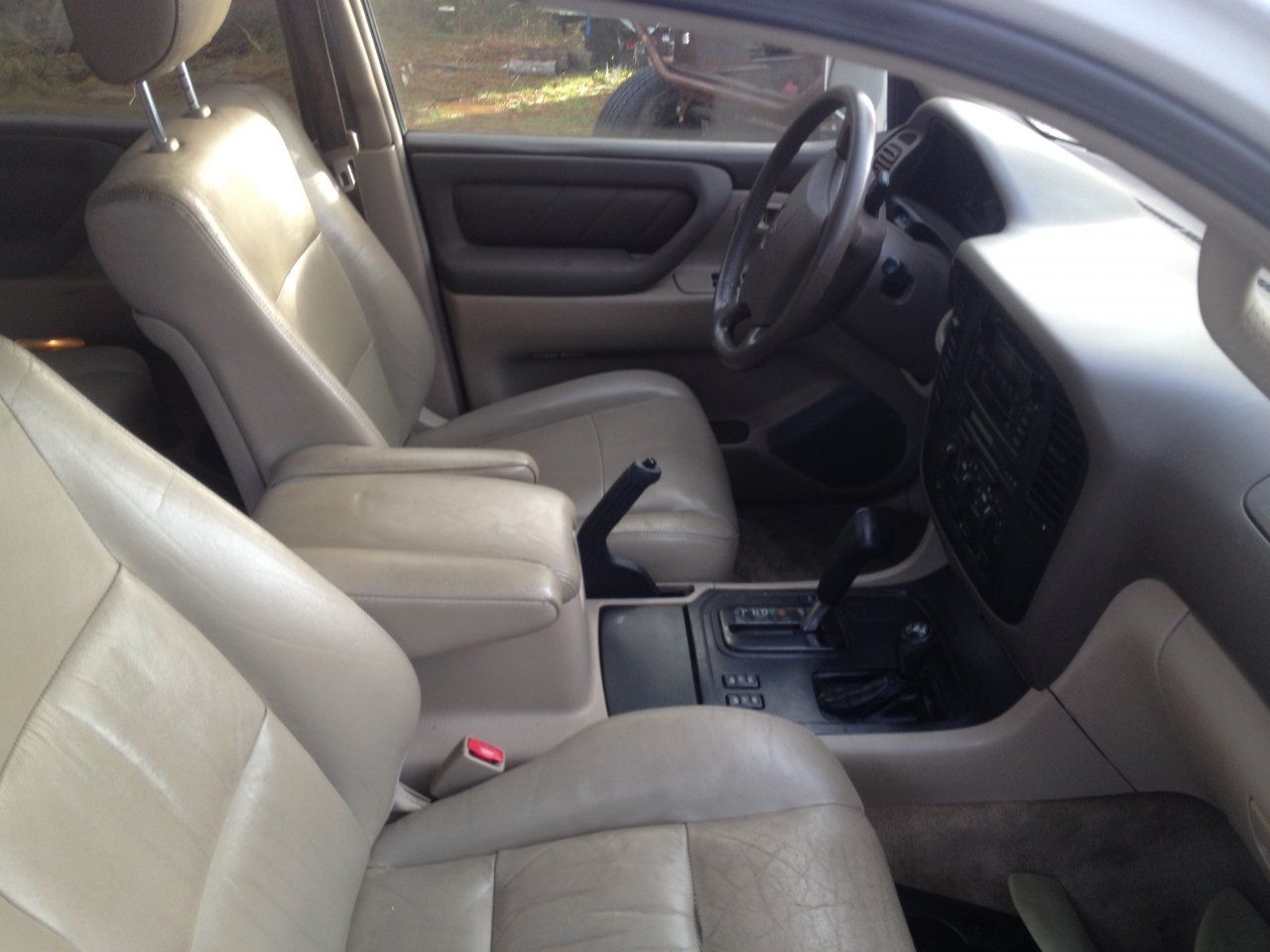

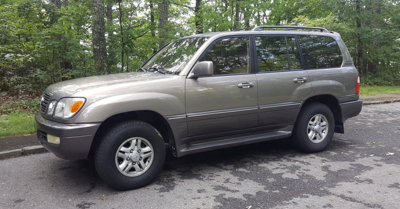

Just gave the seats a clean and condition along with the steering wheel. Fist time with the Lexol and product works well. Leather feels much better.
That is what I have been using on mine. Really like the product as well.
