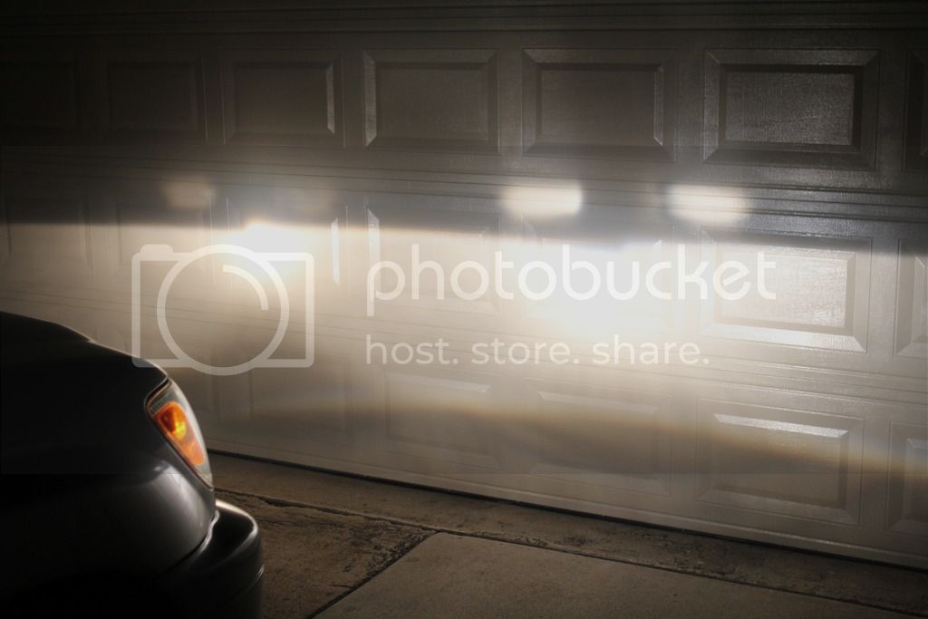

Installed new low beam head lights, installed @pfran42 interior LED light kit + the lights under the running board + CREE reverse lights. Great service!
Left light is original, right light Philips X-treme Vision +130% headlights H1 55w
