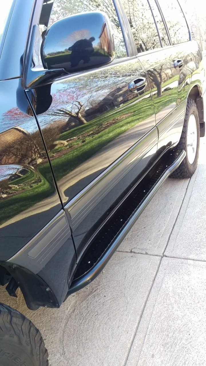

White knuckle slider install this weekend. Really nice build quality. Easy install process. One of the sliders had some serious flaws in the powder coat which was slightly annoying but i figure some black spray paint will cover it nicely.

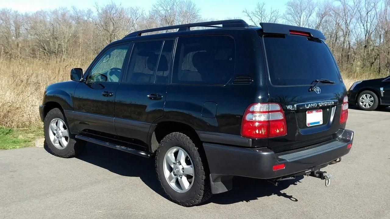

First post! Bought a 99 with a bunch of miles (220k), really good shape and well maintained though. Must have been owned by older people since the body was rustproofed and we found an AARP sticker on the window! Sounds like something wise older people would do eh?
Since we have welcomed Landy to our family last week I have done:
- Air filter
- Front, rear, transfer case fluids
- Lube shafts (keep it adult adults:))
- Oil, filter, Ceratec
- Fog bulb replacement
- Replaced muffler
- Drive it and love it!
Still need to:
- Trans fluid exchange (just planning on drain and fills, many times over...)
- Install 2" hitch and wiring for our bike carrier and enclosed trailer
- Paint gold lettering, calipers
- Brake fluid flush
- Power steering fluid flush (in progress)
- Rustproof the underbody
- Weathertech mats before next cold season
We have owned soooo many cars and vans since we have been married (at least 30) and the biggest regret of a sale was our beloved 1995 Previa AllTrac SC. This Land Cruiser brings some of those fond memories and Toyota nostalgia back for us. Right when we spied it we were smitten.

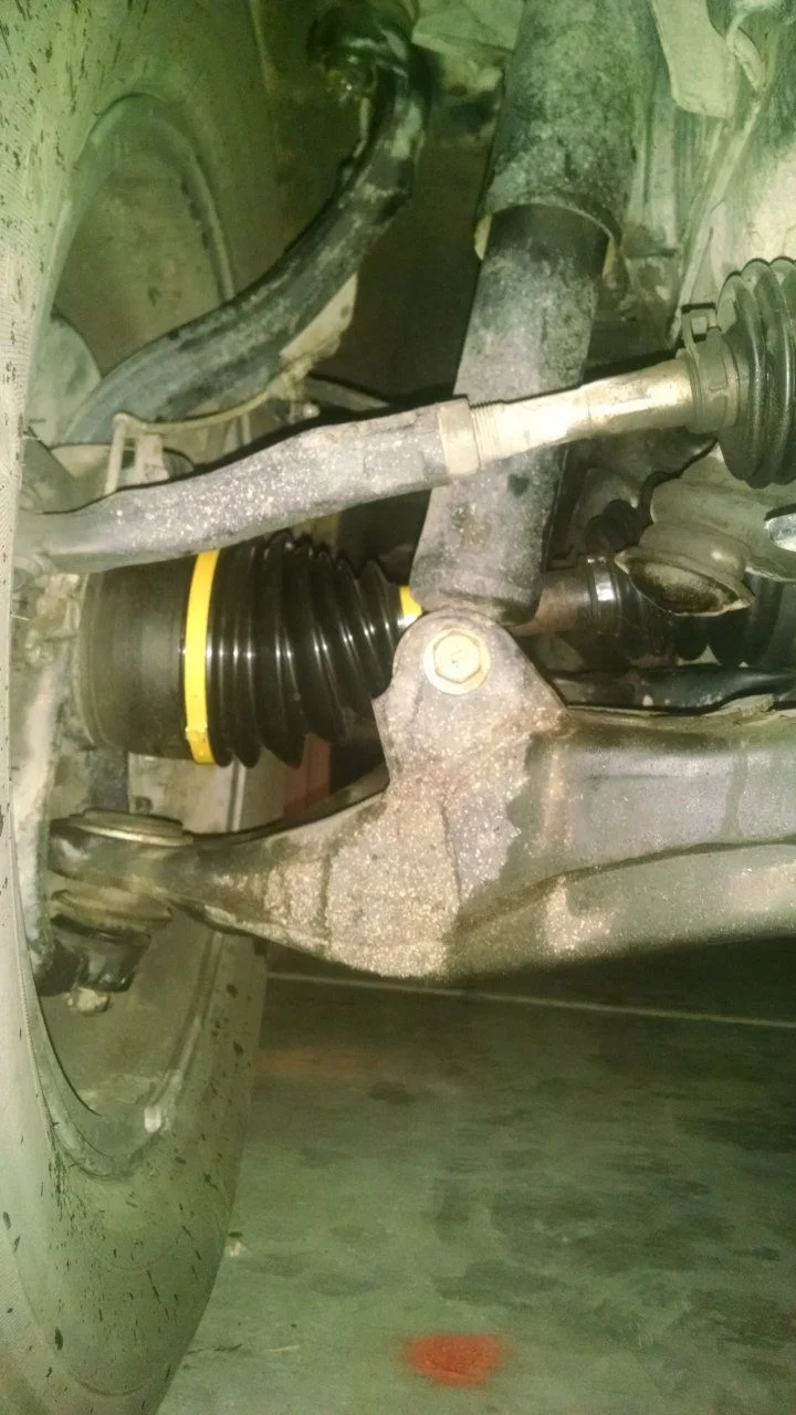

Yesterday I done both cv axles and drive flanges, front UCA's, Rear LCA's, Panhard Rod. Didn't manage to get the rear UCA's done so will be back under the truck next weekend to finish.

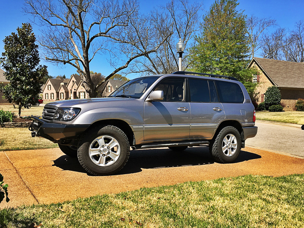

Do I really need to run the spacer in the front. To clear 285/75-16 on stock wheels ?
Do they clear without?
^ My 285/75-16 Duratracs actually cleared better without the spacer than with it. Looks better with the spacers though...

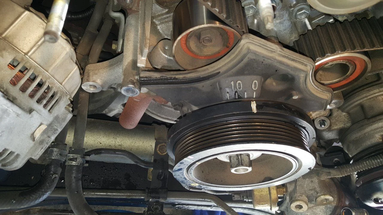

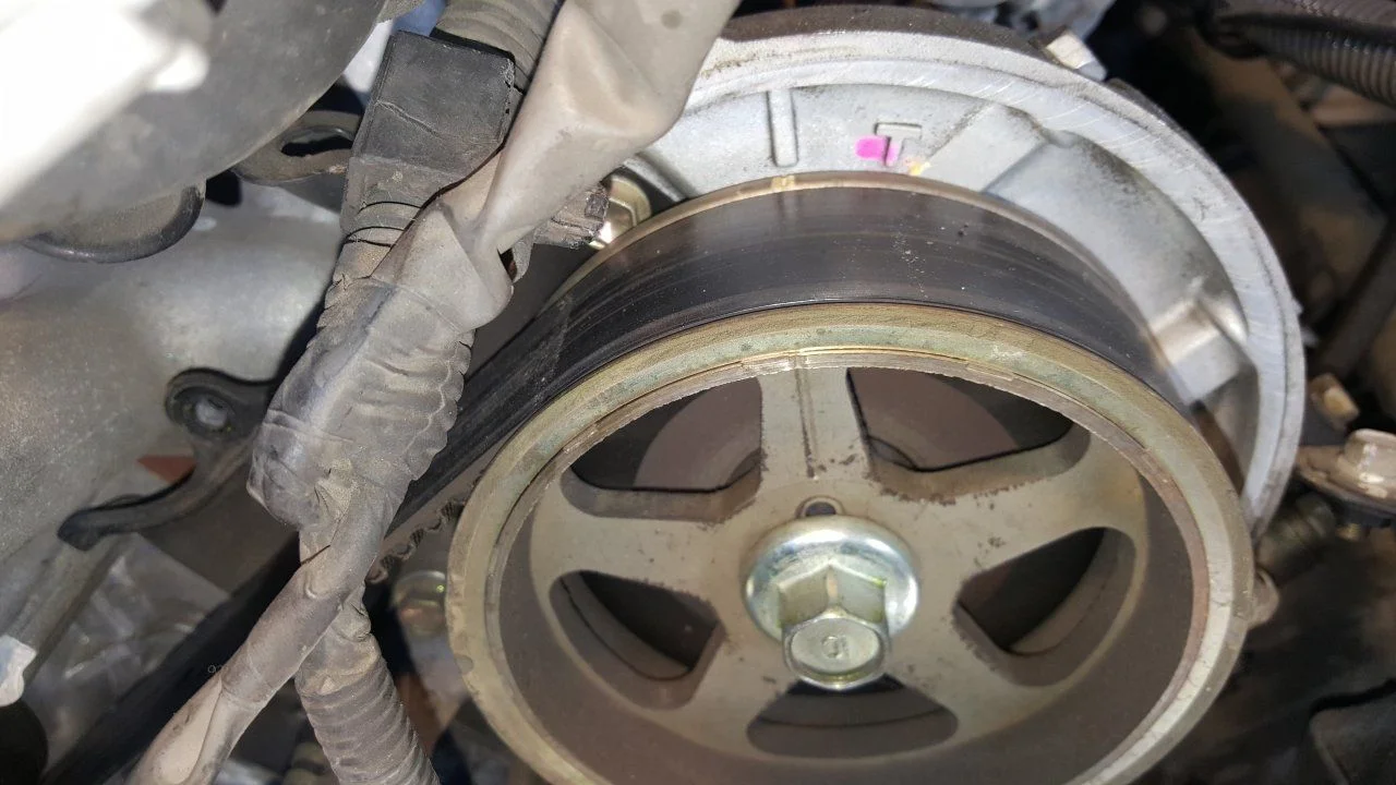

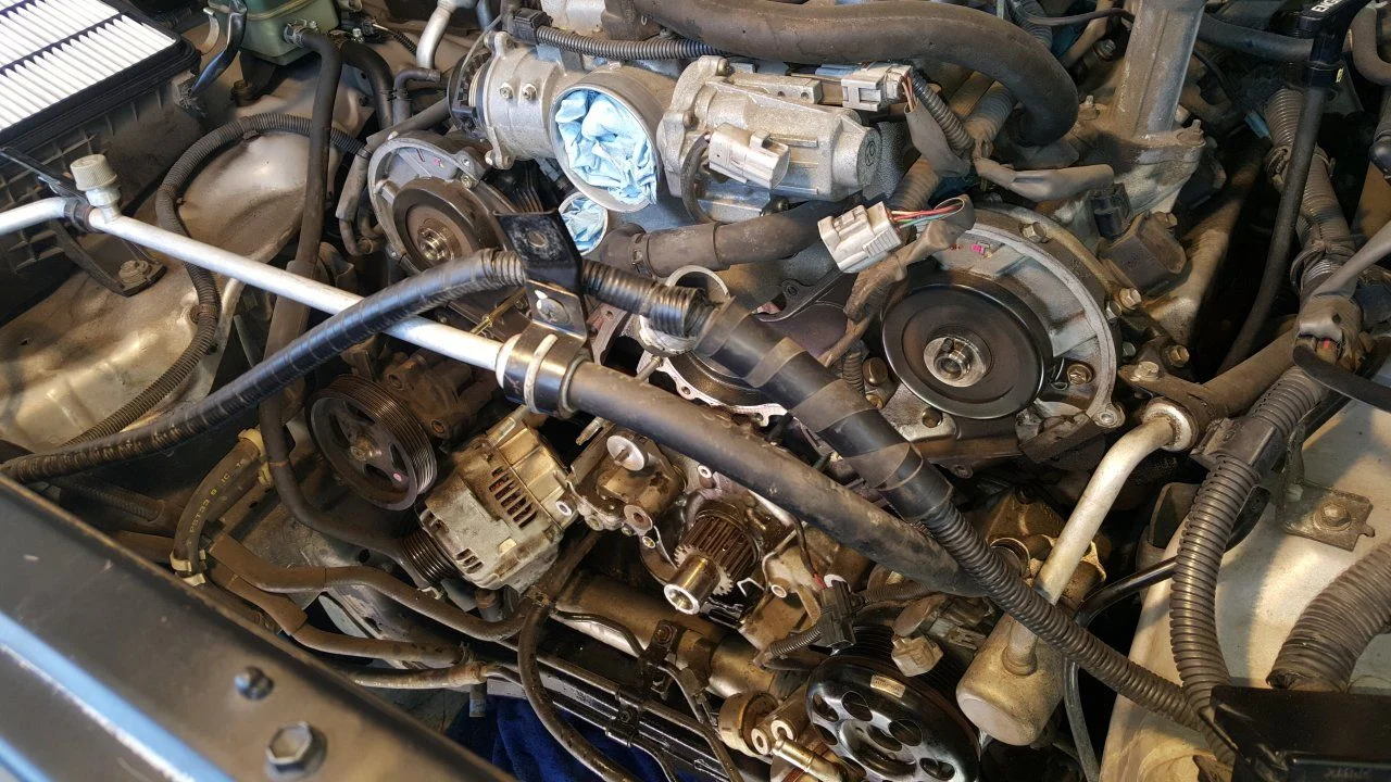

Finished my timing belt a couple days ago, not a hard task just time consuming... Replaced heater hose t's, Radiator (fxxxer had just started leaking from very small crack on filler neck) Aisin timing belt kit from Amazon, cam seals, serpintine belt etc...Anyways here are random pics.... Oh yeah peeps getting ready to do this, do yourself a favor and take radiator out.. You have way more space in there and not to mention you can fit a regular size air impact gun to losen the crankshaft bolt....Can't imagine doing this job without the extra space...
