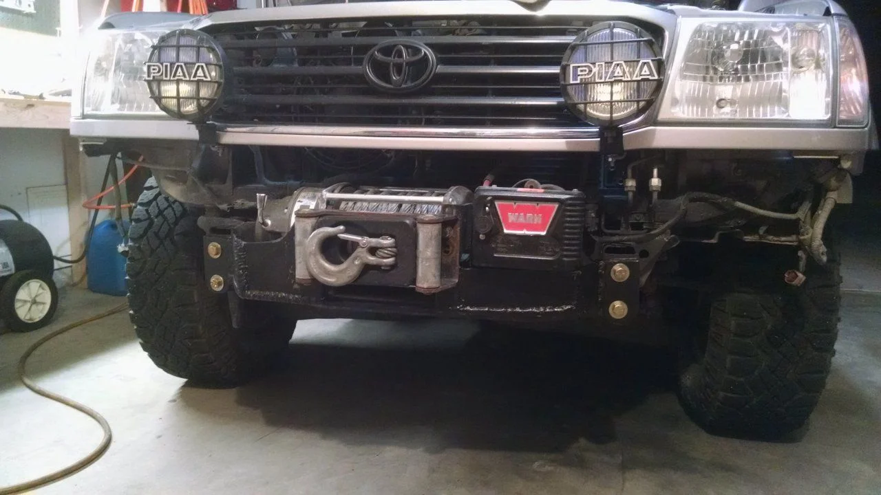

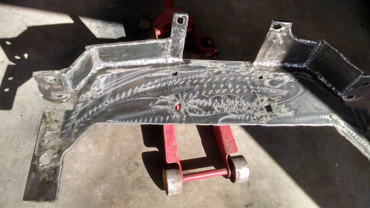

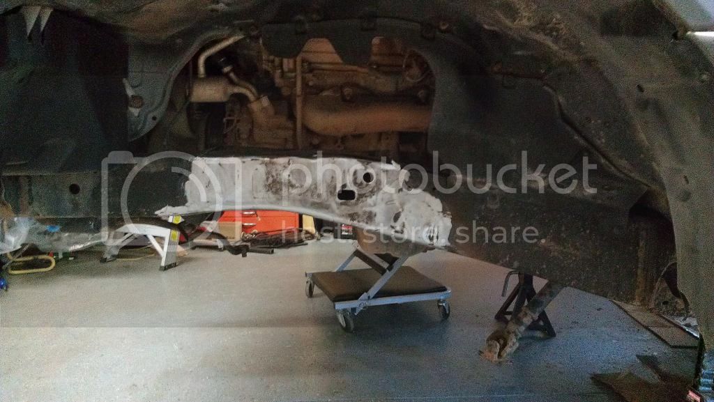

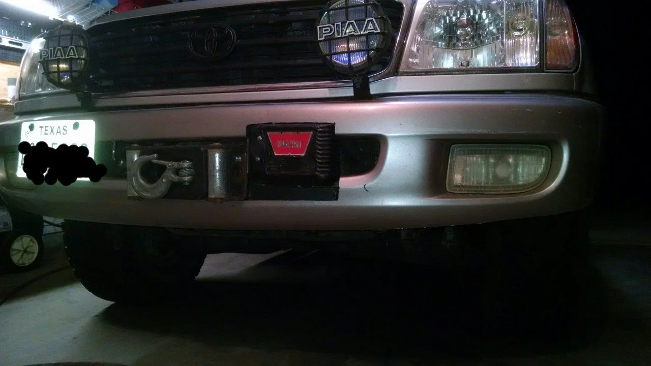

Finished winch channel. Not the prettiest, but I'm quite confident it would pull the truck apart before failing. Eventually I will remote mount solenoid, and get a different bumper cover and or build off this into a full front end something "hybridish"
I'm sure I will catch some flaq about the welds, but consumables wear out and I ran out of gas at the same time. So I cut, and ground off the original outside welds and did some "stitching" if you will.

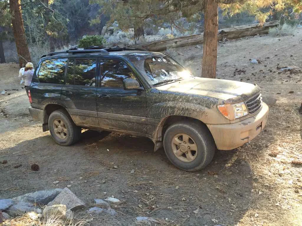

Power washed the cruiser after spending the weekend romping through some mud pools up in Big Bear, on the trail up to Holcomb Valley to climb.

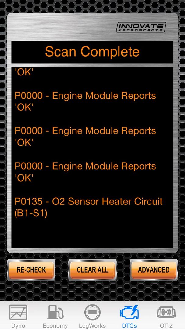

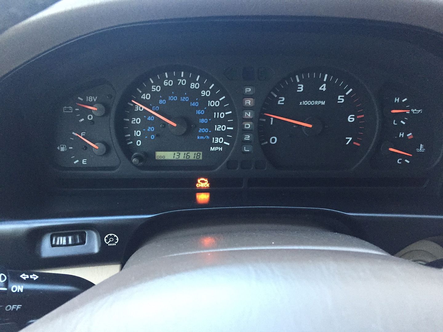

Of course, my luck didn't hold out long....
On the way to work this morning (with an outside temp of -11F) I got one of these on the dash....
....hooked up my trusty WiFi OBD Reader and pulled the codes:
"P0135"
Looks like I'll be shopping for a couple new Denso O2 sensors and a crowfoot socket in the near future!! :)

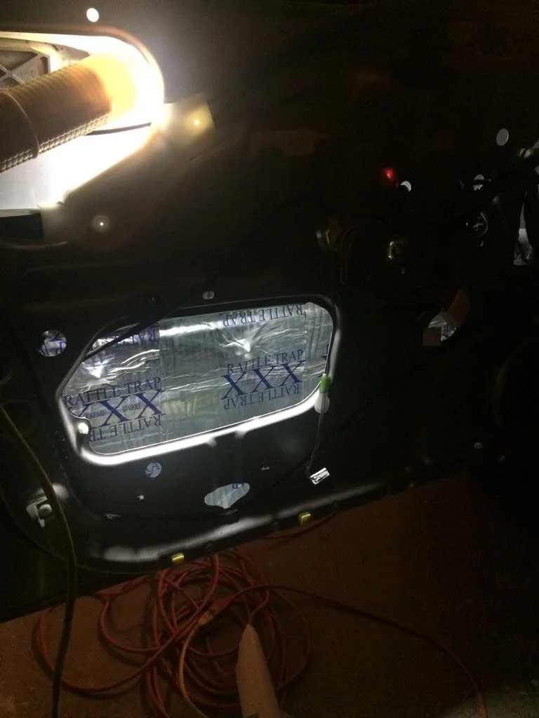

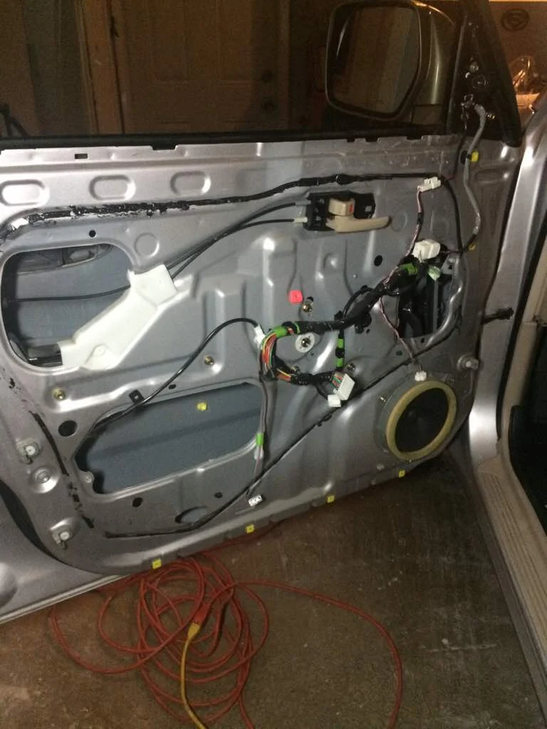

Fat matted the doors, tailgate and installed LEDs in the cluster. Fat matting the floors and cargo area tomorrow if I have the energy. I'm beat.
