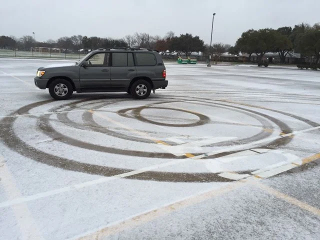

Did some donuts in the high school parking lot. Then installed a pioneer avh-x3700bhs head unit. Felt like uncle Rico living the glory days but it was just a work snow day in Texas.

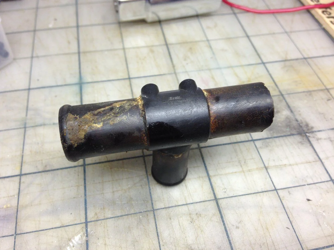

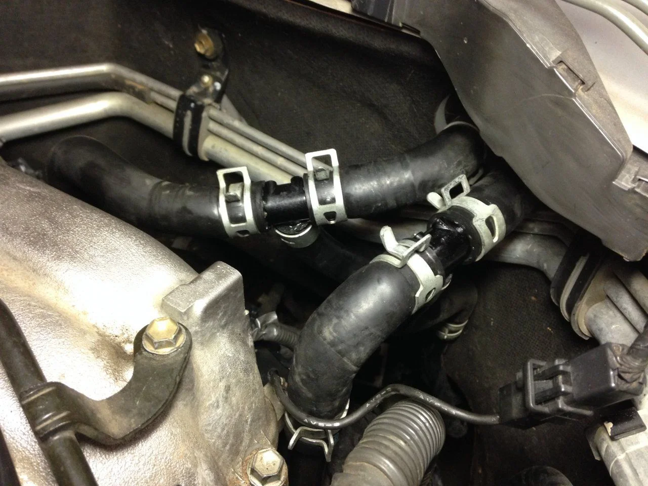

Finally got around to replacing the heater tee's this evening. I purchased and intended to replace them at 121k but continued to put them off thinking I could get by a little bit longer. Took a peek under my hood this morning and noticed a small leak dripping coolant from the drivers side (hot) stem on the end that comes from the engine block. After classes I came home and did the swap and boy am I glad. The end broke off after I barely touched it and I actually had to remove the tubing that goes from the engine block to the hot tee to fish out the bits that were lodged in there. After removing the tee I noticed that the opposite end was very close to breaking off as well and it appeared as though the coolant had started to eat a groove into the plastic. All tubes seemed to be in good shape so I figured there was no need to replace those at this point, and the clamps held their tension so I reused those as well. Luckily nothing fell down into the coolant system and all is well!

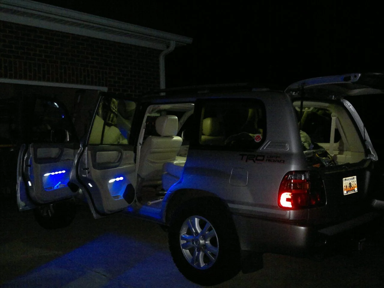

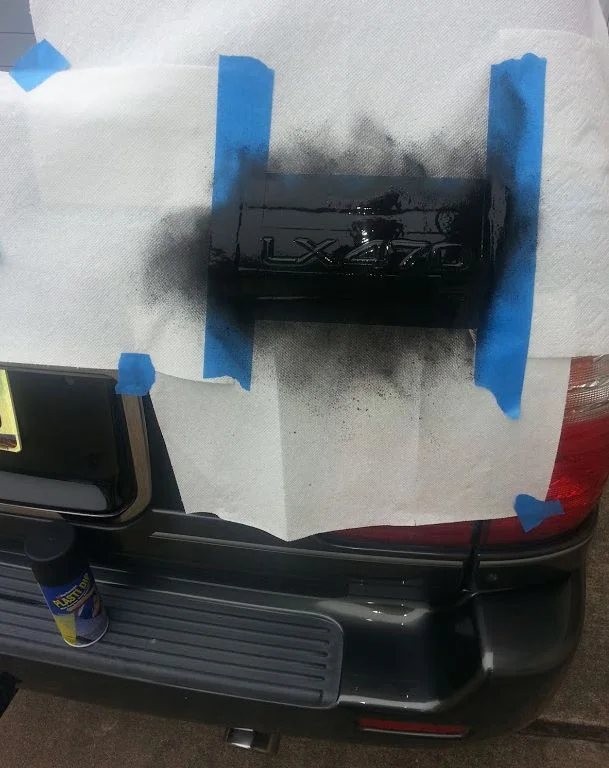

I just picked up an 01 and have replaced all the speakers, hid conversions, led interiors, pioneer dvd deck, redid tint, installed front rear cameras, blacked out badges and rims. Love the truck. Had one growing up and can't wait to see where we go.
