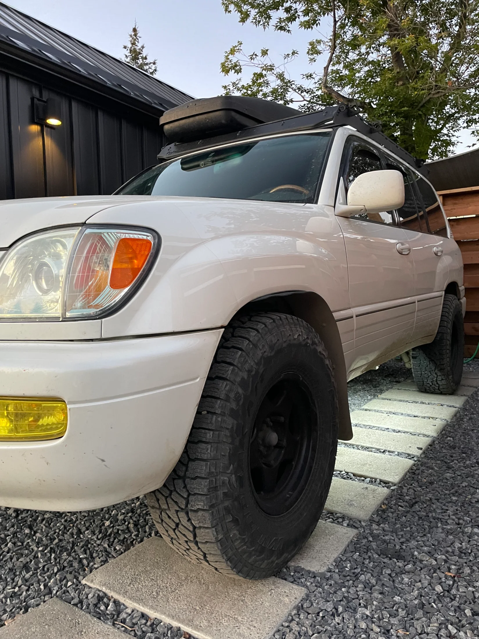

Added puddle lights back onto the LX. Stock connectors were available, but the ones on the underside of the truck were heavily corroded, so I hardwired them. I used a couple of those 60” pickup brake light kits and just wired the whites to the original wiring. That’ll let me use the reds later when I get a switch panel and some ditch lights.
