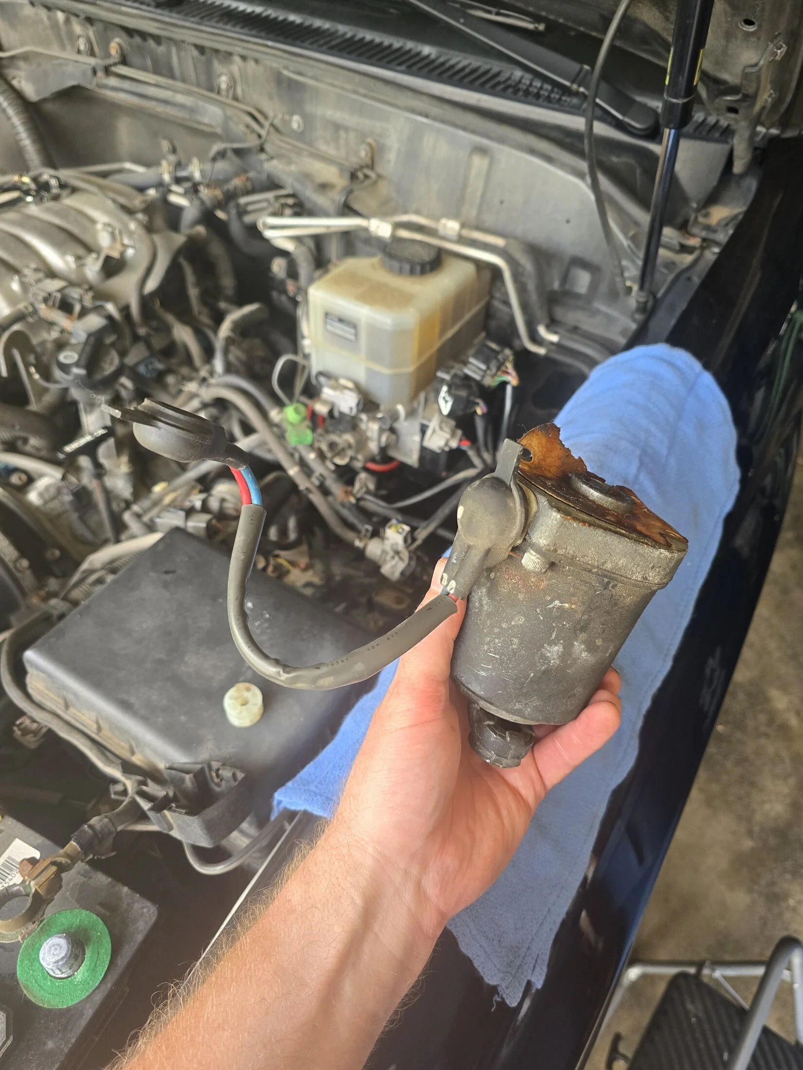

Last week, my daughter was driving the LX and got the dreaded " ABS & Brake dash indicators " along with the annoying buzzer in the cabin letting me know the brakes failed. Yesterday I replaced the ABS brake booster motor and all is well. The original motor made it 247,000 miles. We will see how long this one lasts.

The common denominator I’ve seen in 100s for the abs failure is the presence of rust/corrosion. This is one of my recommended pre-purchase items to check to my friends looking to buy one so they can negotiate more on the price as this is not a cheap repair. Nicely done.

If I would have let the Toyota or Lexus dealership do this repair, it would have easily cost around $4k. Since I did the job after watching a few YT videos some cruiser brothers put out, it only cost me $75.00 and around 3hrs of my own time on a Saturday...plus three minutes for the buzzer to finally shut off🤙

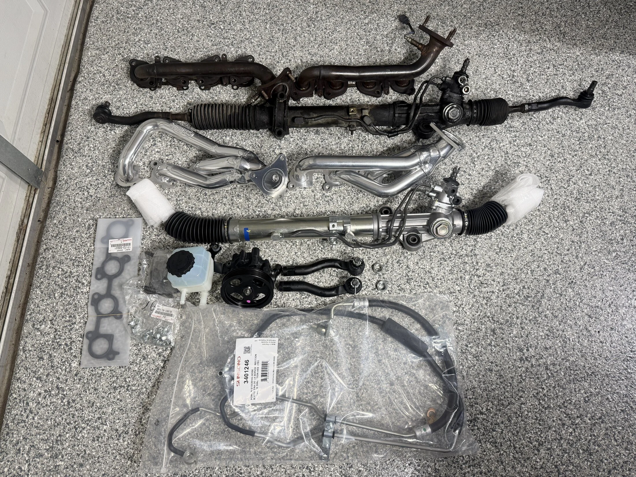

New oem steering rack with new PS pump, reservoir, d bushing, and outer tie rods. Aftermarket low/high pressure lines. The intermediate shaft u joints are floppy so ordered a new oem shaft.
Doug Thorley headers with oem gaskets, studs,
And nuts.
Also, filled Aisin fan clutch with 30k CST and set first opening at 120 degrees. I replaced the fan clutch last Nov 2023 but temps would creep at idle ~210 degrees in middle of summer here in Texas where we see 100+. The fan clutch was under filled from the factory, which became apparent in the summer. I installed all new cooling Nov 2023: radiator, tstat, water pump, hoses, fan + clutch.
New oem steering rack with new PS pump, reservoir, and outer tie rods. Aftermarket low/high pressure lines. The intermediate shaft u joints are floppy so ordered a new oem shaft.
And nuts.

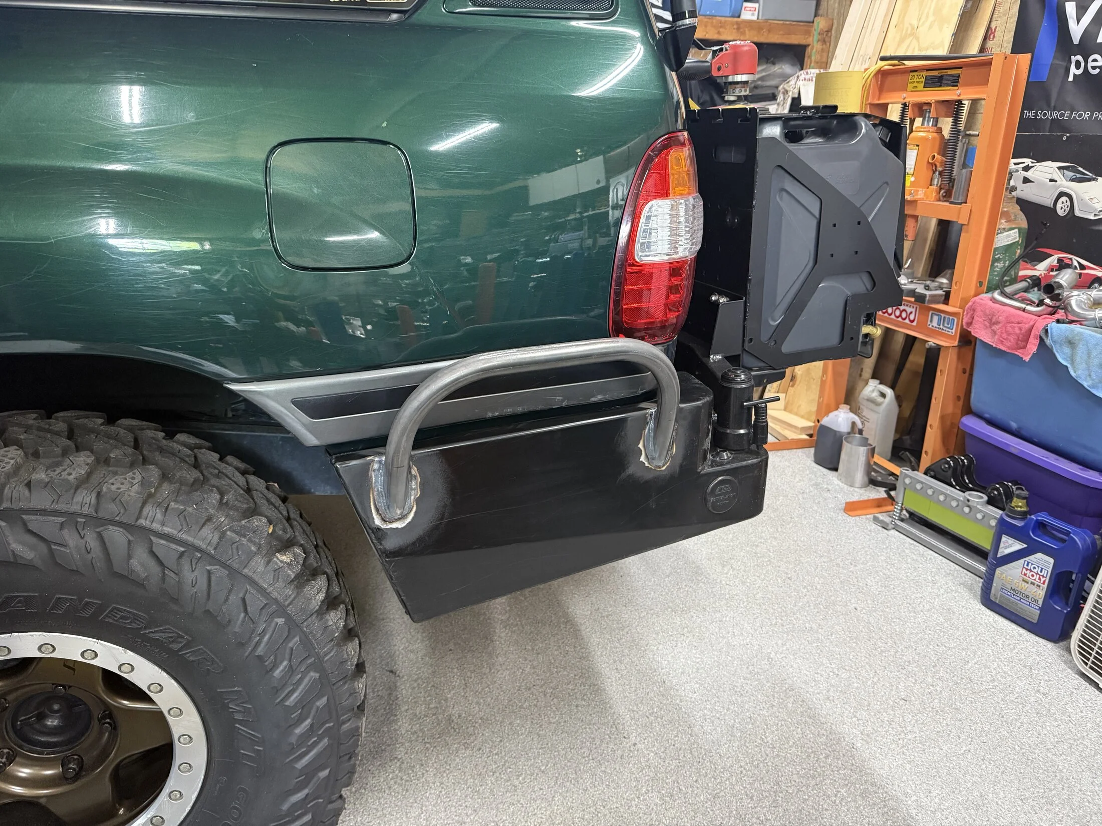

Welded in some quarter protection
Nice work! Great idea!
Now tell me about the flooring you used in the shop. That looks amazing!
thats my buddies shop, he had a company come in and do epoxy floor coating. It been down for probably 5 years now and holding up great but i know it wasnt cheap

What was the part number for this one? Did you go OEM or? @jbyrd78

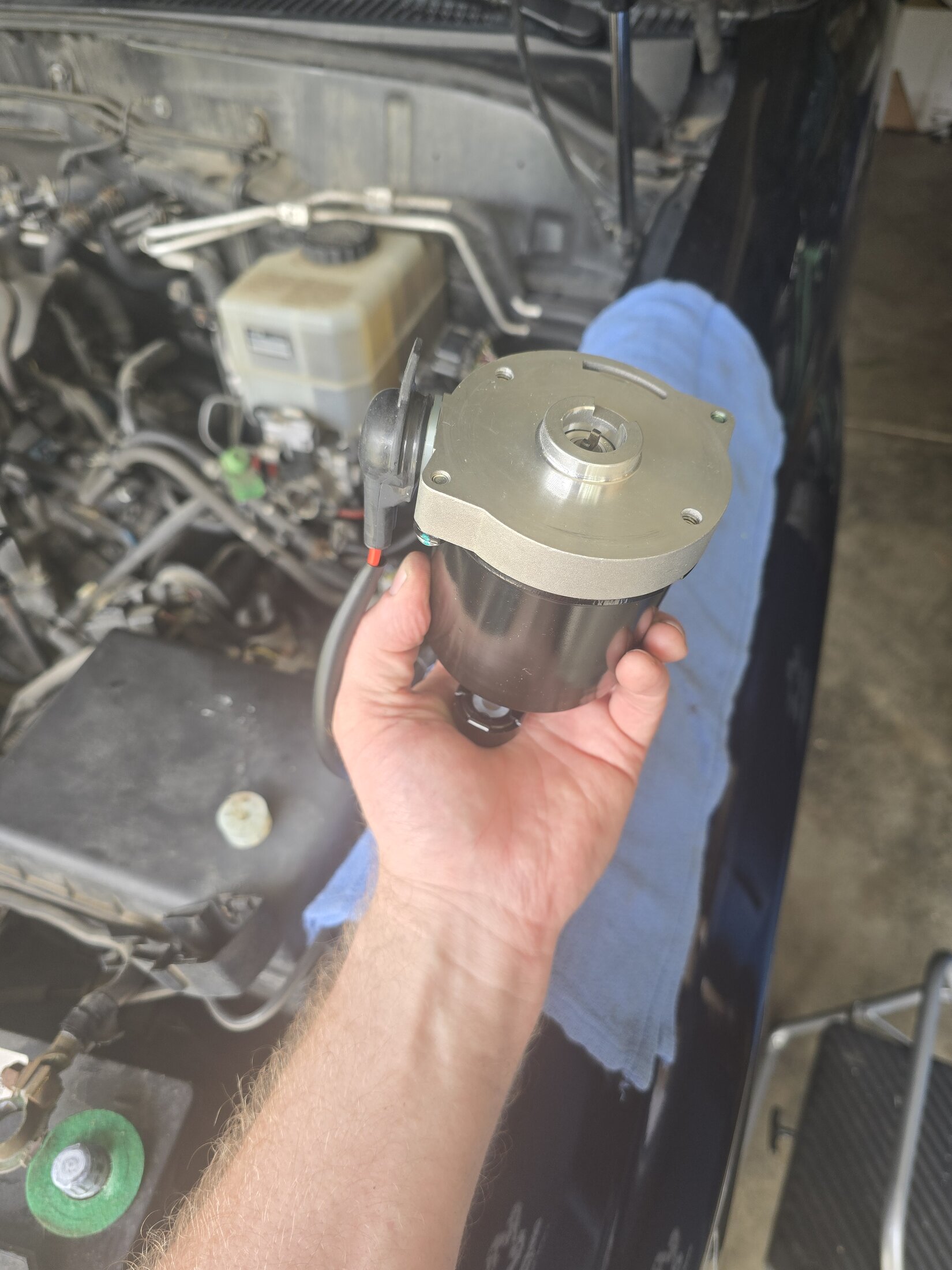

I purchased an aftermarket part off Amazon.
From what I could find, and anyone can feel free to correct me if I'm wrong, but there is no OEM part number. Their is a set of number stamped on the motor, but it didn't bring anything up. My understanding from the videos I watched, is that Toyota will only sell a full ABS master cylinder and not just the motor.
Here is the motor that I bought off Amazon.

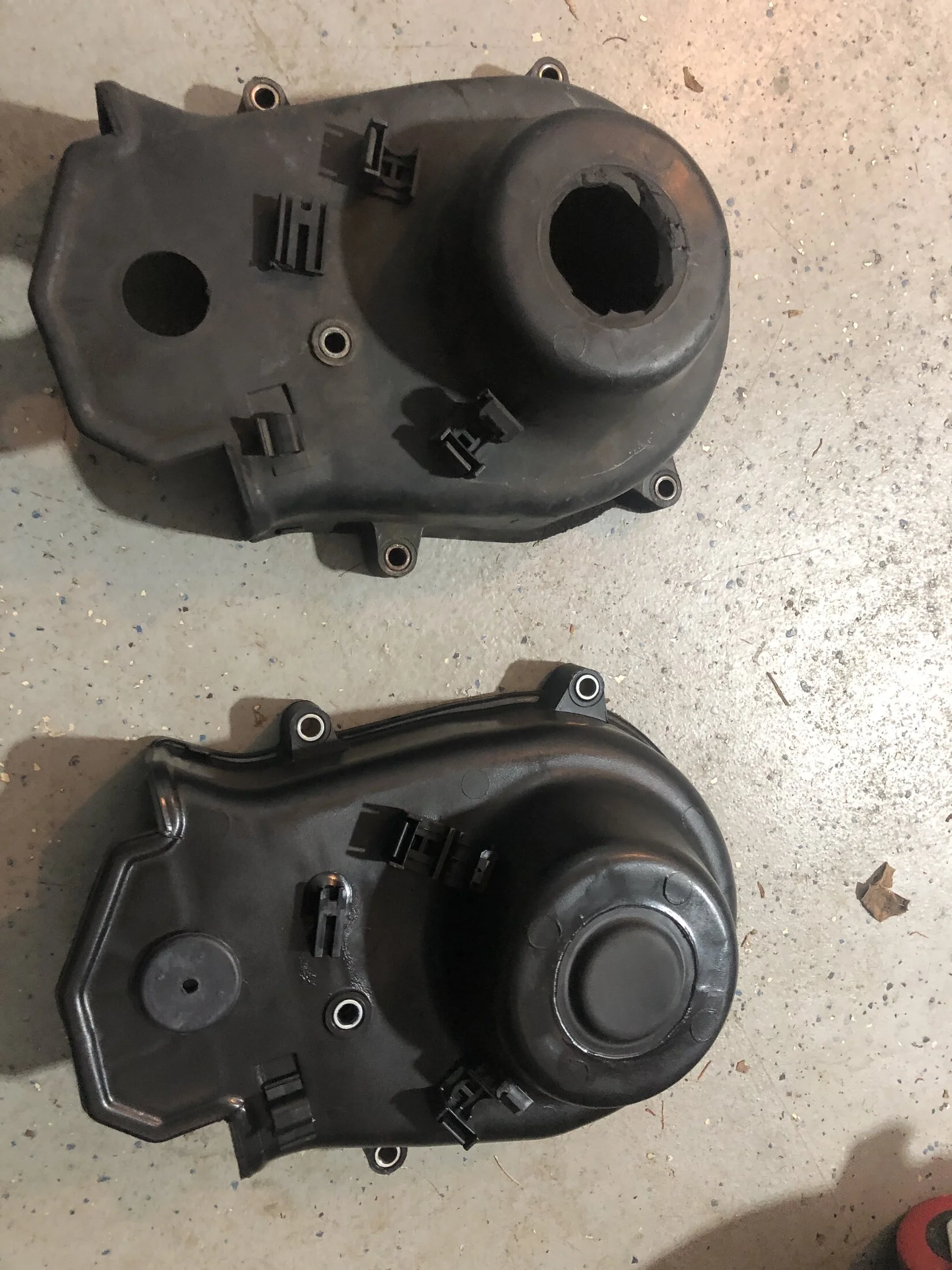

Previous owner or something had busted the cam cover. I finally got around to replacing it. Anyone know the rationale behind having this cover composed of both hard plastic and the rubber cap area?
