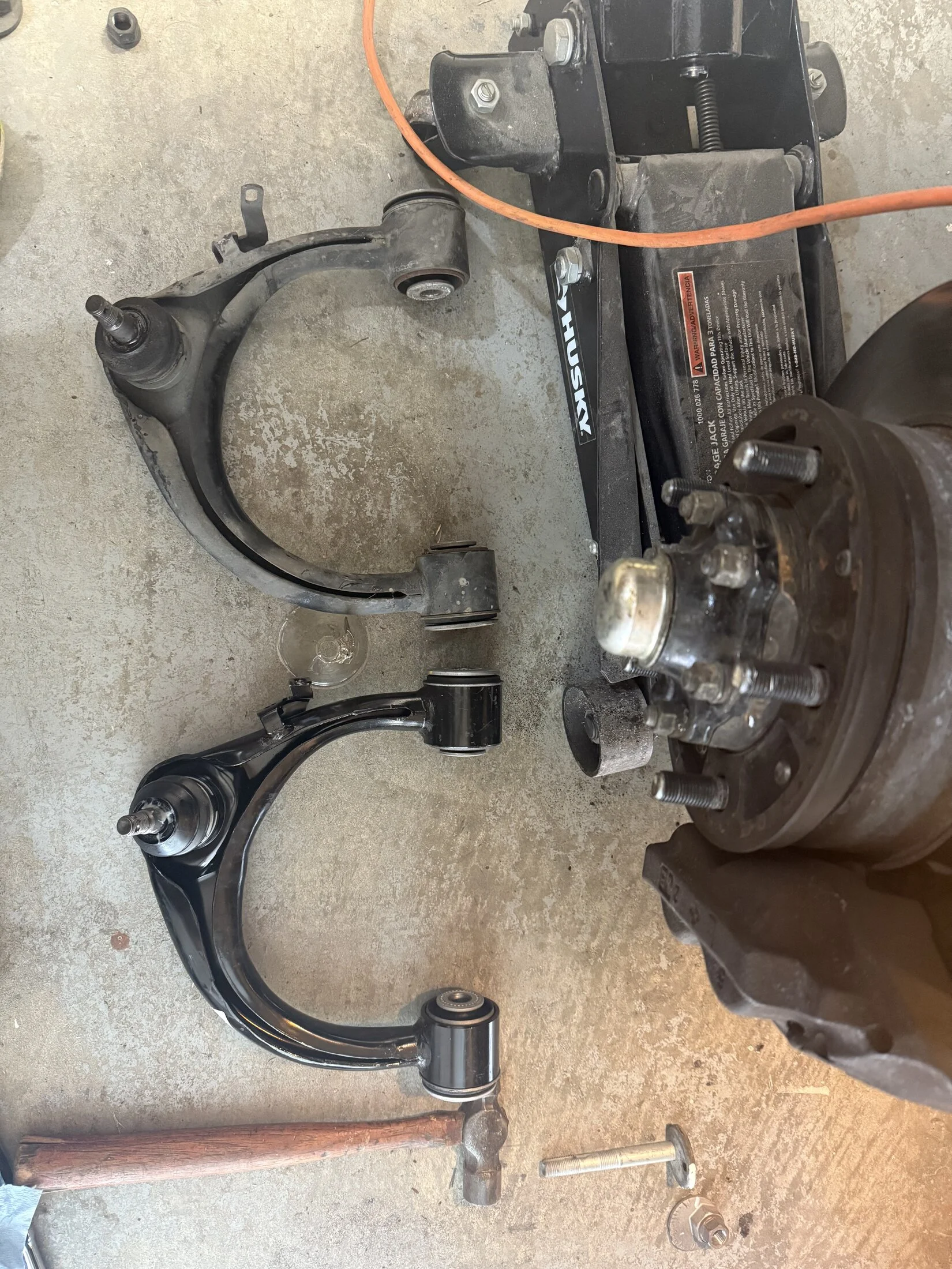

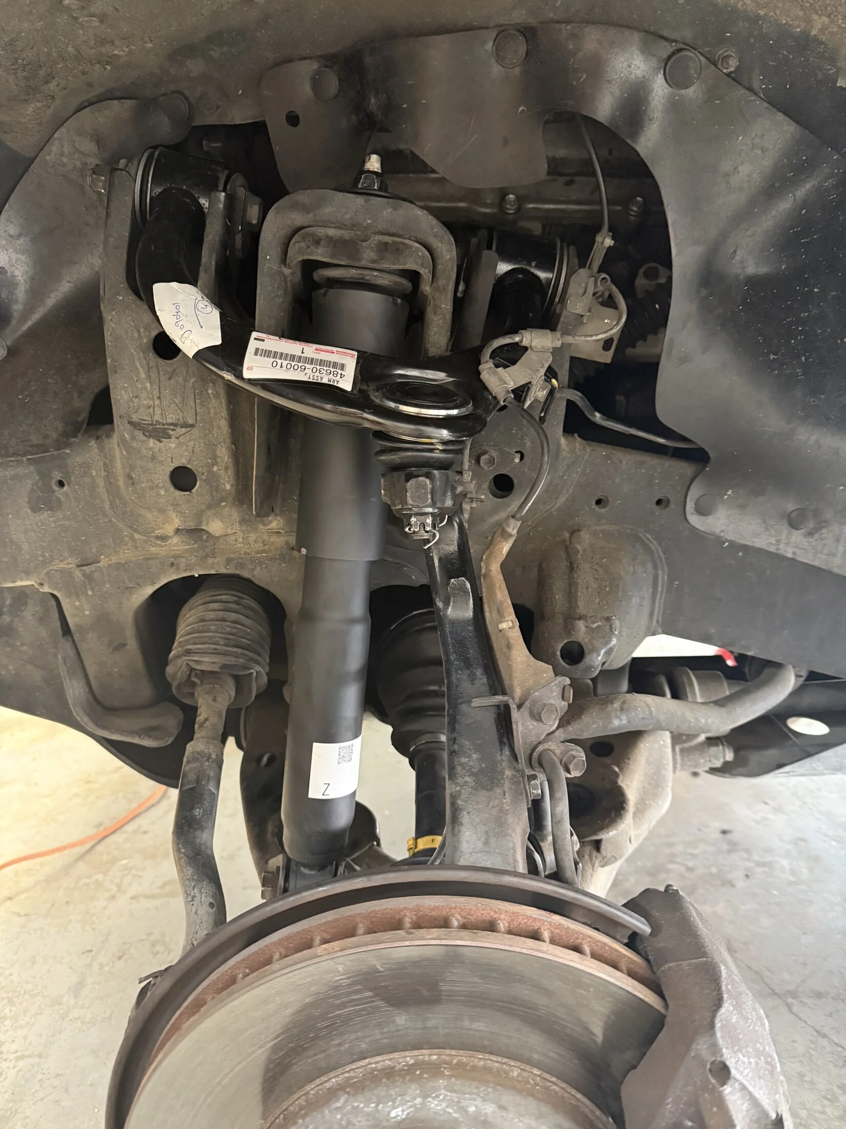

Today I did the upper control arms on the front, and the front shocks. Per usual drivers side took 2 hrs, passenger took 1 hr. Now she only rattles on the back half!

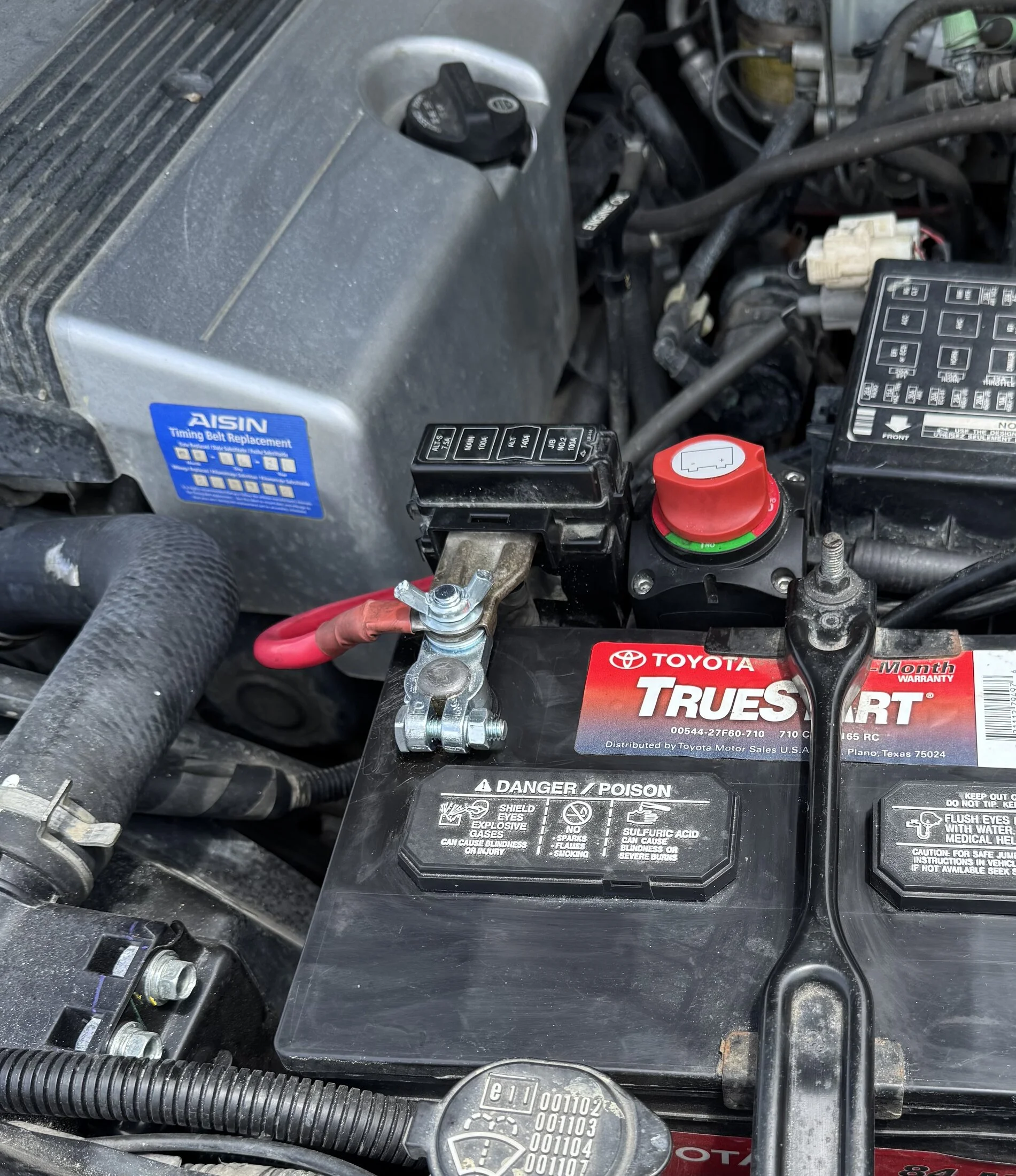

Replaced the positive battery terminal with a Duralast Gold marine terminal. I’ve been fighting corrosion ever since I installed the Toyota battery. The original factory terminal had seen better days, was warped and not providing the best connection.
