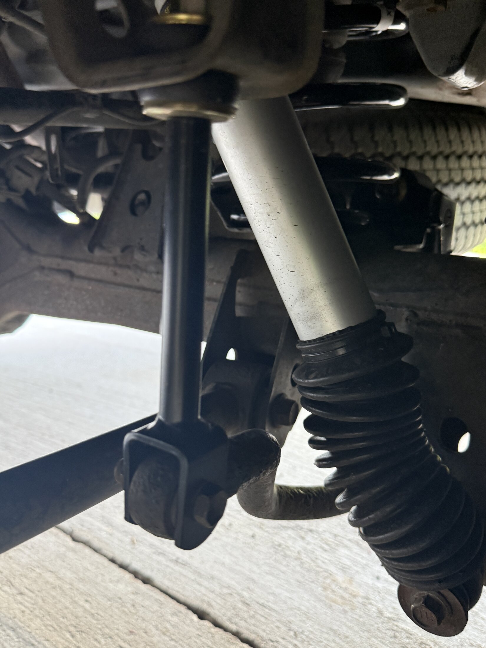

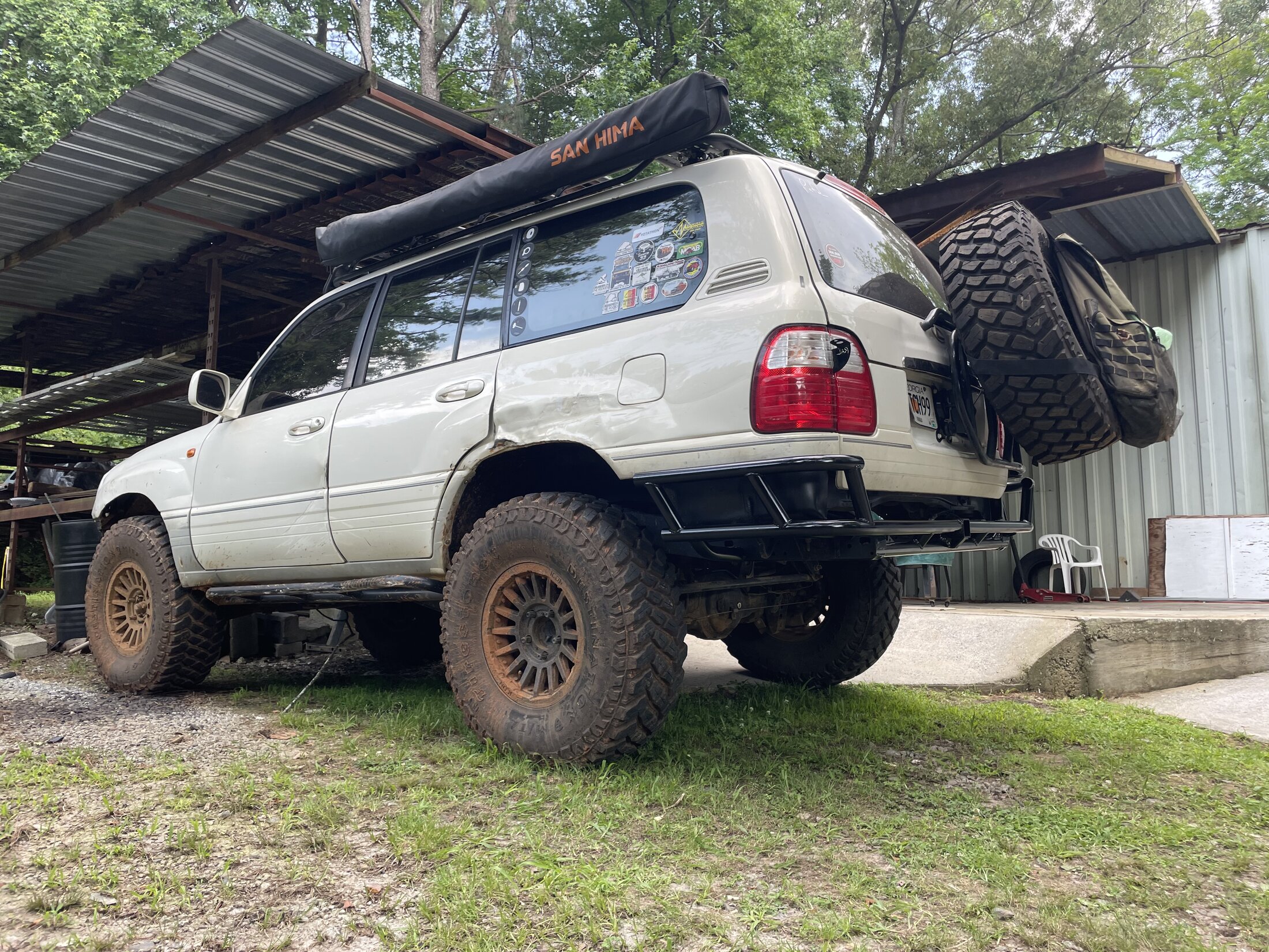

I finally decided I was never going to get around to installing all the parts I have been collecting for the one-hundred and took it over to Mike at MEO to give it a little love.
Short List:
New CVs and hub flanges
New Icon shocks
New Torsion bars
Dif drop
Ekimkeith
Wheels
Tires
Much needed cleaning
I finally decided I was never going to get around to installing all the parts I been collecting for the one hundred and took it over to Mike at MEO to give it a little love.
Short List:
New Icon shocks
New Torsion bars
Dif drop
Ekimkeith
Wheels
Tires
View attachment 3919733View attachment 3919734View attachment 3919735View attachment 3919736

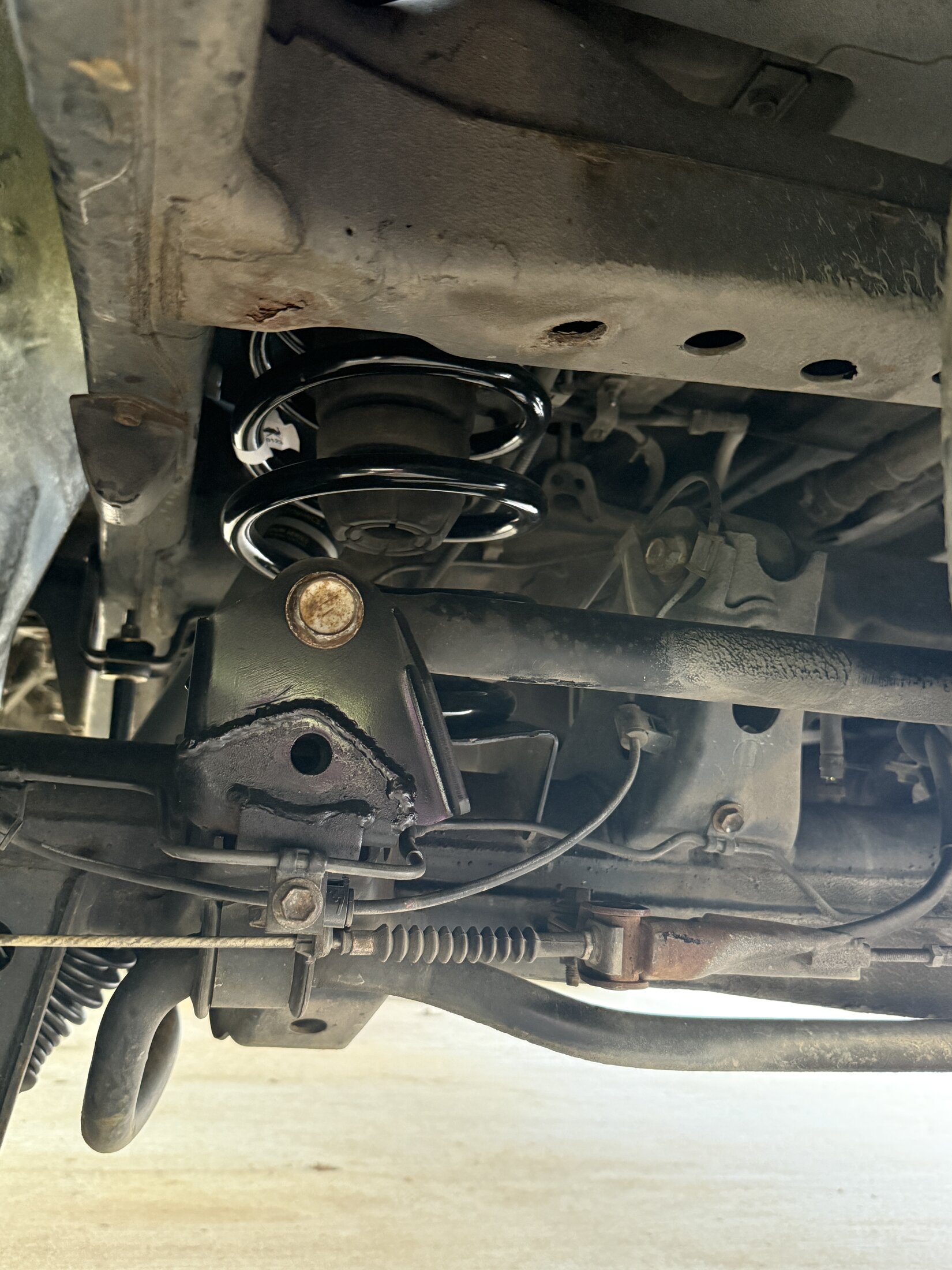

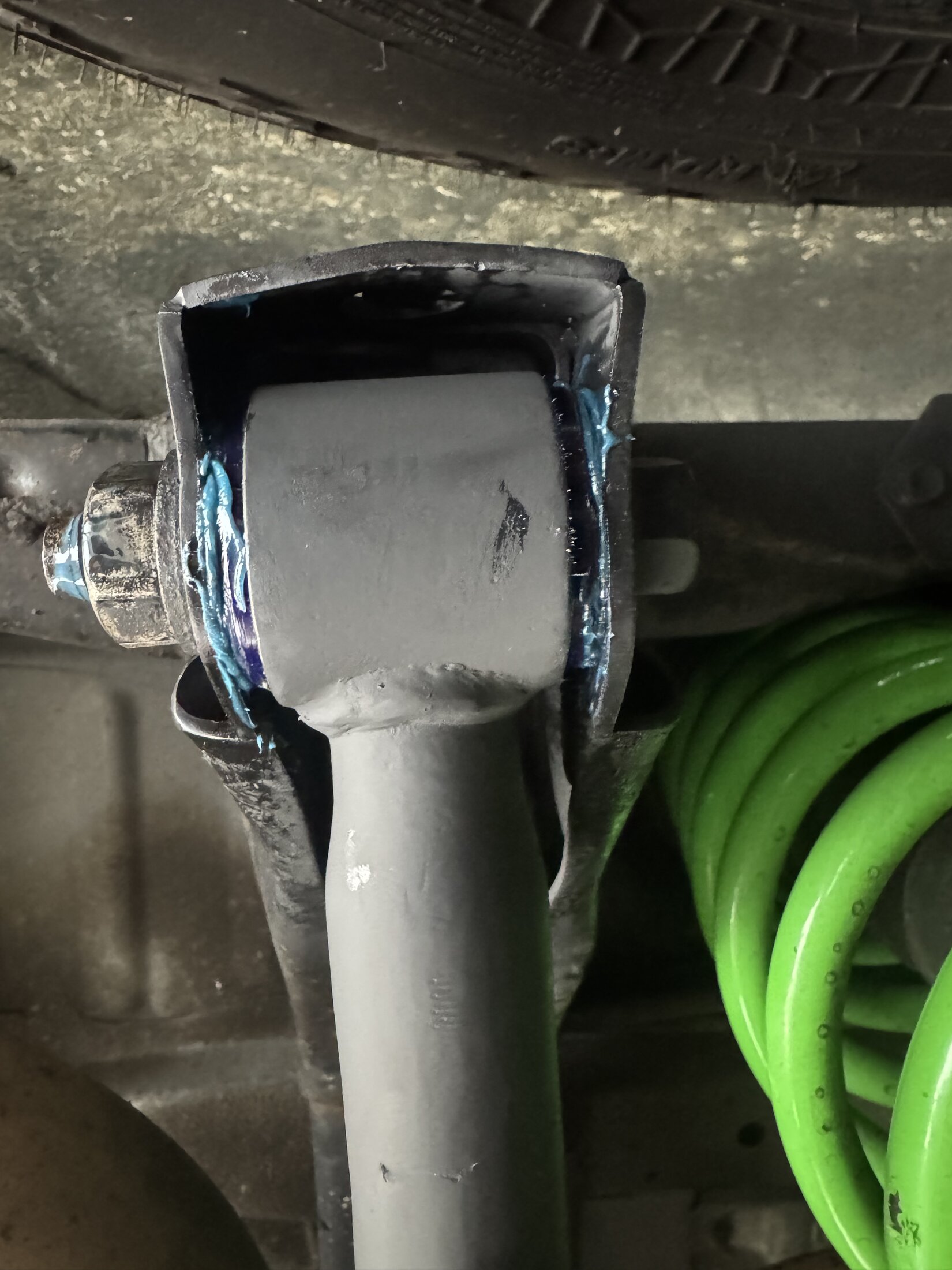

Did you also weld on the frame side bracket for the Eimkeith PCK? I’m asking because I just did mine on my 2000 LC and noticed to get to the 110 ft. Lb torque spec the bracket had to suck in a considerable amount and distorted quite a bit. I think its probably fine but it caught me off guard. Here is a picture looking up at the bottom of the frame side bracket. I installed new SuperPro bushings in the Panhard bar and I feel like they are even wider than OEM and it still distorted like this.
Mike (@Fntoy) mentioned the frame side bracket and replaced the bolt with something different. He said that bolt was “no good”. He didn't give me much more detail than that. I didn’t question it considering he is under these land cruisers for a living.
I’d be curious as to what he knows (@Fntoy). I’m not sure how a differnt bolt would change anything. I reached out to Eimkeith on their website but have yet to hear back.
I agree. I could have misunderstood. Sorry, this is what happens when you don’t do the work yourself for a change. I’ll be curious what Eimkeith says.

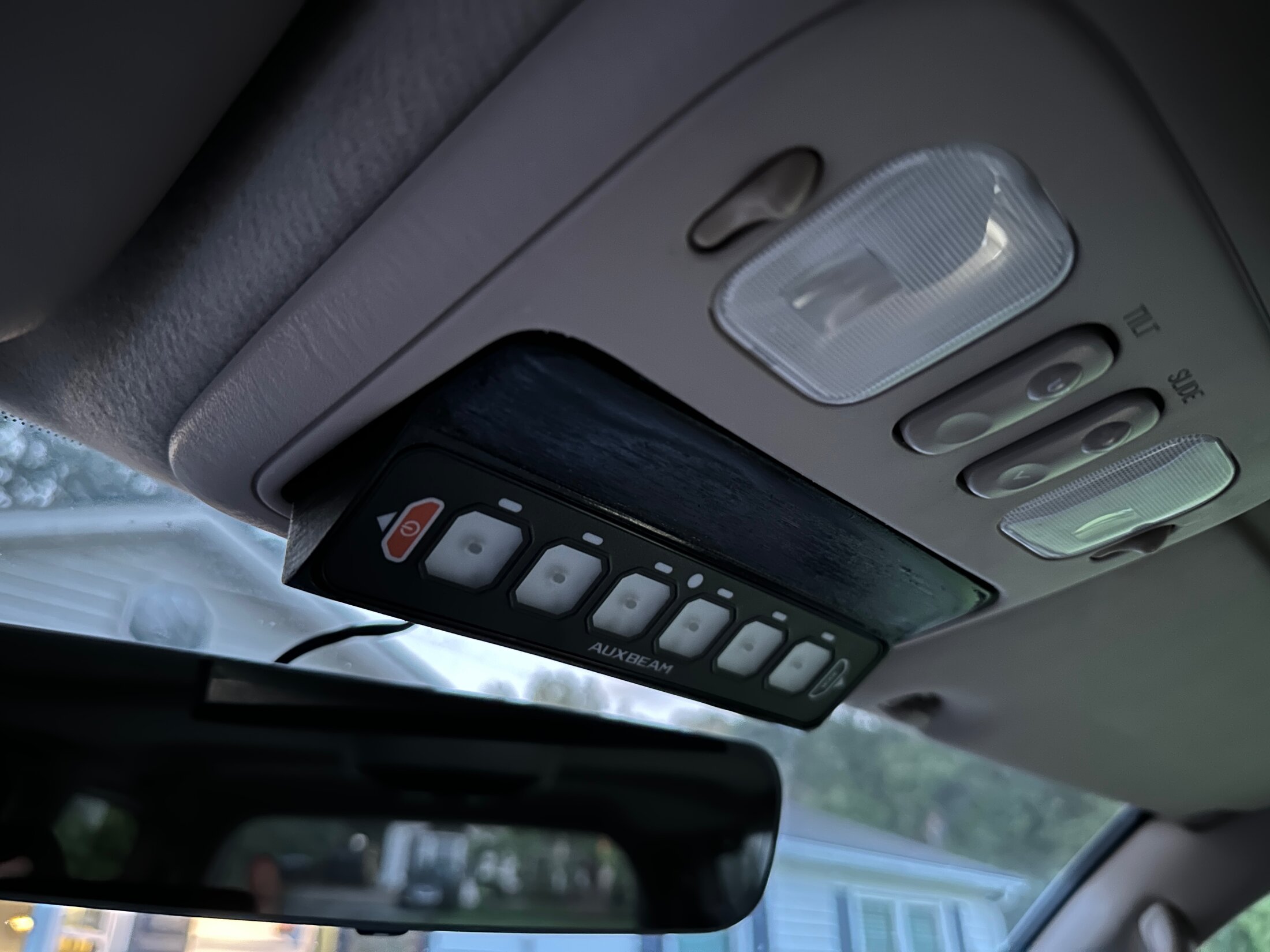

Designed and 3D printed a mount for the new Auxbeam slim switch panel as I wasn’t the biggest fan of the chunky rectangle panels.

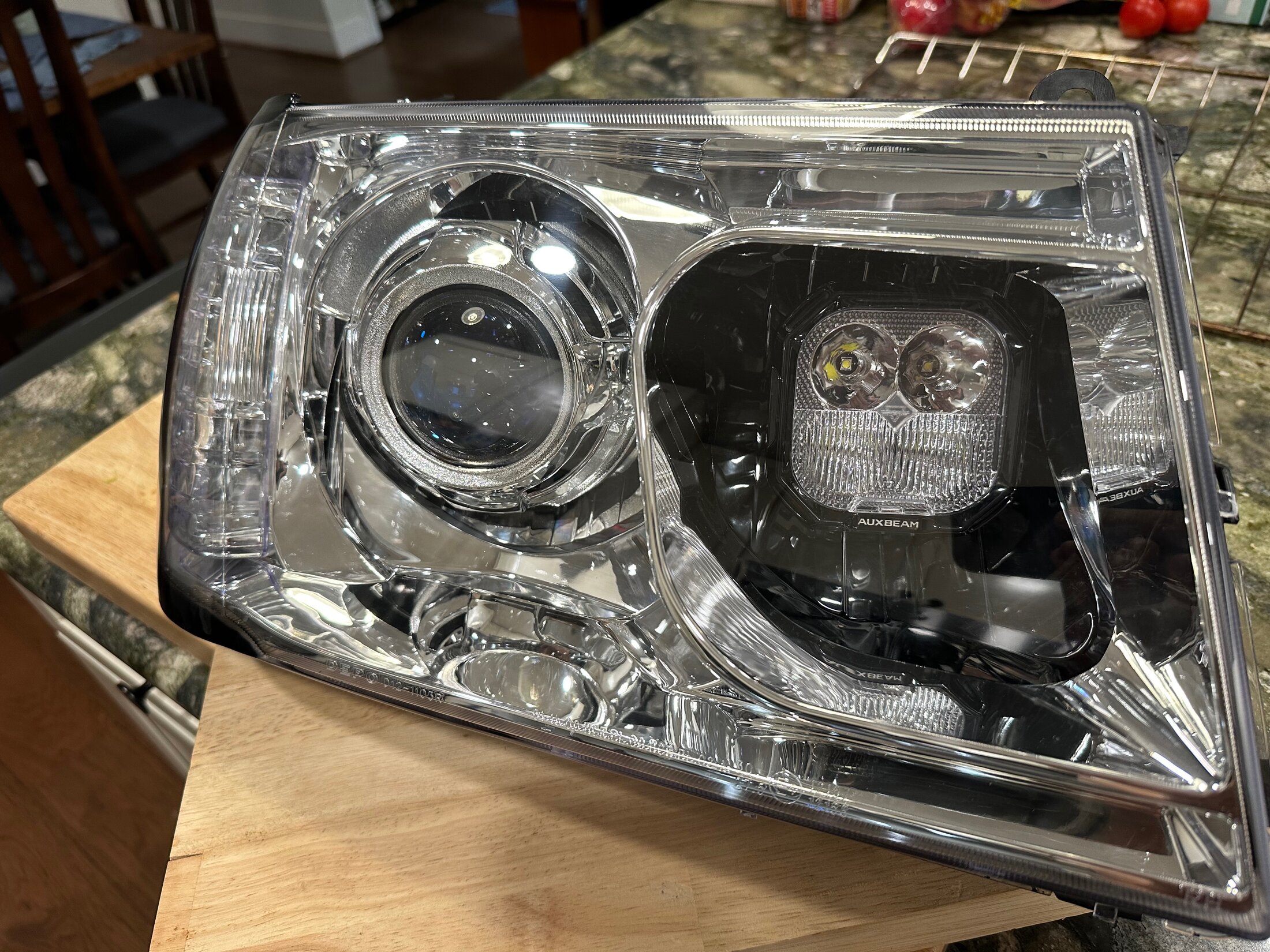

Completed my headlight retrofits using bixenon projectors and an Auxbeam light in place of the high beam. Designed and printed an alignment jig and mount to make it happen using stock holes on the rear of the lights.

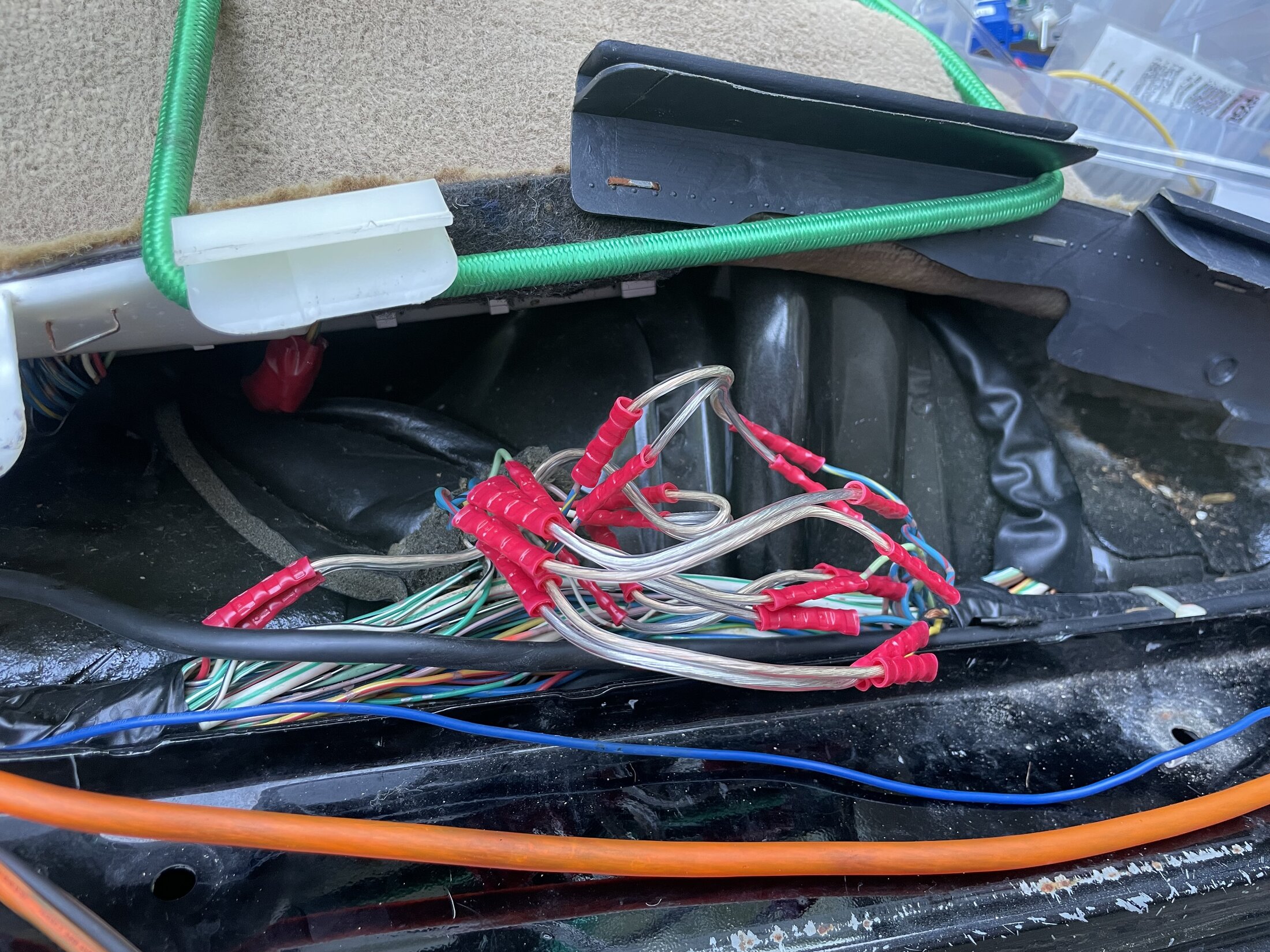

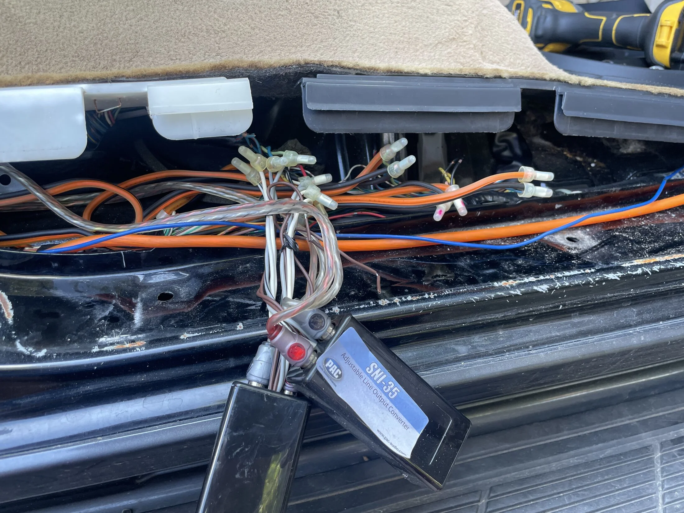

Pulled the crappy Memphis 300W amp the PO had mounted to the wall with drywall screws. It drove a 10” sealed box woofer that was a quarter second behind. PO also had cut the speaker wires and tied in converters so I had to splice in pieces of wire. All back to stock and the ML system still sounds great.
Before: (at least all the speaker wires are in the same harness)
After:

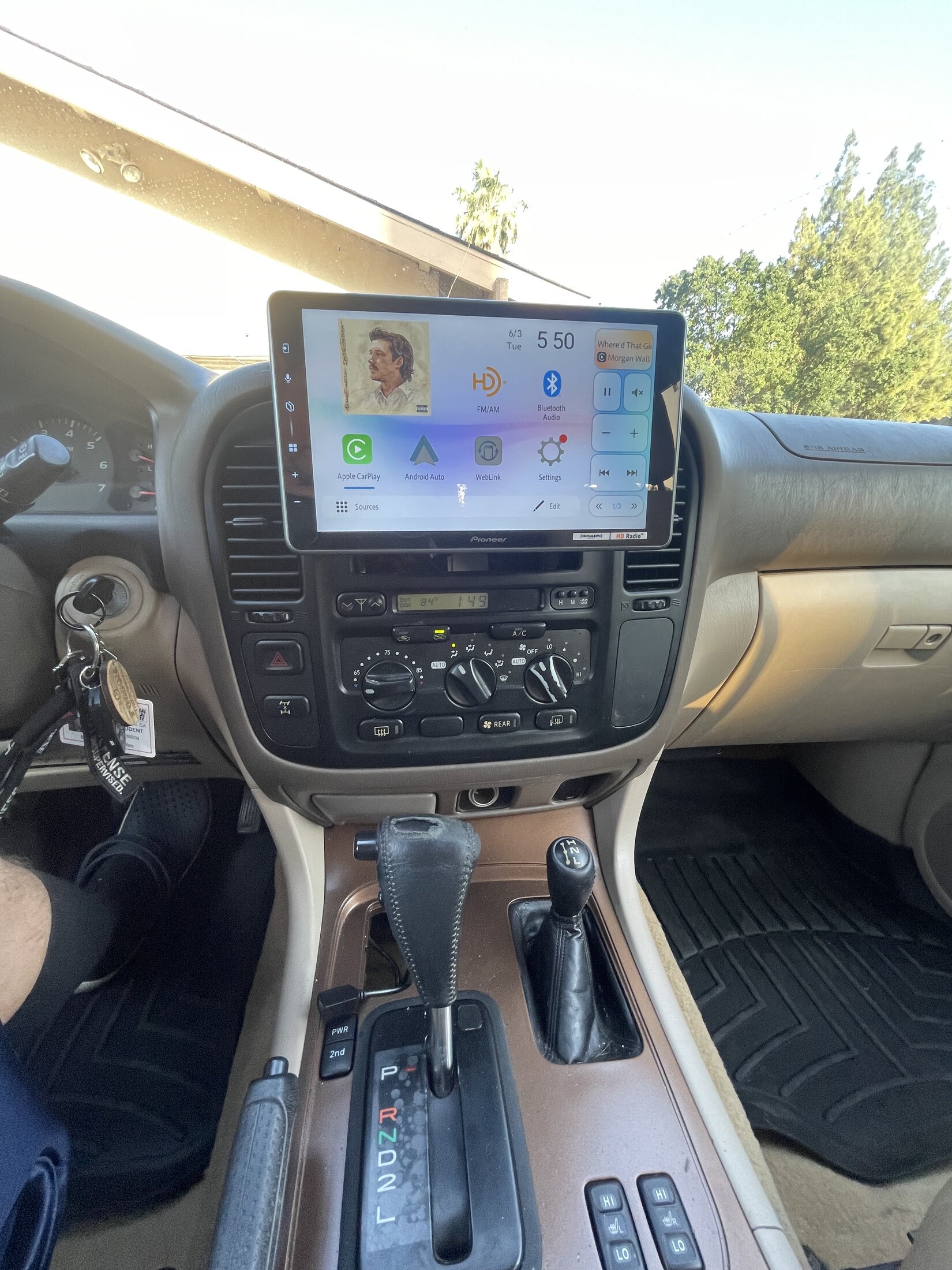

Finished the navigation delete and installed a Pioneer WT5000NEX head unit. Sounds so good and feels good to finally have A/C back again. Just in time for summer.
Is that a single or double DIN unit? I've been looking at the Kenwood's floating displays.
