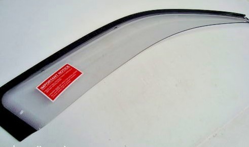

Do you know where to get these window visors? The US ones and even the JDM ones seem to be different. I like these because they look more like the 80 and 60 series ones.
Found some on eBay, they’re a genuine Toyota part that start with PZ, which I think means Australia only
Might be worth jumping on if the shipping isn’t insane, our AUD is in your favour at the moment
