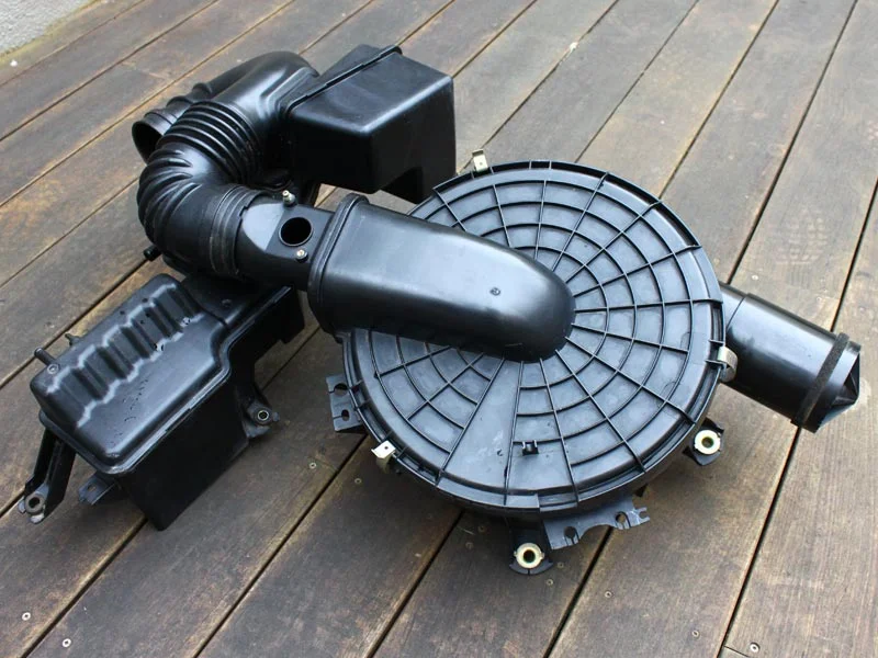

It has been about 5 years since I first wanted the OEM cyclonic filter. Not so much because I need the filtering capacity but more so I could fit a full size aux battery in the AHC LX. Peter (Moooooo) was helping me with leads and salvage yards in Australia but I was never able to get a hold of one. I pretty much gave up on it. Peter didn't though!

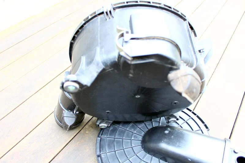

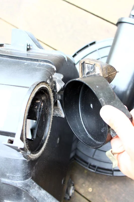

The cyclonic air box is pretty cool, actually. I have had this type of set-up in my 70 and 80 series. How it works, as I understand it, is the centrifugal force draws the particulates to the outside of the round box and the cleaner air is sucked into the center. The particulates spin around but eventually fall to the floor of the airbox where there is a "tuna can" that collects it. The tuna can is easily accessible from outside the box and can be dumped without removing the filter.
There are two rubber one-way valves on the bottom where dust can escape (dust relief valve, as it is called). The OEM air filter is also washable.

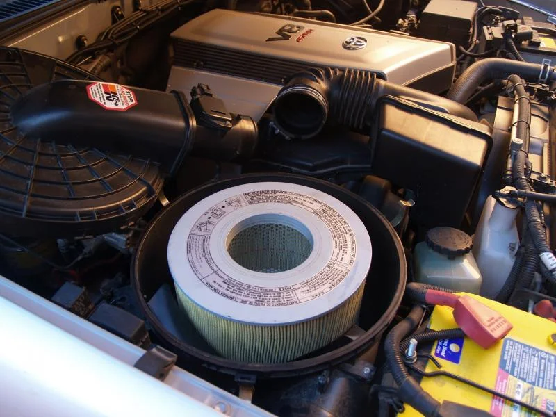

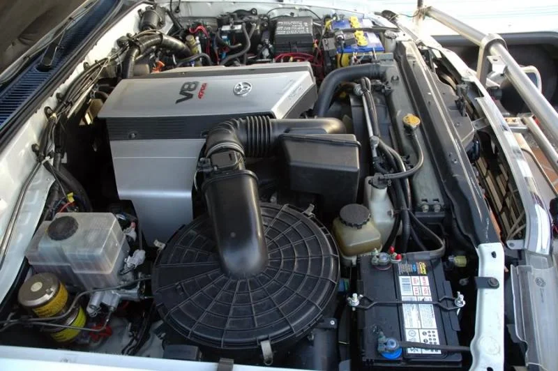

I don't have it installed yet as I need to get a few more parts including the filter. But here are a other people's pics of the filter installed. As you can see, it makes room for another battery behind the PS headlamp. And there is room behind the airbox in a LHD 100 for even another battery if one wanted. Yes, keen eyes will notice the PS reservoir is in a different location. It is mounted to the aux battery tray.
Special thanks to Peter for hooking me up. If there is enough interest in the same set-up, maybe Peter can scour the local salvage yards for more air boxes! New, they are very expensive.
There are two rubber one-way valves on the bottom where water/moisture can escape. The OEM air filter is also washable.
