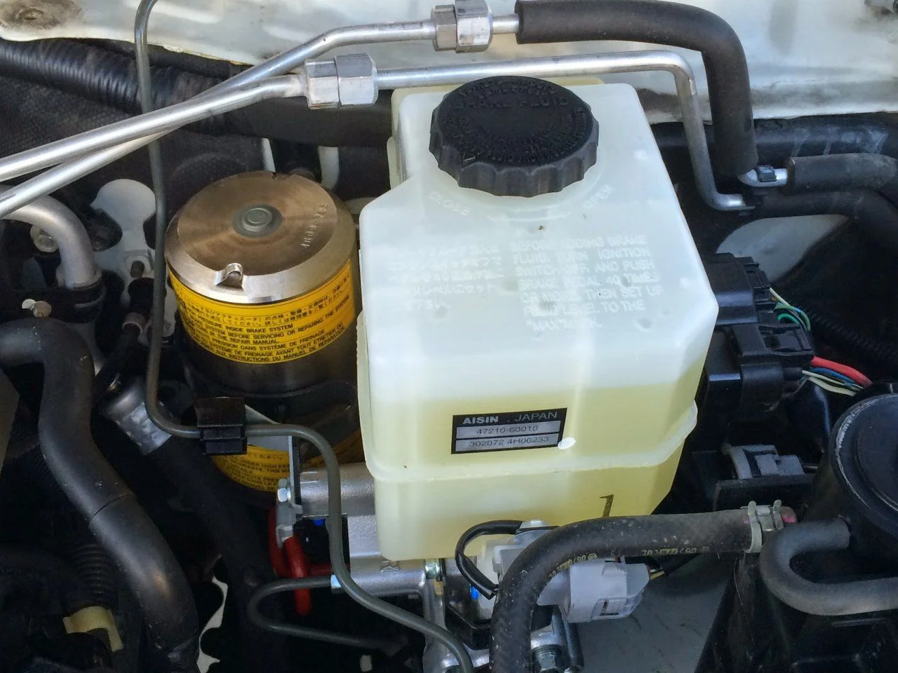

From a few weeks ago when the brakes went out . . .
And then - thanks to @beno - got one of these for a serious discount . . .

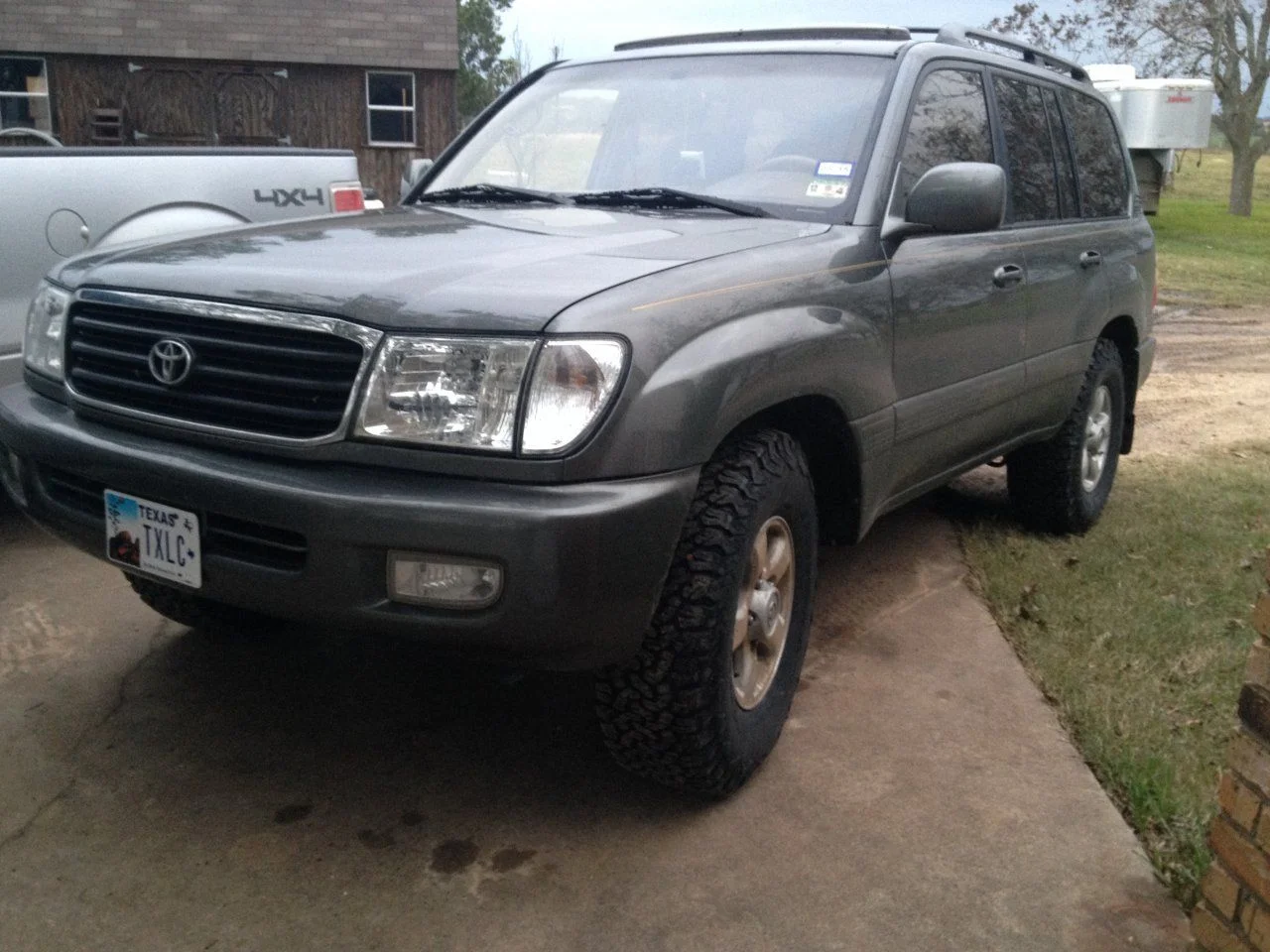

Installed wheel spacers: 1.25" front and 1.0" rear.
So far I'm OK with the wider look, the tire rub on the front shock reservoir has been eliminated, and I am enjoying the difference I feel in the suspension.
Replaced all 4 tires. Moved the best tire that I replaced to the spare (it was in bad shape and the rear tires were still in decent shape). Now I need an OME 2.5" lift... ok... I don't "need it" but I want one :)
They look great. Are they the new ko2 at's?
They are. I like them. They are a good balance between daily driver and something for off road.
285/75/R16
285/75/R16
Well from my experience, you won't be needing tires for a loooooooooong time.
Good choice, they are the best all around tires in my opinion!
Are these snowflake rated? That was my only beef with the old k/os, not great in the snow.
