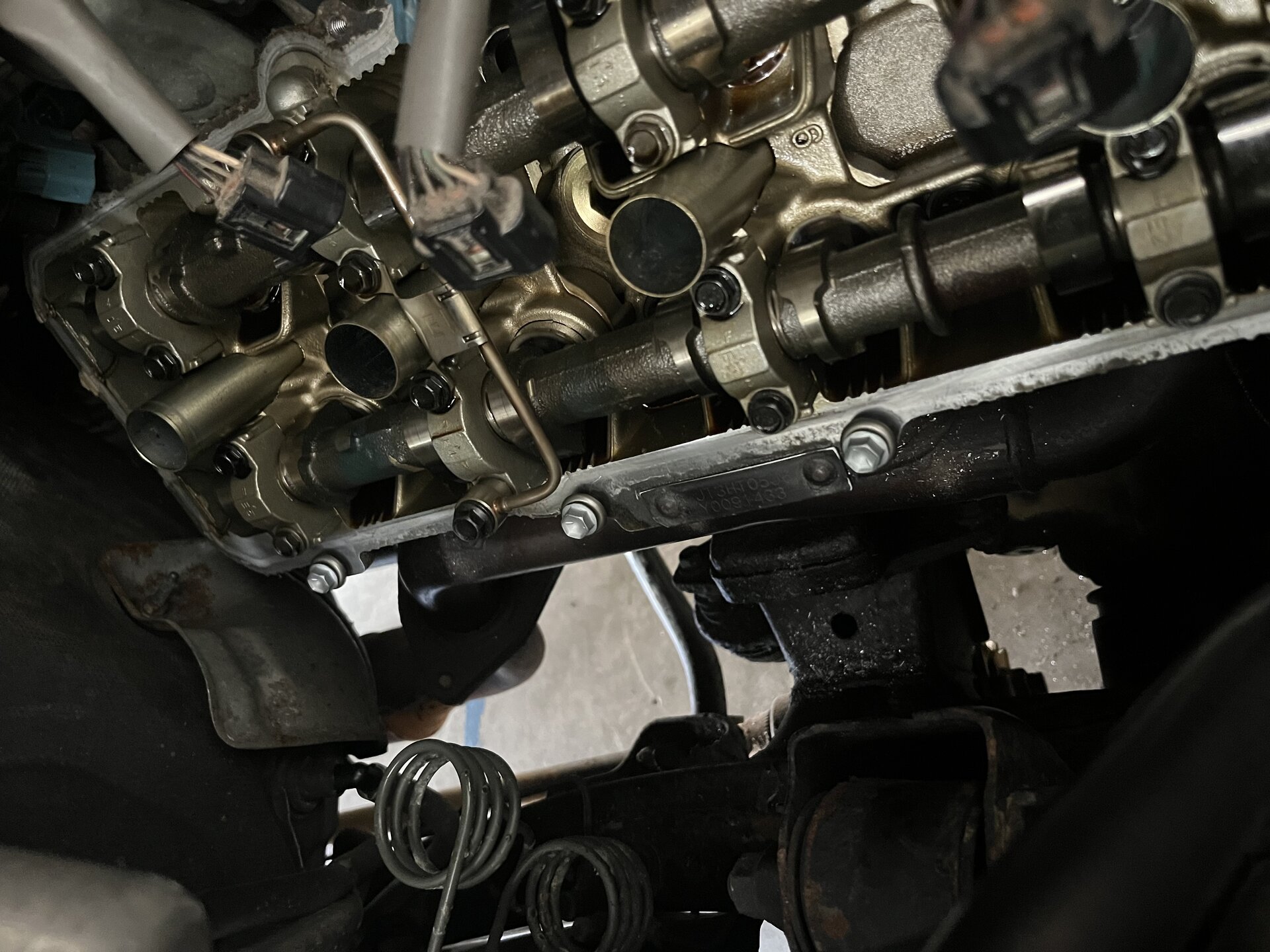

Due to an oil leak, I had to do my passenger side valve cover gasket and as luck would have it, three of the bottom bolts broke. After two hours of drilling and lots of patience I was able to remove the bolts and had the wholes re-threaded to the OEM size 6mm x 1.00. The new OEM bolts fit perfectly.
Good job. I dont get why those bolts break so often if they so low torque.

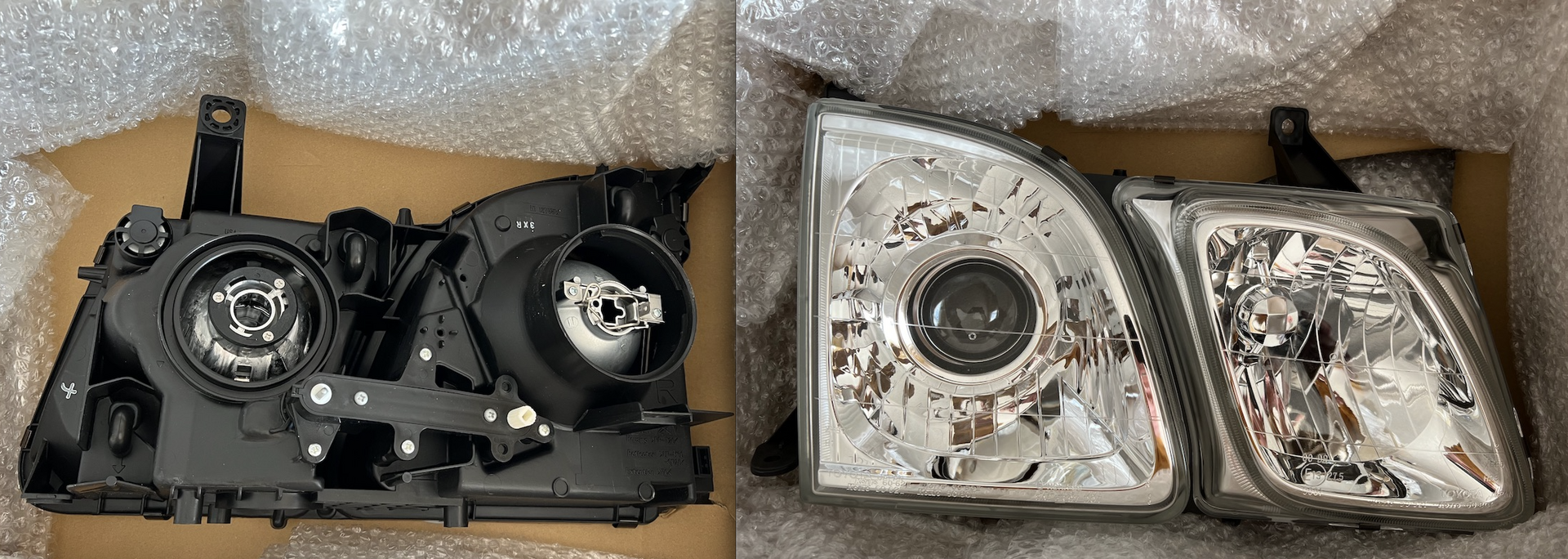

Received my new OEM Headlights for my '06 LX470... Got them on sale at Bell Lexus in North Scottsdale. The cost for the glass lens version was $332.81 each. Also got around to installing the Ironman 4x4 Recovery Points between the rainstorms we're having out here in California. Not that a Land Cruiser would ever get stuck...
Who should I get to convert to HID Projector Beams? I'm looking at LightWerkz... $1160 though...
You should read this thread…
Luke111 has it figured out.
This is the right answer, @RAMf1. Do it and don't look back.
