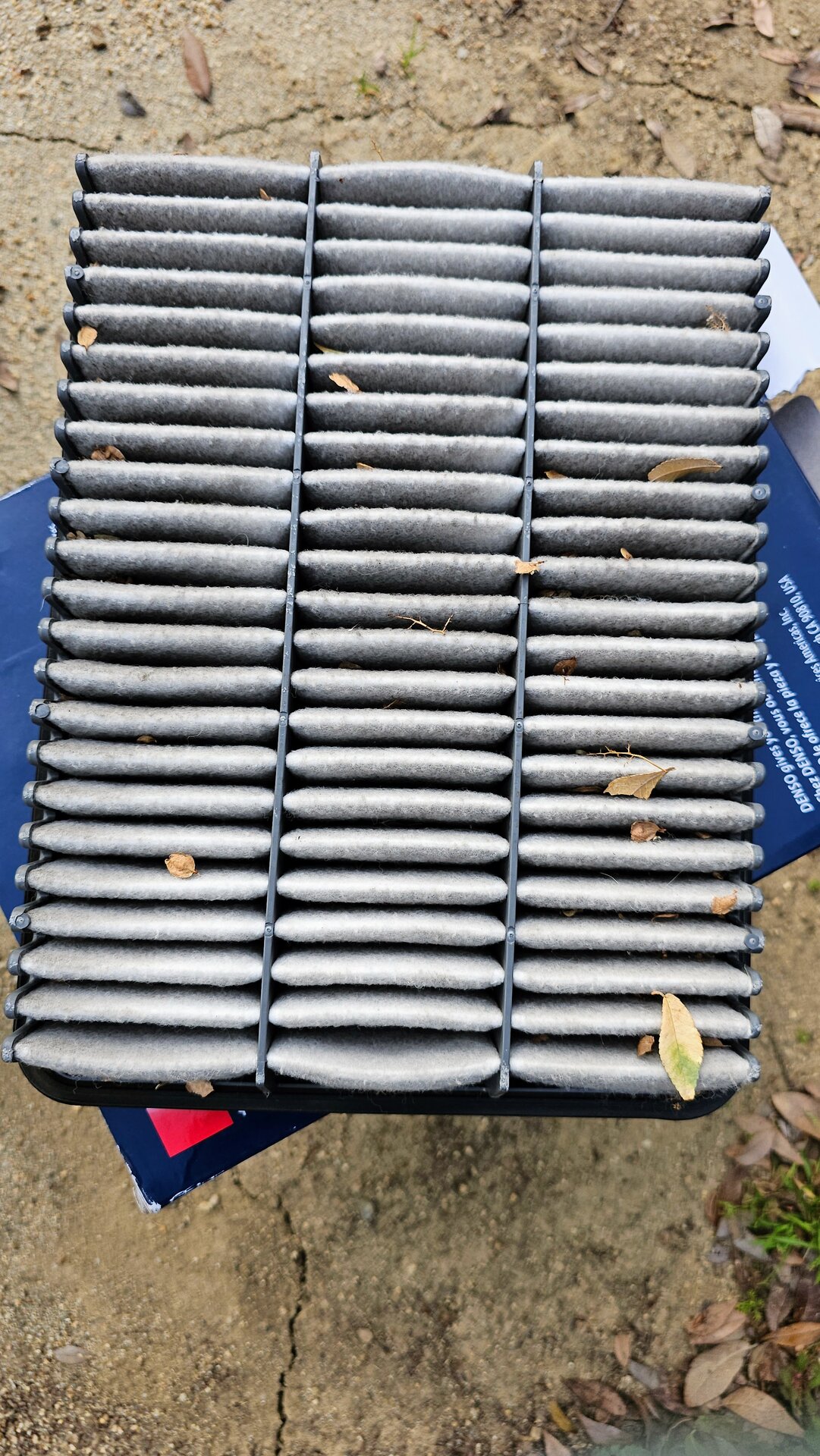

New Denso air filter, was too rushed to take pics of the other stuff today. It's dirtier in person than the photo makes it look.

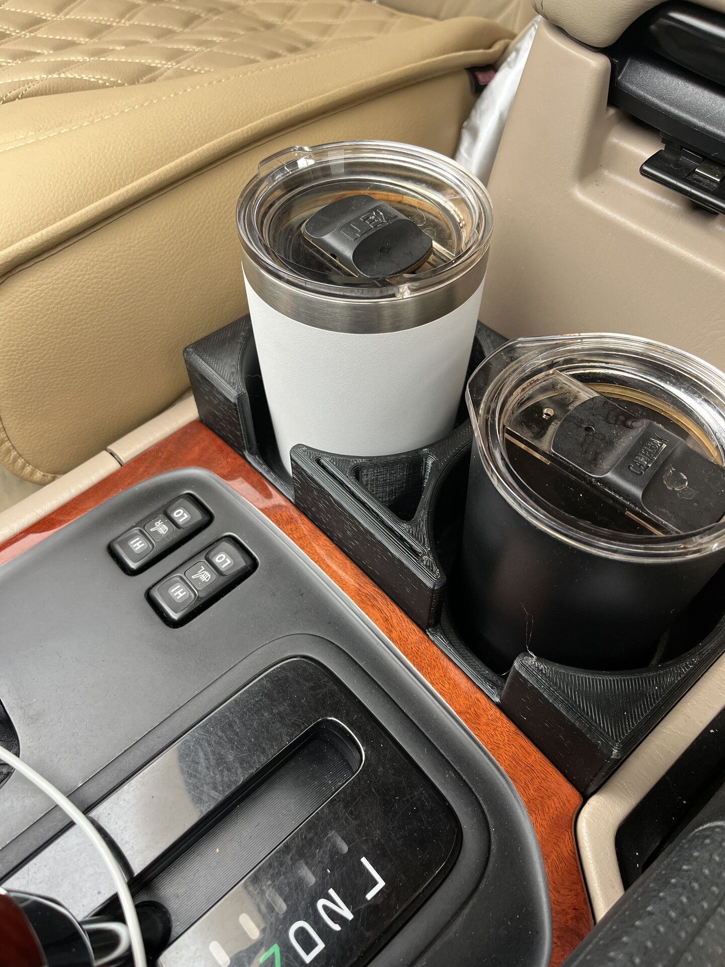

Installed the 3D cup holder from cruiser designs in the LX. Also dropped the U-Haul brand hitch receiver frame to make room for a 33” spare underneath. I had a replacement from Curt that was supposed to allow room for the 33” spare but the one Curt sent didn’t fit and all the bolt holes didn’t line up so I sent it back. I also did the Solvefunction side mirror rattle fix on my 80 series.
